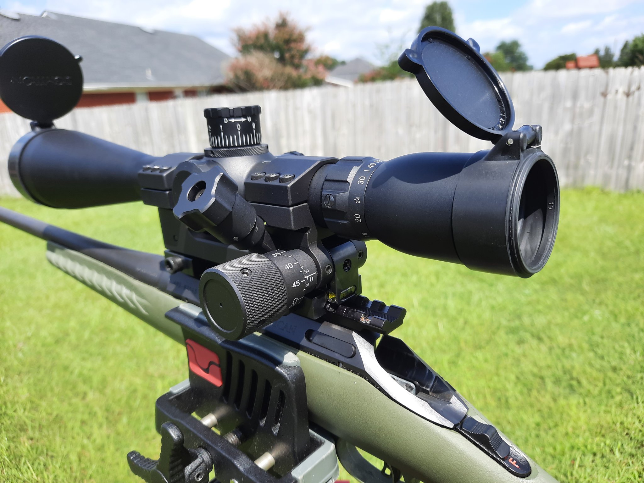

Then I put my IveyTron (Ivey base and Sightron 10-50 scope) from the 300PRC Pokemon Rifle to the Ruger RAP 6.5 in chassis. The thought here is that I can just swap the IveyTron back on the big rifle if I get a chance to shoot a mile this year.

I’m also curious what that bolt looking thing is off the side of the optic.

Its the Ivey Base: You can see more on Rumble in this vid - FF to about 2:50 in the vid
