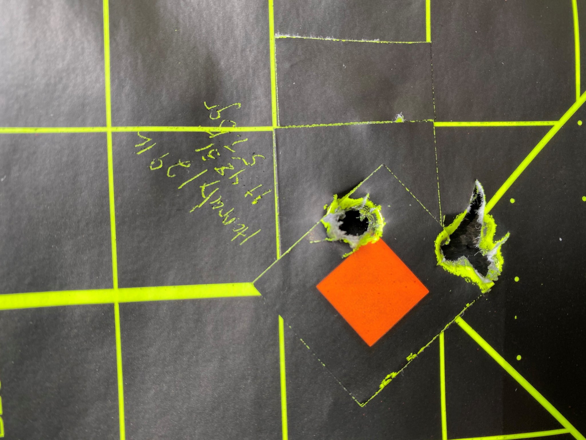

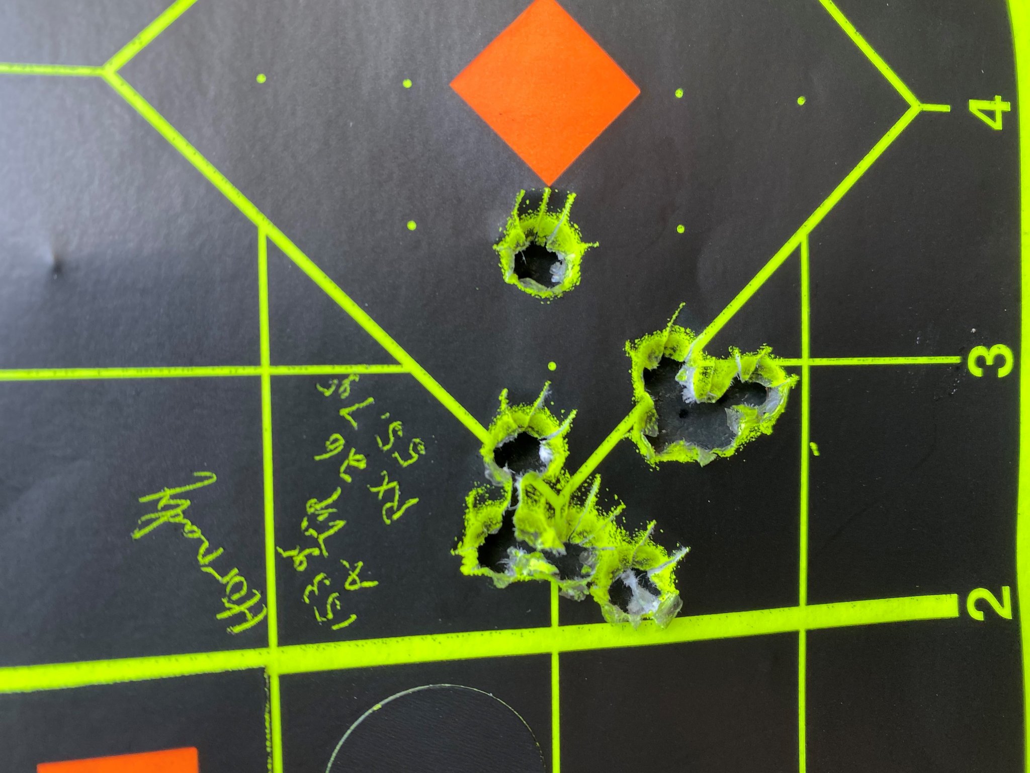

    Here's my data:
    Christiansen Arms MPR 6.5 PRC 24” carbon barrel 1-8” SilencerCo ASR Flash Hider
    Magneto v3
    Hornady 129gr Interlock
    H4831 57 gr
    Hornady brass x 4 firings
    Fed 210
    COL 2.052
    COAL 2.850
    3095, 3067, 3117, 3097, 3113
    1.00”
    H4831 57.5 gr
    Hornady brass x 4
    Fed 210
    COL 2.052
    COAL 2.850
    3164, 3156, 3188, 3142, 3167
    0.60” w/ 4 in same hole
    Warm barrel with 5 shots through it after cleaning
    H4831 58 gr
    Hornady brass x 4
    Fed 210
    COL 2.052
    COAL 2.850
    3154, 3176, 3180, 3179
    1.00” 3 shots through same hole, warm barrel
    Rx 22 56 gr
    Hornady brass x 4
    Fed 210
    COL 2.052
    COAL 2.850
    3090, 3143, 3161, 3143, 3170
    1.00” 3 shots 0.50” warm barrel
    Rx 22 56.5 gr
    Hornady brass x 4
    Fed 210
    COL 2.052
    COAL 2.850
    3170, 3178, 3178, 3195, 3188
    0.75” warm barrel
    Rx 22 57 gr
    Hornady brass x 4
    Fed 210
    COL 2.052
    COAL 2.850
    3160, 3190, 3212, 3206
    0.60” warm barrel
    Hornady 153 gr A-Tip
    H4831 53 gr
    Hornady brass x 2 firings
    Fed 210
    COL 2.030
    COAL 2.955
    2759, 2808, 2821, 2813, 2851
    0.75”
    H4831 53.5 gr
    Hornady brass x 2
    Fed 210
    COL 2.030
    COAL 2.955
    2858, 2839, 2842, 2831
    2853, 2853, 2838, 2867
    0.6”
    H4831 54 gr
    Hornady brass x 2
    Fed 210
    COL 2.030
    COAL 2.955
    2864, 2881, 2876, 2859, 2879
    1.00”
    H4831 53 gr
    Hornady brass x 2
    Fed 210
    COL 2.030
    COAL 2.955
    2927, 2886, 2899, 2891, 2898, 2895
    1.00”
    Rx 22 51 gr
    Hornady brass x 3
    Fed 210
    COL 2.045
    COAL 2.955
    2790, 2811, 2818, 2815, 2822
    1.00”
    Rx 22 52 gr
    Hornady brass x 3
    Fed 210
    COL 2.045
    COAL 2.955
    2873, 2876, 2878, 2889, 2881
    0.75”
    Rx 23 51.5 gr
    Hornady brass x 3
    Fed 210
    COL 2.045
    COAL 2.955
    2876, 2858, 2858 fps
    1.00”
    Rx 23 52.5 gr
    Hornady brass x 3
    Fed 210
    COL 2.045
    COAL 2.955
    2915 fps
    1.00”
    53F 44% 30.23mmHg
    Berger 156 gr Elite Hunter HPBT
    H4831 54.5
    Hornady brass x 6
    Fed 210M
    COL 2.035
    COAL 2.940
    2823, 2830, 2852, 2849, 2848
    2849, 2833, 2856, 2843, 2845 SD 10.6
    2”
    H4831 54.8
    Hornady brass x 6
    Fed 210M
    COL 2.035
    COAL 2.940
    2852, 2866, 2852, 2870, 2859
    2865, 2875, 2877, 2868, 2877 SD 7.5
    2”
    Rx 26 55.0
    Hornady brass x 1
    Fed 210M
    COL 2.030
    COAL 2.940
    2893, 2883, 2886, 2887, 2881
    2882, 2897, 2901, 2882, 2908 SD 9.3
    1.5”
    Rx 26 55.3
    Hornady brass x 1
    Fed 210M
    COL 2.030
    COAL 2.940
    2914, 2894 SD 14.1
    1”
    48F 86% 30.08mmHg
    Rx 23 52.0
    Hornady brass x 1
    Fed 210M
    COL 2.030
    COAL 2.940
    2805, 2823, 2839, 2827, 2842 SD 14.7
    2” cold clean barrel
    Rx 23 52.5
    Hornady brass x 1
    Fed 210M
    COL 2.030
    COAL 2.940
    2851, 2851, 2845, 2869, 2853 SD 9.0
    1.25” slight ejector circle pressure marks
    Rx 23 52.8
    Hornady brass x 1
    Fed 210M
    COL 2.030
    COAL 2.940
    2871, 2872, 2888, 2896, 2866 SD 12.7
    1.25” mod ejector circle pressure marks
    Rx 26 55.5
    Hornady brass x 1
    Fed 210M
    COL 2.030
    COAL 2.940
    2896, 2940, 2950, 2920, 2927
    2907 SD 20.1
    1.5” high ejector circle pressure marks
    Rx 26 56.0
    Hornady brass x 1
    Fed 210M
    COL 2.030
    COAL 2.940
    2949, 2962, 2956, 2947, 2955
    2951 SD 5.4
    1” mod pressure on bolt w/ ejection
