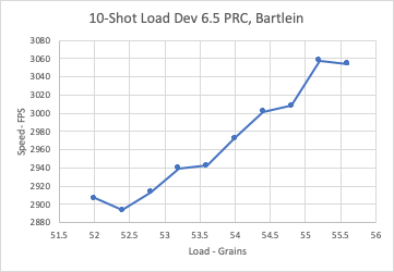

6.5 PRC Ladder Test (1st Time) 143 ELD-X New Rifle Thoughts On Next Steps
GBOGH
Sep 23, 2019
31
18
Ok so first time looking at a load ladder test and decided to look at the 143g ELD-X (as i had a lot of them :) ). Powders were RL26, RL19, RL17. Results are below with load data, graph, and shot grouping at 200yds. (unfortunately i was rushed to get through these as our range was about to go to a tourney so i had to get through the three 10 rd groups per 5 min range hot / range cold (so 5 min on 5 min rest )
i am curious where people would go next? i am thinking of dialing up the RL19 only in 0.2 increments now but maybe its worth looking at another or all other powders again in 0.2 increments. Just learning how to interpret data so happy to hear thoughts etc.
bo
G1G7
Bullet143g ELD-X
0.625​
0.315​
PowderRL-26
Barrel26" Bartlein
Twist1:8
BrassHornady
PrimerFederal Lg
ShotLoad-grSpeed-FPS
1​
52​
2907​
2​
52.4​
2894​
3​
52.8​
2913​
4​
53.2​
2940​
5​
53.6​
2943​
6​
54​
2972​
7​
54.4​
3002​
8​
54.8​
3008​
9​
55.2​
3058​
10​
55.6​
3054​

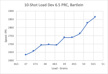

G1G7
Bullet143g ELD-X
0.625​
0.315​
PowderRL-19
Barrel26" Bartlein
Twist1:8
BrassHornady
PrimerFederal Lg
1​
47​
2634​
2​
47.4​
2657​
3​
47.8​
2694​
4​
48.2​
2697​
5​
48.6​
2694​
6​
49​
2739​
7​
49.4​
2739​
8​
49.8​
2762​
9​
50.2​
2828​
10​
50.6​
2864​

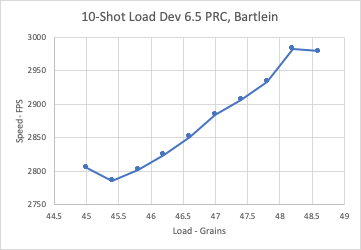

G1G7
Bullet143g ELD-X
0.625​
0.315​
PowderRL-17
Barrel26" Bartlein
Twist1:8
BrassHornady
PrimerFederal Lg
1​
45​
2805​
2​
45.4​
2785​
3​
45.8​
2802​
4​
46.2​
2825​
5​
46.6​
2851​
6​
47​
2884​
7​
47.4​
2907​
8​
47.8​
2933​
9​
48.2​
2982​
10​
48.6​
2979​

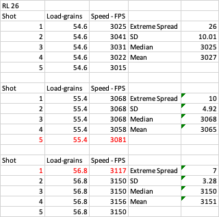

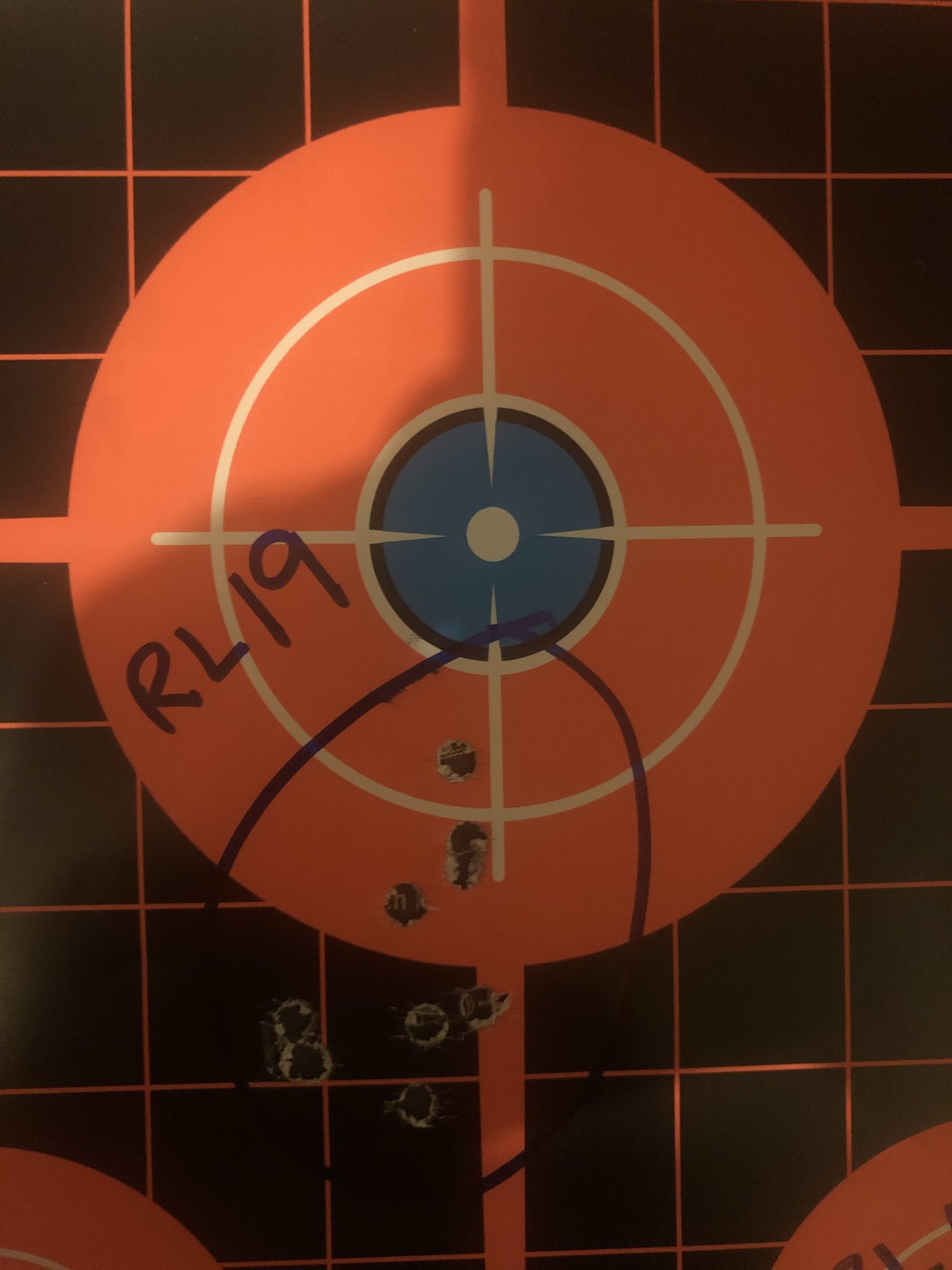

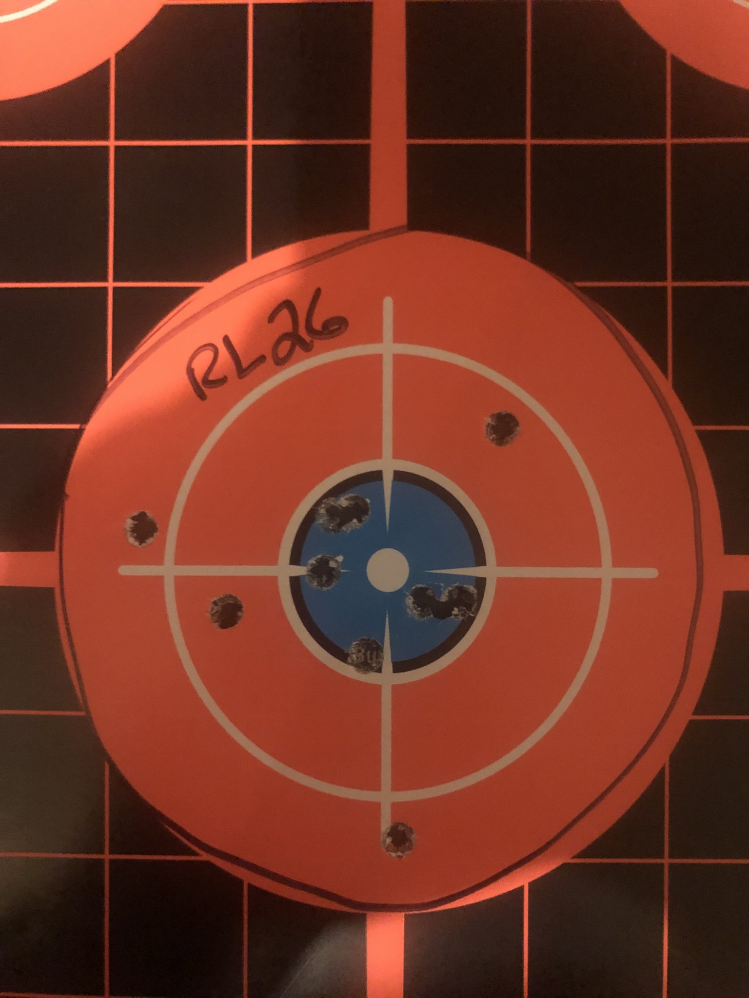

Well first off, excellent layout and posting info, I'm about to do this for the first time for my 300WM in about a week, so I really don't feel confident to comment on your results. That said, what was your COAL with respect to the lands? I've decided to start @ .020. I'm going to say that the RL26 looks to be the best with the "better" group size IMO and MV. Good job. Cheers
I’m at 2.905 length for all loads. I was going to work on coal once I found a sweet spot on loads. So at this point I actually don’t know my coal.
OK, well it's my understanding that once you have the "node" you can fine tune the accuracy to some extend using the COAL. While you have a few "flyers" with the RL26, IMO you have excellent MV and if you can tighten the group , you have done your job. Good luck.
It’s likely I found a good upper node on rl26 but never hit a peak with rl19.
I may push rl19 a bit and also fine tune rl26 and take my time
ill Be measuring my coal in next few days. Wish i could find hornady prc for their coal
BTW, did you experience any over pressure signs? also, I bought the Hornady gauge and modified cartridge, so I could get the exact COAL for my chamber and adjust from there. I'm running a Bartlein barrel as well & I'm impressed with it's performance so far. He's a 3 shot group with Norma 170 Tipstrike factory ammo, after about a 30rd "break in" .

Photos are as follows: (ALL 200 yard groups)
They are in order of the loads above.
note that the first load 54.6 showed more sporadic velocities and spread.
the second pic, minus one shot (last one) had a decent spread
third again minus one shot was not bad either.
I shot the 5 rounds in about 20 seconds or so for each round of five. basically was not really taking too much time to steady etc.
the following are the numbers then in order of the three loads:
Now one thing that was curious to me. the last round at 56.8 showed a lot of smoke in the action area. but there was zero primer issue zero heavy bolt or ejector mark. is this a primer pocket being expanded and gas escaping from over pressure of the primer pocket???
I lean towards the 56.8 load but if the smoke is a sign of an issue seems the 55.4 is not bad either.
either way I will be measuring my lands next and doing 0.015 to start and maybe 0.025 and 0.035 away to see if there are any changes.
