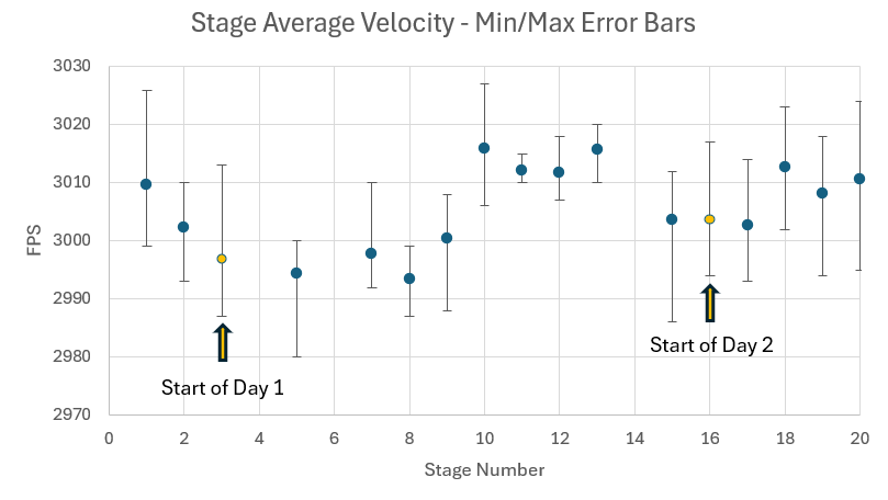

    28” 1:7.5 tw Bartlein barrel with a SAAMI chamber.
    5 shot groups are great:
    Temp stability is pretty good. I recorded almost all of my shots over a 2 day match. Temps ranged from the low 60s in the morning to the mid 80s in the afternoon. Despite that, I had an SD of 10 and ES of 47 for the entire match.
    Each stage was 4 to 8 shots. The error bars show the min and max velocity for each stage.

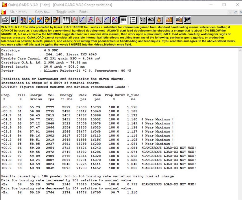

    Up to this point, I have been using RL-26 but the spread on speed is just no good as far as I'm concerned. I see pretty big variations in speed when the temps change, and I'd like to get something more stable.

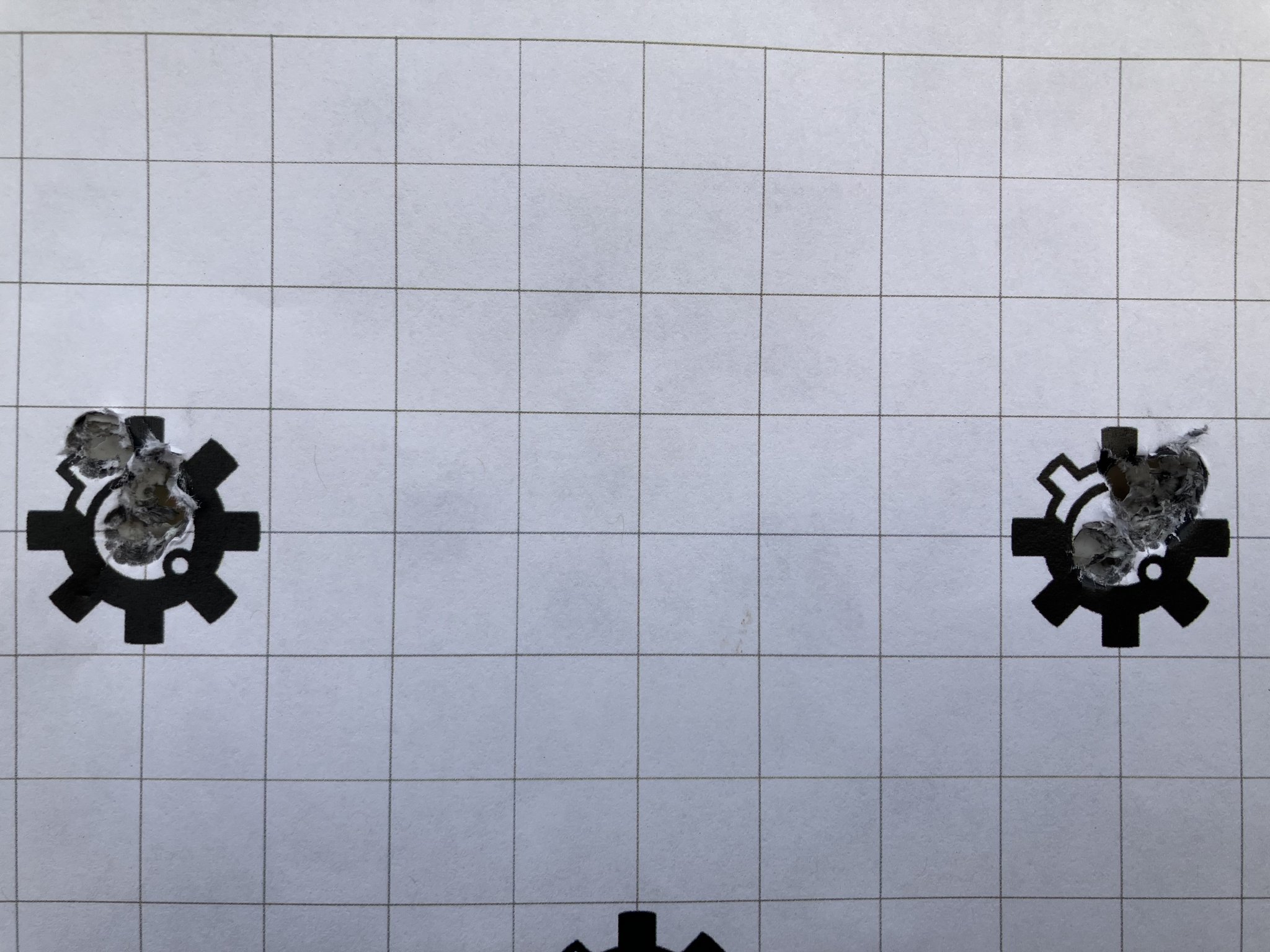

    Just started loading for the 6.5 PRC this week. I’ve been shooting factory Hornady 147 ELDM ammo for a few years and was never really happy with it. It killed several deer, but felt it could shoot better.
    Defience Ruckus Ga Hunter
    Proof 22’ carbon barrel
    Hornady 1x fired brass
    Federal 210
    147 ELDM
    56.6 H1000
    2954 fps
    ES 8.7
    SD 3.9
    .260 group
    This was only a 3 shot group. I’ll confirm with a larger group when I get back from work in a month.

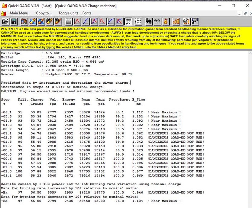

    I'd say that N560 would be a good powder to try. And if you're after velocity, it'll get that projectile over 3k fps without any pressure issue in a 20" barrel and over 2900 for an 18" barrel.
    Another good powder would be H4831sc.
    Reactions: 260284

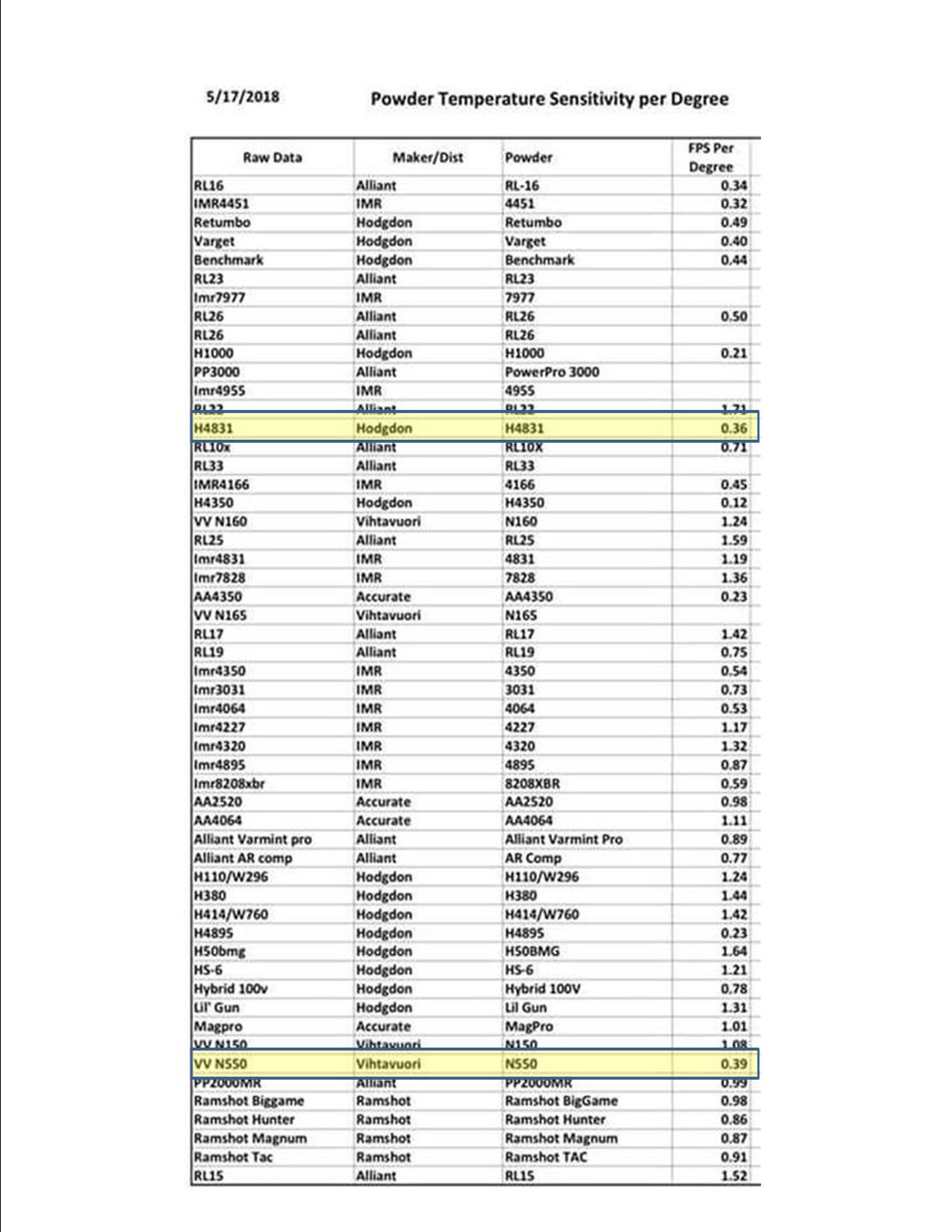

    I'd recommend going with H4831sc. It's really a good power that done well in various cartridges and calibers. It's even worked well for me using 140 to 153.5 gr Bergers.
    So the H4831SC is awesome! I have 3 range sessions on it and the speeds were all consistent and predictable. The best part is the ES was 10 fps or below on all loads tested. I ended up settling on 56.5 gr of powder with 140 game changer bullets. Averaging 2955 fps. (20” barrel)

    So, I ran some numbers just to see where that load is, as I know I've been running ~54.5 grs and know that was on the high end. So, here's some ballpark numbers just FYI:
    I like that software; I'll have to download and try it out.
    I would be interested to see what the RL26 numbers are, they are basically running neck and neck for speed (in my rifle). It's interesting that the 4831 would show near max pressure with extremely low velocities.
    The fill volume also makes me wonder, I could shake the loaded round and vividly hear/feel the powder still had some capacity.
    Is there any chance that this software is on the "lawyer" side of things?
    This software is available for download, but at a price. Note too that there's a bit of a learning curve for how to get the numbers right that's reliable. It works well for finding the ballpark to work within. Basically yes, I'd say it's on the "lawyer" side when used properly.
    Here some RL26 numbers (for the default burn rate):
    Reactions: BossGobbler

    Anyone tried any of the N100 series? Like N165 or N170?
    Currently using H1000, but I was thinking about that or something like Ramshot Magnum for practice & plinking.
    I haven't tried any of the n100 series for this cartridge and I just didn't think the temperature sensitivities for them would work well for me here in the Phoenix AZ area.
    Back when the "good" powders were hard to find, I did get hold of some MagPro, which isn't too temperature sensitive and it did ok, but I'm only using what I have left for fire forming.
