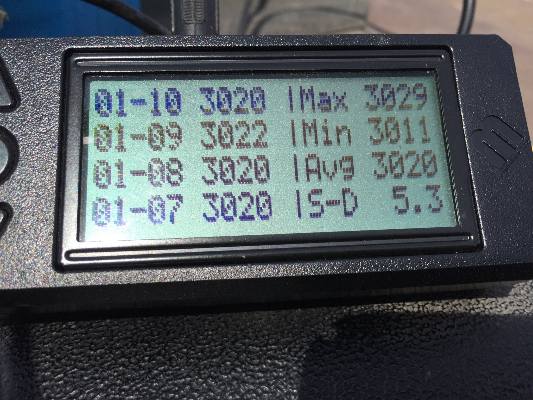

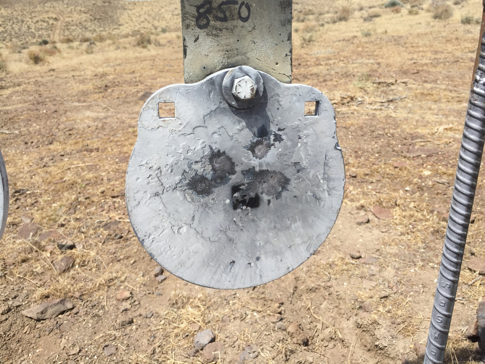

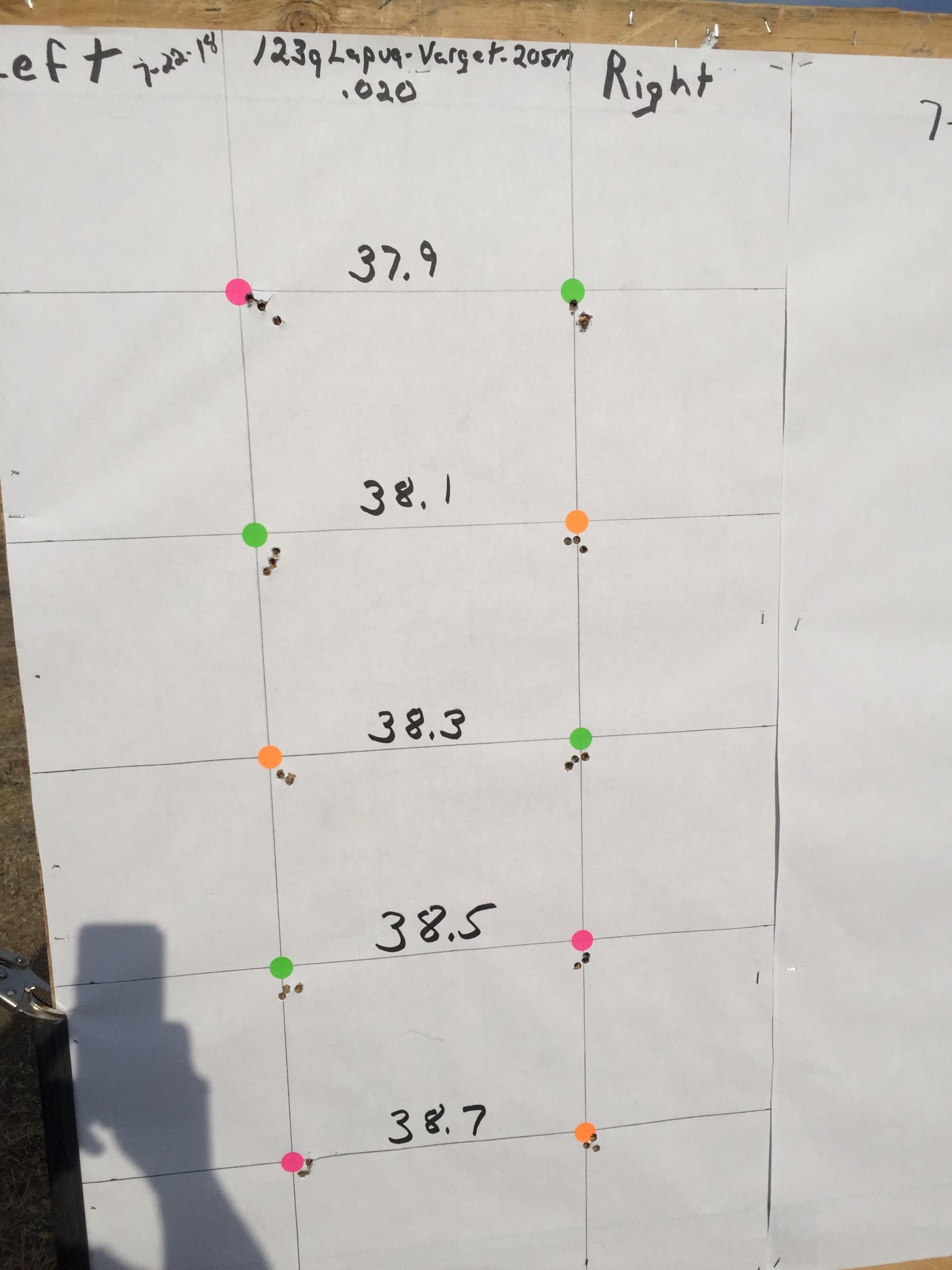

If varget and what ever bullet you choose don’t shoot in your 47 something is wrong.
I’m on my 3rd 47 barrel all hawkhills...
First varget and 140g hybrids tack driver
Second 140eldms 130 Berger hybrids 130 TMKS all with varget shot lights out
3rd just got shooting last Sunday 123 lapuas and varget
I tried 4350 in all of these and no where near the accuracy or low number varget produces .
The steel is at 425yds 7 rounds and have not touched seating from the load development.
Run the varget you’ll be much happier
