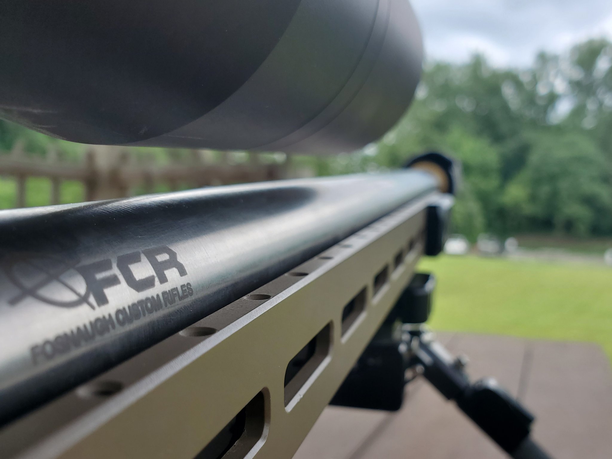

150 rounds down the new rebarrel from Fosnaugh Custom Rifles. A Bartlein Barrel mod400 at 25 inches and 1.20" straight no taper.

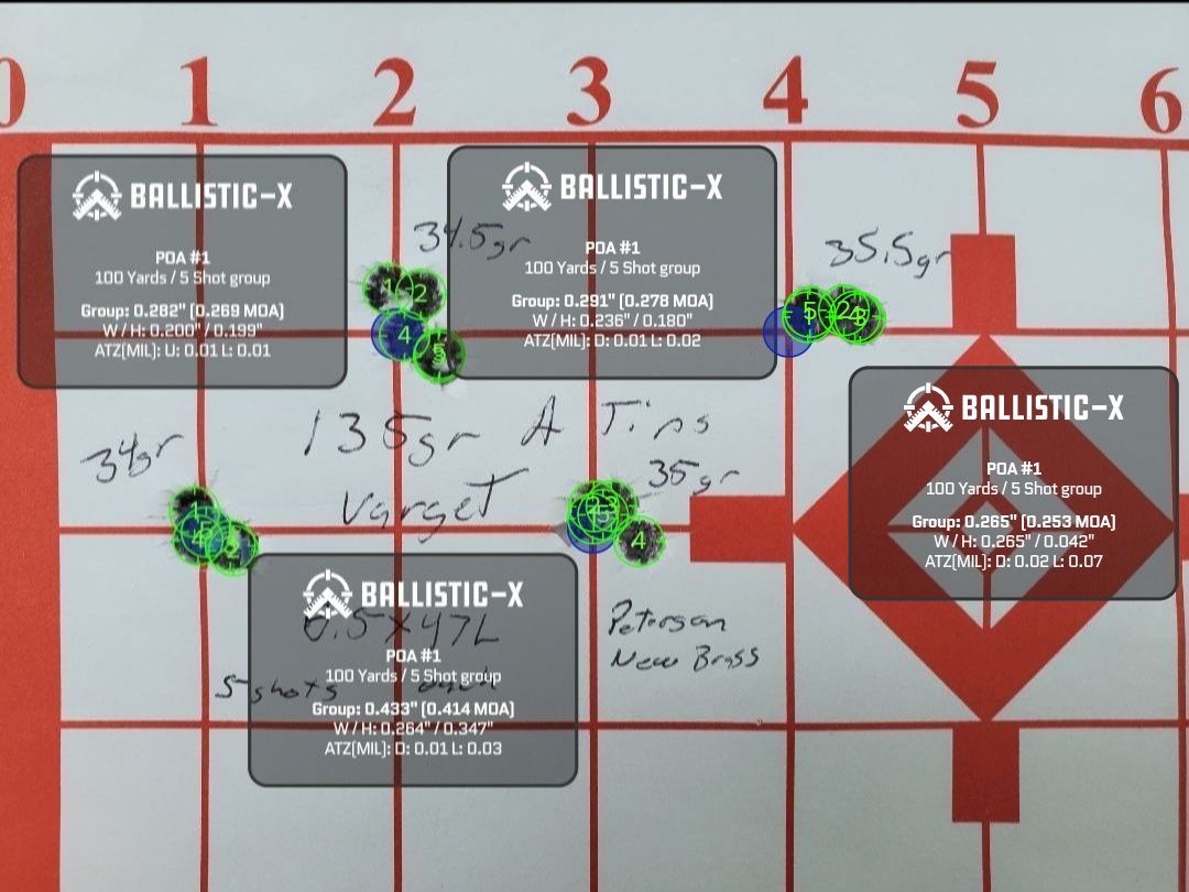

My Hornady 135 grain A-tips arrived today so I loaded up some with Varget, set the jump to .055" in brand new Peterson brass and lit them off with CCI 450's. Four groups of 5 averaged .303 moa 👍 thanks for a sweet shooting rig Eddie!
Thats a pretty consistent load there...
