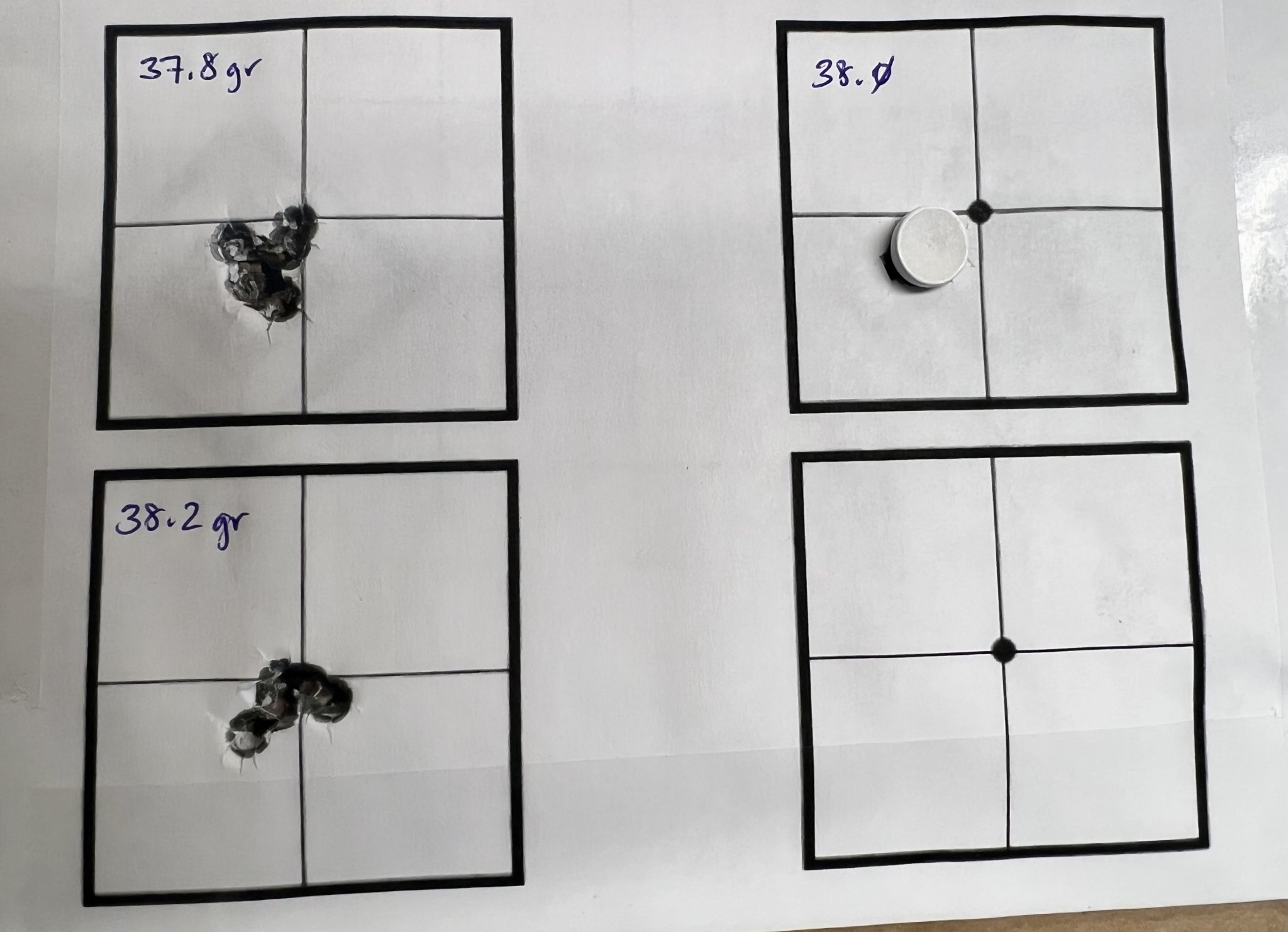

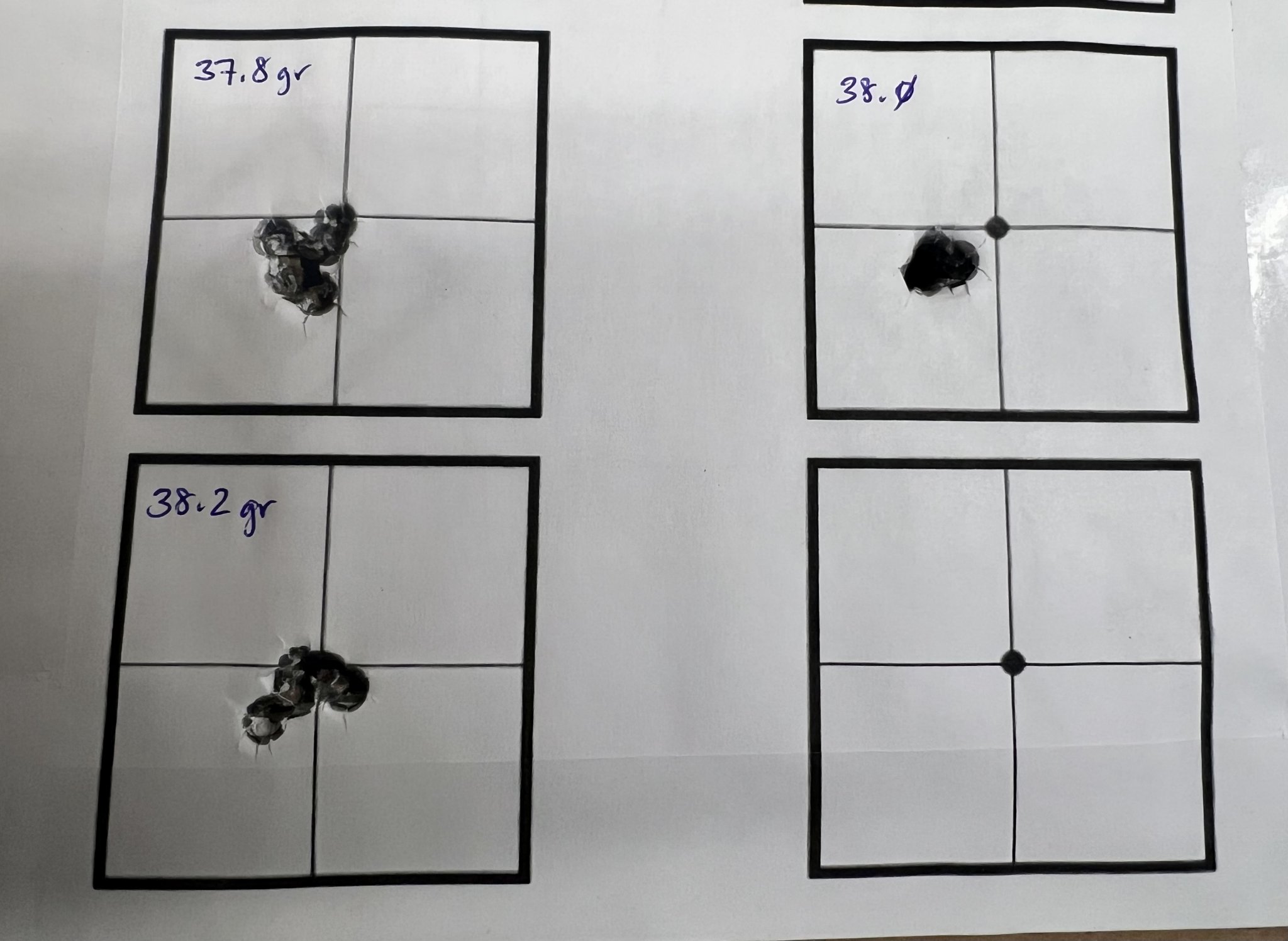

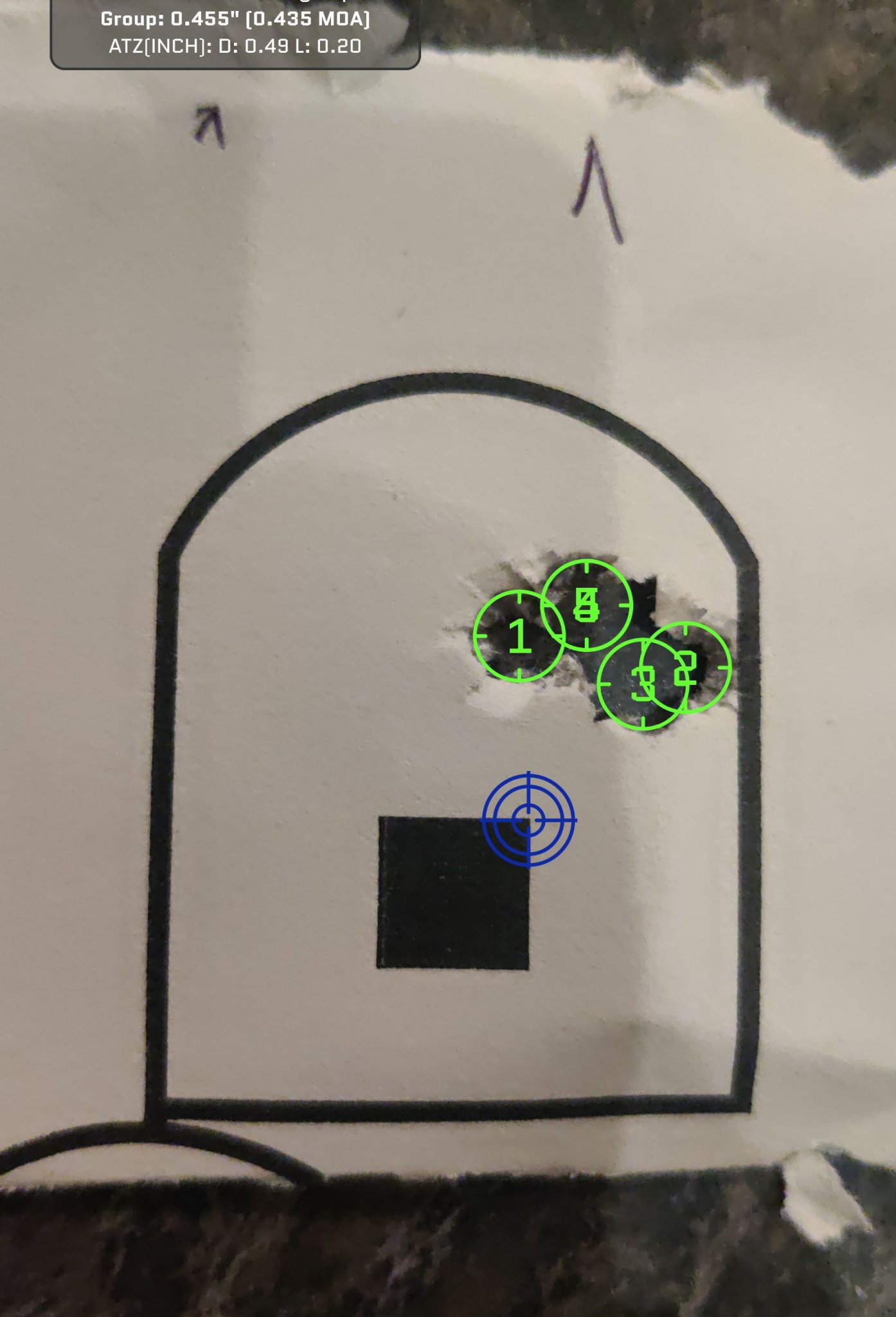

5-shot groups:
With a golf tee for reference:
These are the 2600fps node - extreme spread was 2598 to 2610 across all 3 charges.
Around .060” jump, didn’t even touch the tuner yet.

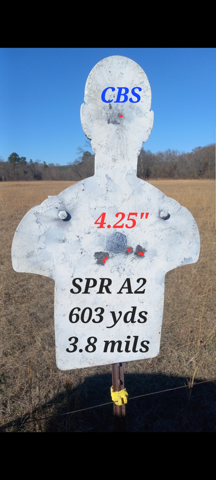

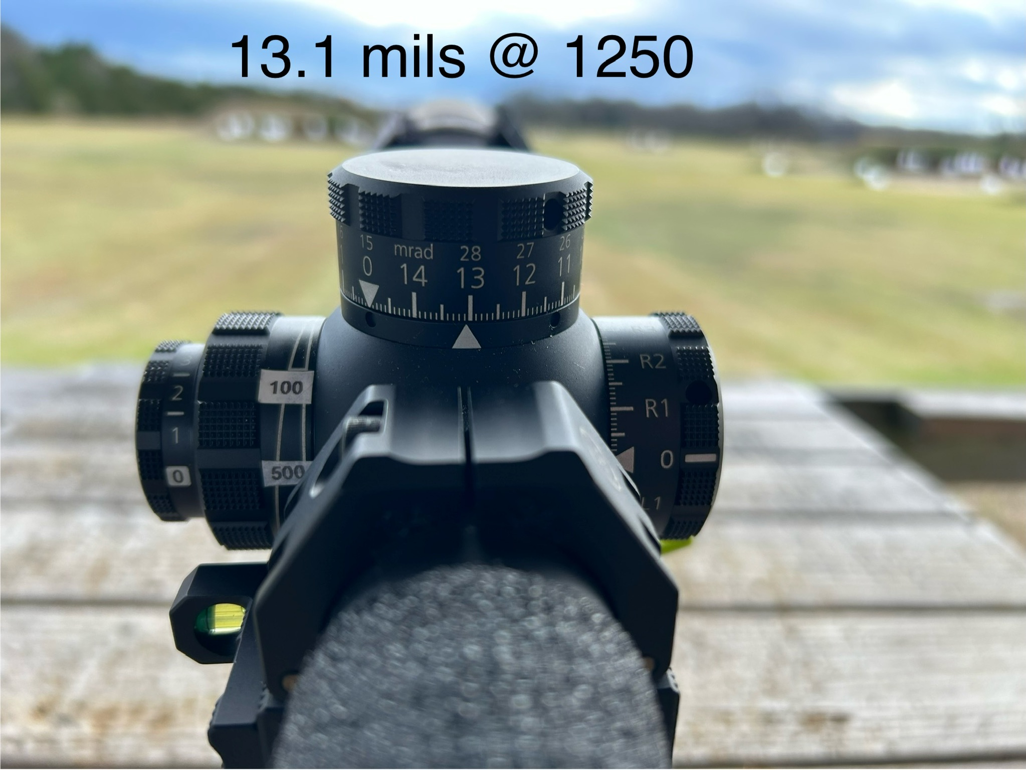

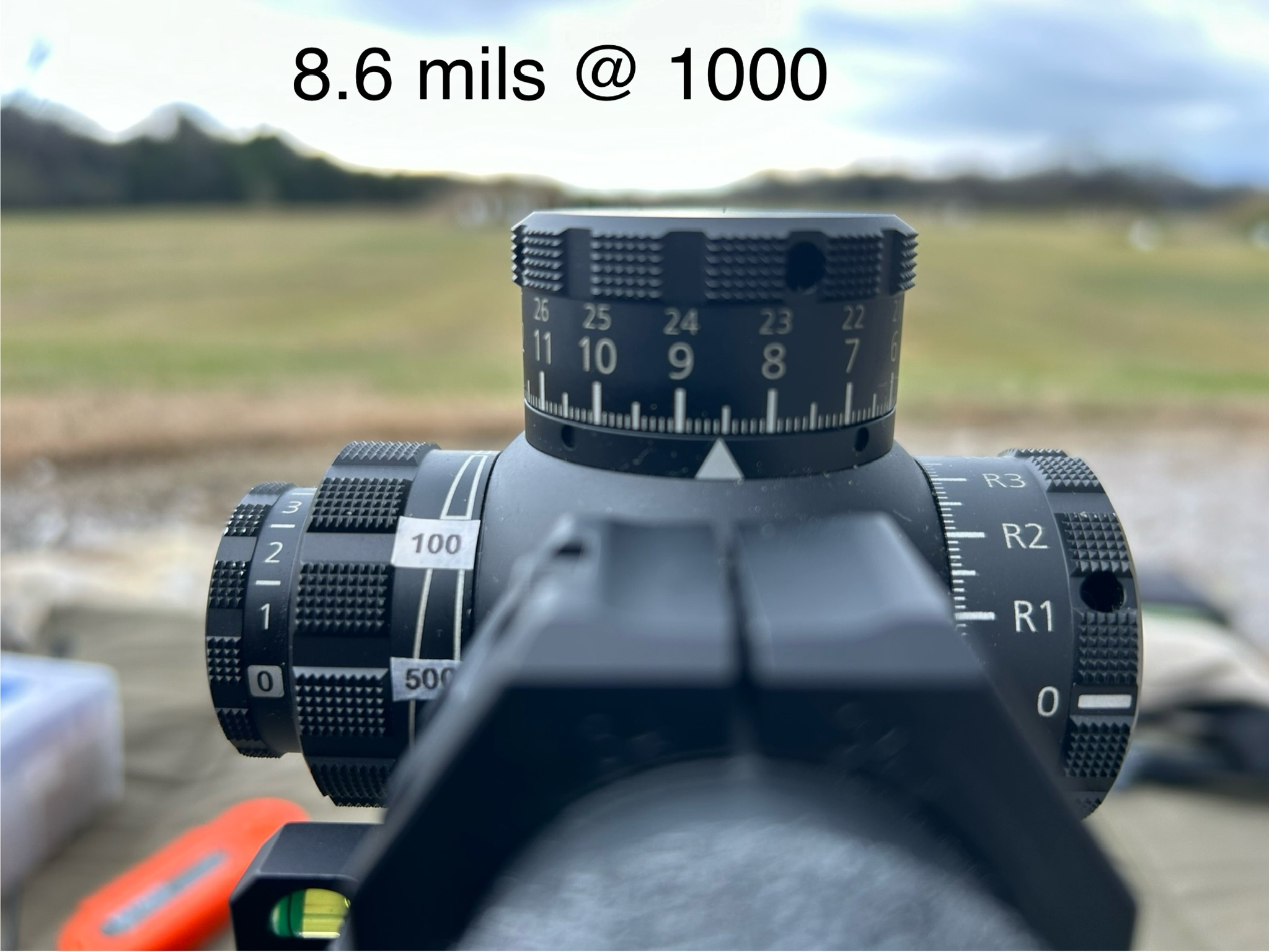

Trued velocity at 603 yards today on the 123gr Scenar / 35.3gr Varget load. It's just chug, chugging along at 2,805 FPS, but the load works. See post #615 for short-range workup and specifics.

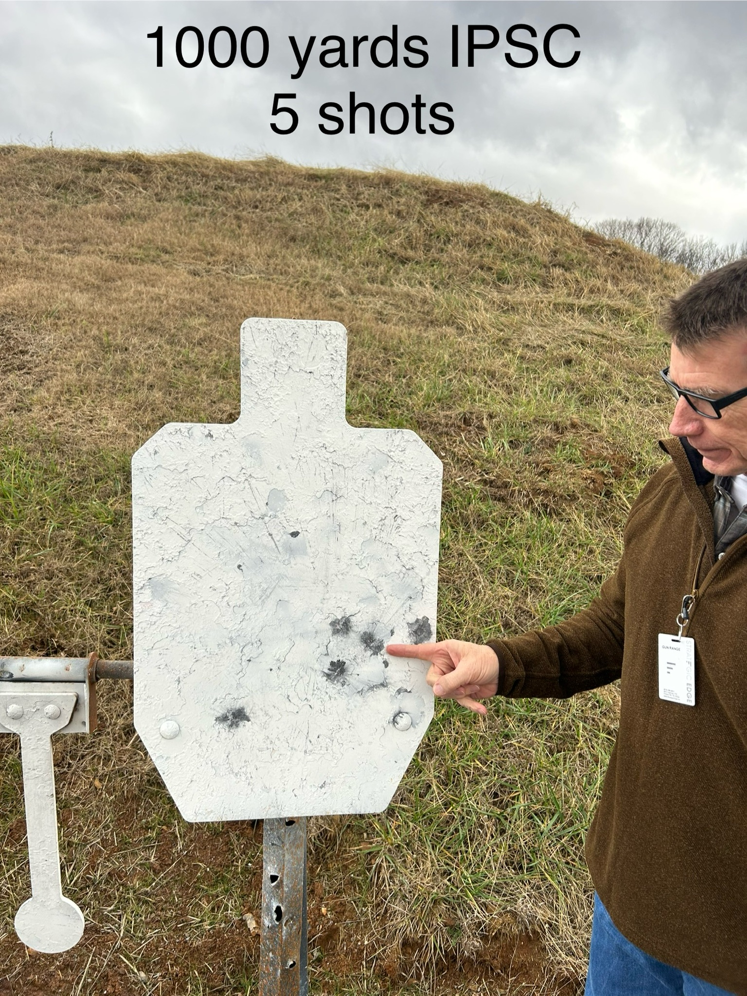

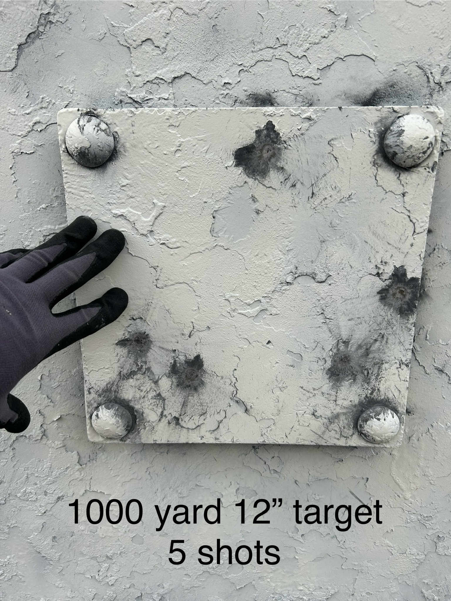

Approaching 3000 rounds on my x47, and it’s still shooting but I think the velocity has started to drop. Took it out past 500 yards for the first time in a few years, did ok at 1000 yards (first round impact on the 12” sight-in plate) but it fell apart at 1250. Switching headwind of 10-15 mph made it interesting. I think the bulets were going transonic at 1250.
140 ELD-M’s with 38.5 Reloder 17.

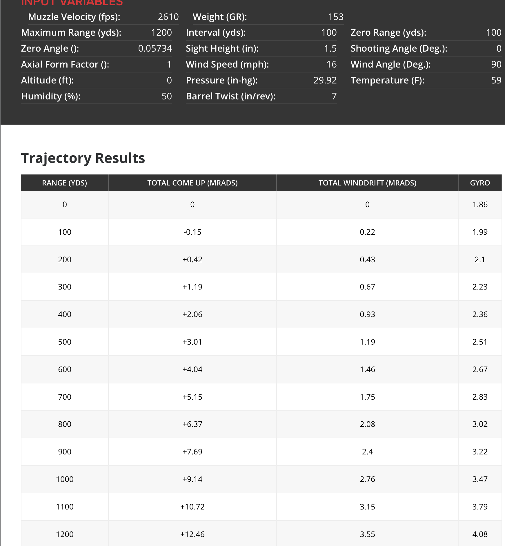

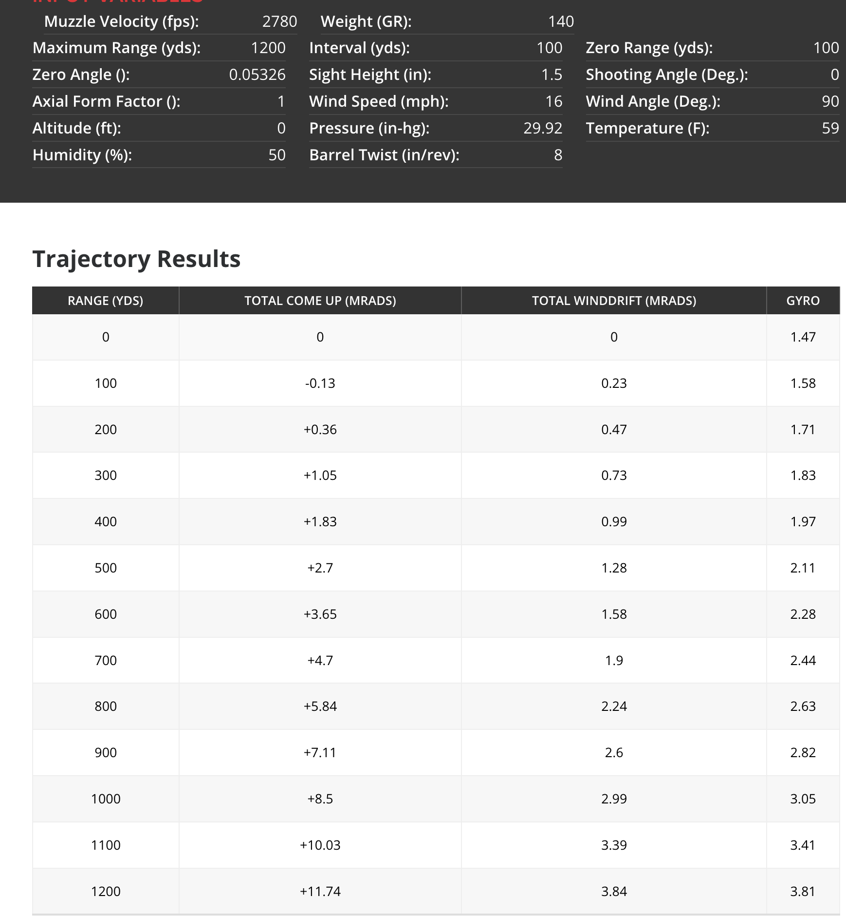

Looking at 4Dof's doppler data, and comparing a 153 A Tip @2600 to a 140 Hybrid @2780, you might see a .1 difference in wind drift up to 12mph wind at 90° until you get to about 1000 yds, and which point it turns to .2
140 HYBRID @2780 FPS
153 A-TIP @2610 FPS
Not sure if the juice is worth the squeeze, unless you were considering running the 140s @2610 and seeing if the 153s would be a better option for slow stuff.
