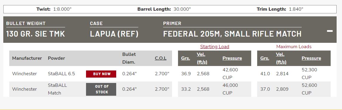

Anyone tried staball match? Burn rate is similar to varget. Now that I’ve moved and am gonna be in LA for four years due to residency. I’m thinking of ways to avoid dropping a ton of cash into a new reloading setup. Figured I’d bring the Dillion down use staball Match and just throw it. Range is 15 minutes from my place and pretty solid so i plan to start shooting more again
Don't think I've seen any 6.5x47L, 6.5C, or .260 posts using it yet.
StaBall seems to be in the perfect burn rate for the 6.5 short action cartridges, so I'm not sure Match is going to best it. Maybe with the super heavy projectiles? I honestly just don't know. Hodgdon's data shows them basically neck and neck with a 130gr bullet in the 47L, but who knows what real world results will show.
Go buy a pound and let us know :)
Don't think I've seen any 6.5x47L, 6.5C, or .260 posts using it yet. Go buy a pound and let us know :)
I’m thinking about getting 8. I just haven’t read anything good about staball 6.5 with the 6.5x47. With match having a burn rate extremely close to varget it should perform quite well with the 6.5x47. Least that’s my train of thought. I saw where George said that it would work with the BR and Dasher. Which are to extremely varget based cartridges
I went back and added a bit to my post after looking at Hodgdon's data. I think it'll just be up to us reloaders to see if it performs. Similar to how StaBall data showed it to supposedly be a good 77gr .223 powder, but turned out to be a flop, I think it'll pretty quickly get figured out in the x47L as well.
I seem to recall reading on a forum when it first came out that it wasn’t ideal in the 47, so I held off on trying it. But I hope I’m wrong. Please share your results.
I mean according to hodgdons video George said it was ideal for 6Br and dasher but stepping up to the GT would warrant 6.5 staball. But given the burn rate I’m inclined to try match. Plus I’m trying to get my Dillon here and just load on it

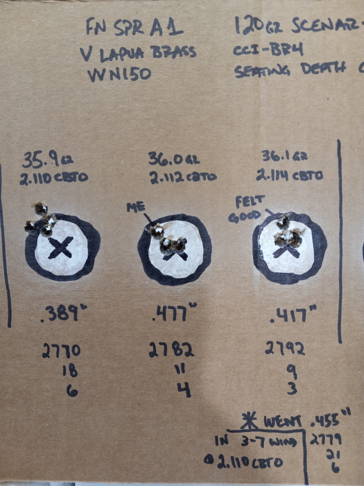

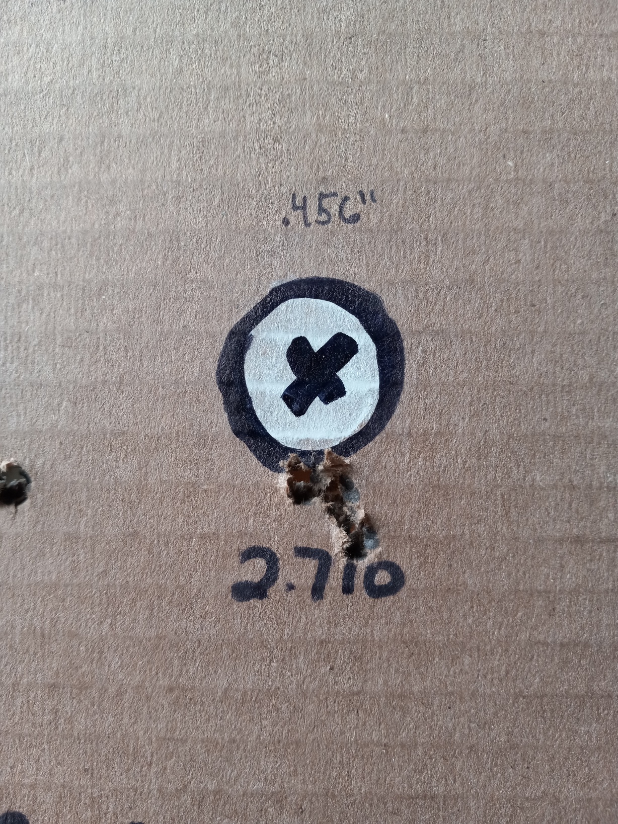

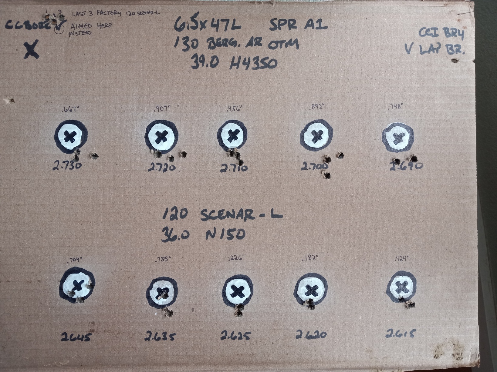

Got out in the snow with my coarse seating depth tests today.
On a side note: I'm going to have to remember to not try this again with my Bushnell DMR II. I've never really noticed the CA before with my eyes during much more ideal conditions, but it REALLY stood out today against the snow and played hell with my ability to focus.
Excuses out of the way, I have about 125 rounds down the pipe now on this particular rifle. I thoroughly cleaned it after shooting last, so I took the opportunity to see how much my cold bore shift is. Turns out that it is not much. Three shots (top left) of my last three remaining factory rounds fell into about a half inch group...which is what this rifle does with that ammo. I've shot a. 4, two .5s, and a .6 for (5) shot groups with that factory load during break-in.
First up on seating depth: 130gr Berger AR OTM Hybrids (that's a mouthful). Never tried this bullet before, and I've yet to screw with H4350 in this rifle. Nothing really stood out. I had a. 6, .7, .8, and .9...with one depth showing a little promise at .456". That is a .040 jump for this chamber.
*Yes, I know...three shot groups. The Hornady guys would be in agony if they saw this. I have managed to figure out what doesn't work pretty quickly with three shots, and save my components for charge weight testing and confirmation groups.

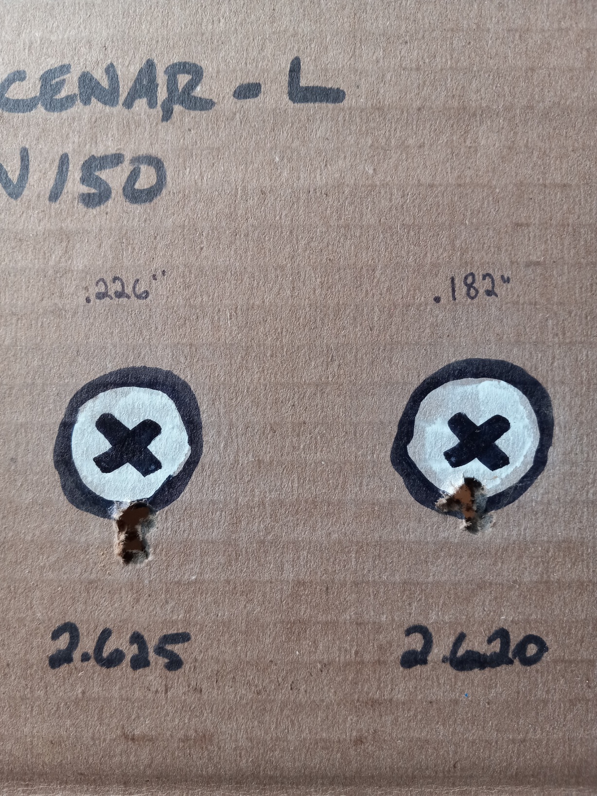

Next up was the 120gr Scenar-L. Factory loads are 2.615 (can't remember the CBTO at the moment), and I've thrown five-shot groups in the .4s during moderate wind with the bullets seated at a nominal 2.620. So I have a little experience with this bullet and powder already. Turns out 2.260 is the uber sweet spot, but 2.625 isn't shabby either. I'm probably just going to load 10 shots for confirmation at 2.265 and figure this load will last for a while as the throat erodes some. Velocity was 2780 with an SD of 6 when I shot that load before...not a screamer, but this is a range toy and not a comp rifle.
So at this point I have one load for confirmation testing. I may try the 130s next with Varget and see if anything improves.
Rifle is an FN SPR with 26" Brux, 1:8, M24, that was spun on by Matt Stewart.
Brass is virgin Lapua, primer is the CCI-BR4.
Reactions: Oldloser and bobke

I guess I've screwed with the 120gr Scenar-L, and VV N150 to where I'm as good as it is going to get for my skill level (at short range). I'm still needing to verify this at distance before I count on it enough to load up and go.
Only five-shot groups today too...I wussed out of 10- rounders in favor of additional testing .002" depth and .1gr powder adjustments just to see what kind of window of decent accuracy I had.
Looks like 2.110 - 2.114 CBTO at around 36.0gr +/- .1 is going to keep me in the .4s. That gives me some wiggle room without having to constantly tinker with stuff.
By the time I had dropped to 2.008 - 2.009 CBTO, groups opened up another quarter inch even though ES and SD got stupid low (like 6 and 2)...definitely can't go below 2.110.
I managed to "throw" one shot high a couple times too. One I called before I even saw the impact (it is still minimal), the other felt good, but ended up opening the group a tenth or so. I counted both in the measurements anyway. I was getting excited on the right target until that 5th shot got me.
Wind was a very nice 2-4 full value, so no real guess work needed.
It's a nice, easy load that - if it holds at distance - will be great for informal recreational plinking.

I know the Hornady guys would crap because the group sample sizes aren't large enough, but try 3-5 shot groups of your favorite load with your seating depth...then do it at .003 intervals in each direction a few times (just .003, .006, and .009). It'll really open your eyes.
I watched Jack Neary on a podcast (a benchrest HOF dude). He said .002 differences are significant. Then I watched Keith Glasscock, and John Masek demonstrate their results in .003 intervals. They look for .006 windows like guys look at ladder tests.
I can't put it any other way than to note that their results were significant. I know Keith doesn't settle on a load unless he can put 20 rounds into 2" or less at 600...so maybe that would help settle the large sample size crowd.
I was happy to find a .004 - .005 window...and yes, that last .002 on the low end nearly doubled my group sizes. I went from consecutive .3, .4, .4 to two .7s. I was frustrated enough on the last group that I only fired four rounds. That POI shift is pretty gross too.
(Not being sarcastic) I know it doesn't fit into your discipline, but I bet that you could find a real hammer load if you're already 1/2 MOA or better with almost zero development. My first x47 is like that with the 123gr Scenar and Varget.
But yeah, if you get a good load on the long side, you should be able to shoot quite a few rounds before you erode enough away that you have to mess with seating depth again to maintain that exact level of accuracy. If 'acceptable' accuracy is good enough, you might not have to touch the load for a long time. The 120 Scenar and N150 hasn't shot worse than a .9 for me. I just wanted to see how good I could get it in this barrel.
I nerd out on testing this stuff to a fault...it's probably why I ramble so much in these posts.

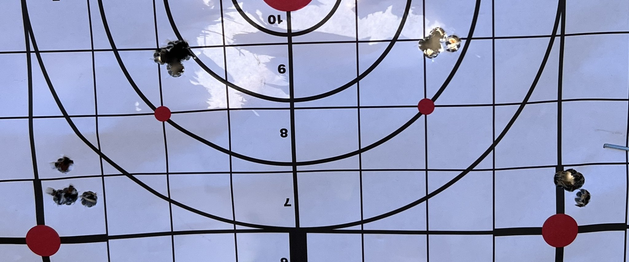

Anyone tried the Barns 145 Match Burners?
Yes, see picture.
I picked up two new boxes cheap and broke in a new barrel with them and was pleasantly surprised - I took 150 rounds in a new barrel and new brass with 39.0 grains of H4350 and COAL of 2.810 out to the range last week. This setup got me about 2700 fps with SD of 10 and some really small groups. ( New Lapua brass was 4/1000 under the same brass once fired from the test. Brux 8T @ 26 inches.)
I had several very small 5 shot groups and overall .8 mil dispersion from the 45 shot in 9 separate consecutive groups at at 100 yards. Once I was DOPEed, I was able to hit 1 moa plates at 500 yards in a heavy crosswind 19 out of 20 times. I also did build and breaks on a .4 mil plate at 450 yards and had good elevation every shot.
I don’t have my exact DOPE in front of me as I type this, so no BC calculated, but my hold was around 5.9 at 790 yards with the zero shown in the picture attached.
I shot some good loads from classic hunters 135 and A-Tips 135 at the end on paper to validate them and the Barnes shot better for me.
I have two new barrels coming and will repeat this with ATIPS 135s, Berger 144s and the Barnes 145s. And will run a test out as far as I can once I get a calm day.
Yes, see picture.
What powder were these shot with?
Barnes 145 elevation was 6.1 at 800 yard at 2666 fps in new brass. AB custom curve was right on. Just a tad higher than Berger 144s at same MV.
At 100 yard Berger groups were a single ragged hole with Barnes having a larger but uniform group with a flier every 15th round. On the 800 yard .5 mil plate Barnes were all over the plate with one high and one off plate with Bergers clustered together and no misses.
That 19" rig is doing 2700 fps with that load. Have a bunch of 130 vld but waiting till I run out of 135 classics at this point to try them. Varget seems to be very nice with this load.
At my 5200 feet elevation, it is still doing 1877 fps at 700. And I tend to hunt bears at 9000 ft elevation so even better up there.
