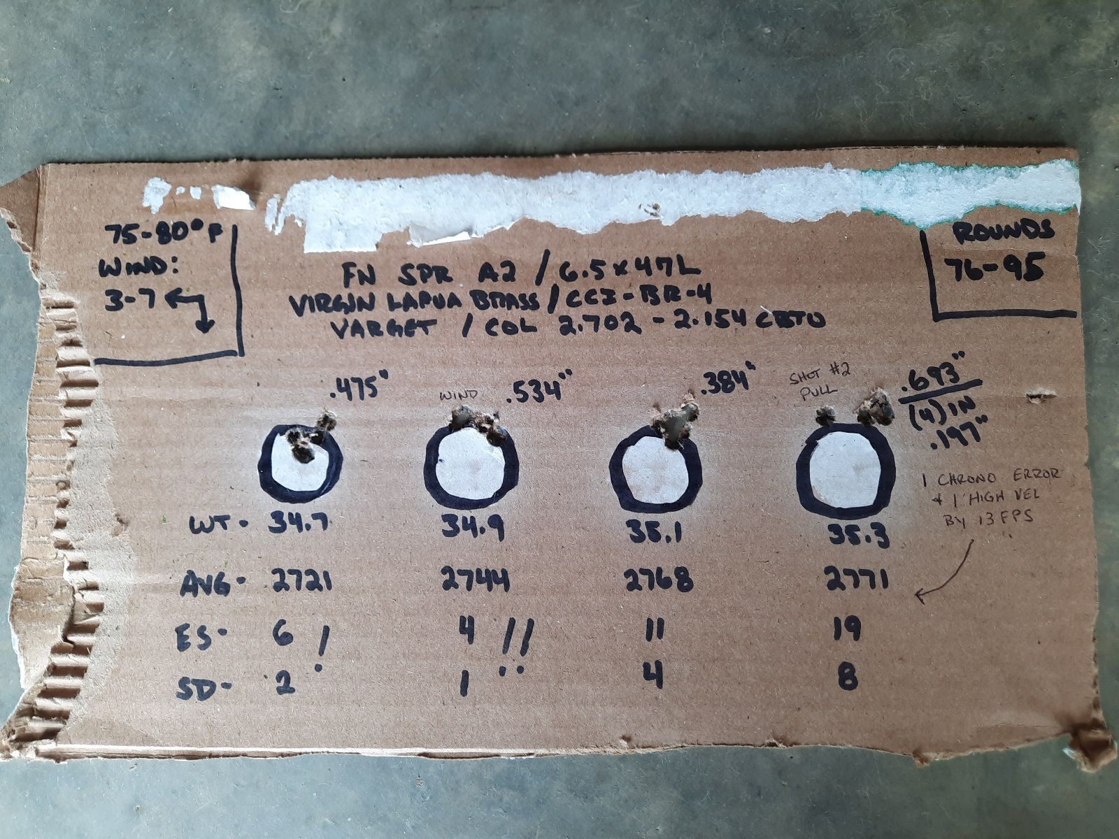

Real mild load of Varget under the 123gr Scenar. ES and SD were excellent across the board, but I have a feeling that at 35.3 I'm starting to run out of that node. This was a narrowing down load, as I had already put a couple .3 - 4s down with 35.0 and 35.3.
I know the velocity hounds are going to pick on me, but this is a fun rifle, not a comp rig. As I got over 36gr, the groups started to open up, and I never pushed it hard enough to see them come back down.
I'm playing around with Norma Golden Target 130gr right now. Definitely more finicky, but the potential is there. Will be doing some narrowing down and confirmation again as soon as possible. The below Target is five shots over H4350, 2.100 CBTO, CCI BR4.

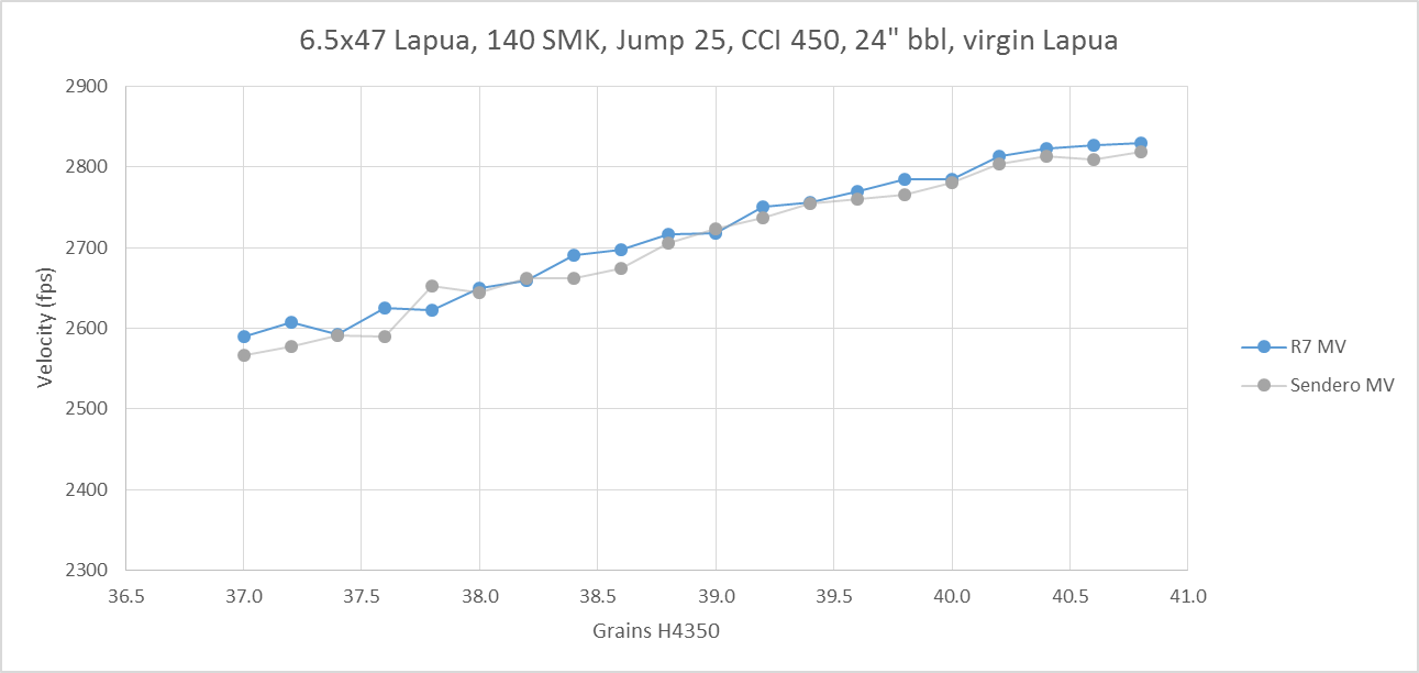

Two different rifles, one a sporter profile, the other a Sendero profile, both chambered in 6.5x47 Lapua.
Test of H4350, virgin Lapua brass, CCI 450 primer. Sierra 140 Match Kings at jump 0.025"
At 6400 feet, baro 29.7", 45 - 50 deg F, 36% RH.
Compression begins at around 40.5 grains, and 41.0 interferes with seating depth.

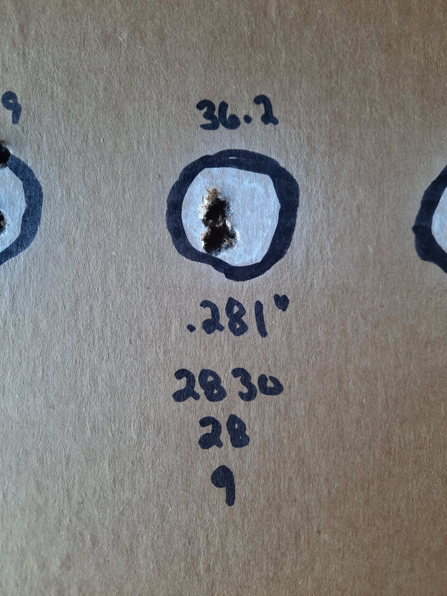

Tested some Reloader 15 behind the 123gr Scenar in 99 degree weather this afternoon. Shit it was hot and humid out.
123gr Scenar
Virgin Lapua brass
CCI BR4
2.705 COL/2.162 CBTO
35.0 - 36.2 Re-15
This isn't a comp gun, it is a fun rifle. I'm perfectly happy to sacrifice velocity for barrel life. That being said; ES and SD didn't knock my socks off today. It will probably tighten up as I get higher in the charge weights.
Groups followed the trend of this 26" Krieger barrel: usually in the .4 - .8 range until it throws an awful 1+ MOA group (the famous "scatter node") right before coming back to something good. This was no different. 35.9gr threw an ugly 1.1" group, but then 36.2 threw a .281". That was the highest charge tested for today.
Velocity specs are in the photo.
That is the third time I've shot a 1+ MOA group, and then followed it up with something in the .2s. So far the trend for this barrel has been to keep 3/8 or better accuracy for a half grain of powder...well see as I test this load a bit further later on.

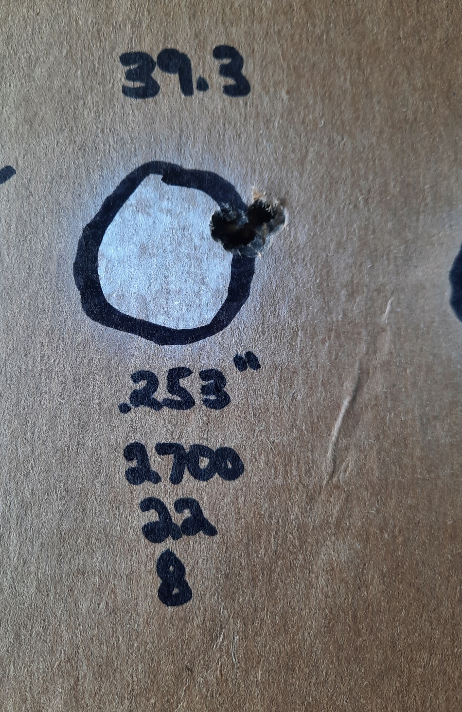

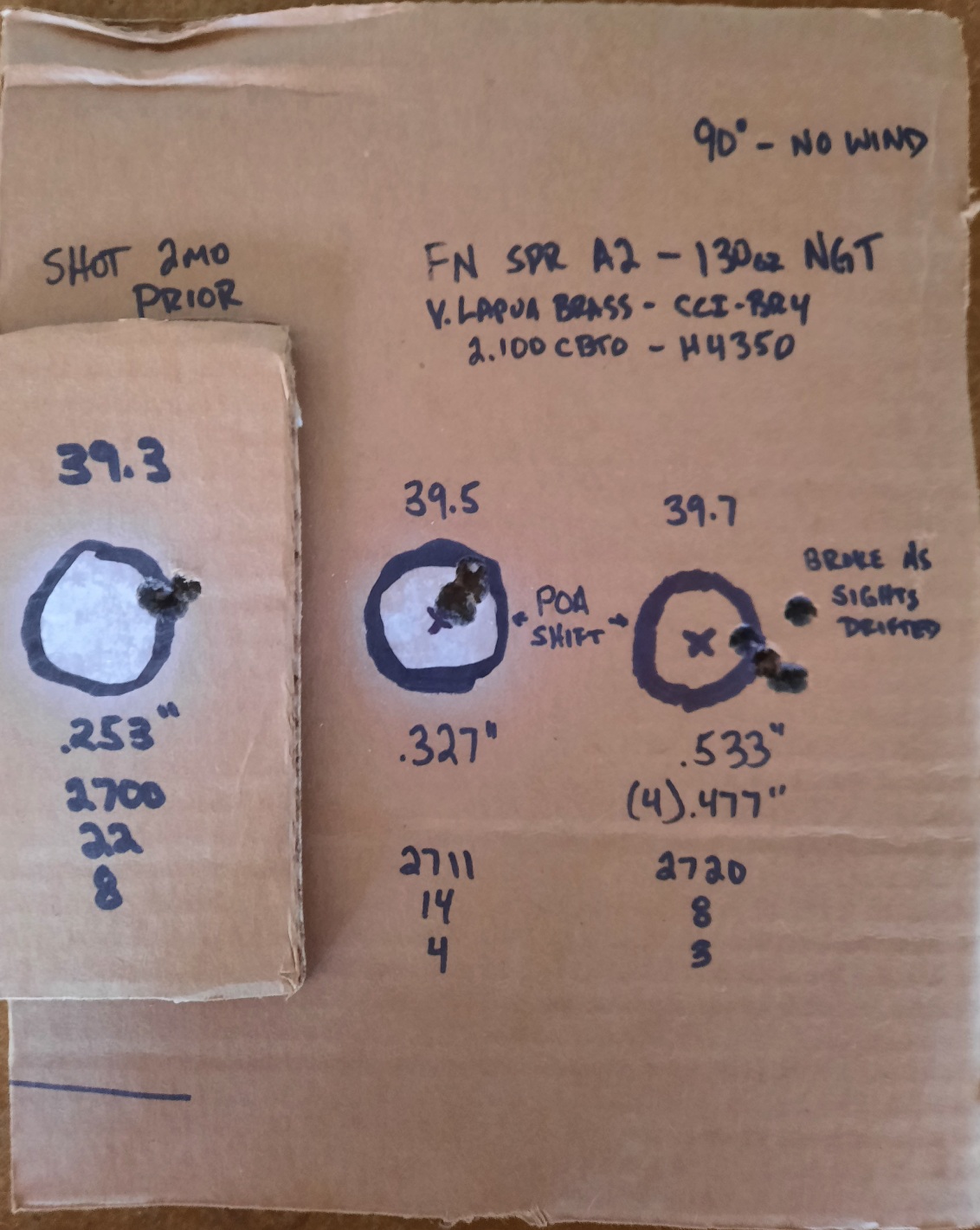

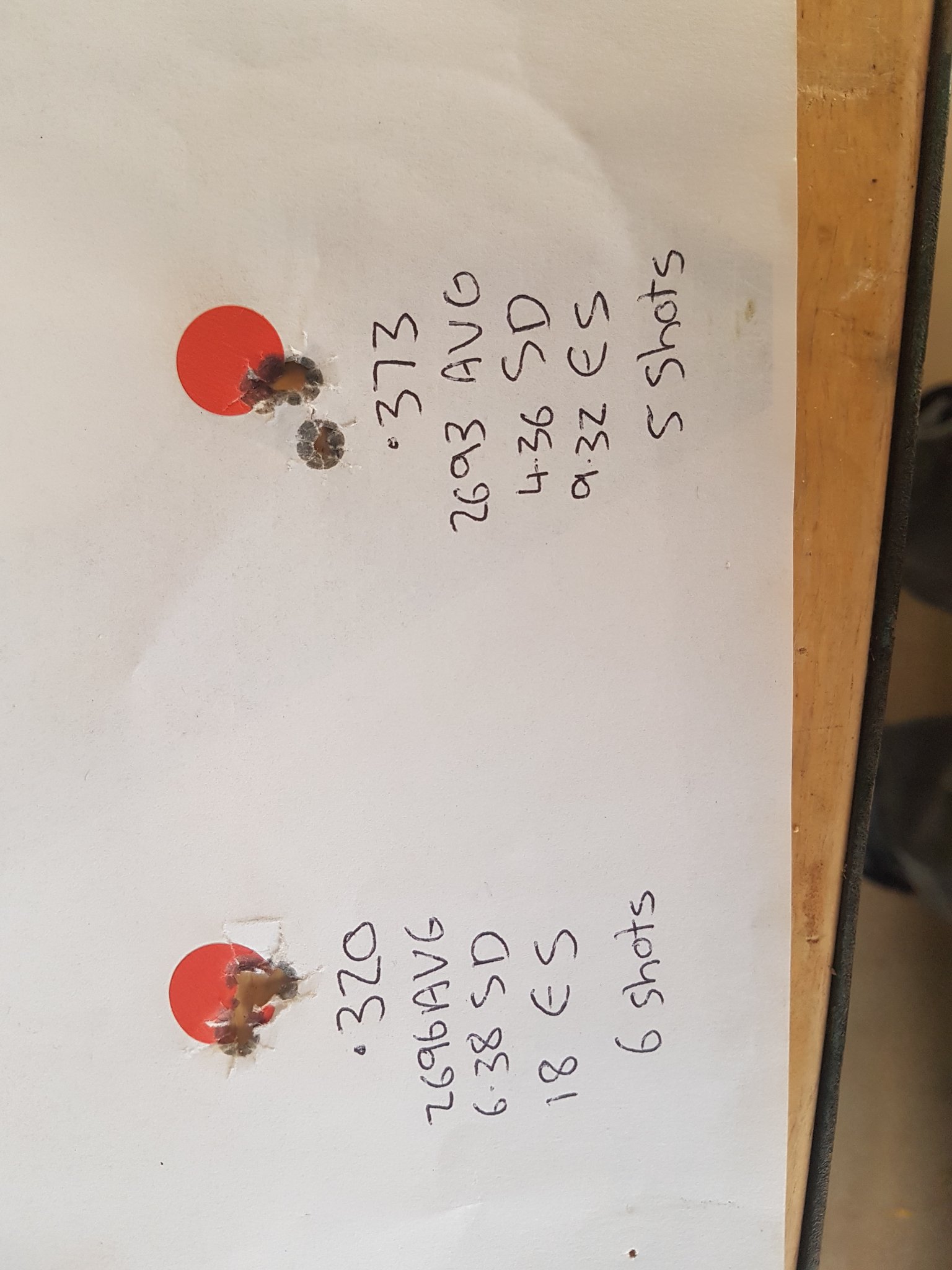

Played around today, trying to verify some loads (5-shot groups). Long story short, I had a bit of an equipment issue that took me a few groups to diagnose. However I did get to test a little higher up on the charge weights with the 130gr Norma Golden Target bullets and H4350.
Below is a composite of my last group from two months ago (cut and glued on the left) with my last two groups on the right.
Please excuse the "POA shift" written in the middle of the target...I meant to write "POI"...the things you notice when you review your handiwork.
Edited to add; I've had this rifle rebarreled with a 26" Krieger, M40 contour, 1:8tw by Matt Stewart of Stewart Rifles. He's put together a heck of a shooter for me.
