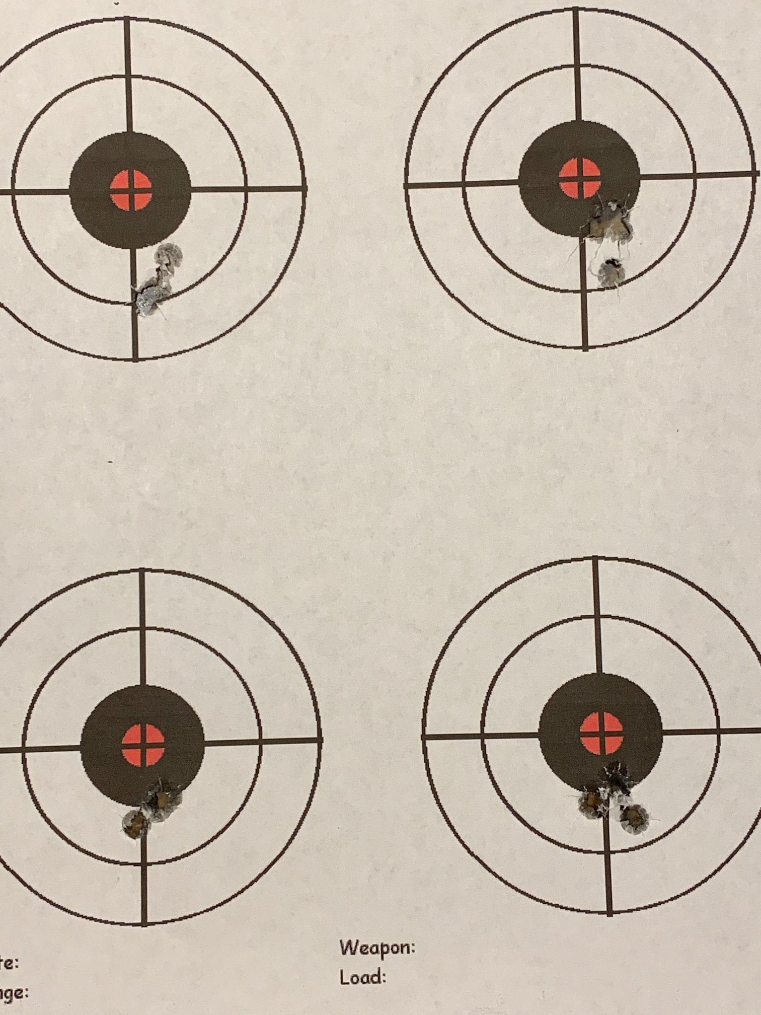

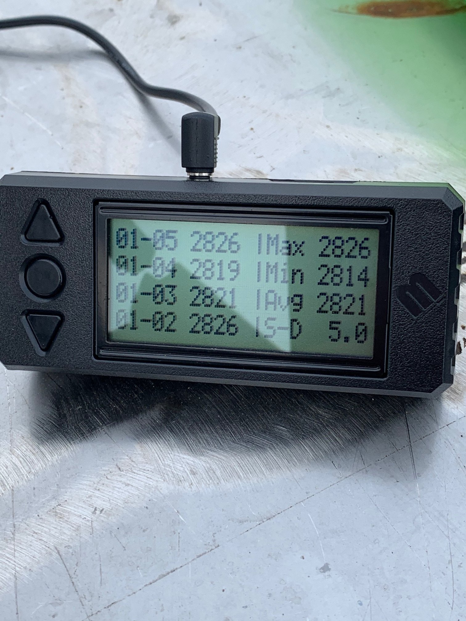

I've been working with Berger 144 Hybrid LRs for the past few weeks and have a load that has gone from all touching to collapsing onto each other:
Lapua cases
CCI 450
41.4gr RL17
2.800" COAL
2.124" CBTO
Neck tension from 0.2625" mandrel
2890fps out of 26" barrel
Lapua cases
CCI 450
41.4gr RL17
2.800" COAL
2.124" CBTO
