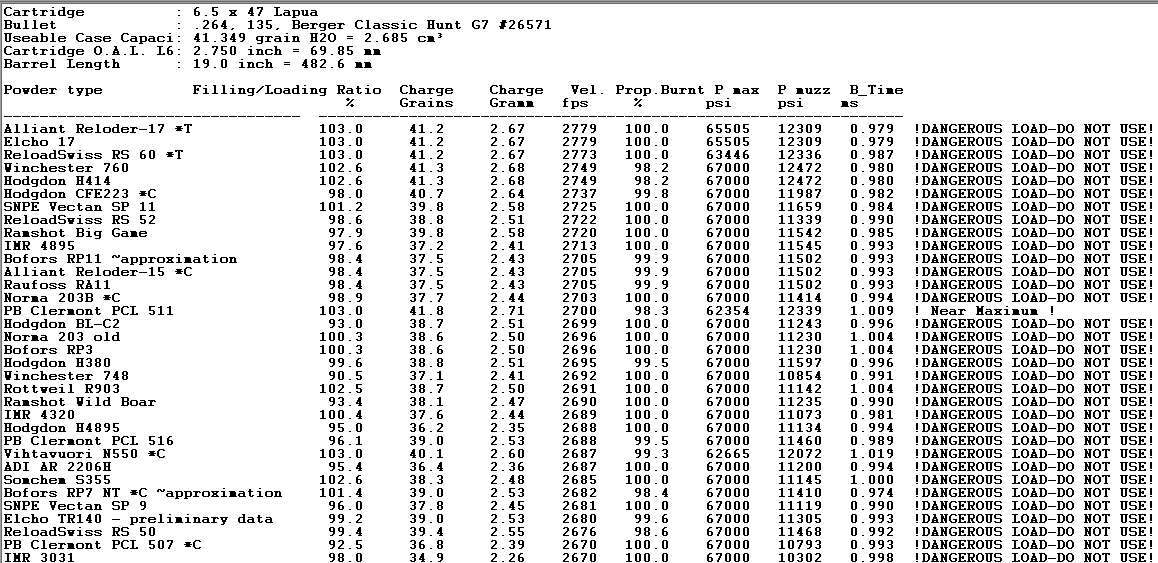

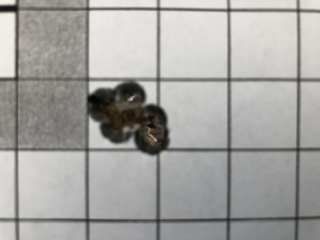

Looks like 2700 FPS is about tops for 19” barrel with the 135 in my rig. 37.7 grains of Varget. Testing for groups next.
Cool. Im curious for your real world results so this will be good.That would be great. I'm hitting lands at 2.75 oal with the 135 Berger. Using CCi 450 primers. Would love any info you could share. Thank you

I just loaded another ladder from 35. To 36.1. Gonna slowly work up to pressure. I have some slightly flattened primers but nothing jumping out at meMy 144 hybrid testing so far was only a few rounds at 37.3g of Varget. I am going to run it up a bit more and see here the speeds level out.

Just tried rl-17 last weekend to replace varget. Results were ok in the morning, but by afternoon primers became an issue. Didn't blow any but definitely high pressure marks and primers backing out of case.just my experienceGlad its not showing higher than 69Kpsi. RL17 may be worth a look too but man the accuracy is there with varget. Now to find more of it.
Small or large primer?The Peterson brass is really nice..... Im local to them and was able to get 500 6.5x47, 6mm CM, and 6x47. All seems to hold pressure better than the lapua. It is all really uniform as well. Great so far. Was running the 150 SMK in a 6.5x47 to try out. 37.5 varget @ 2760 with not even a flatten primer. Impressed as I thought its pretty heavy for a X47 but sub 1/2 moa at 500 and 1k !!
