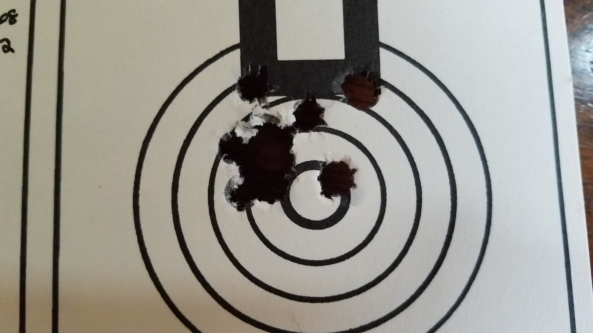

I got out and finished with the last ladder I had today with a new battery in the MS.
It appears that AR-COMP is the powder I have been looking for to use with the 123CC.
It showed the least amount of vertical spread through the charge range even though it was the fastest burn rate but had acceptable accuracy so will give this one more attention.

nice job with the AR comp and 123CC's! Whats the charge weight in the pic? I'm about to load 150-200 rounds with AR Comp and 123CC's virgin brass and new barrel so I can have once fired brass and start load development with 130s/140s hybrids and Varget. I typically use the 123CCs/AR Comp for practice and plinking for my 6.5x47/260 barrels since I have plenty of AR-Comp and got 2k 123CCs and a really good deal. On my last 6.5x47 barrel I tried 35gr AR-Comp/123CCs and got 2847FPS ES18 SD6 out of 20rounds and grouped 3/4". Good enough for my purpose but after looking at that pic maybe I should revisit this combo
Reactions: XLR308
The pic is the group from the 10 shot ladder and the reason I was thinking AR-COMP would be my preferred powder with the 123CC since it showed the least amount of vertical dispersion through all of the charge weights.
Honestly I was kind of expecting to see some pressure signs with AR-COMP considering it's faster burn rate but it has surprised me before with excellent results in other calibers such as the 68spc that there wasn't any data to be found with it.
Every other powder I have tried with them ( Varget, AA4064, H100V ) had atleast double that.
