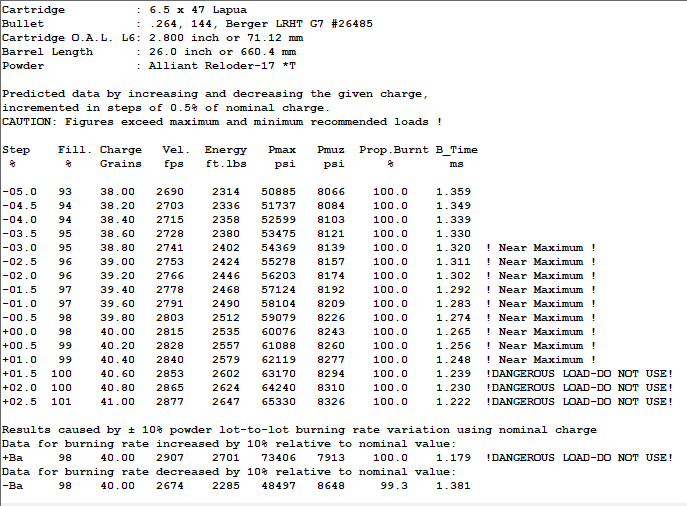

Some QL predictions for reference
Reactions: RegionRat
Thanks for that. I don’t have QL, it’s cool to see the charges and pressure predictions. I suspect I’m getting close to the end of my barrel life with around 2700 rounds so I’m burning through some old 140 ELD’s using 38.5 grains of RL17 with what’s left of it. Its still surprisingly accurate at around 2750 with a 24” barrel.

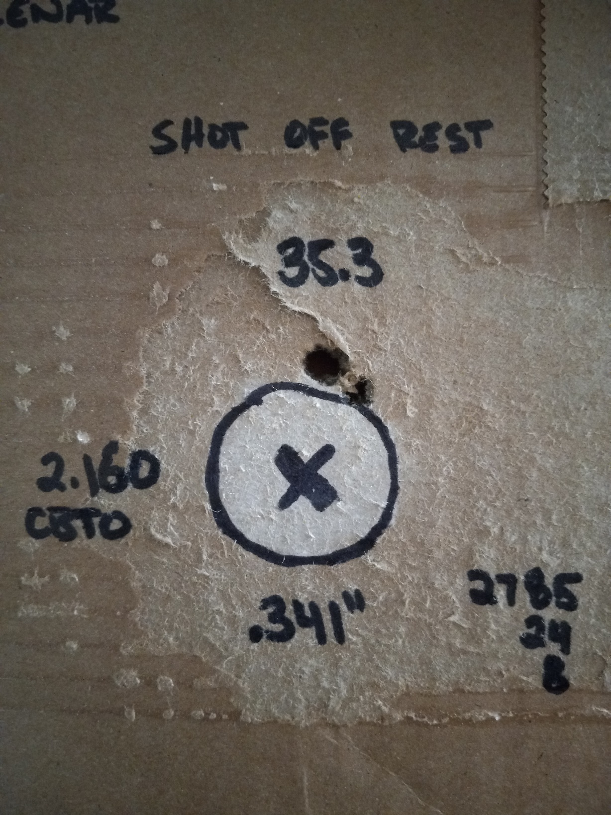

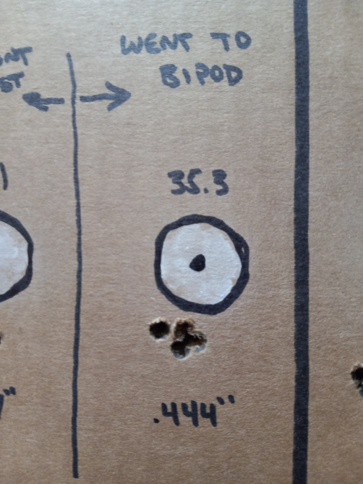

Went from virgin to once fired brass. Obviously I have a small flaw in my annealing or resizing process because my ES and SD have doubled now (now 24 & 8 vs. ~ 12 & 5). Guess I'll have to start fiddling with crap.
Average velocity though is less than 5 FPS from what it was.
35.3gr Varget is the happiest spot in the low node at 2,785.
First group was shot off a bipod under 3-7 MPH full value winds yesterday. Confirmation group was shot in almost zero wind off of a front rest today. I couldn't pass up a chance to shoot in almost zero wind.
Please excuse my poor man's targets.
*** 123gr Scenar, Lapua brass, CCI Br4, and Varget at 2.160 CBTO.
Rifle is an FN SPR A2 with 26" Krieger spun on it by Matt Stewart.***

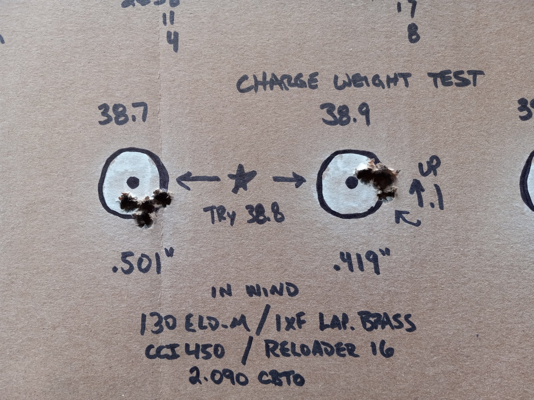

130 ELD-M and Reloader 16 test today. Did not use my chronograph until the last few shots, but when I tested seating depth I was in the single digit SDs (at top of photo). Velocity was 2706 @ 39.1gr...so pretty slow in the window that gave me the best accuracy.
Winds were up today. No excuse, but I bet it would be tighter on a calm day (that's what she said).
26" Brux, 1:8, M24
26" Brux, 1:8, M24

You are absolutely correct. I wasn't getting any pressure at 39.3 with the 130s (2726 FPS when I shot it over the chronograph), and this particular FN bolt really craters primers. I'm definitely getting it bushed with the next rebarrel regardless if I stay with 6.5x47 or not.
This Brux is almost exactly 30 FPS slower than my Krieger on my other 6.5x47 too. Both are 26" in length, 1:8.
^ I was just comparing notes, and my best load for that Krieger barreled rifle is also 38.9gr of Reloder 16, but under a 130gr Berger AR OTM. Velocity is 2710.
Reactions: Guns&WhiteWater
^ I split the difference of these two loads, and went 38.8gr. Loaded five to shoot at a little bit of distance to see how it would hold. Shot 1.45" at 300 this afternoon. Not far enough to prove a whole lot, but the results are kind of where I was expecting/hoping to be.
Now I'll fine tune seating depth to see where I can load out to. With my chamber, 2.090 is .020 off.
I'm content with this as a mid-range load. I developed it mostly for shooting coyotes and packs of feral "coyotes" out to 400 or so. I'm overrun out here.
^^^ Same rifle, same target, same distance at 300, next day. Five shots again too (head), but this is with the 120gr Scenar-L load that I posted a month or two about above.
I know it's going to make me sound like even more of a dork; but the one lower impact broke while my crosshairs were low.
Apparently the 120gr Scenar-L load and 130gr ELD-M load are within a tenth mil of each other at 100 and as well as 300 yards too. I know that it won't track like that out at distance, but at closer ranges it's cool to not have to adjust zero or DOPE.
I'm also enjoying that these groups both include the CBS.
120gr Scenar-L: 36.0gr N150, CCI BR-4, 2.115 CBTO.
130gr ELD-M: 38.8gr Reloader 16, CCI 450, 2.090 CBTO.

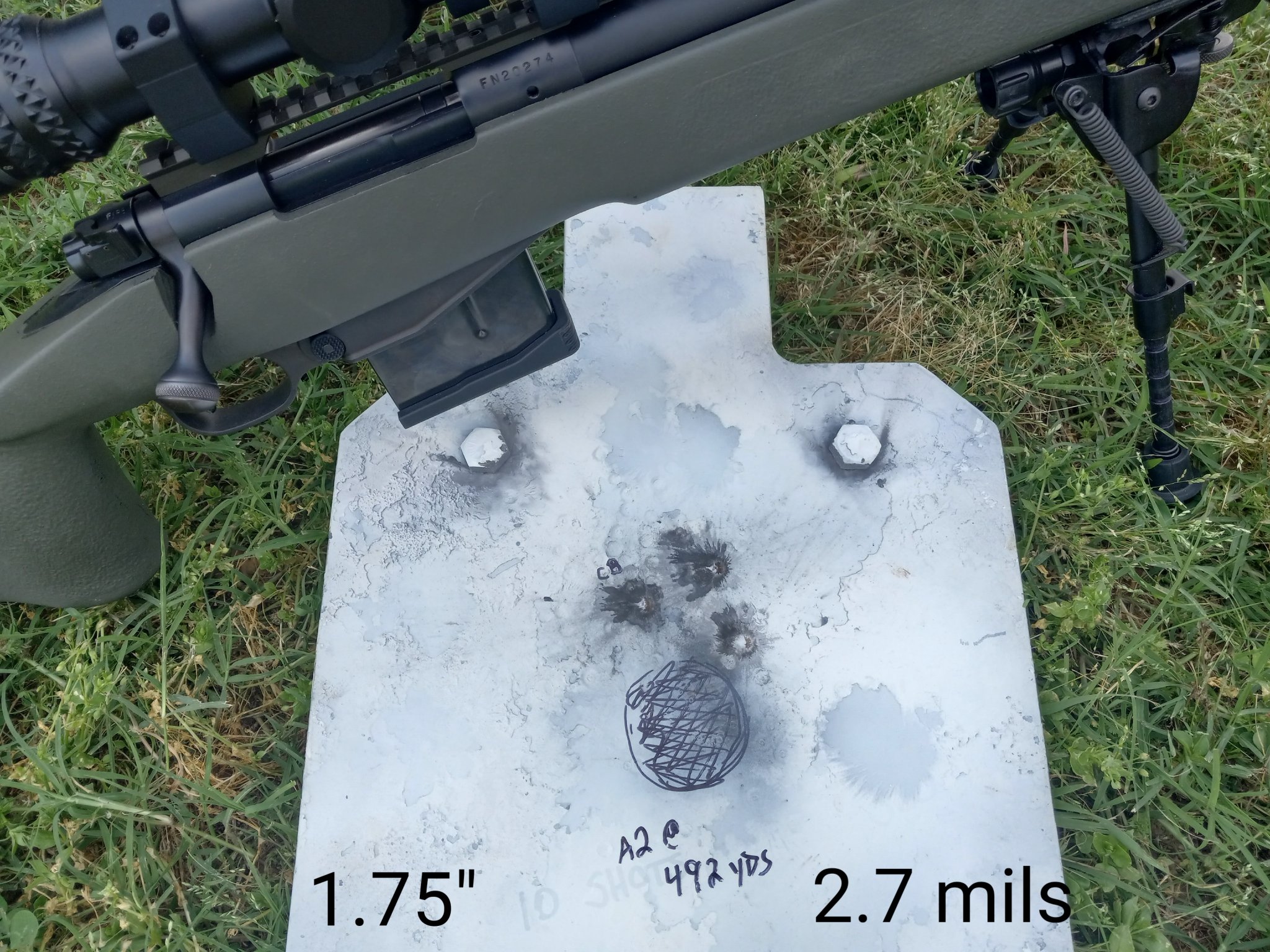

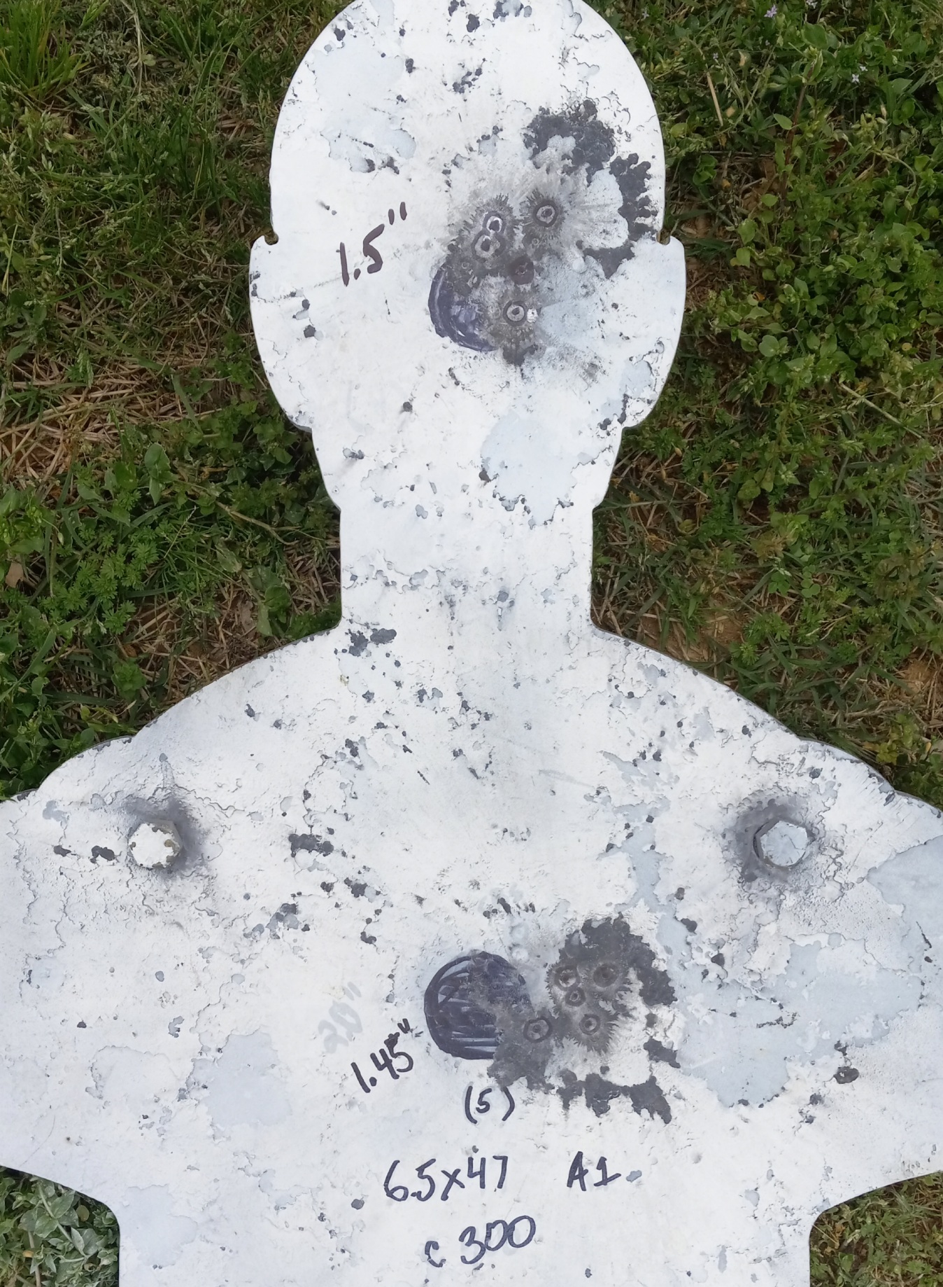

123gr Scenar, 35.3gr Varget, CCI BR-4, Lapua brass. 2782 FPS from a 26" Krieger. I've gone a full grain and ~80 FPS faster, but this is where the accuracy is.
10 shots at 300 yards. Winds were real light, but switchy (2-3 MPH). I never changed my POA.
Like a frigging amateur, I splashed out my aiming spot by round #4, and I did manage to drop one low-right. Without that one, the other 9 were in about 1.7". It ended up at 2.1" though including the momentary concentration loss.
Just before this, I'd shot 5 into another .4 at 100 yards on paper. I was burning up my last loads after having the rifle apart, and wanted to make sure my zero was still good.
Mrs. Diggler1833 came out and shot the last 3 rounds on my coyote target at 300. Her group measured about 1-1/4". She was happy and didn't want to hear about the Hornady guys saying that her group sample was too small.
I'll try it again on another afternoon when the winds are calm (will probably take another month for that). I'll be sure to add or subtract a few tenths to keep from washing out the aim point again.

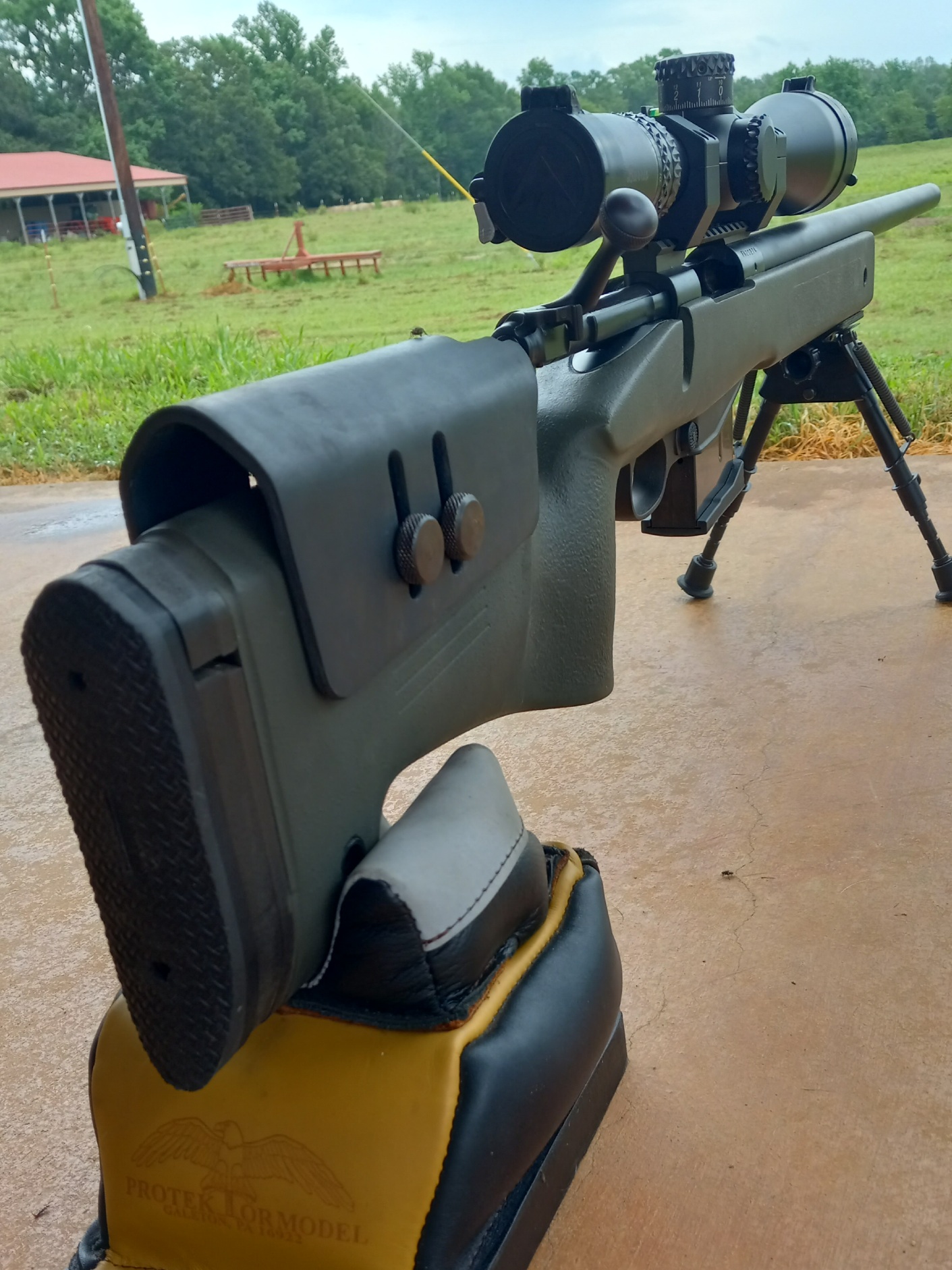

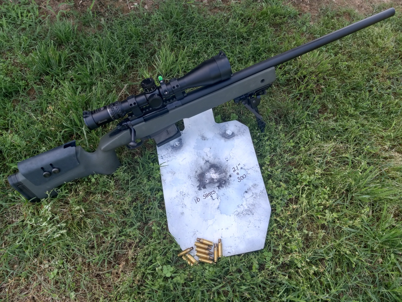

Broke out one of my 6.5x47s today to celebrate a bit early since we just had a rainstorm come through.

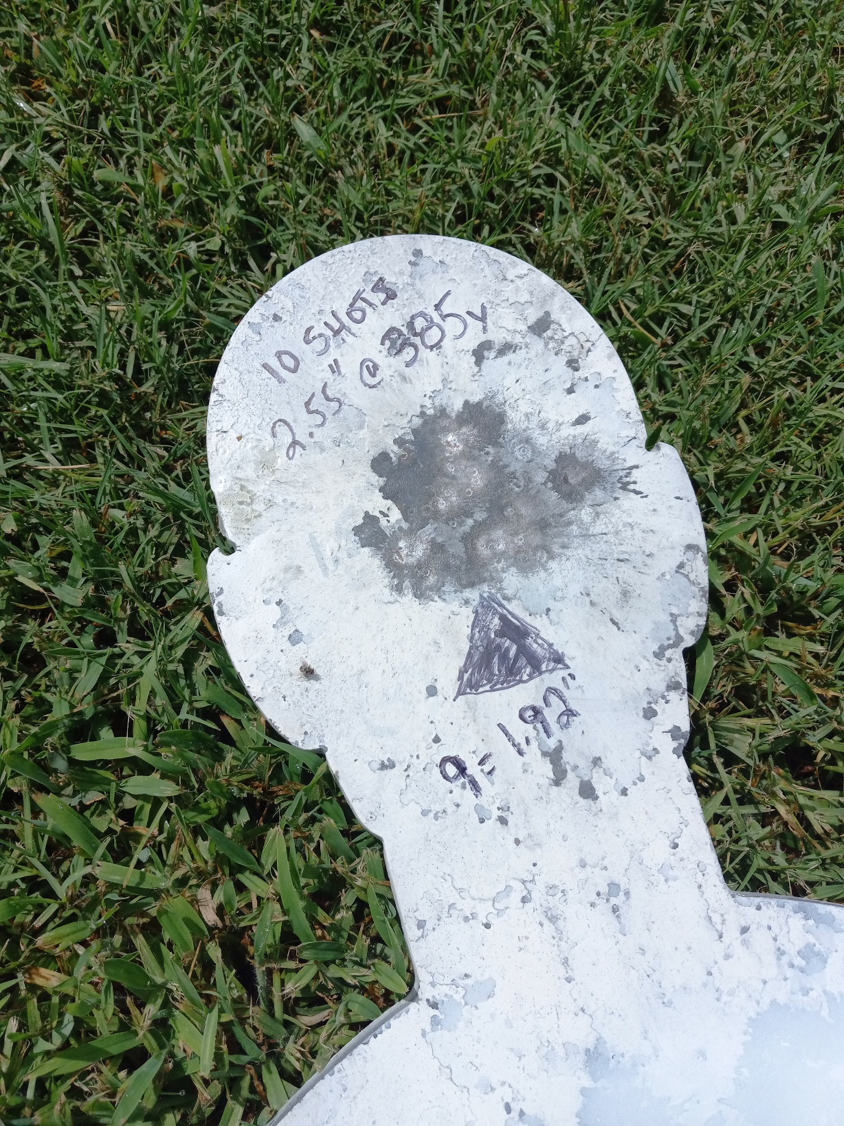

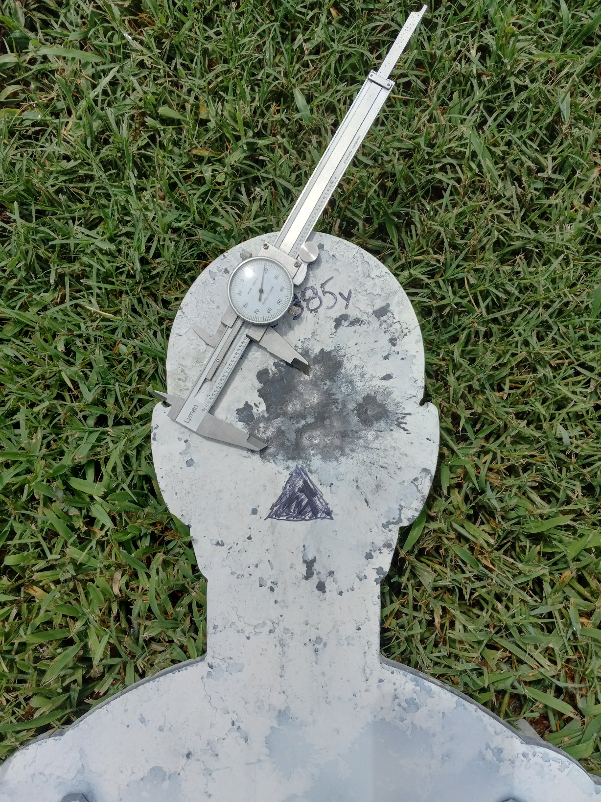

Tried truing up my data a few days ago, but could only shoot to 492 because the grass (seed stems) were too high to shoot further. Working with Hornady and JBMs calculations, I'm closer to about 2815-2820 FPS if I don't play with the ballistic coefficient. It might bite me in the ass later when I go further, but it works for now at all ranges out to 500.
Since three shot groups don't count, today I shot a 10-shot string off my back porch at 385 just as the rain cleared...it's as far as I can shoot from here in a safe direction.
I added .1 to my elevation this time to keep from splashing out my POA. Wind was a bit switchcy, but was only 2-3 MPH.
Minus the wind call I blew on shot #3, I managed 9 into 1.92" / (.48 MOA)...However with my drifted shot it came to 2.55" / (.63 MOA). My vertical is more than I'd like, but if I can keep it to less than a half minute, I'll be fine to the distances I'm limited to out here on the ranch.
The cold bore is in that group somewhere too, just like it is in the first pic at 492.

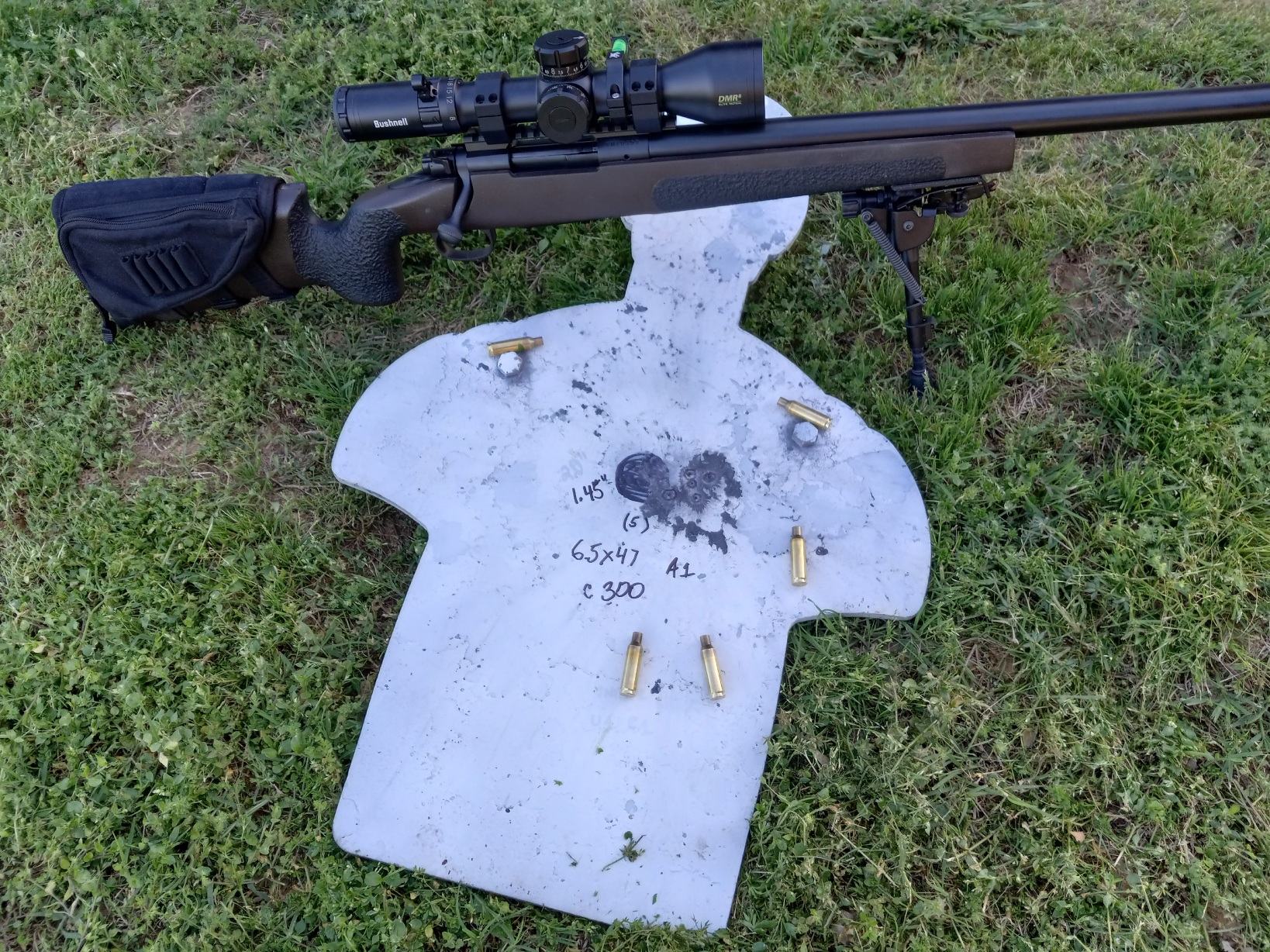

123gr Scenar
1xF Lapua brass
35.3gr Varget
CCI BR-4
2.165 CBTO
FN SPR with a 26" Krieger.

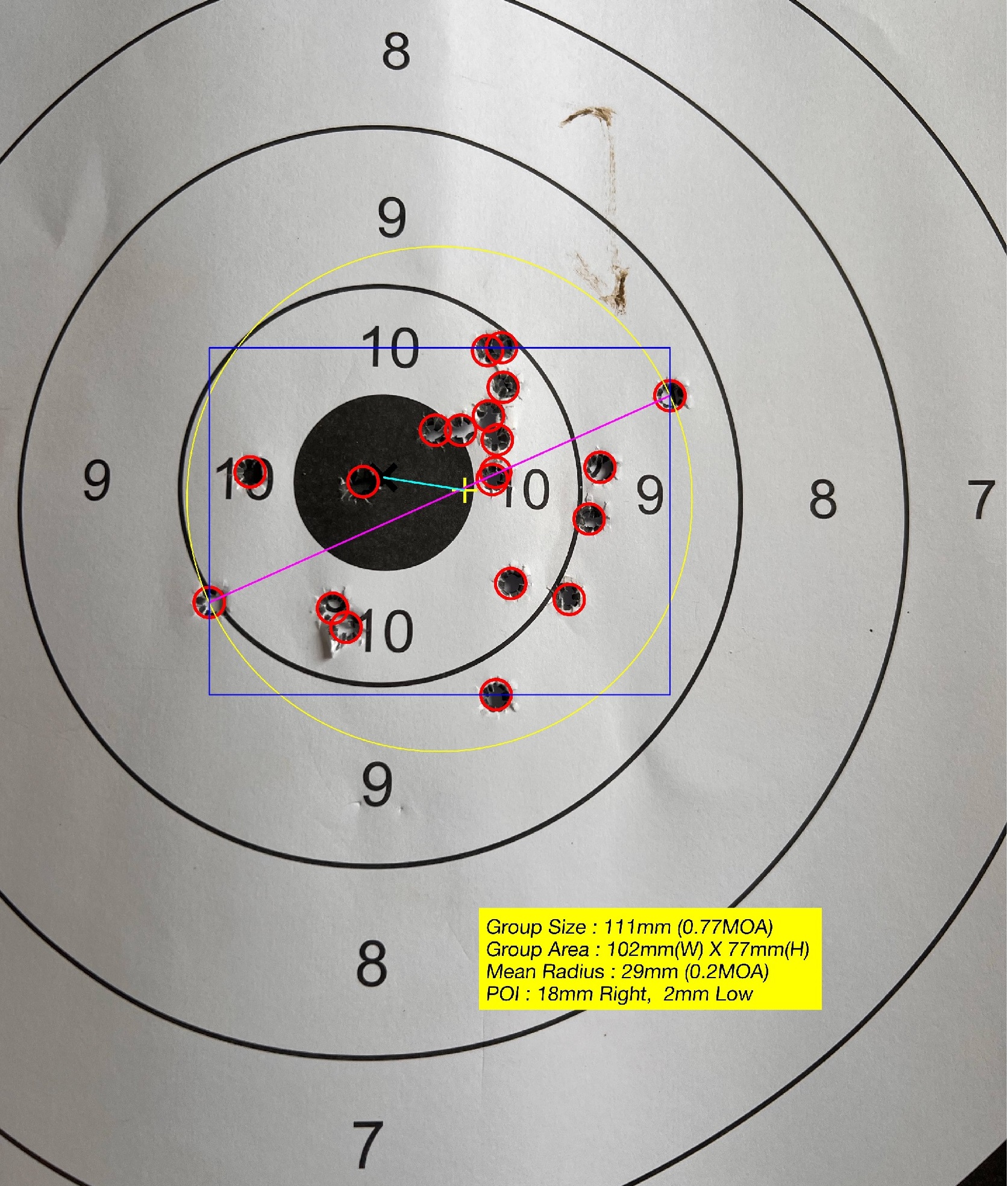

500 meters (547 yards) Nationals mid June, 20 shots. Prep and match are 25 mins (7 test shots on different target and 20 for match).
Previous day was raining a lot, and on match day it was cloudy. Just before my squad was to start the match, sky cleared and sun started to shine. You cant imagine the mirage we had, I even forgot to adjust the parallax, and a spotter barely called the shots.
I did all the prep and shot all 27 shots under 16 minutes.
Sabatti TLD 28" MMR, RGM custom trigger, Vortex Golden Eagle
39.5 gn N550, CCI450, Lapua AGS flame annealed brass, 140gn ELDM 2.811" OAL, Joypod-X
X is 1.5", 10 ring is 3.5"

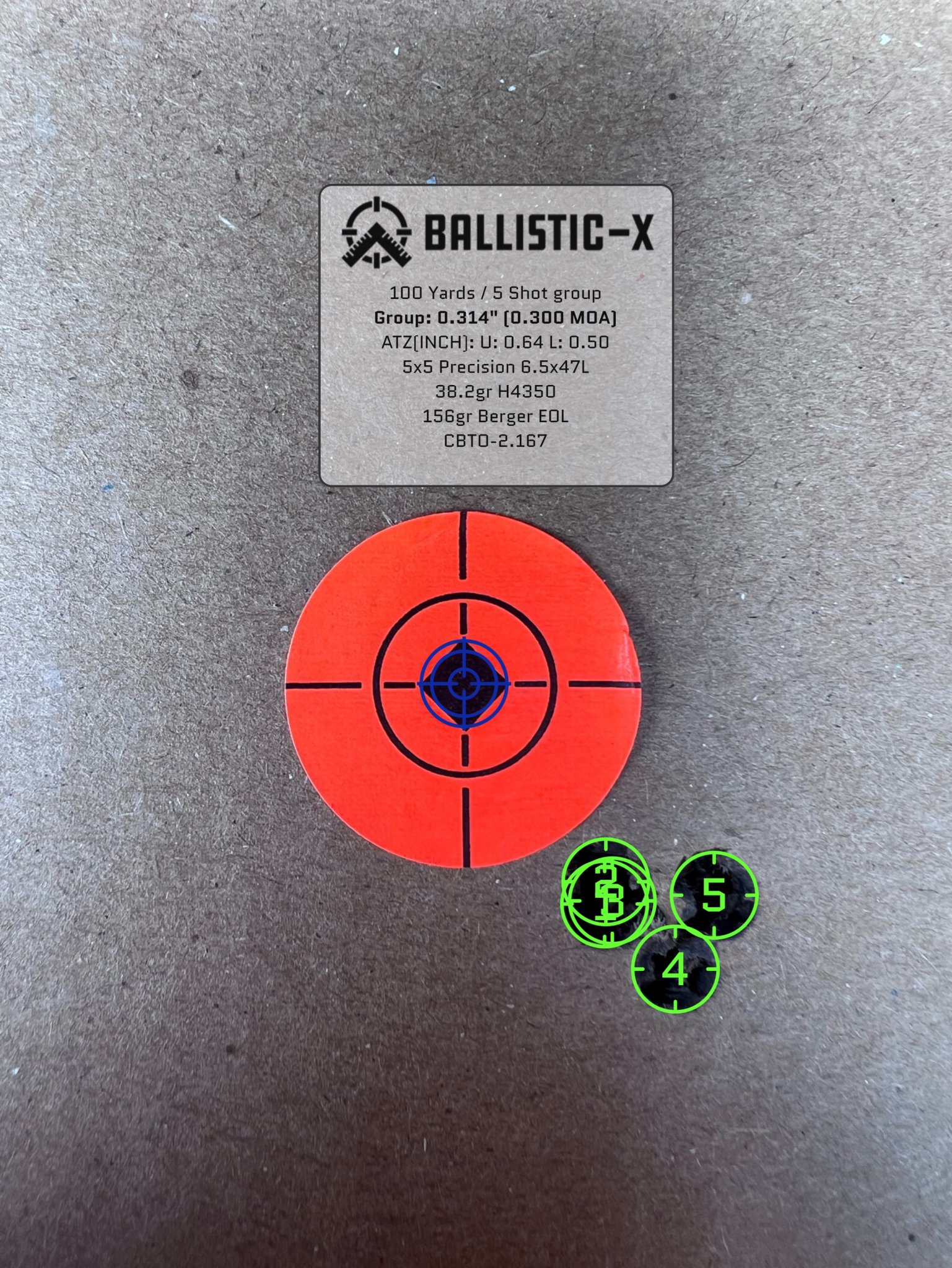

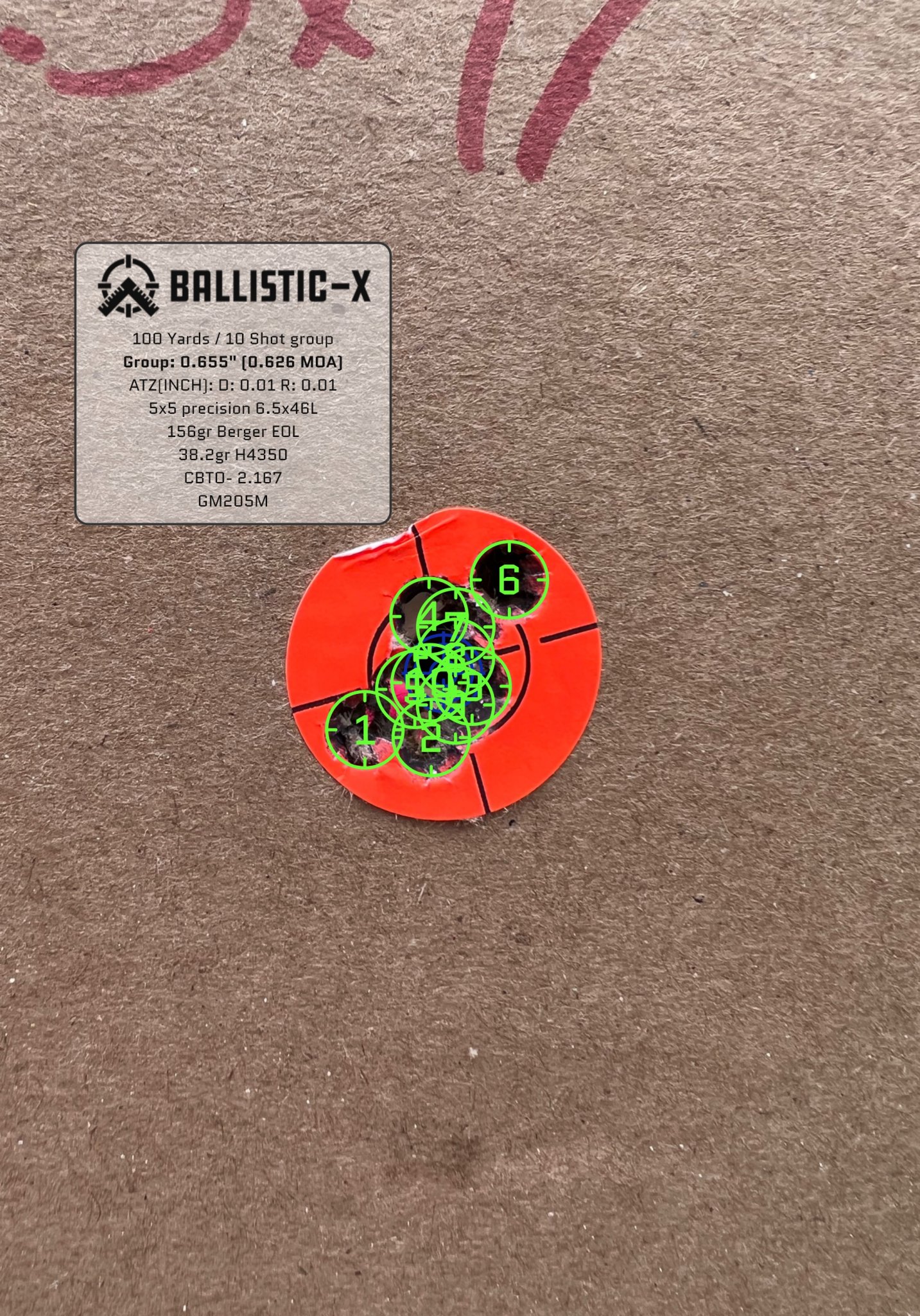

Fast 5 and 10 shot group yesterday to check velocity and zero.
5x5 precision 6.5x47 with 28" Bartlein
38.2gr h4350
Berger 156gr
CBTO-2.167
2650fps

I'm using 7.5t. Not sure on exact freebore but it was cut for 144s but I decided to go with 156s
