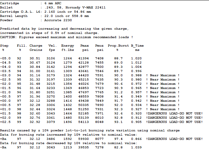

    Went ahead and broke in my 25CM barrel but freaking amateur hour. Guess I’ll find out next time. Gonna start at 31.0 A2230 and move up hopefully.
    84F 56% 29.88 in
    Seekins 6 ARC Shaw 18” SS 1:7.5
    Magnetospeed V3
    Hornady 58 gr VMAX
    A2230
    Hornady brass x 5 (several primers fell out prior to shooting due to loose pockets)
    205M
    BTO 1.6650
    COL 1.4900
    31.0 3335, 3339, 3332, 3317 SD 9.6 1” no pressure
    31.3 3393, 3377, 3413, 3389, 3408 SD 14.5 0.8” (4 0.5”) no pressure
    31.6 3416, 3431, 3416 SD 8.6 0.8” no pressure
    31.9 3444, 3426, 3412 SD 16.0 1.25” no pressure
    32.2 3468, 3466, 3474, 3476 SD 4.6 0.5” x 3 no pressure
    32.5 3507, 3506, 3497, 3506 SD 4.6 1” mild pressure ring from extractor
