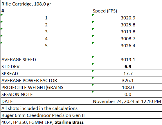

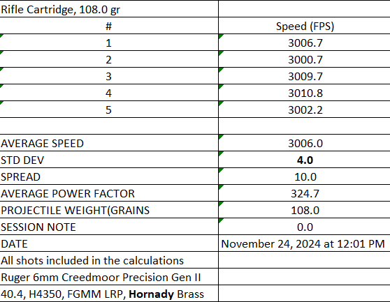

That's pretty mild for clickers. I've been running 109 eldm at lapua brass at 41.5gr H4350 2940fps and 45.6 rl26 3060fps from a 22" barrel, brass has 3-4 reloads, and never any clickers using the RCBS matchmaster die. I have a feeling the chamber may be a lil small. What's fired brass that give click measure at base?
I’m at .470 on the lapua once fired and I just did a test with alpha and I’m at .4680 still with zero clickers and no pressure signs.

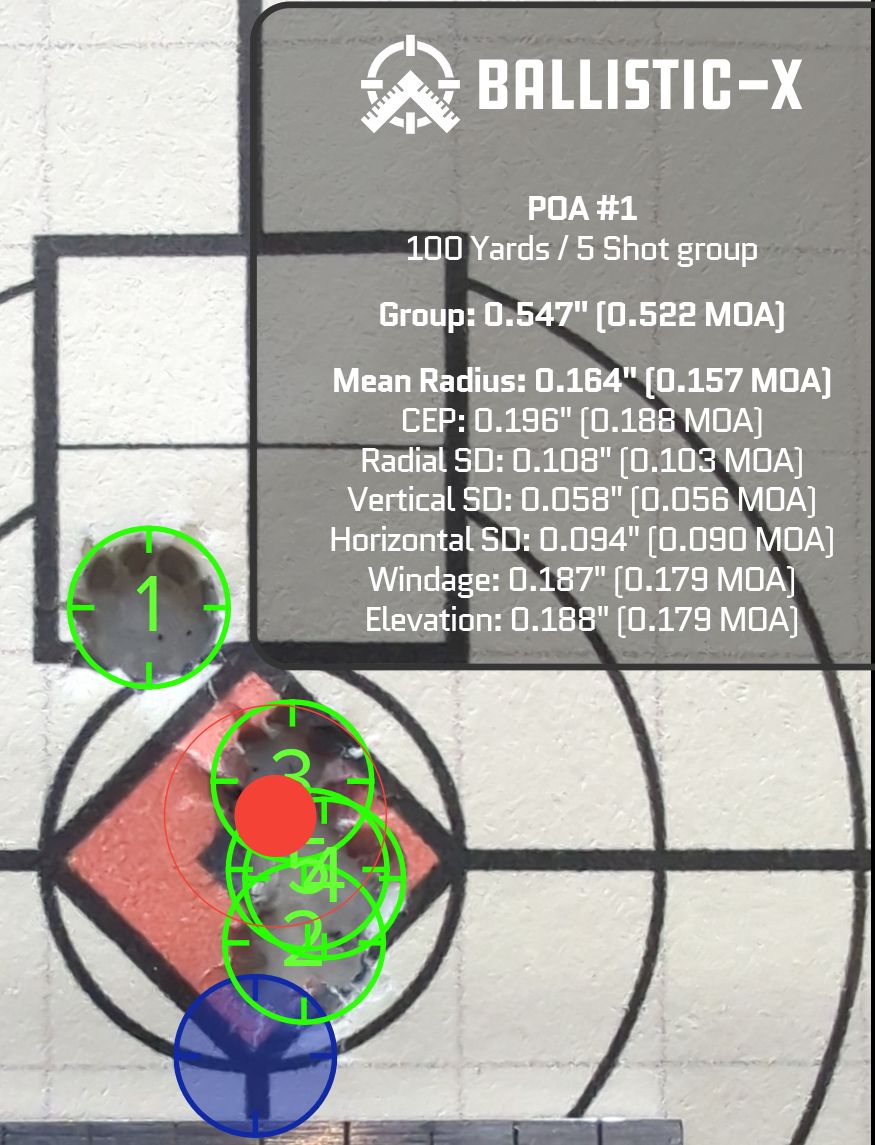

Fudds will tell you this won't work... the powder's too fast, the bullet's too heavy, not enough case fill... blah, blah, blah, blah...
These pics aren't particularly amazing or anything, but I hope they show that the fudds are mistaken.

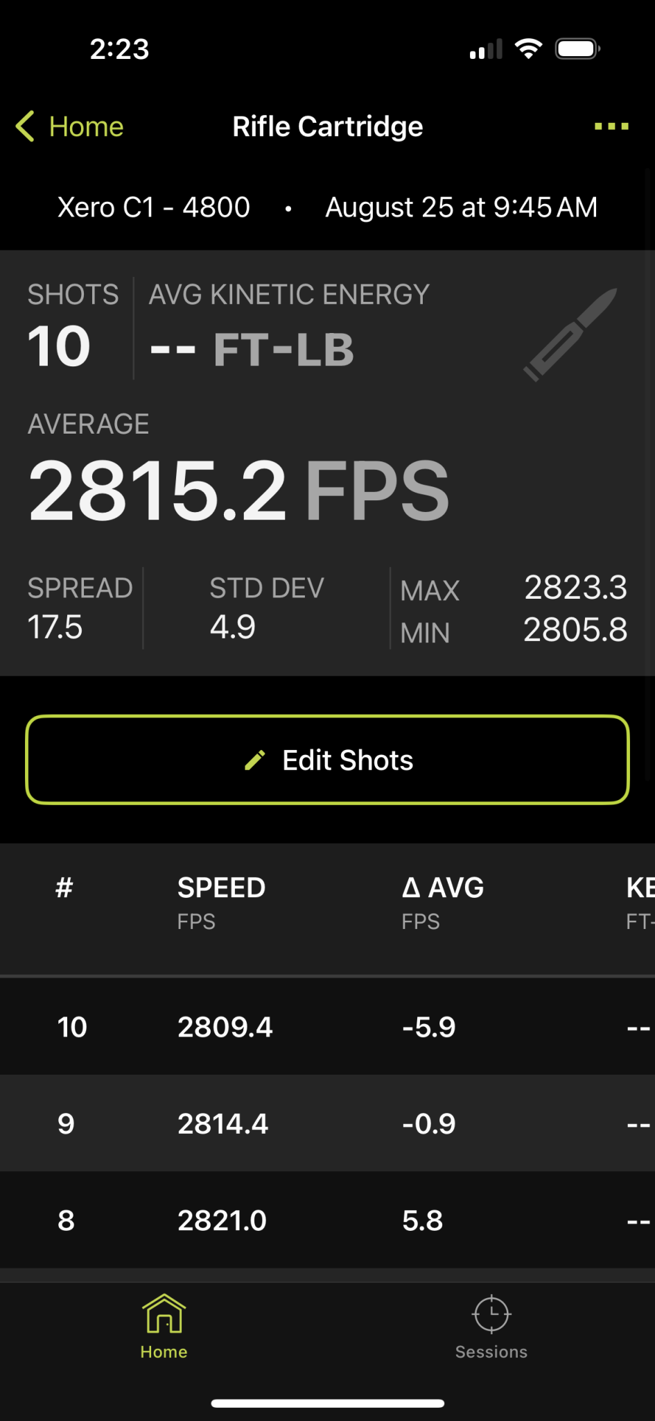

36gn Shooters World Precision Rifle
112gn Match Burner
Lapua ex-22-250 case
CCI 200
2.180" BTO
2815fps AVG @ 90degF, SD 4.9 ES 17.5 over 10 shots
26" Proof SS prefit
No signs of pressure at all, soft-shooting like a mild Dasher.
I didn't take a pic of my 100yrd group, but they were all touching.

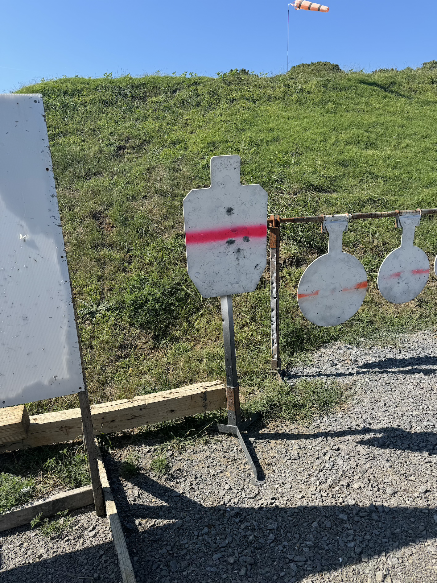

3 at 1000yds off a PRS skills stage barricade (kneeling, standing, kneeling, builds/breaks in between, didn't run a timer but >60secs):

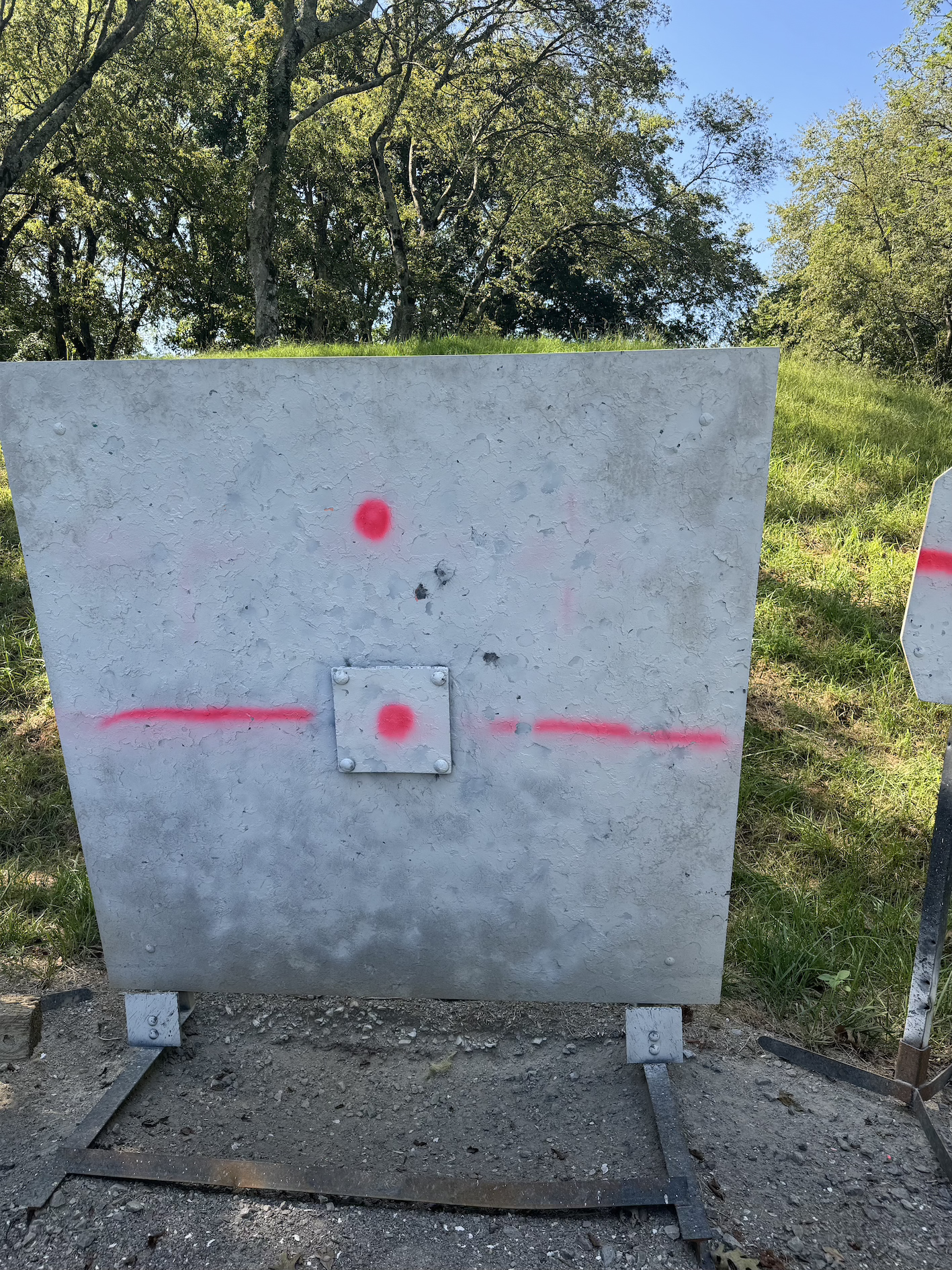

3 at 1250yrds off bag/tank-trap to see if the G7 I was using (.301 G7) was ok (it might be low or just parallax), for >$0.25 a pull these shitty MBs sure are as terrible as some say :rolleyes:, I hope no one buys them so they stay cheap. 😛
Edited to add: almost forgot... this barrel has 3000rds on it, these were somewhere between rounds 3001-3050.

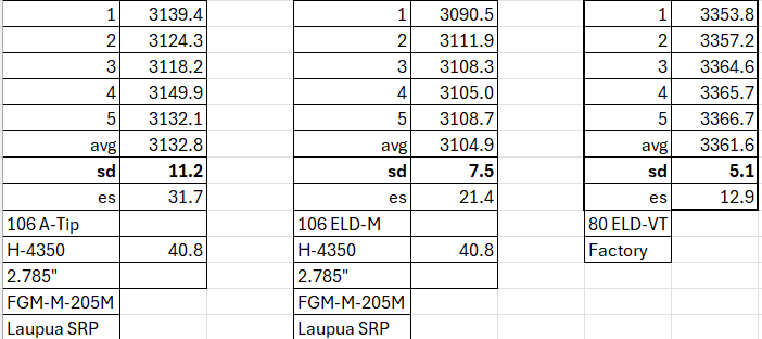

40.8 RL 16
110 A-Tip
2.785" COAL
Planning on shooting 10rd strings tomorrow of 40.8 H-4350 with 106 ELD-M (that's what they look like) and 106 A-Tips mentioned earlier in the this thread.

The A-Tips were about 28 fps faster than the ELD-Ms, no idea why (more aerodynamic?)
Very impressed with the Factory ELD-VT

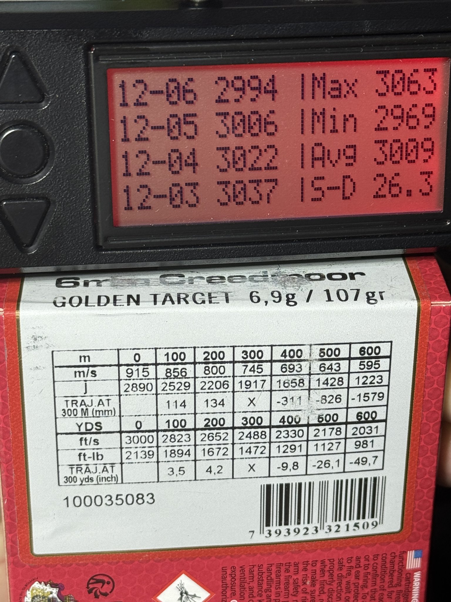

Hmmm 3090-3166fps at 91degF in Vegas, where even hotter 100+degF temps are common...
Don't blow yourself up dude.

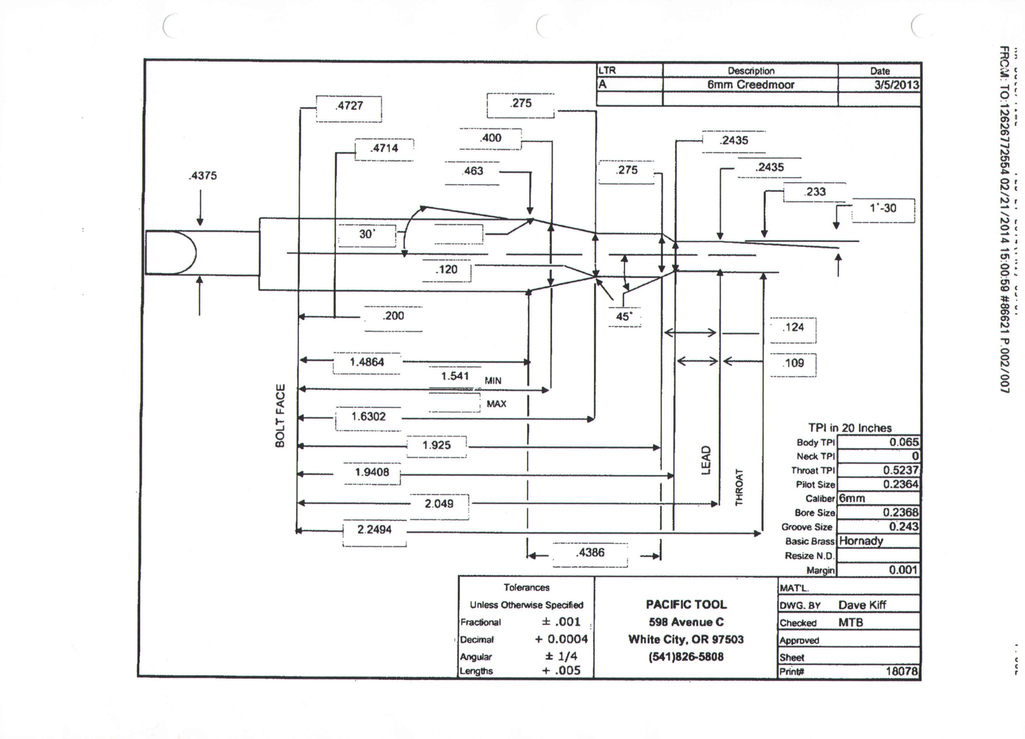

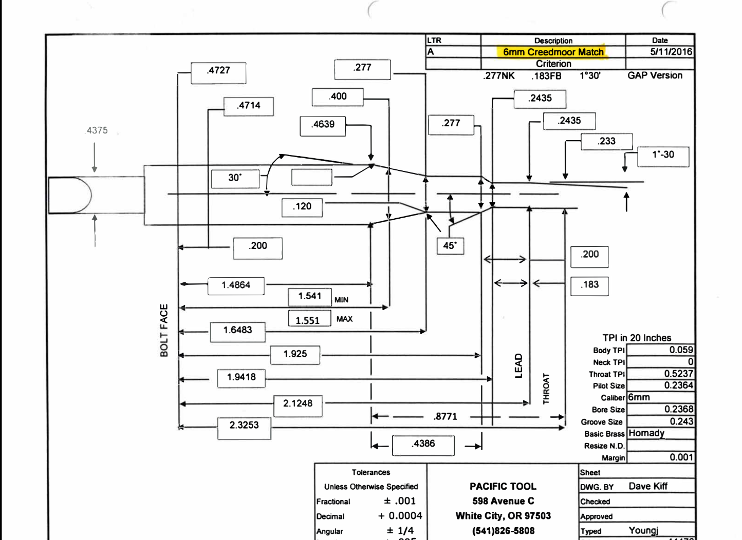

Hey there. New to the 6 Creedmoor world - it's been a *very* long time since I've had a 6mm anything. 6BR, .243 Win, and a 6x47L, way back when, but I don't think any of the Creedmoors were even out when I sold that one off. That 6x47L was a fun gun, though. Kinda hoping for more of the same with the 6CM 🤞
So... I ended up with a used Criterion barrel from a friend, who'd bought it used from someone else (and never got around to using it). Supposedly 275-300rds on it, don't know any more 'history' than that. Checking with the bore scope shows a little bit of heat checking at the end of the chamber, but otherwise the lands look good.
The barrel is marked as '6 Creedmoor Match', so I got in touch with Criterion and requested chamber prints so I could figure out the difference between their regular '6 Creedmoor' and the 'Match' version. Looks like the regular has 0.120 freebore, and 0.275 nk, and the match has 0.183 freebore and 0.277 nk. The freebore makes sense, the neck... not so much. Maybe I'm missing something?
Still waiting on other parts to show up, so I'm not in a huge hurry on this one. I've got a few hundred 'old' style bullets - S107MKs, Hornady 105 A-max, and Berger 105 VLDs. Figured I'd throw these down range while I get a feel for the new-to-me cartridge. Plenty of powder in the general burn rate, including N150, N160, H4350, etc.
I'm sure I'll find out for sure when I finally have all the components in the same place at the same time and can screw everything together, but I'm a little curious as to whether those bullets are going to be jumping a ton with that freebore from an AICS mag? What about something more in the varmint-y range, like an 87 V-Max?
The 277nk 183fb is a saami spec reamer, nothing match about that. My Lapua brass is 273 loaded, alpha is 272, works well in saami spec chambers. The long freebore is great for the newer heavy for cal match bullets.
Reactions: TheOfficeT-Rex
I hear ya. I'm guessing Criterion is just basing the naming off what their prints from PTG say
I'm so used to .308 Win brass coming out .342 from a .343 chamber, and loaded rounds being .335-.336... it's going to take me a bit to mentally adjust to not having so much room around the case necks ;)
That was kind of where I was going... I'd seen some references to it being great for the 109/110/112/115 gn bullets; wasn't sure how well it would work with the 'older' 103-105-107gn bullets. Or if there was any appreciable difference at all.
As long as they feed smoothly from the mag, go reasonably fast, and group pretty well, I'll be happy ;)
Well, ptg reamers aren't great, hopefully the chamber is close to what the print says! For any the 6mm that get shot high round count between cleanings, say a weekend match, I greatly prefer a 244 or 2445 freebore diameter. More room for carbon fouling in the throat before it starts creating velocity issues. 6Creed makes carbon rings quickly depending on powder choice. I had one that was a lil tight in the throat and after 70 rounds of rl16, it would pick up 30-50 fps and groups would open up. However rl16 plus a suppressor, is recipe for carbon fouling.
I've had great luck with 105s and 107s jumping 50-90k, so it'll shoot just fine I'm sure.

The jump will probably be anywhere from .030” and up with those bullets and the SAAMI .183 freebore. Luckily those bullets don’t mind a jump. Well at least the AMAX and SMK don’t.
Reactions: memilanuk

6 CM here with 26" M24 Bartlein
H4350: 41 gr
Burger 109 LRHT
Lupua Brass Small Primer
CCI BR-4
OAL: 2.83 +- 0.002
FPS: 3100 (SD around 7 . Clean barrel and cold bore it drops to around 3050)
Groups are normally well under 0.5 MOA, but I have seen 0.136 MOA for best case.
Using up some old components while I waited for the 'good' brass to show up... S107MK @ 2.050" BTO (~40 thou jump), 2x Hornady brass, BR2 primers, 42.0 gn H4350 running @ ~3050 fps. Bullets and primers are probably 18-20 yrs old. Barrel is a Criterion 26" med Palma "variable headspace" aka Sav barrel nut pre-fit in an Origin action. Barrel came to me used, looks okay so far 👍
Just finished up a load for a new 26" ES Tactical barrel in a DTA. H4350 42.1g, 105 Berger Match Hybrid. .010" off the lands and 3178 fps average with very good ES and SD. Shoots a nice ragged hole. Very easy load work up. The Berger liked .005' to 020" with .010" off the lands being the best and the gun printed very well from 41.2-42.4 grains as the upper node. Worst group in that whole spread was sub .50". Impressed with it.
Went on a little journey while trying to just get a little speed out of my 6CM and the 108 ELD-M. I've got a 6GT for when I want to shoot 2,900 or less. I just wanted 3K with half-minute consistency.
Started low with Peterson brass after reading how the case capacity is less than others. 38.3 - 39.7gr H4350 shot little bug holes, frequently around 3/8" (just 5 shots). Unfortunately that was Dasher speed, so I tried more.
40.1 - 40.7 exhibited a POI shift of about a half inch, first one kicking out, then 4 of the 5 moving out. Admittedly I fired a couple of those charges twice, thinking that I was throwing a shot...nope...consistently 1 out in the same direction. 41.0gr hit my 3K FPS goal, and the group had stabilized to the new POI.
Since 3K FPS was my comfortable minimum, I left it there and just seated in/out a bit to see how accuracy held up.
It shot 3 consecutive groups across .015 seating depth with virtually the same result (.3 - .4s). I found the limit too as I came out the top with a double-group that was close to .7 MOA.
41.0gr H4350 shows zero signs of pressure in my Peterson brass or primer by the way if anyone was wondering. There were threads where other guys were into pressure really low, but that isn't my case. I just wasted ~60 rounds.
While I'm sure another 50-100 FPS is easily possible, I'm happy where I'm at.
-26" Bartlein, 1:7.25, AI AT-X
-108gr ELD-M
-1x fired Peterson brass
- CCI 450
- 41.0gr H4350
- 2.230 - 2.245 CBTO (all good *so far)
3,012 FPS, 17 ES, 6 SD
I may have a fast barrel or either the 6 Creed does great in short barrels.
Tikka
Peak 44 Bastion
19" PVA, 3B (not a prefit, just the blank)
Shoots pretty much everything very well.
Lapua
CCI BR4
42.3 gr H4350
103 ELDx at 3040 fps
Peterson
CCI BR2
41.4 gr H4350
108 ELDm at 2995 fps
Lapua
Fed 205M
46.0 gr RL-26
108 ELDm at 3045
