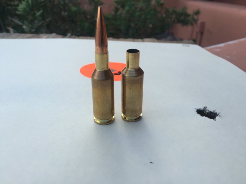

Run a 6 BRA (6BR ackley )and don't mess with all the dasher stuff . No false shoulders ,hydro forming or jamming Load and shoot . The results are out on this little guy .
That looks like the ticket.. what do you gain in terms of velocity over the straight BR?
Some of the 1000 yard benchrest shooters are making the switch over to it. It's set a few world records and some of the top shooters switched. Easier fireforming, maybe better aggregate scores in benchrest.
