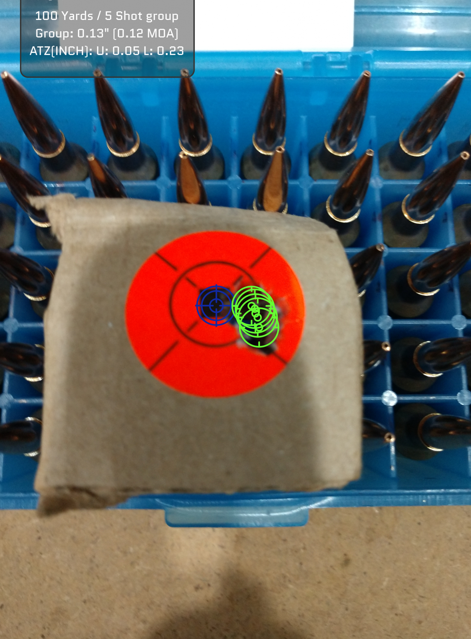

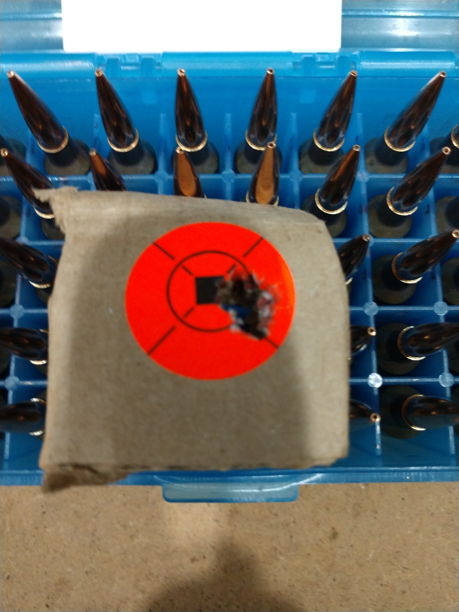

I worked up loads for both the 112 Match Burner using Varget and the 115 DTAC using H4350 based on what others had done. Both shoot very well, under .5 MOA. Now I'm doing a round of seating depth tests with a lower powder charge (33.5 instead of the 34.1 I did my initial test with) on the 112's from 0.020 to 0.110 off the lands to see if what I heard about larger jumps is true. Just something to do...
34.2 grains of Varget @3020 with a 105 hybrid,CCI 450 .025 off.

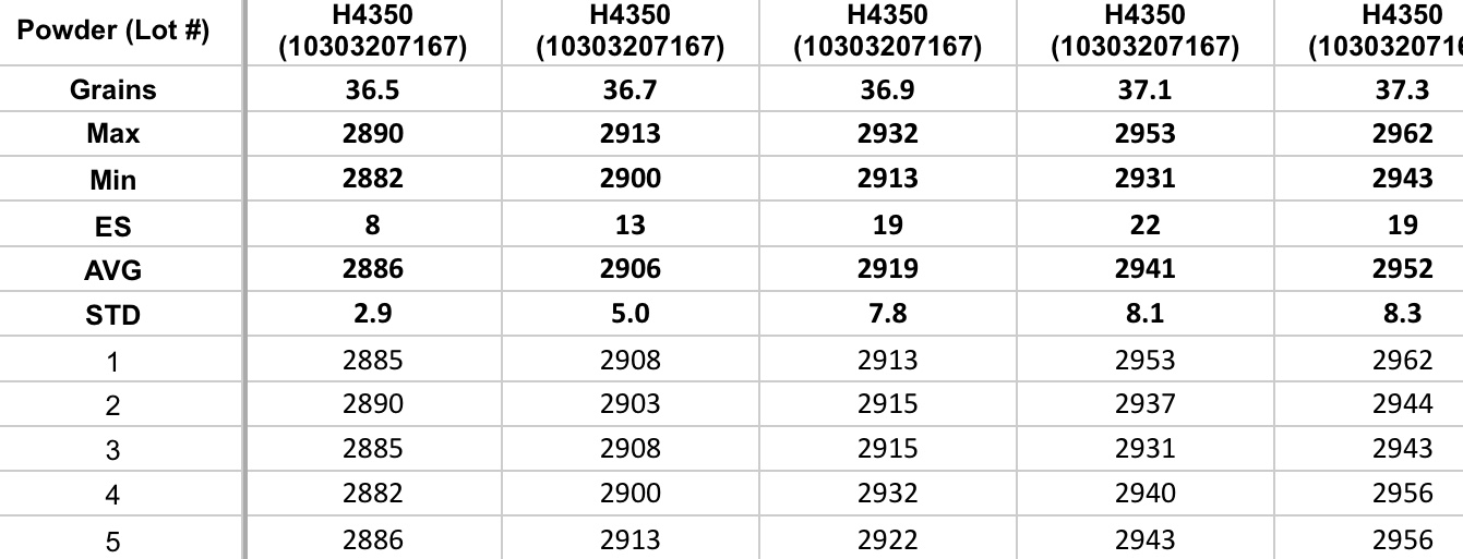

7 rounds of H4350 @ 2858 fps with 109 - new Hawk Hill bbl. Hoping it will speed up to 2900. Still experimenting...
Do you think you’ll stick with the 4350 for your gt? I’m considering making the jump, but I have 0 varget and a lot of h4350 from my 6creed.
Reactions: Huckmeat
I'm in the same boat. I have tons and tons of H4350 and only a handful of Varget. Given the results, I may just stick with what I have so far unless someone else says otherwise. Plus, I've been told that Varget is more prone to a carbon ring.
