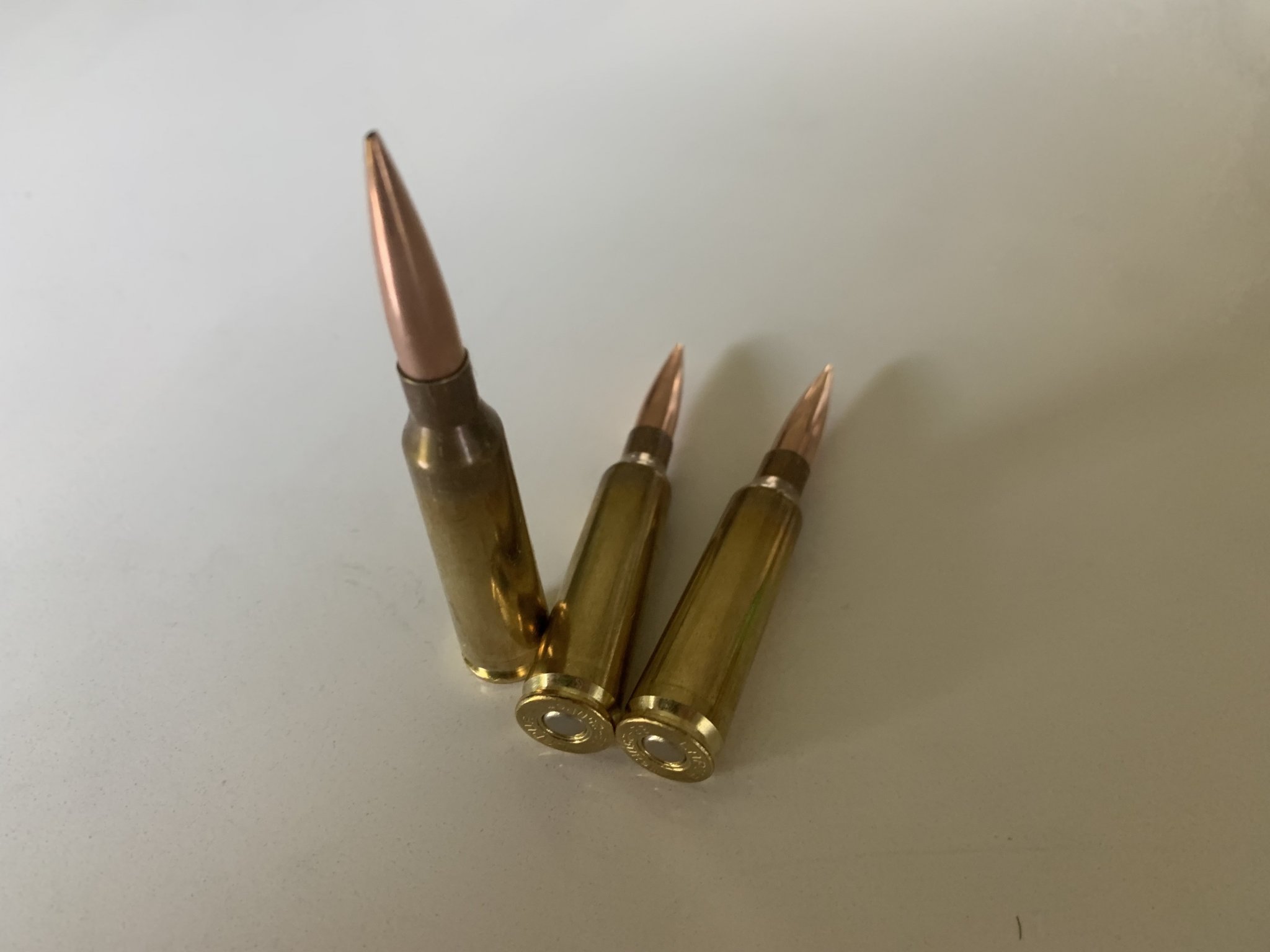

The most common cartridge used to make 6gt is 6.5x47 Lapua

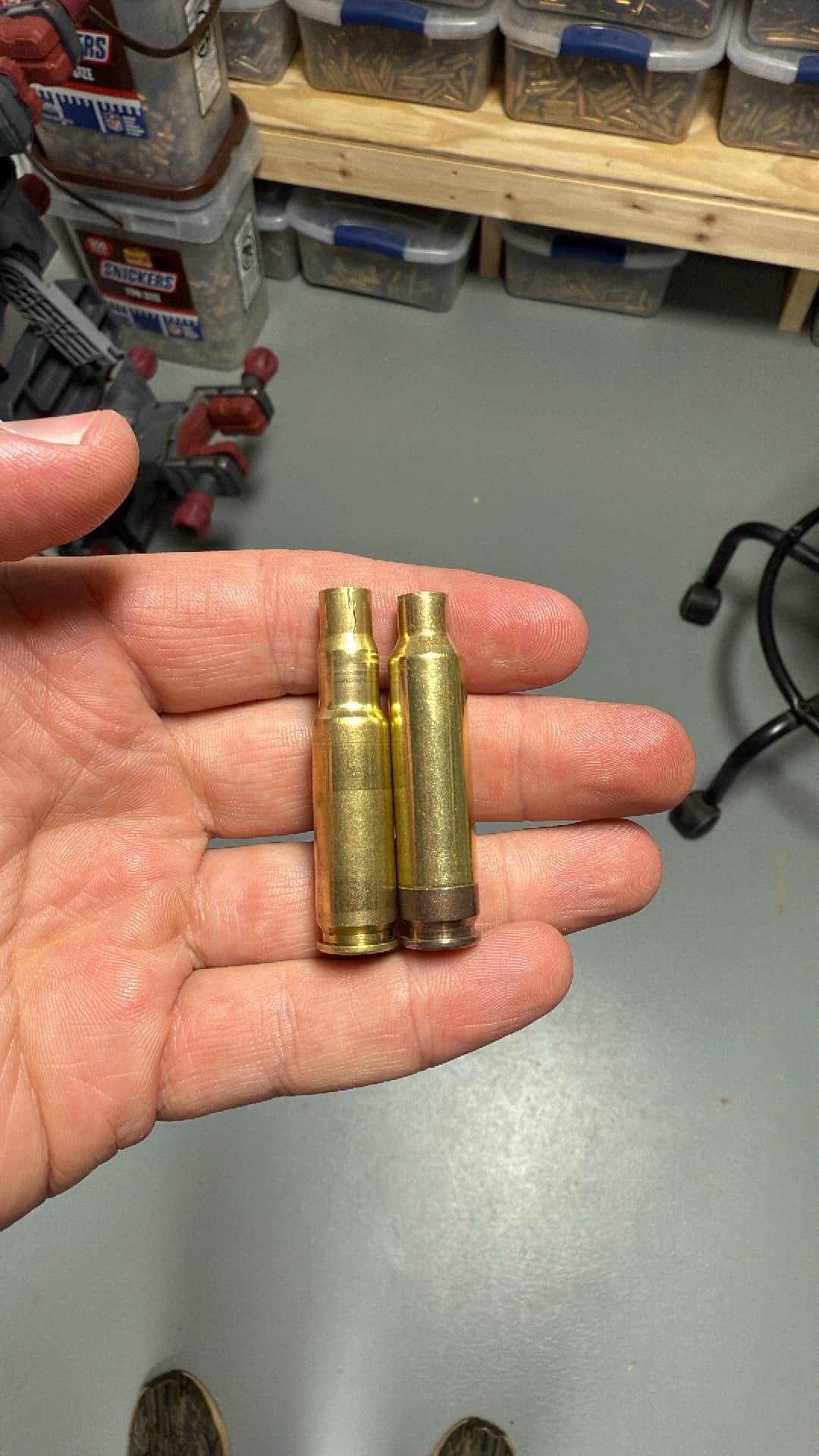

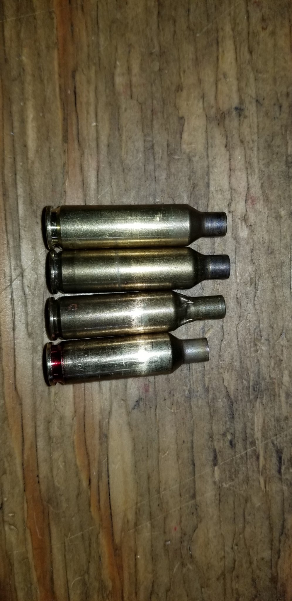

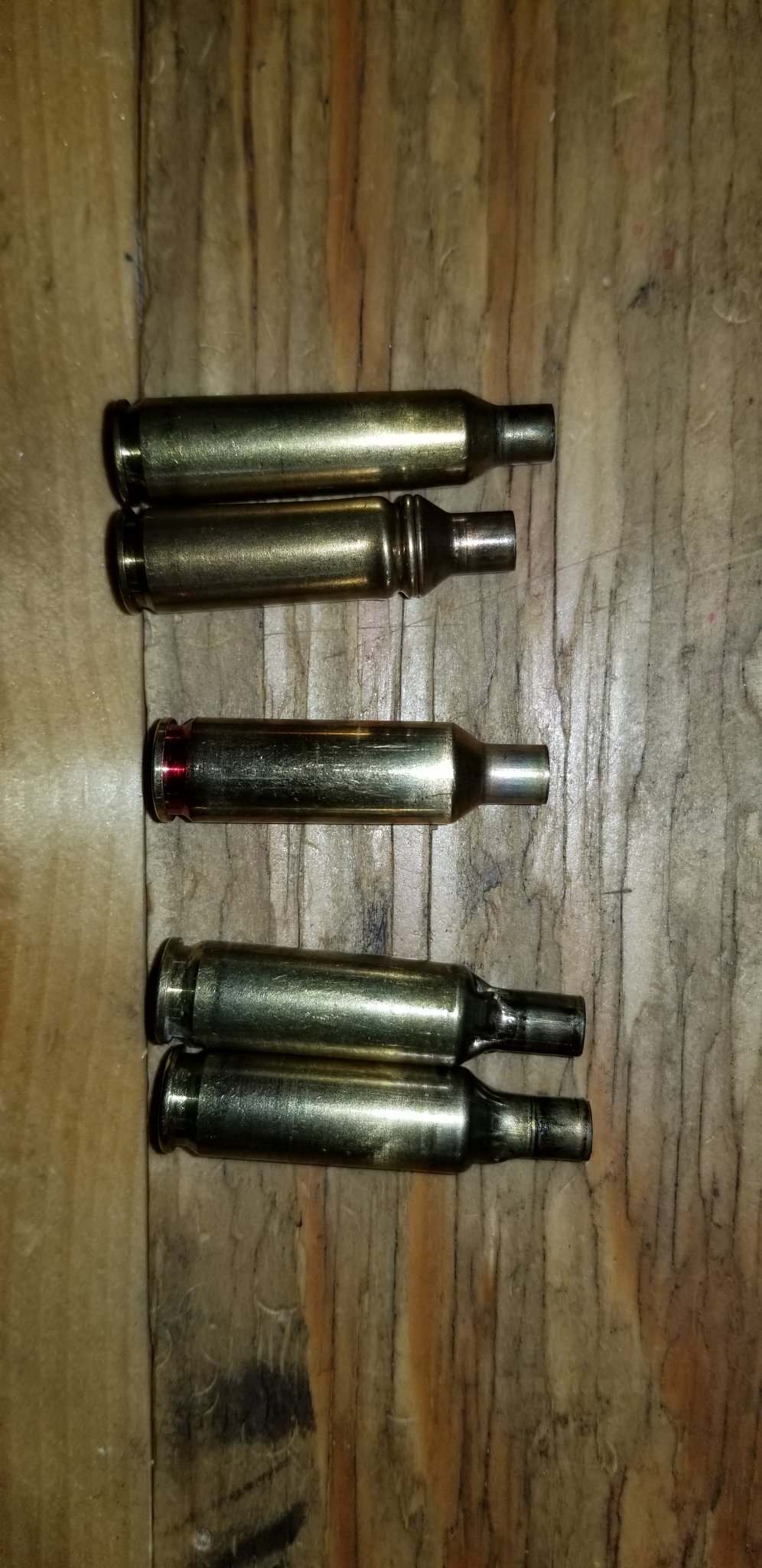

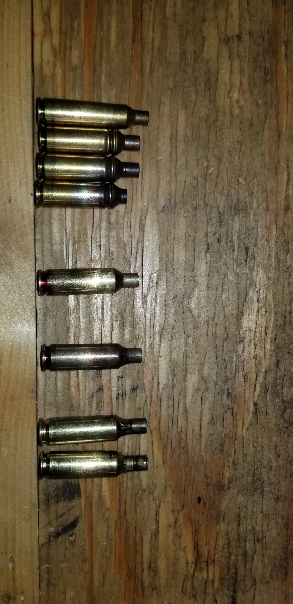

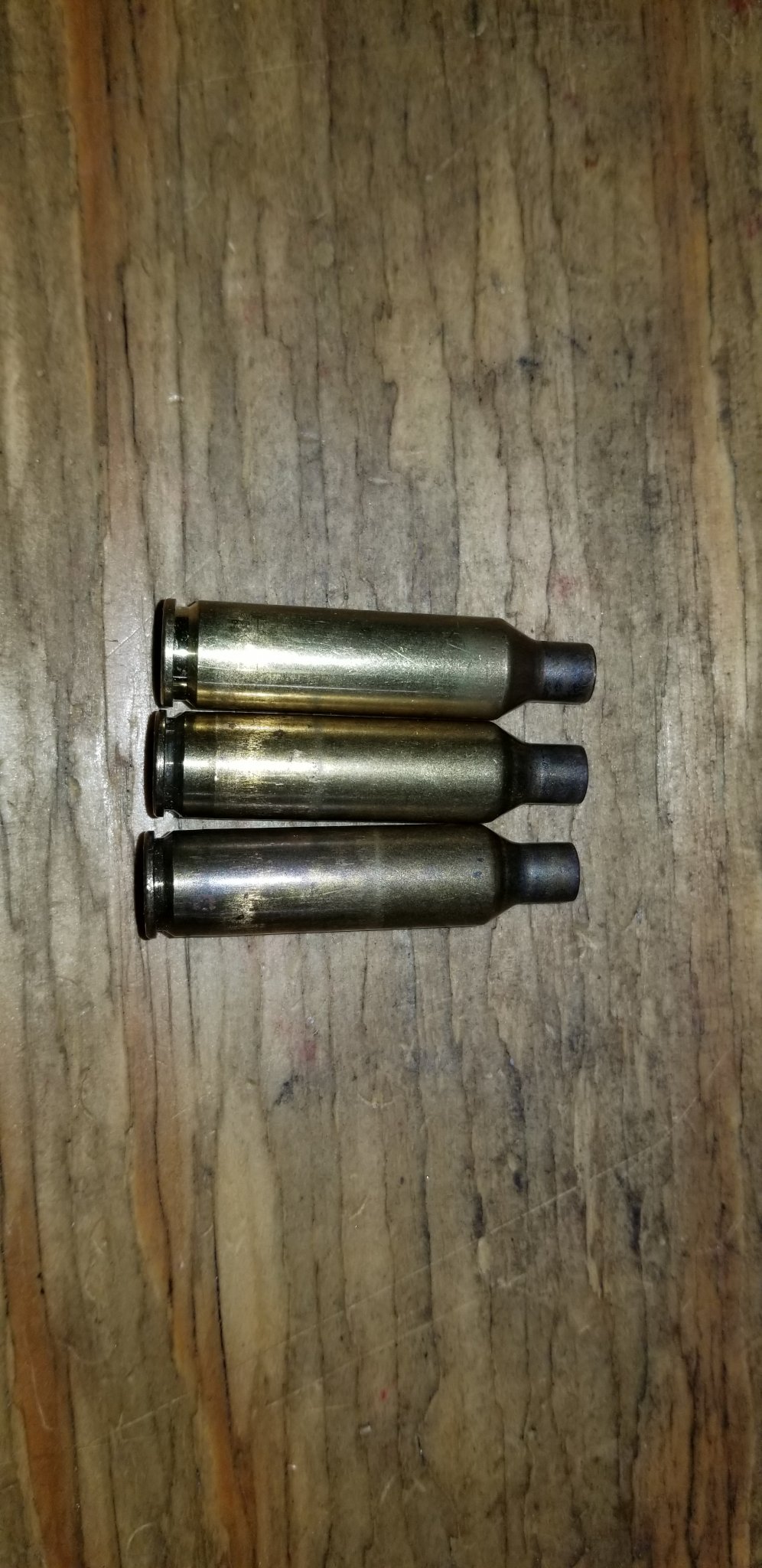

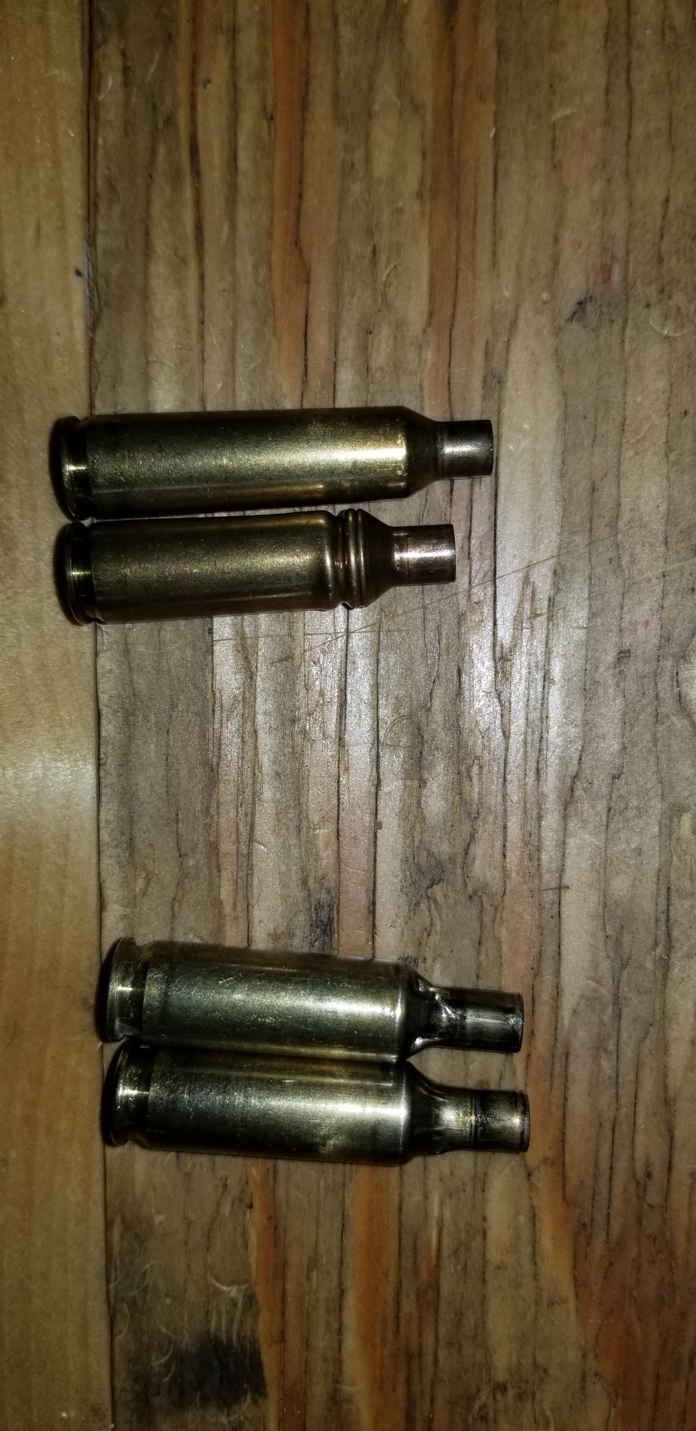

I ran a few thru my 6gt die some annealed some right out of the ammo box (old r&p brass) it folded every one. Too much unsupported case would be my bet I also ran some creedmoor thru as well it was better but pinched the shoulder see pics however you can fire form 22-250 into 6 creed near perfectly I would pay close attention to the web and shoulder area for signs of failure

22/250 was used to make 6xc, some guys even fireformed it to make 22 creed. XC case dimension are quite different than the gt. It'd be a lot of work! So much that I'd rather just go buy alpha gt brass.

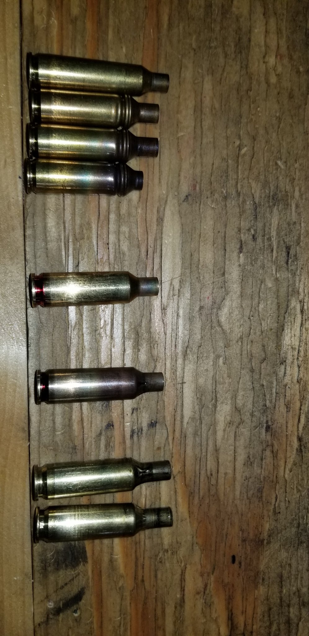

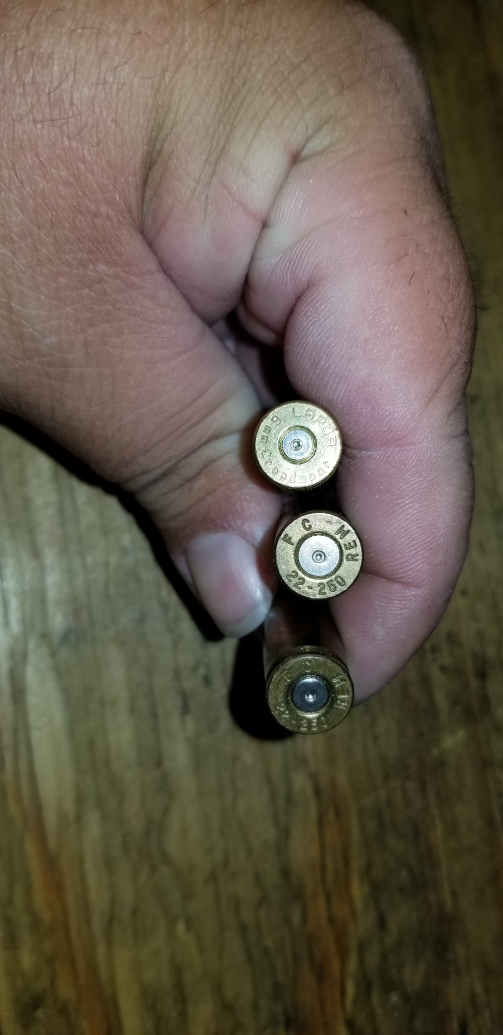

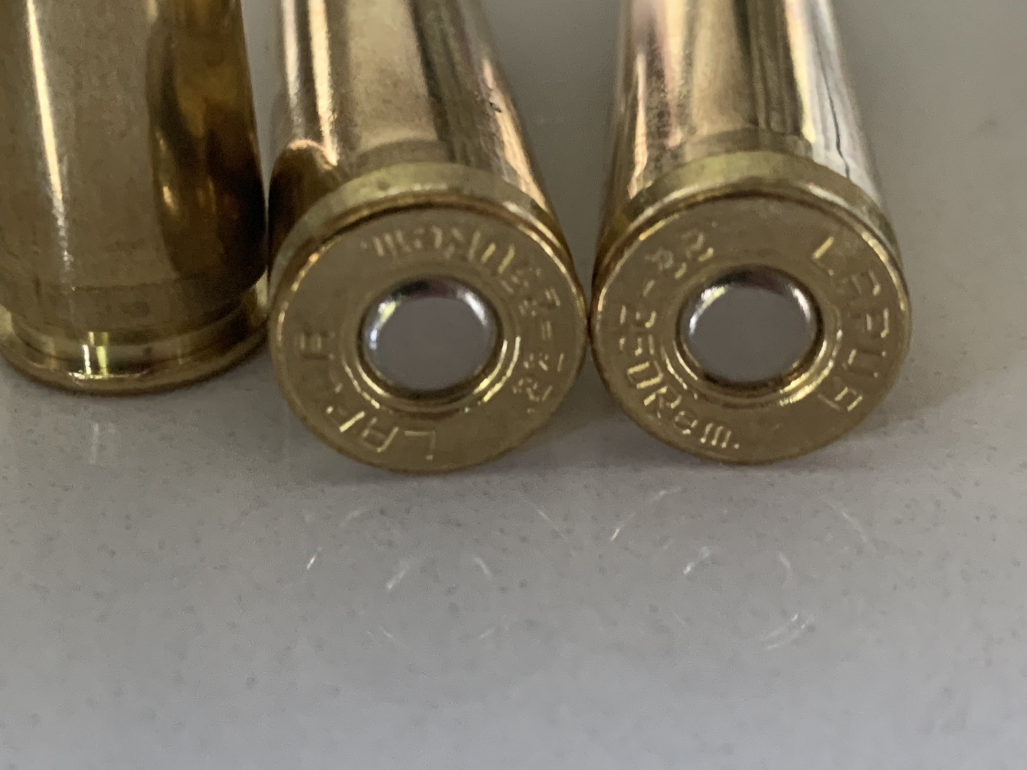

I'm getting a pre-form die to convert 22-250 and 308 brass into 6GT, if it works I'll get them made for dashers etc as well.
Since there's so many plentiful brass options I figure it would be handy to have. I'll get back to you all when the dies arrive. Yes they will be LRP but hey in this day and age, options are options. The 22-250 shouldn't need any neck turning but the 243/308 probably will and possibly some reaming too.
You might have better luck starting with a 308 or 260 Rem die to push the shoulders back, the more shallow angle makes that easier. Then follow up with your 6 GT or Dasher die. And annealing to start and probably in between, likely followed by neck turning is what I'd try if you really have to form these.
Agreed. ADI 308 brass is very good too.
The die is on order and will be ready around the 4th of July. Basically it maintains a 20 degree angle up to the wall/neck junction of the GT/dasher etc then you can trim and finish in the FL die. Then turn etc. I’ll use a Forster lathe for all that.

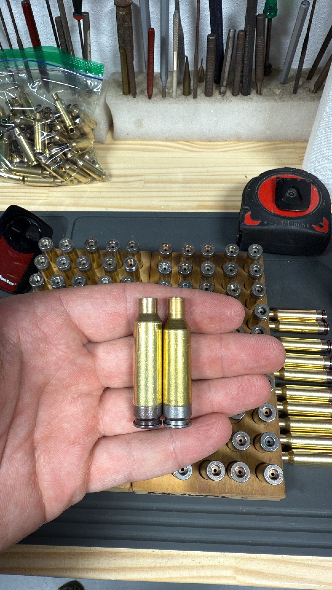

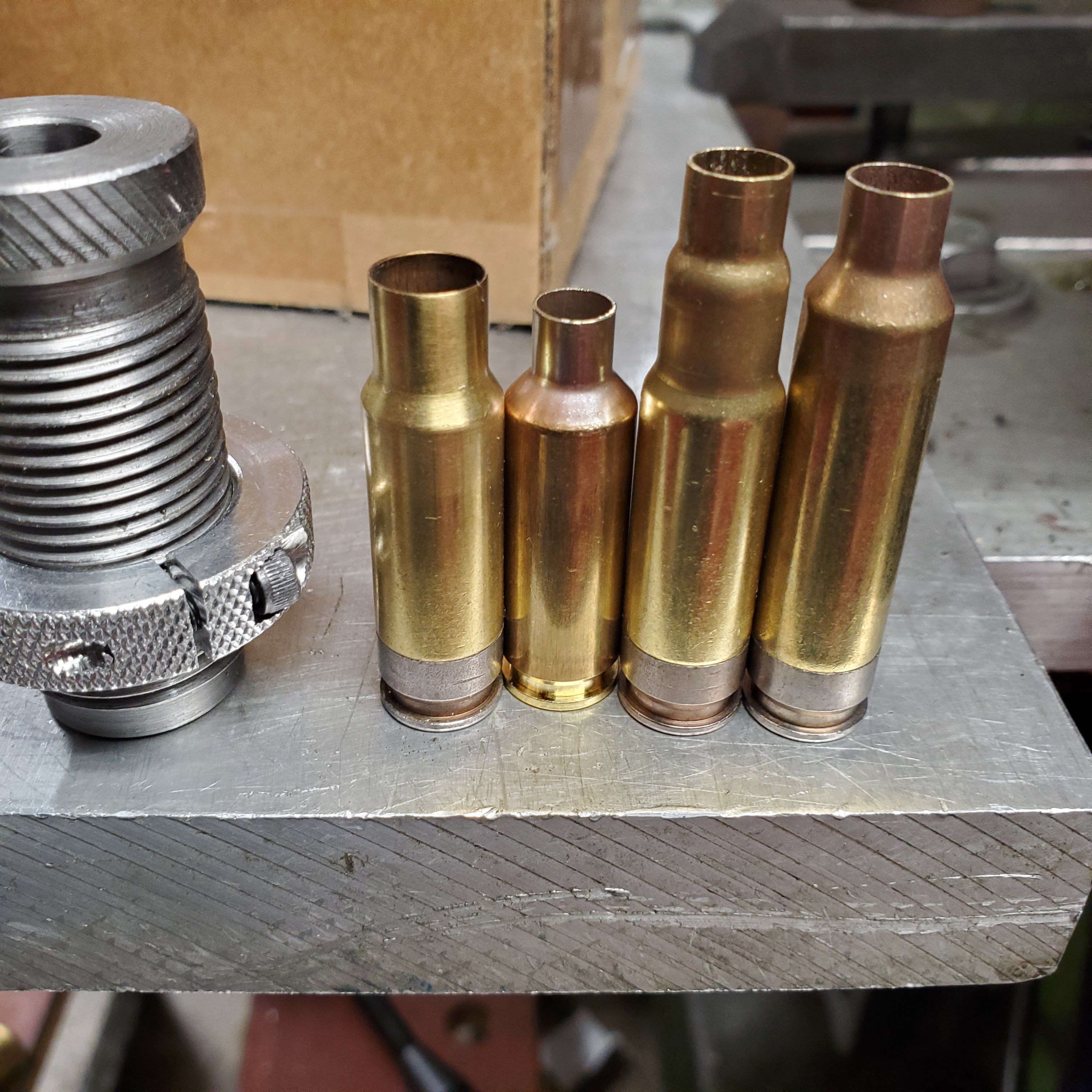

7mm08/308/277 Fury to Dasher

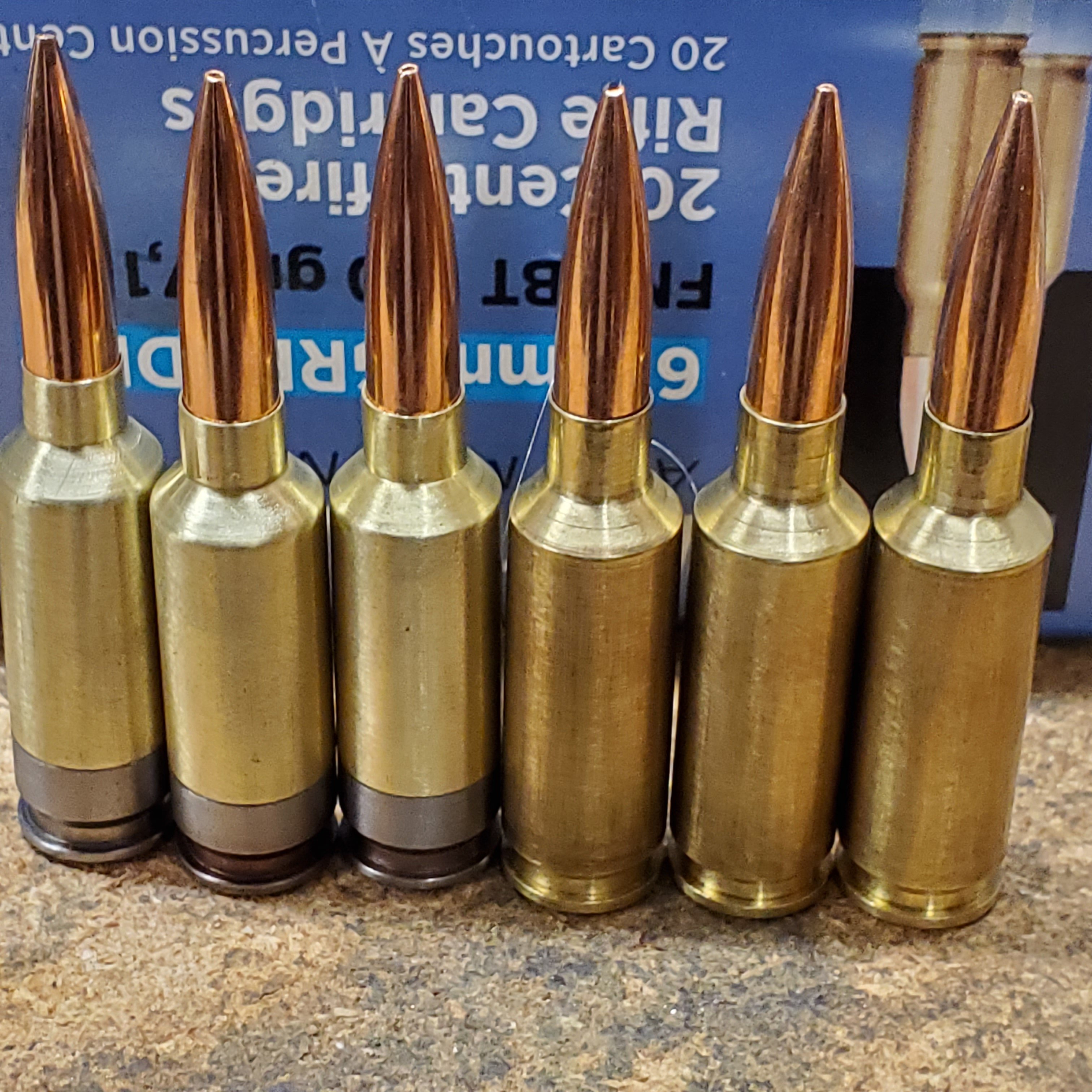

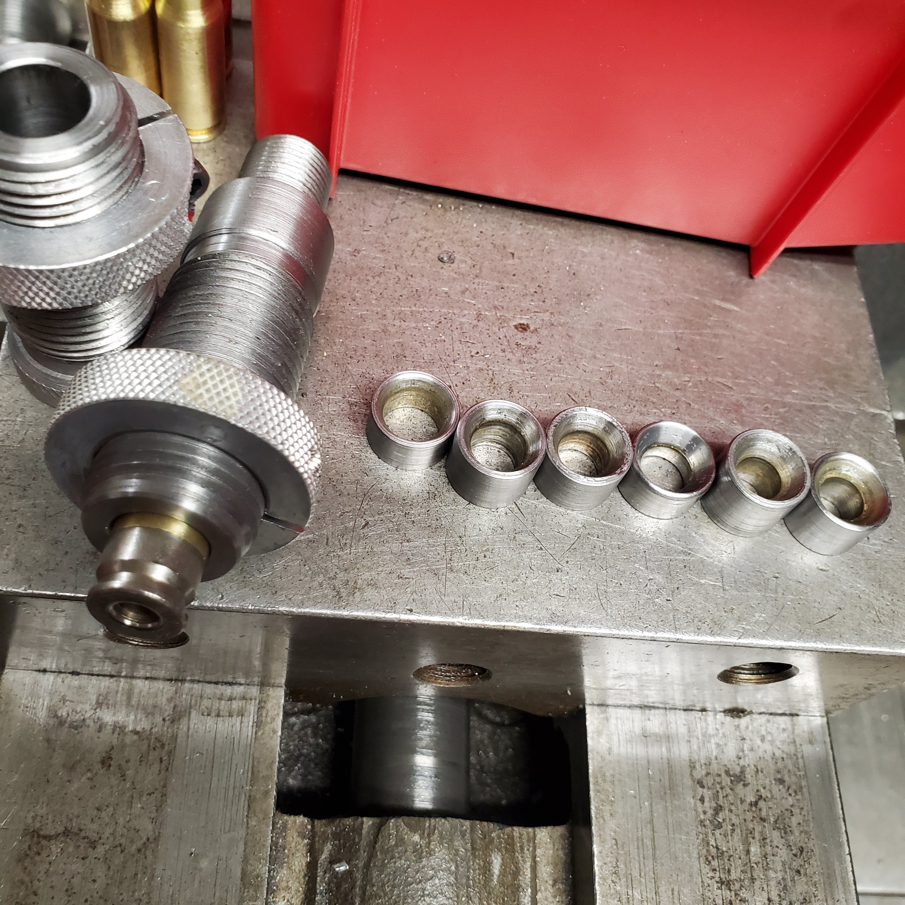

I've made hundreds of 6 and 22 GT from all sorts of things running the Rexem wildcat forming die. Absolutely brilliant. I have to neck turn but turning-schmirning I guess.

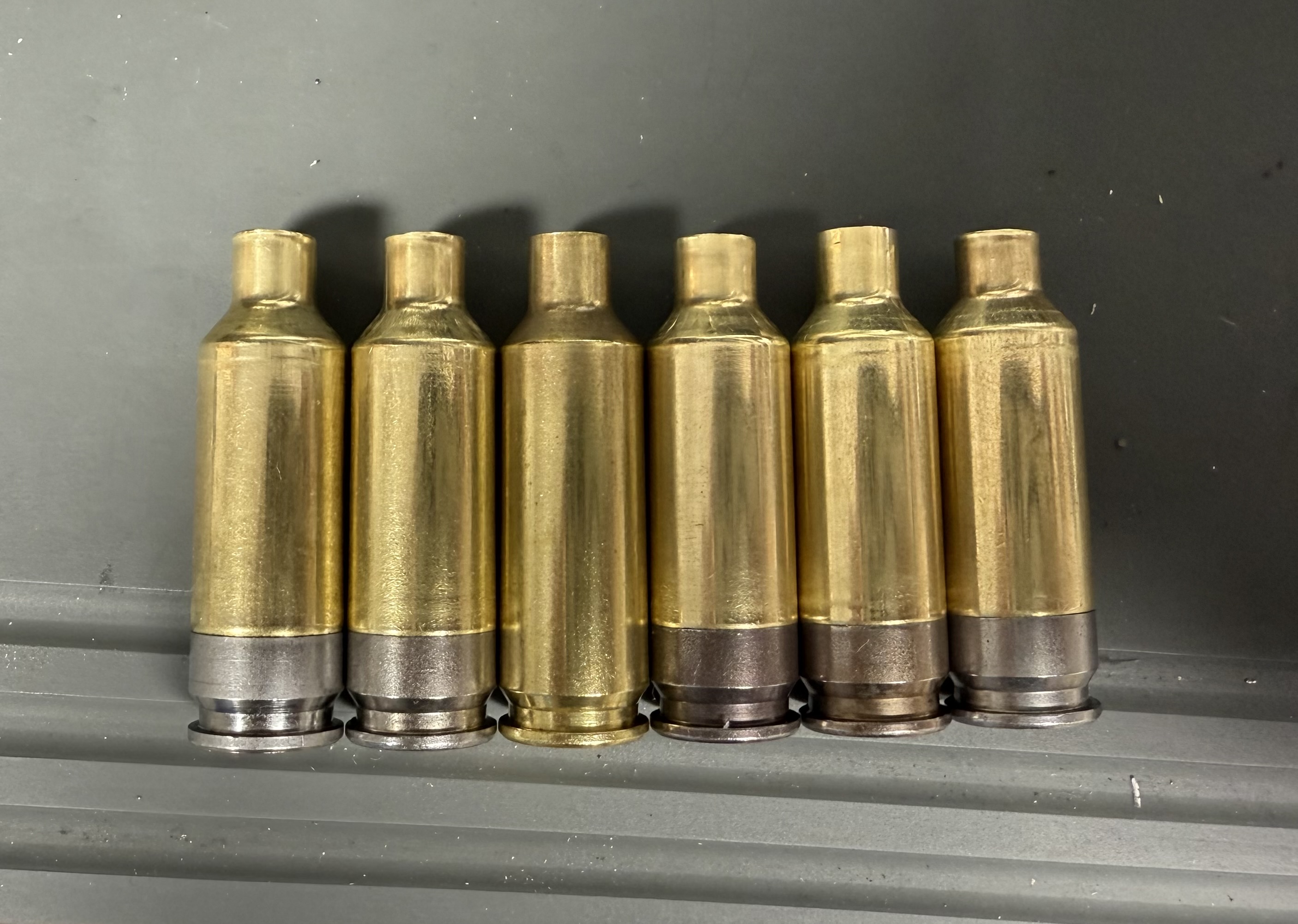

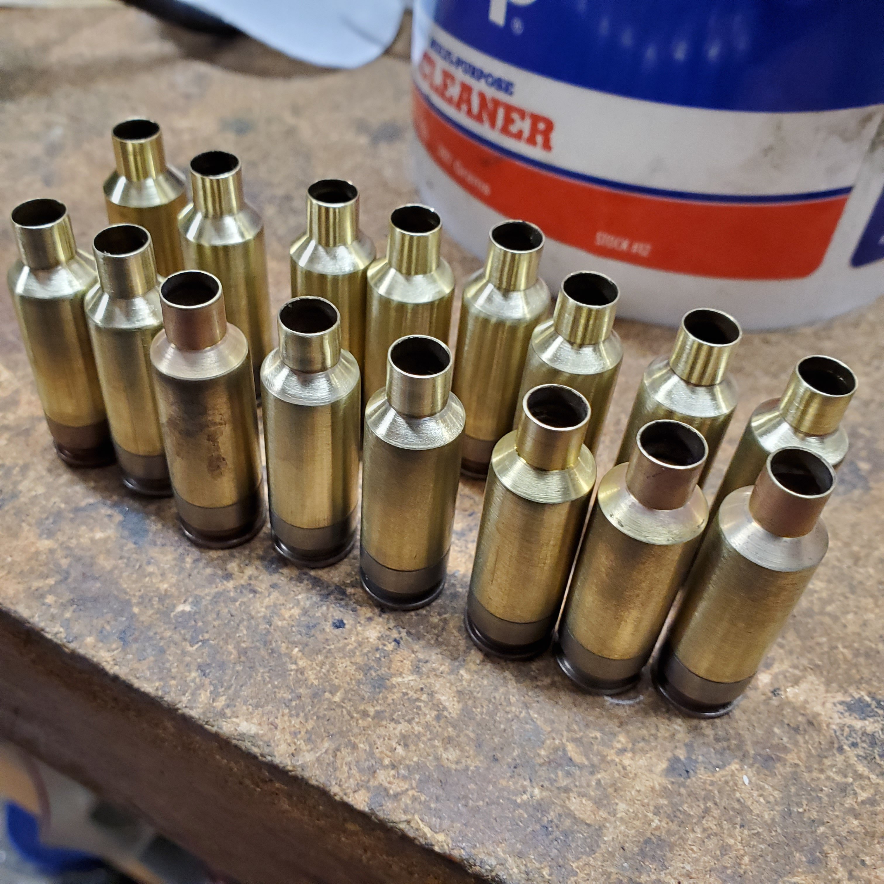

Yes, one can make hybrid 6 Dasher cases.
I usually just purchase Alpha 6 Dasher cases, its much easier.
But also made some out of 6.8X51 hybrid cases...it just take time, and better to do a bunch at a time.
I trim them down in the milling machine, which is very fast and neck turn them in the lathe.
Made a neck step down die with chamber reamer and stepped neck down a few calibers at at time at 30° then the last is bushing is 40° to push the final shoulder into position as 30° is easier to move brass than 40°.
Now you can run 107 grs bullets at 3200 fps or faster, in your 6mm Dasher...if ya want. Most likely burn up your barrel a bit faster.
The idea is you are never really out of brass cases, most cases can be made from existing brass...I even turn down solid heads and recut extractor grooves, to make 6 mm ARC or 35 Rem from 308 win.
