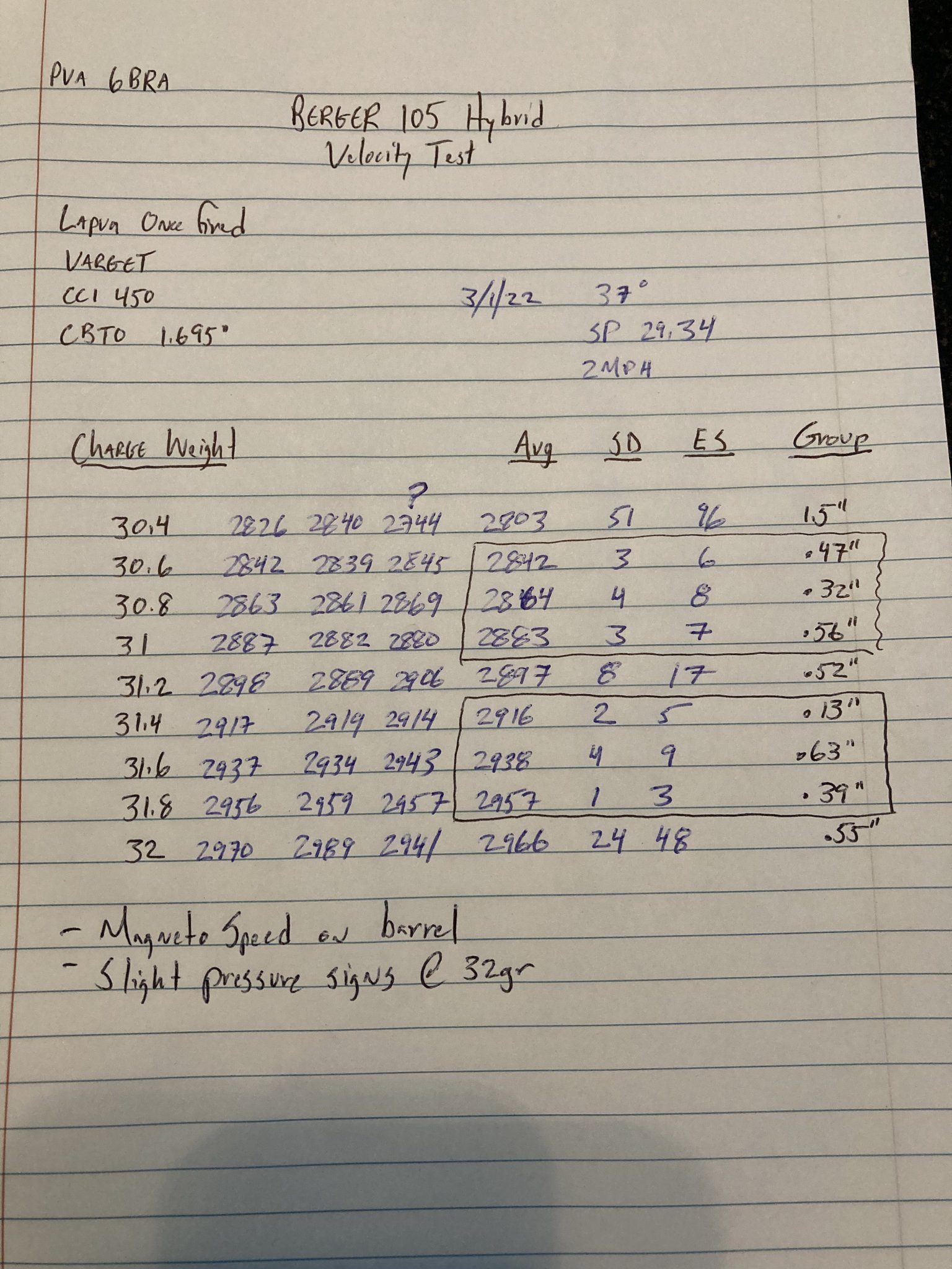

So started some load development the other day. Was mainly just doing a velocity test to see what it would do. All groups were shot with a magneto on barrel so im not sure how dependable they were.
Fireformed Lapua brass
Berger 105 hybrid
Varget
CCI 450
.020" off lands.
I noticed I started to get a little bit of bolt lift at 32gr. Dunno where im going to go from here but looks like might be worth playing around 30.8 or 31.5.

31.4 looks real nice.
It does for sure lol but dunno if it was just luck yet .😂 Temp of 37 that day so I’m sure things might change a bit when it warms up but trying to get this ready for a club match next weekend.
I’m thinking loading up both 30.8 and 30.4 and shoot a cpl groups of each. One for chrono results and another for groups. I’m kinda wishing I had a Labradar right now.
My Varget match load with a 105 Hybrid is 30.6-30.8. I ran in the mid-31 grain range for about half a barrel early on and while it was good initially it eventually got pressurey with bolt lift in dusty/adverse conditions. I would stay well short of 32 grains.
2865-2880 has been a very good node for me over multiple barrels. Current barrel has 2200 rounds, still shoots a ragged hole, was able to win our PRS regional match last weekend with it.

That's good to hear. Im a little concerned that when the temps warm up another 40 degrees that 30.4 range might be getting a little warm. Its good to see that my numbers are pretty much lining up with most here are seeing for nodes goes to show I am not a complete idiot!
Reactions: Sheldon N
I see the slow shot in the 1st group was 2744 while the other two are 2826 and 2840, I can only imagine it's also the shot on target with the ? beside it. Was this a pulled shot, or was the trigger broken at the same POA as the others?
Your very observant! I have no clue what happen to that one but that was also the cold clean bore. Shot felt good so only thing I can think is either it was because of being the cold clean bore or I fucked up on charge weight.
All these rounds I dumped on a chargemaster light but .2gr under goal than I hand trickled on a beam scale. Tedious for sure but I wanted to get the most accurate weights I could at the time.

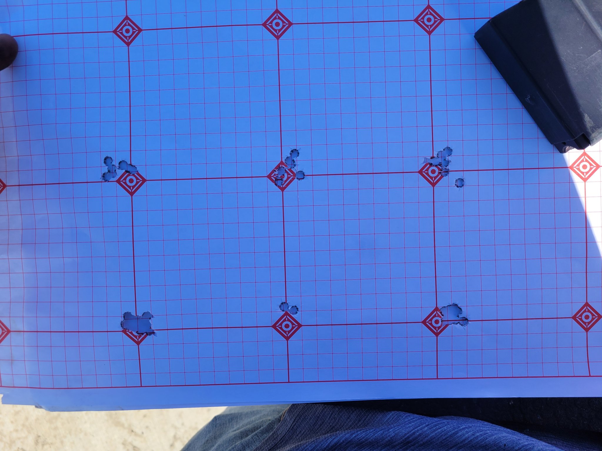

The low node looks like it’ll work. Didn’t run the magneto on these as didn’t want any interference with groupings but .030”-.040” off looks very good. Looking at my numbers this charge weight was average 2864 with a SD of 4.
First match this weekend so gonna load enough for match as well as 25-30 rounds to run over chrono this week.

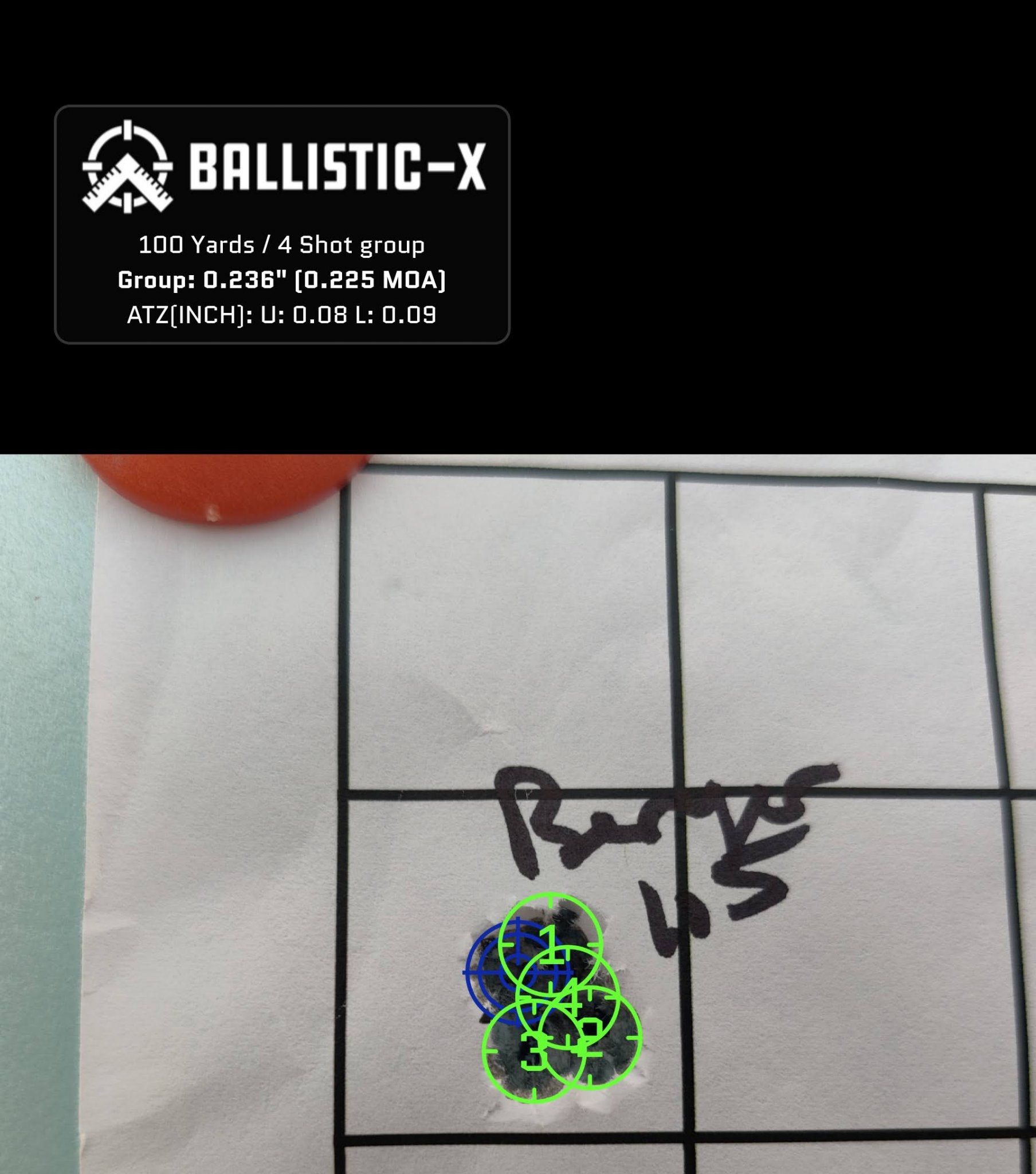

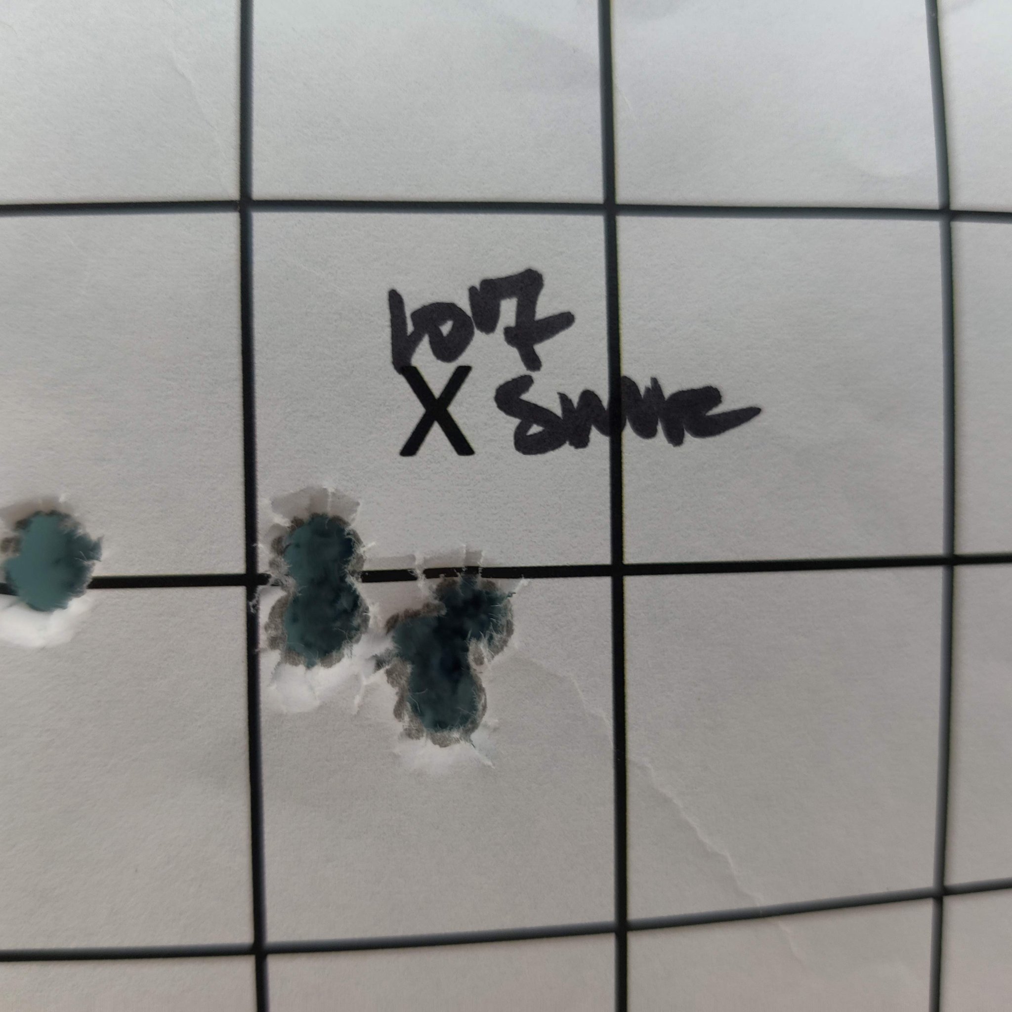

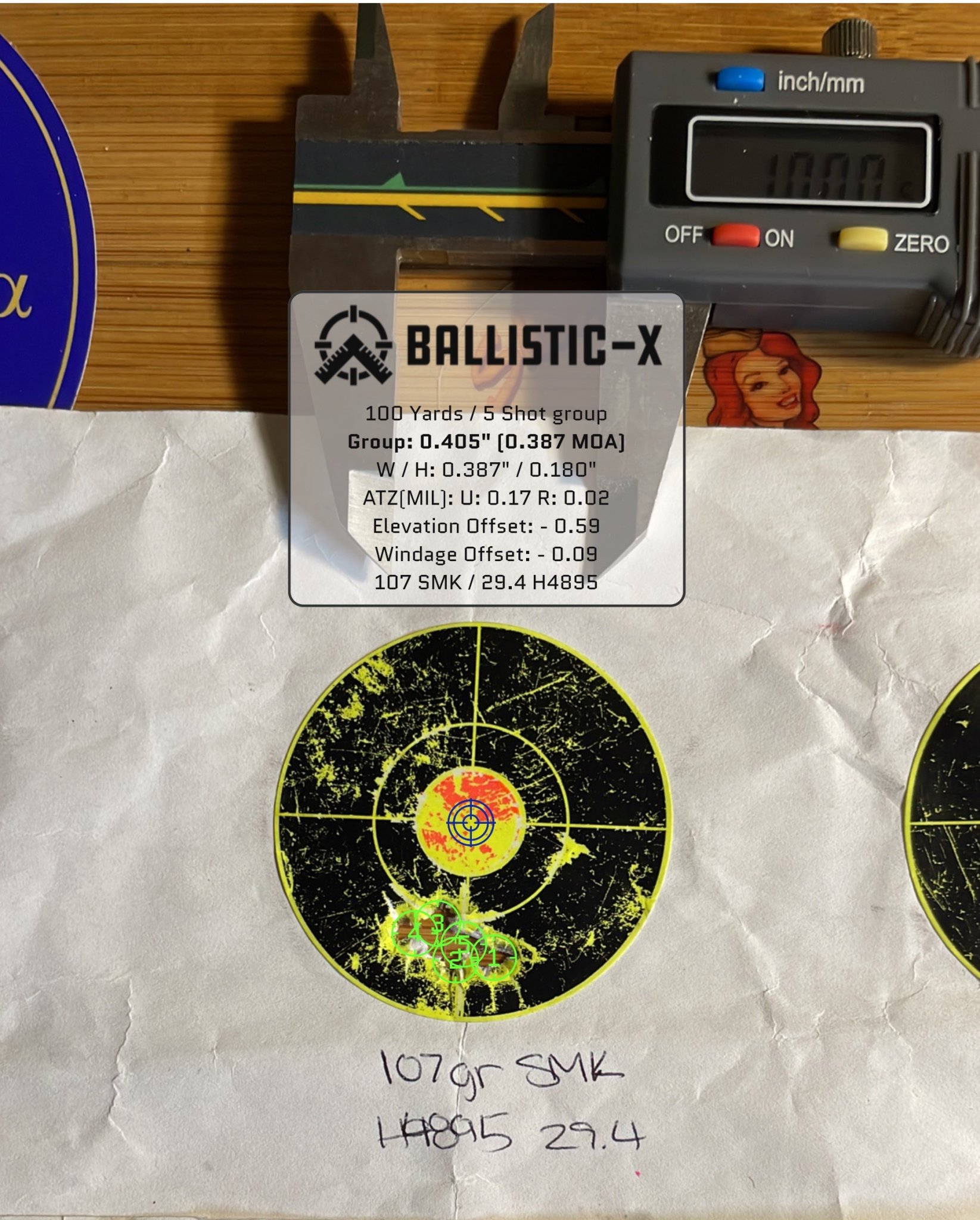

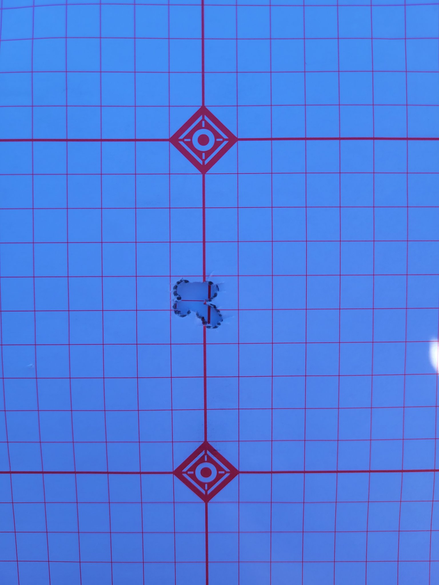

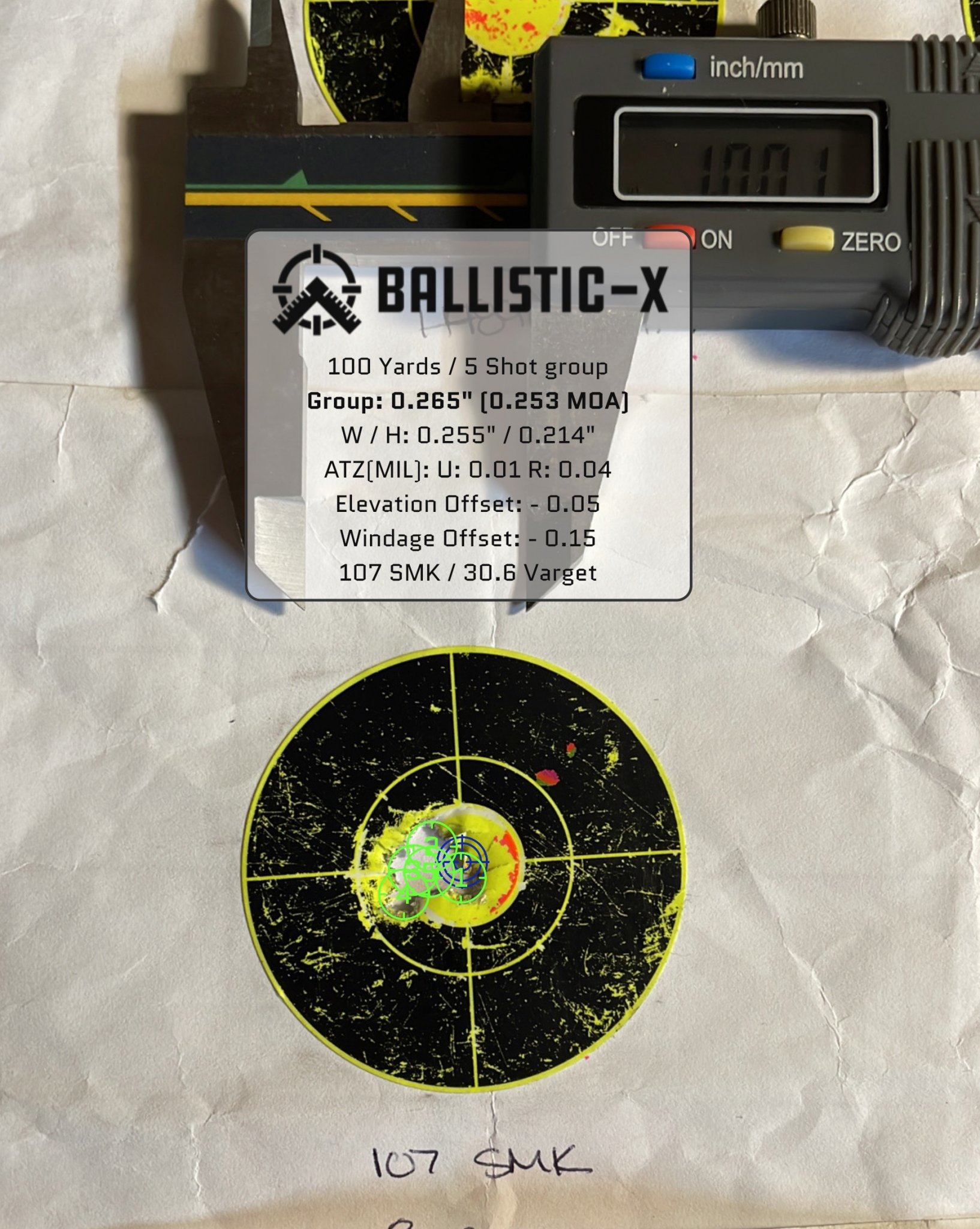

I got my 6mm BRA back from the smith this week and did some load testing with it same day. The barrel should speed up another 30 fps, and it puts me right in the 2800 fps area I was wanting.
Winds were variable from 18mph to 30mph, so I was getting some windage spread with my shots. 107s shot ok, especially around 20-30 thou off the lands, berger 105 hybrids shot amazingly.
Lone Peak Fuzion
25.5" Hawk hill 1:7 barrel
Alpha 6 BRA brass
29.7gr Varget
105 hybrids / 107 SMKs (labeled in each picture)
CCI #450s
1.765" base to ogive
(Picture number two has a hole on the left from an adjacent group)

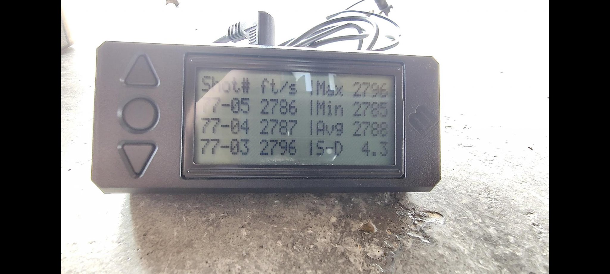

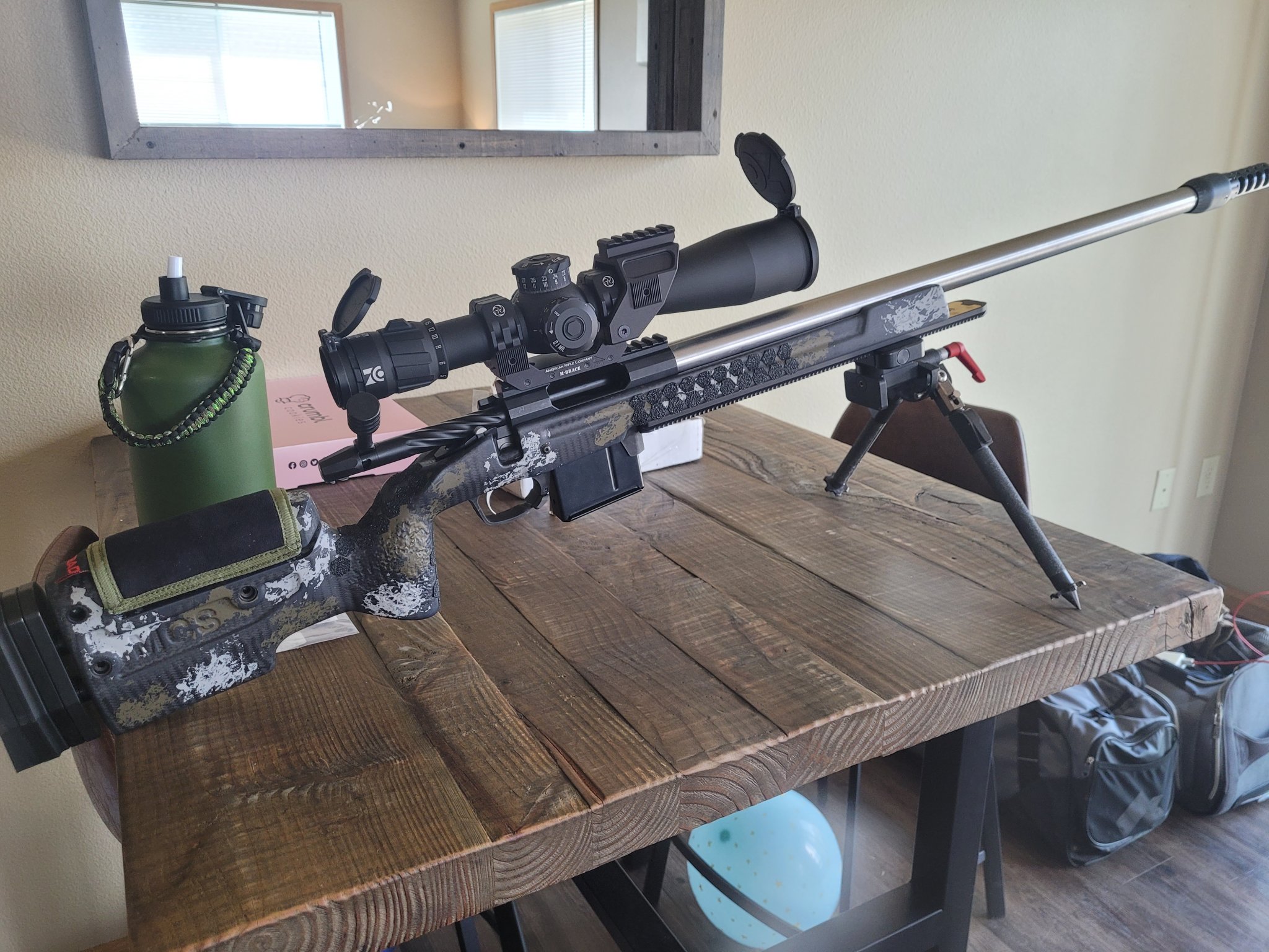

Rifle is finally in my hands. 28" 7.5tw hawkhill heavy comp contour, LPA Fuzion, bna tac pro, manners tcs, ace brake, ats tuner. 1.5" M-brace with zco 527 inside. Took it out yesterday to pop the cherry. 31gr rl16 with 107smk idk how far off lands, just closed the bolt on a long seated round, measured and seated another 15k deeper. Tuner was at factory position foe the first 5 shots ever out the barrel, 1/3 moa group. Moved the tuner to zero and that load opened up. However 29gr rl15.5 shot a couple 10 shot groups that were just over half moa. Zero load development. She'll be a shooter for sure.
My preferred loading:
29.6 gr Varget
105 Hybrids
Alpha Brass
BR-4s
2783 FPS, SD of 4

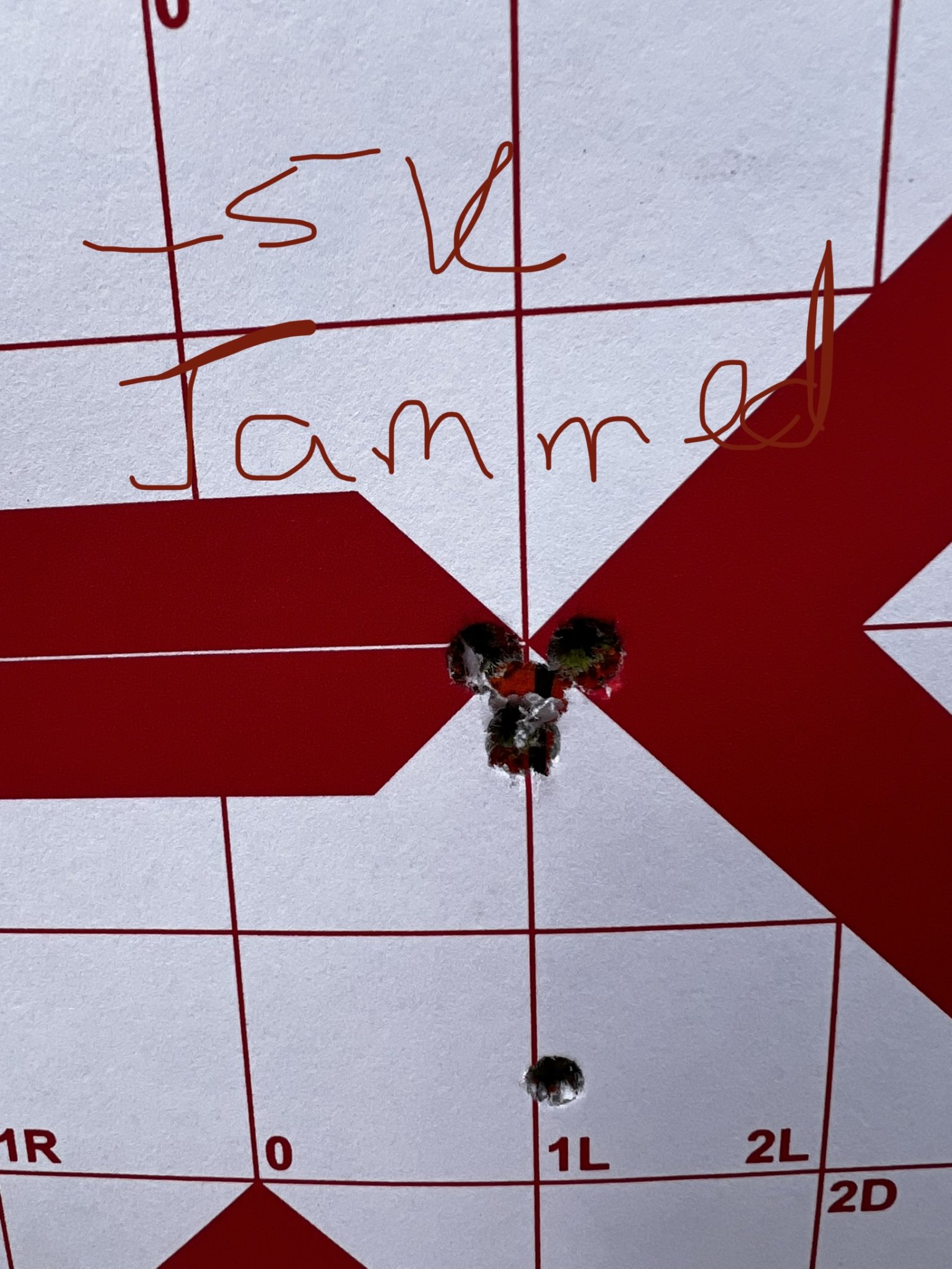

For further reference as I could not find a ton of info with 7.5tw barrels and 87gr vmaxs...
27" 7.5tw Bartlein Mod400 barrel
30.4 gr varget with a 87gr vmax
Thunderbeast ultra 9
AVG speed across 30 rounds, 2960ish. Shot the best jammed 5thou and right at the lands.
Hole at the bottom is from my 204ruger.
Ignore the center and the 4 round group on the right target. Center was 108 bergers and the 4rd group is from my 204. Top right of the left target is at the lands with the 87's. All 3 round groups.
Going to load some more jammed and at the lands to confirm. While kind of slow, it will do the trick for coyotes and prairie dogs I reckon.

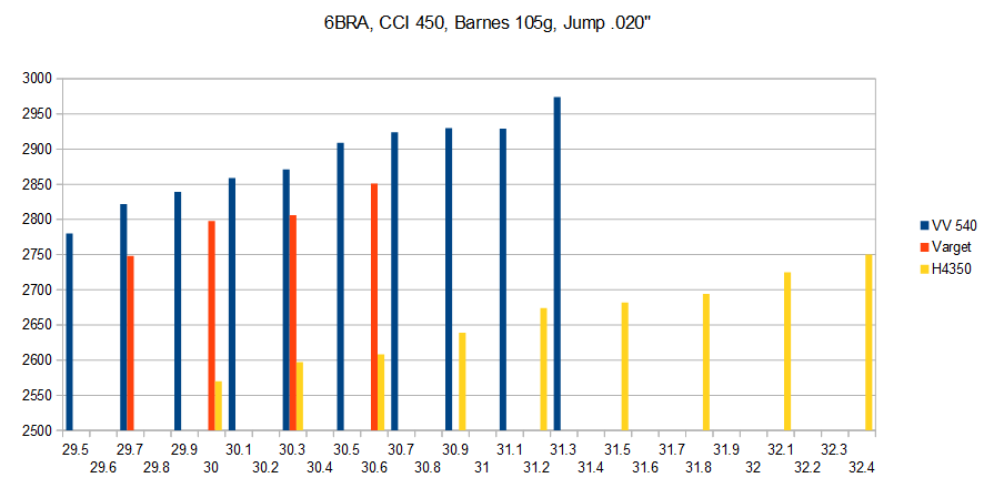

I purchased a 6mm BRA Stuteville prefit barrel in early October and thought I would share my results after 3 different powders.
CCI450 Mag primers, New Alpha 6BRA brass, Barnes 105 bullets, all shots .020” jump
Never could get enough powder in the case to make velocity with H4350. Lots of powder crunch after 31.5 grains. I would only run this powder if it was all I had.
Varget was disappointing to me from a velocity standpoint. I stopped at 30.6 grains and 2851fps with heavy bolt lift and slightly difficult extraction. I was surprised by the abruptness of which pressure signs showed up. Perhaps I should try smaller powder interments. I suspect I can run this powder at 29.9 – 30.2 grains running 2800fps and will likely develop a load there.
I settled on VV N540 at 30.8 grains which gets me 2915 fps with ES 14 and SD 4.5. Put 5 shots in a 4” group at 883 yards. I love this load and imagine it will be hard to beat with any other powder but I'm open to suggestions.
Given that Varget made pressure at a lower velocity than N540 and Varget is faster burning than N540, Should I expect H4895 will burn too fast to make better than 2900fps?
Given that Varget made pressure at a lower velocity than N540 and Varget is faster burning than N540, Should I expect H4850 will burn too fast to make better than 2900fps?
H4850? Is that new? Or you mean H4895? Thats faster than varget. Will likely psi out sooner. Vastly different results than I found with Varget and H4350. I was able to safely say that run 2900-2950 with both powders in my rifle, granted I do have a 28" pipe.

Yeah, I was able to hit 2997 with 107's with varget. Ran them at 2930 for 1500 rounds however. If you’re looking for easy 2900's, I would suggest either a dasher or stepping up to a GT or 6x47
Reactions: EKane
2900 node is def the high node in a bra, similar to the 2930-2950 node in the dasher. However you should be able to run it, guess not safe in all rifles. This is why I usually run longer barrels, free velocity. If N540 shoots well run it. I have found most the N5 series usually burn pretty dirty, hot and are hard on throats, be my only concerns. N150 is a good cool clean burner for the BRA. I run 33.4-33.7gr H4350 depending on which lot of powder for 2950fps. With a drop tube and 140k freebore, I observe zero powder crunch with 105 bergers.
Reactions: EKane
I ran low 2900s with 105 match burners, lapua brass - using 8208 and a 28" tube. Maybe ,3-,5 gn under pressure signs and bolt lift.
If you want to go fast, I've heard BR guys talk about using CFE223 in a long barrel.
Reactions: EKane
Thank you for sharing. To be fair to H4350 I never did make pressure. I just quit when I felt like the case was getting full. I think I will go back and try 33 ish grains and see what speeds I get. Apprciate you input.
