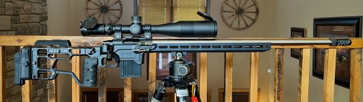

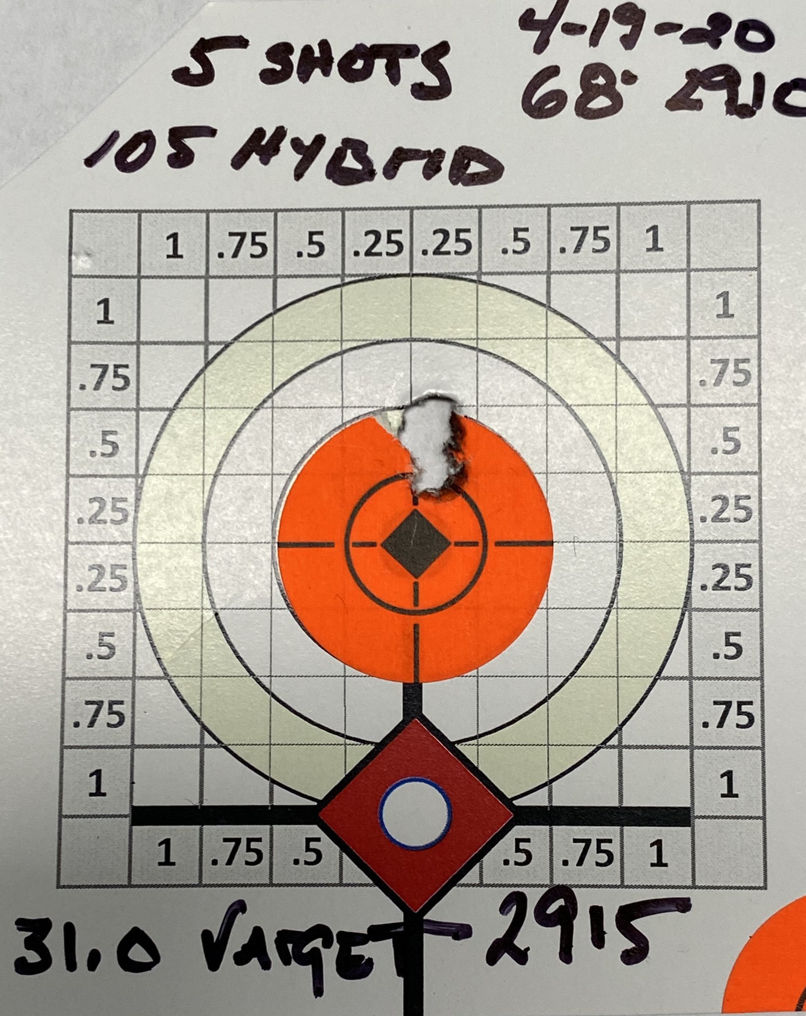

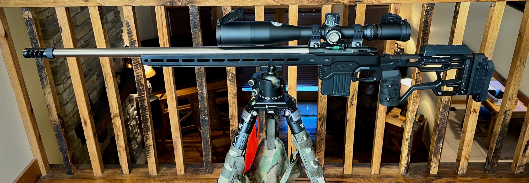

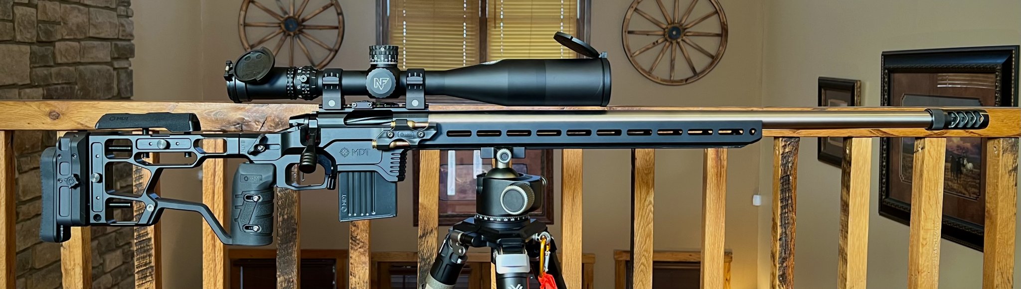

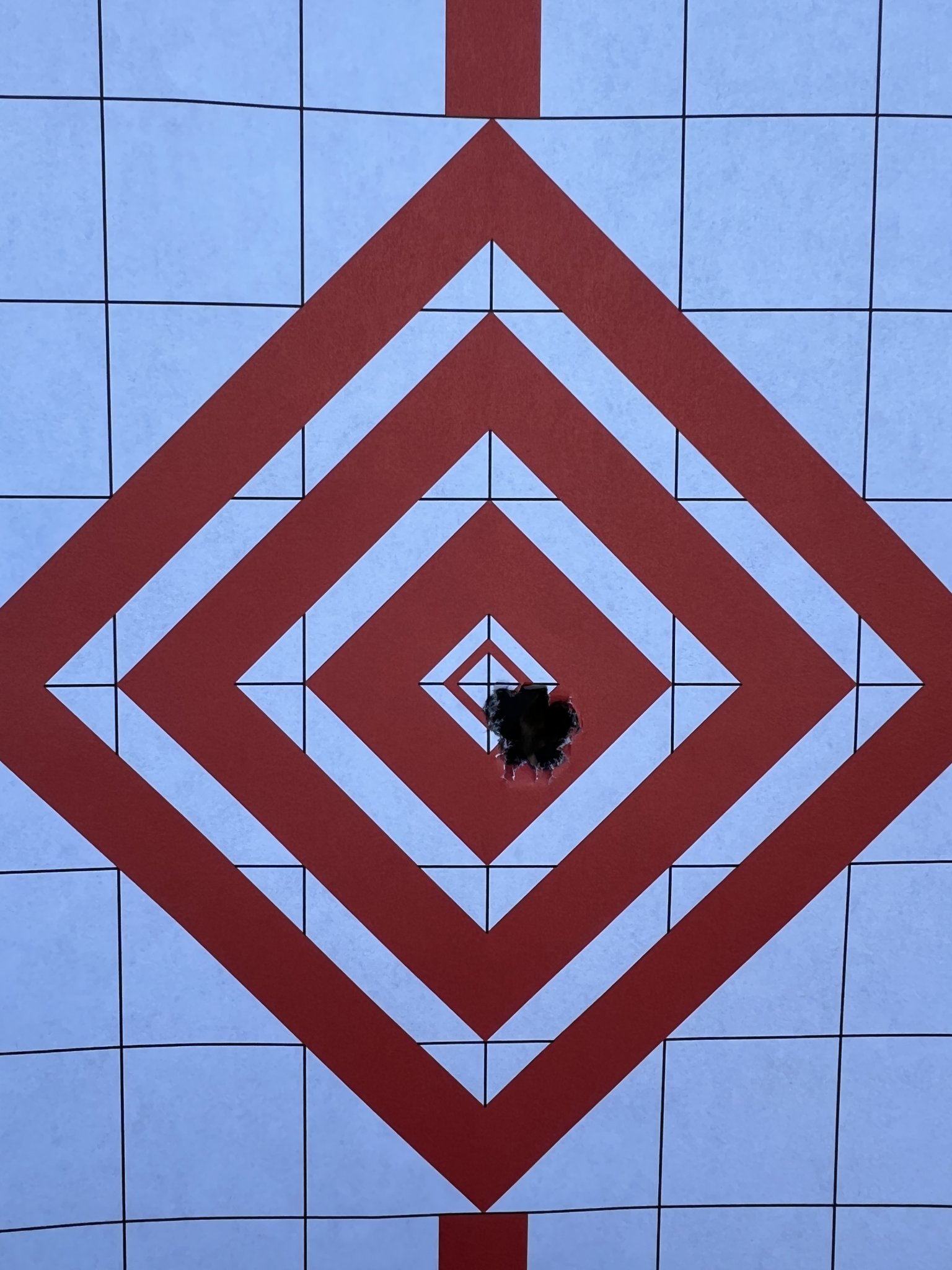

I can’t help with any matchburner data, but I think you will be happy with a 6 bra or 6 GT. I’m shooting both & they are both awesome. On my 6 bra I gave up on Alpha brass and am fireforming Lapua in a barrel that Alex Wheeler chambered for me. It’s the most precise rifle I ever shot except a 6 GT I put together from Impact Precision with Wade Stuteville chambering. Bought everything through them using advice from Tate Streater & Khianna. Though, on the 6 GT I wasn’t fireforming. I don’t know how my 6 bra is going to be more accurate after fireforming. It’s just one solid hole on a 10 shot string. I’ll post a pic if I can find it. Doesn’t look that great, but it’s off just a bipod without a rear bag.
Nice!
That group is from your GT or BRA?
Reactions: Lynn313
BRA, it’s just a fireforming load for a BRA Alex Wheeler chambered for me. No load development. I had given up on another bra barrel reamed with an alpha reamer & using alpha bra brass. I still have 100 more pieces of Lapua BR to fireform before starting load development. I had heard people shot matches while fire forming, but it was hard to believe. This is my 1st time to fire form. I do have a 6 GT that shoots as well.
Reactions: 762 ULTRAMAGA

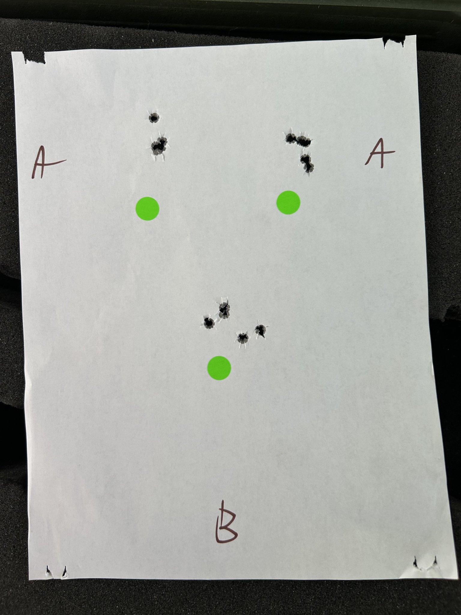

(The attachment is from load development, from 29.5 - 31.5 gr Varget in .03 steps - so every 5th shot. Second barrel just stayed with 31, shoots just as well. About a grain less for 4895)

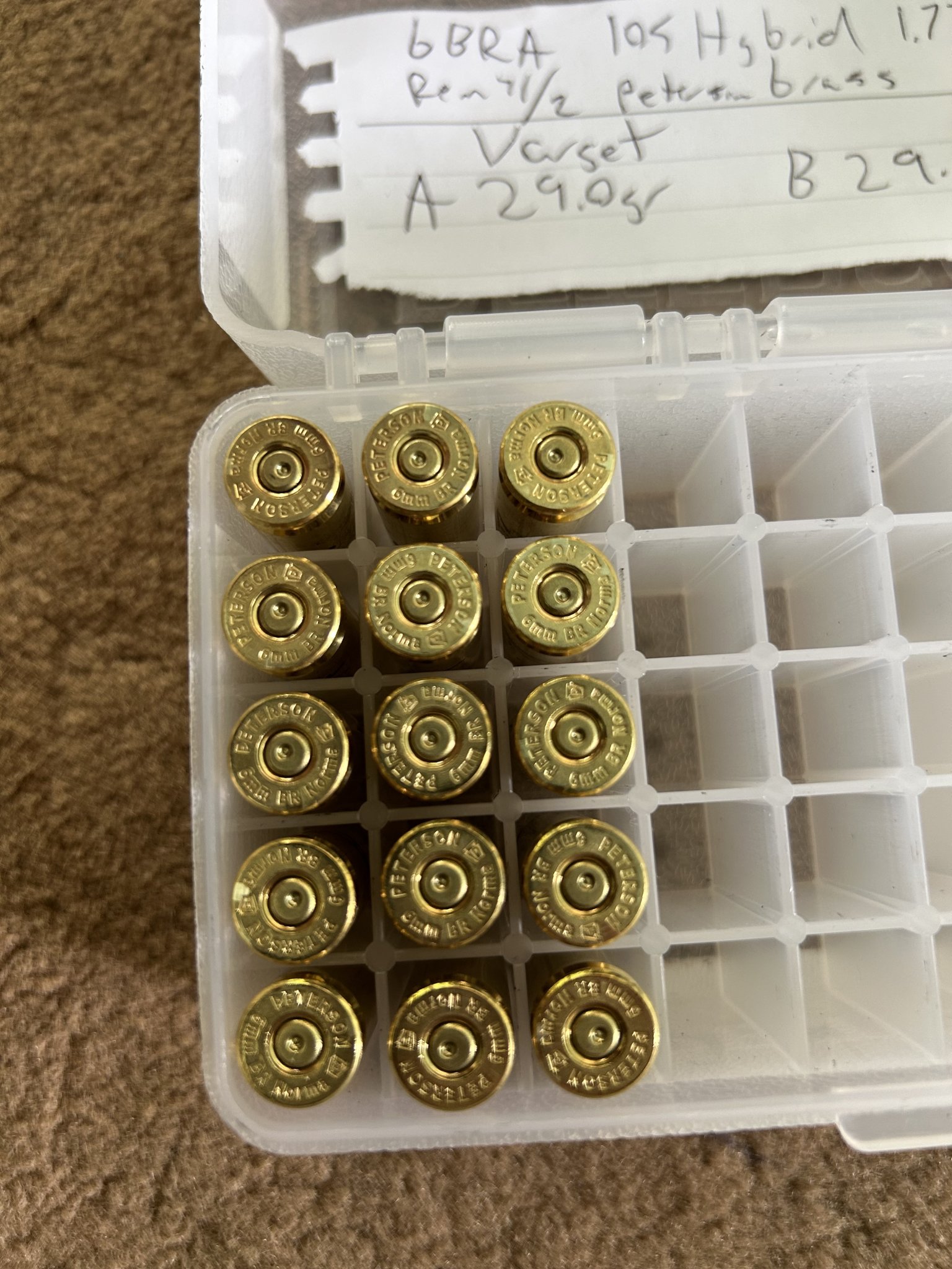

Put my new 6bra barrel on and I’m having some issues. First I loaded up some Hornady 108’s just to throw down the barrel and clean per the gunsmiths direction. After that was done I loaded up 5 Berger 105 hybrids. All of those rounds with 30 grains of varget, Peterson brass, rem 7 1/2 primers. They all had heavy bolt lift with ejector marks. Hornady shot like dog shit, bergers showed promise. So I went home and loaded up 10 with 29 grains of varget, 5 with 29.5 grains. All show ejector marks still, groups not great. 1 group had potential but opened up on last shot. 30gr varget with Hornady 108’s were 2780fps, 30 grains varget with 105 bergers were 2800 fps, 29.5 grains Berger 105was 2730 and 29 grains varget Berger 105 was 2690. Why am I getting pressure signs? Chamber is clean, primers look ok, speed isn’t through the roof. So my questions are:
Should I put more rounds down the barrel before I hope for better accuracy?
Ejector mark im seeing normal during fire forming?
Should I be doing something different?
I was just hoping for something to shoot under a half minute while fire forming and go shoot a few matches but results arent great thus far.
There is a total of 40 rounds down the barrel

Im assuming this is virgin Peterson BR brass? Speeds and primers lead me to believe this isn't true pressure signs. Im thinking there is too much headspace and brass is coming back and slamming your bolt face. I had this with one of my BRA barrels and come to find out that HS was too long and it wasn't supporting the brass when fire forming. I ended up jamming bullets and it went away until all my brass was fire formed. Easy way to check would be to strip the bolt and try to chamber a piece of brass. The BRA chamber should actually crush fit BR brass to hold it when fire forming. If your bolt drops free on a virgin piece of brass this is most likely your issue.

Are the projectiles seated into the lands, or are you jumping them?
Is there resistance when you close the bolt on your ammo prior to firing?
Who chambered your barrel? Is it a tight neck chamber? Did the gunsmith chamber it up to have 4 thou of crush on the first firing?
Yes virgin Peterson 6br brass. I’ll strip the bolt and report back.
Edit: I stripped the bolt and the bolt doesn’t fall when chambering a virgin piece of brass, it’s a crush fit.
Sorry I ment to mention that, jumping .020”. I stripped the bolt and the brass is a crush fit for virgin brass. Not sure on specs other than freebore is .104” I believe.
