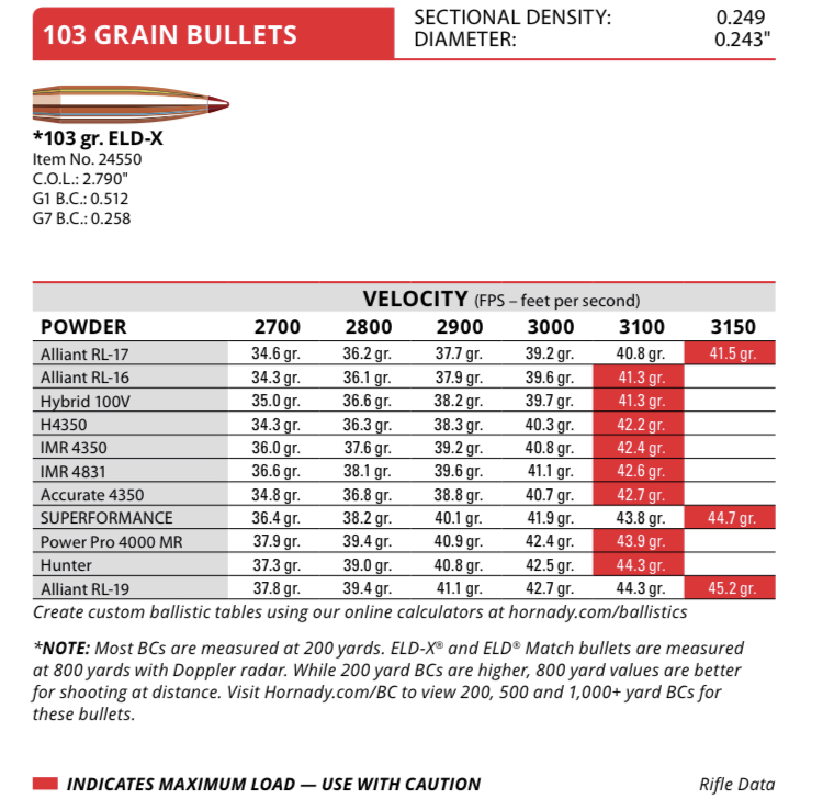

I’m new to the 6cm world I’m going to start with shooting 103gr eldx bullets and h4350 what is a good load charge to start off with for load development? Thanks
Straight from hornady
