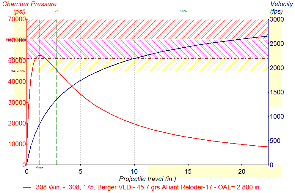

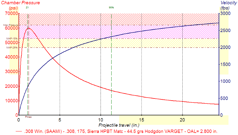

In this image, its for a 308 using varget, but in the first 6-7" the bullet goes from 0 to 2000 fps, it has to go another 9" to gain just 500 fps. Using a powder that its too fast will give you more pressure with less resulting velocity. A shorter barrel will just stop the chart sooner, not alter the pressures and velocity that is gained before the barrel ends.
And here you see that RL17 (from a different source so who knows what the rest of the backing data actually is but its a comparison image I could find) that it makes the same velocity with less pressure, shove in more powder to equal the above varget and youll get more velocity. Which is exactly what the rl powders are known for, just traditionally they are more temperature sensitive, the new introduced powders such as rl16 seem to have fixed that issue.
Both RL17 and varget are ideal powders though so not really a great comparison. But you can see that most velocity is gained right away though.
Think of powder burn rate as more bullet weight dependent than barrel length dependent.

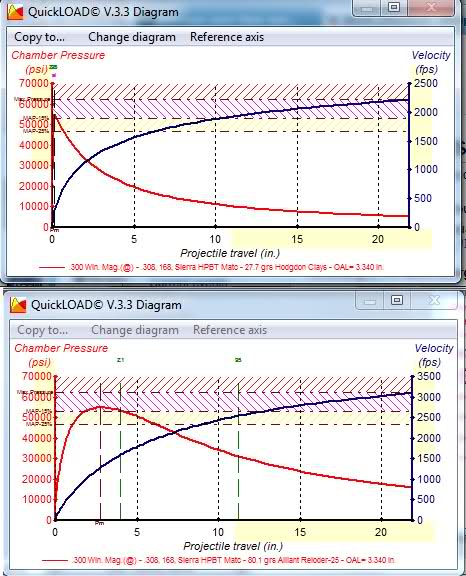

Edit: I found one, shot gun powder vs magnum powder in a 300 wm.
Both hit the same peak pressure of 52kpsi or so, the shotgun shoots way up high and then drops off immediately. Gets to 1500 fps in 5", at 22" its only going 2250 fps
The mag powder is slower to rise. But in 5" it is still going 1600 fps so 100 fps faster than the shotgun owder. Notice that it continues to build though where as the clay powder above starts to flatten out as the barrel length continues, at 22" its going 3100 fps instead of 2,250 like the shot gun.

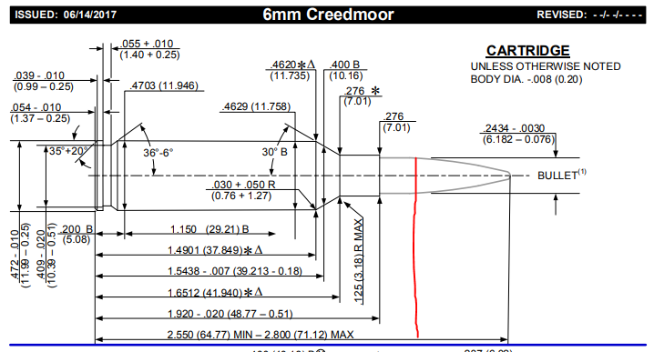

I'm using a COAL of 2.8" in my 6mm Creedmoor.
Is that the ogive measurement or entire cartridge? That is one of the things I'm getting confused about.
By the way, using Hornady, match grade ammo, my velocity loss was 210fps as compared to their published velocities. I also dumped some of those same loads and found a difference of one grain of powder in three cartridges which motivated me further towards reloading my own.
COAL =Cartridge Over All Length (COL Cartridge Overall Length)
CBTO= Case Base To Ogive
Unfortunately many use the terms interchangeably/incorrectly so you really just have to know what the provided measurement should be. Knowing that its a 2.7 number that would have to be overall length, the creed cbto would be in the 1.9X- 2.lowX region as shown with the red line, its in between the 1.920 number of the max case length and the 2.5 of the minimum COAL.

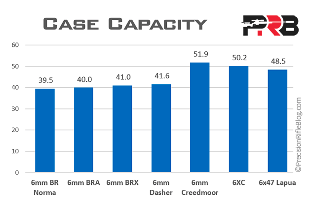

Milos suggestions of 51.5 for hornady and 51 for lapua are probably best but here is a clip from this years PRB caliber comparison
Charts like this are exactly why you want your own numbers. So many brands of brass. My numbers for 6x47 and XC were slightly less, and garbage in-garbage out applies. I need to weigh Dasher, yet to do it, QL does not come close to my numbers, lol
