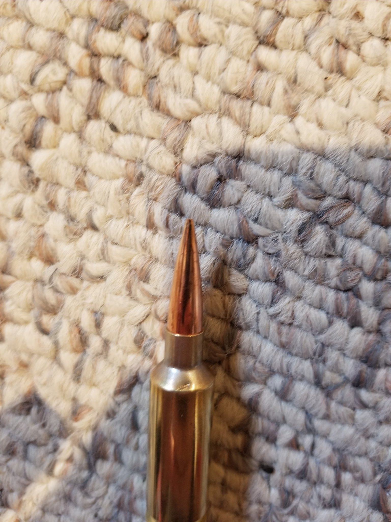

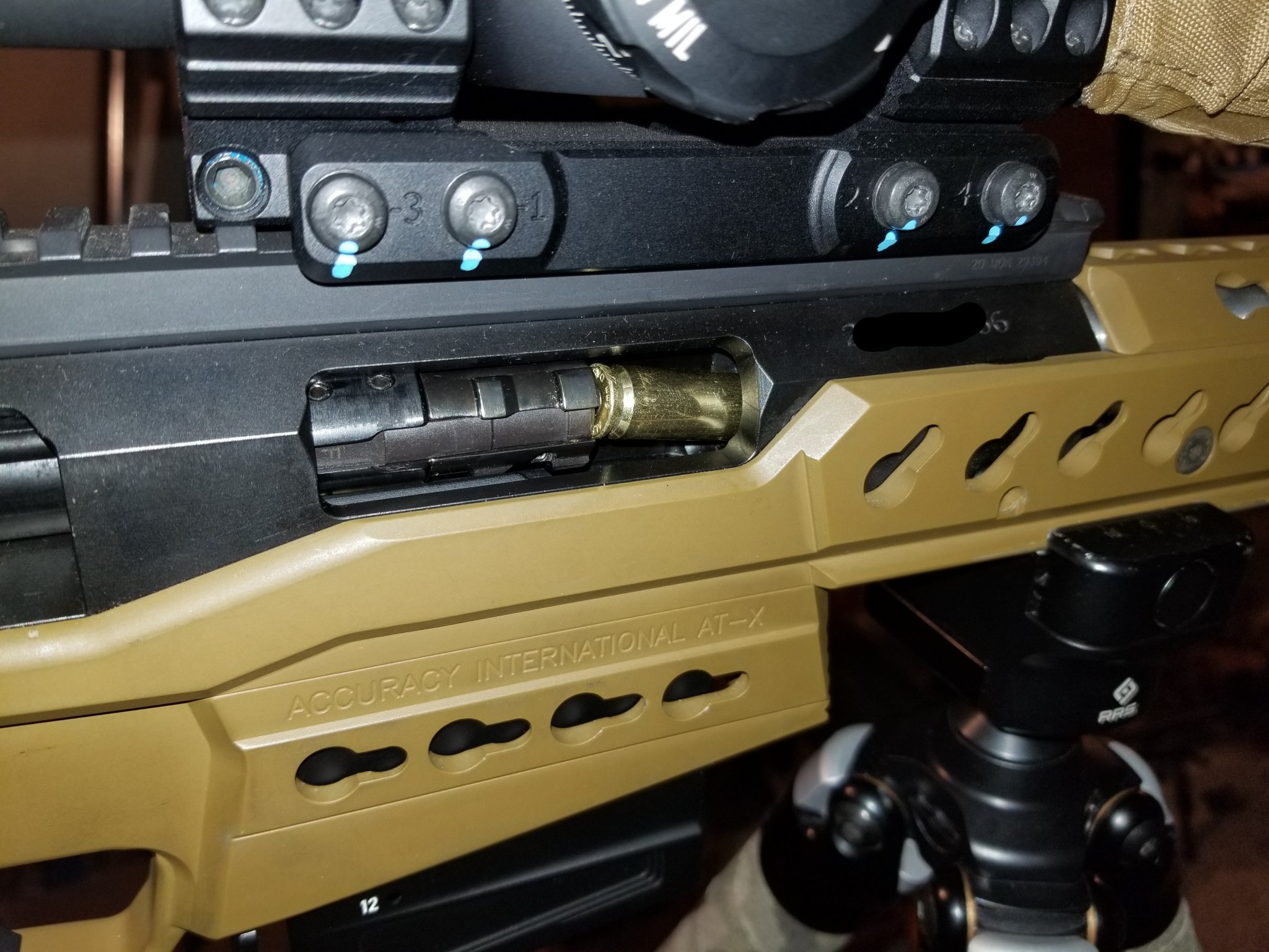

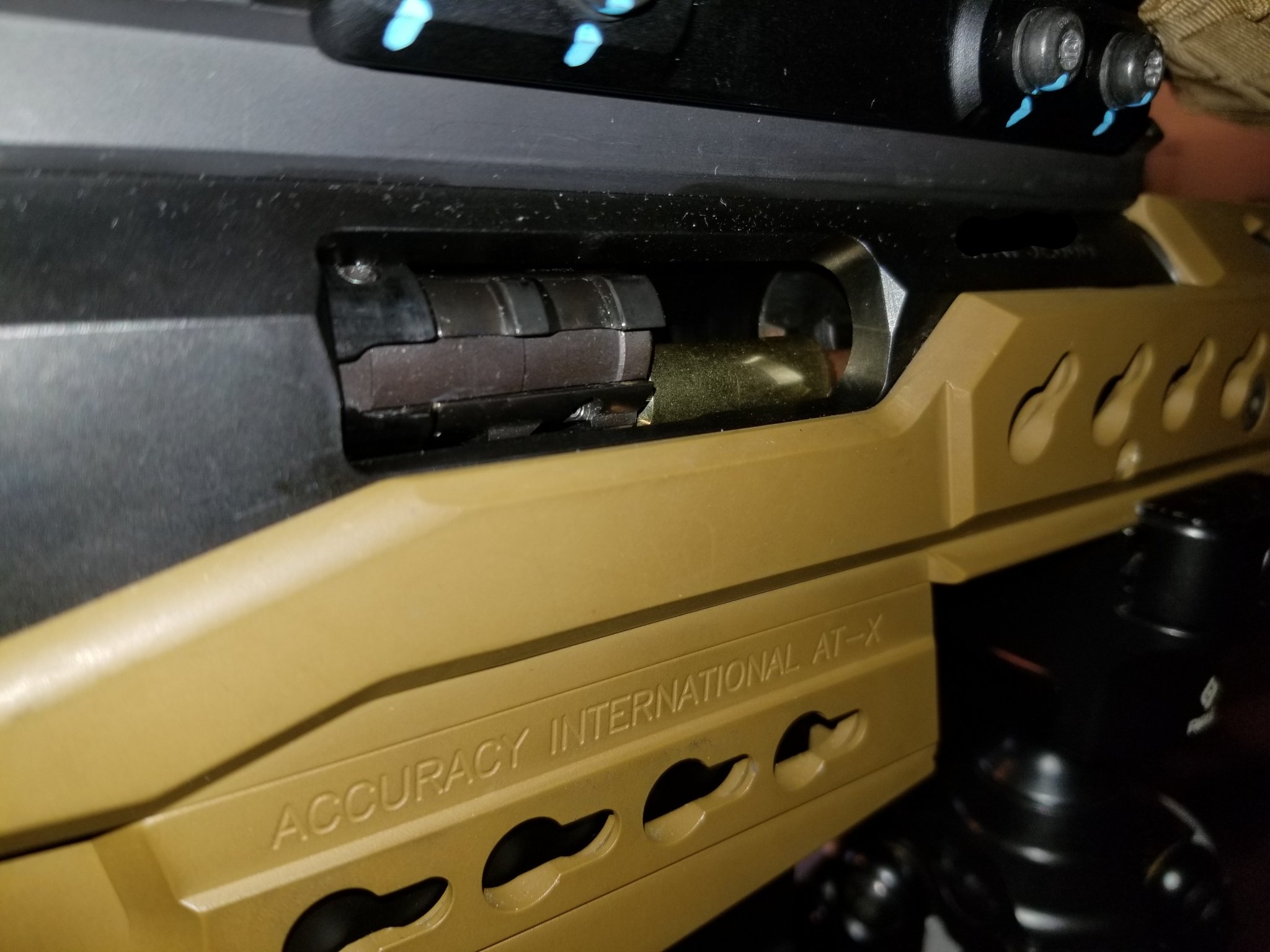

Could someone who's shooting 105s let me know what the OAL is on their round? I'm having feeding issues in my AI and I'm starting to wonder if the freebore is too short in the used barrel I picked up. Assuming a shorter OAL might be more picky with feeding.
