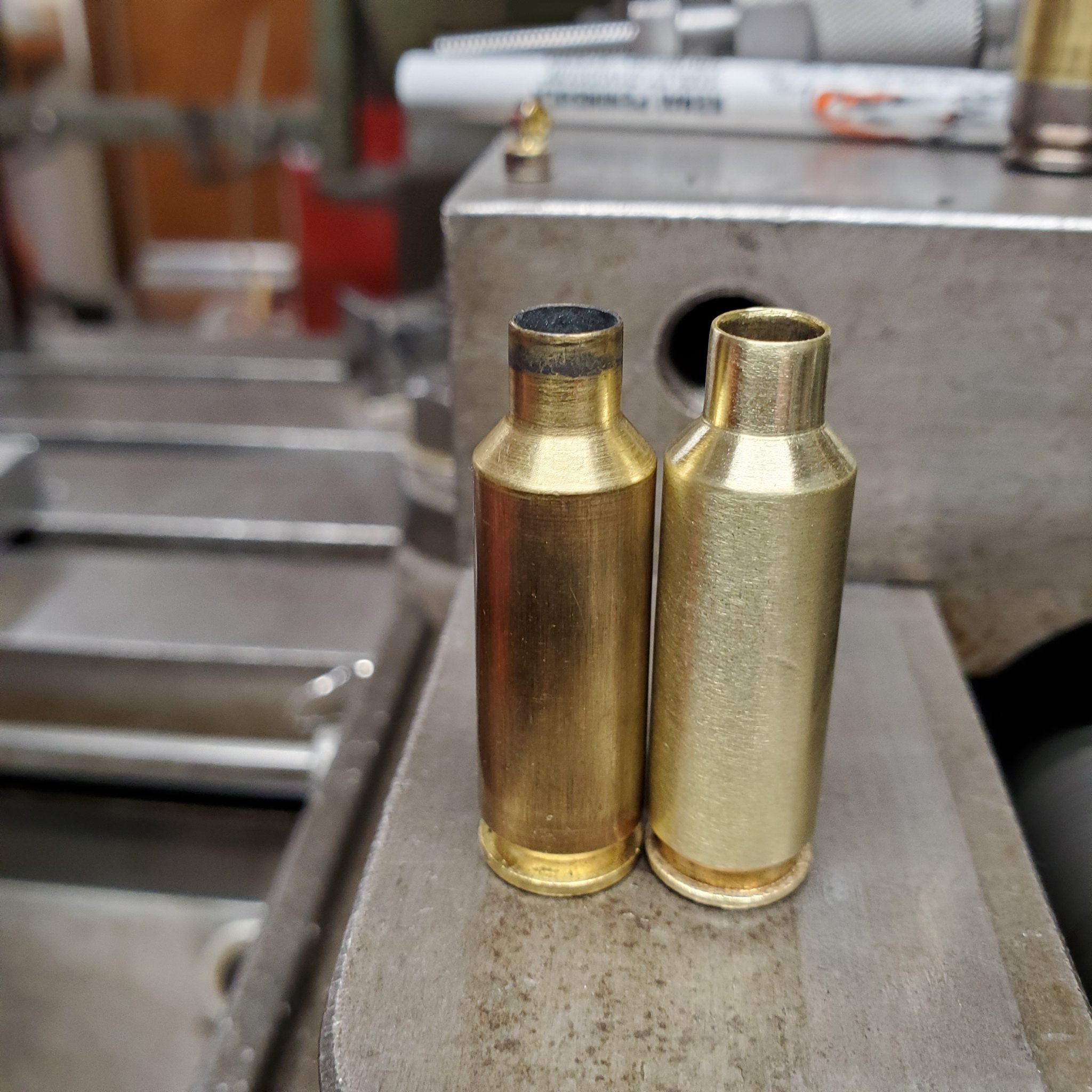

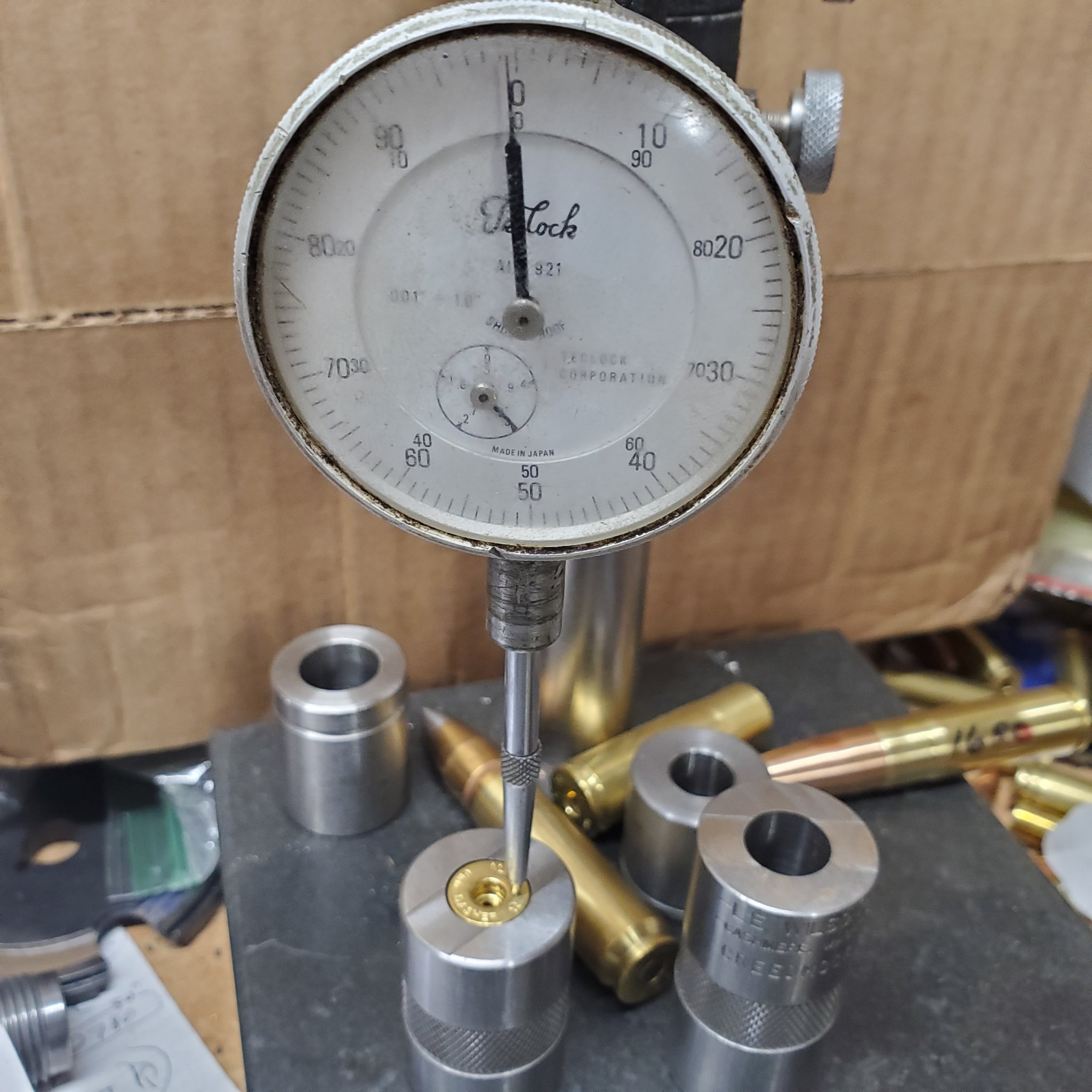

Guys with both Dasher and BR/BRA, do you find the "chambering a round" process (when you run the bolt and push the cartridge to seats it into the chamber) to be less smooth on the Dasher being a 40 degree shoulder?

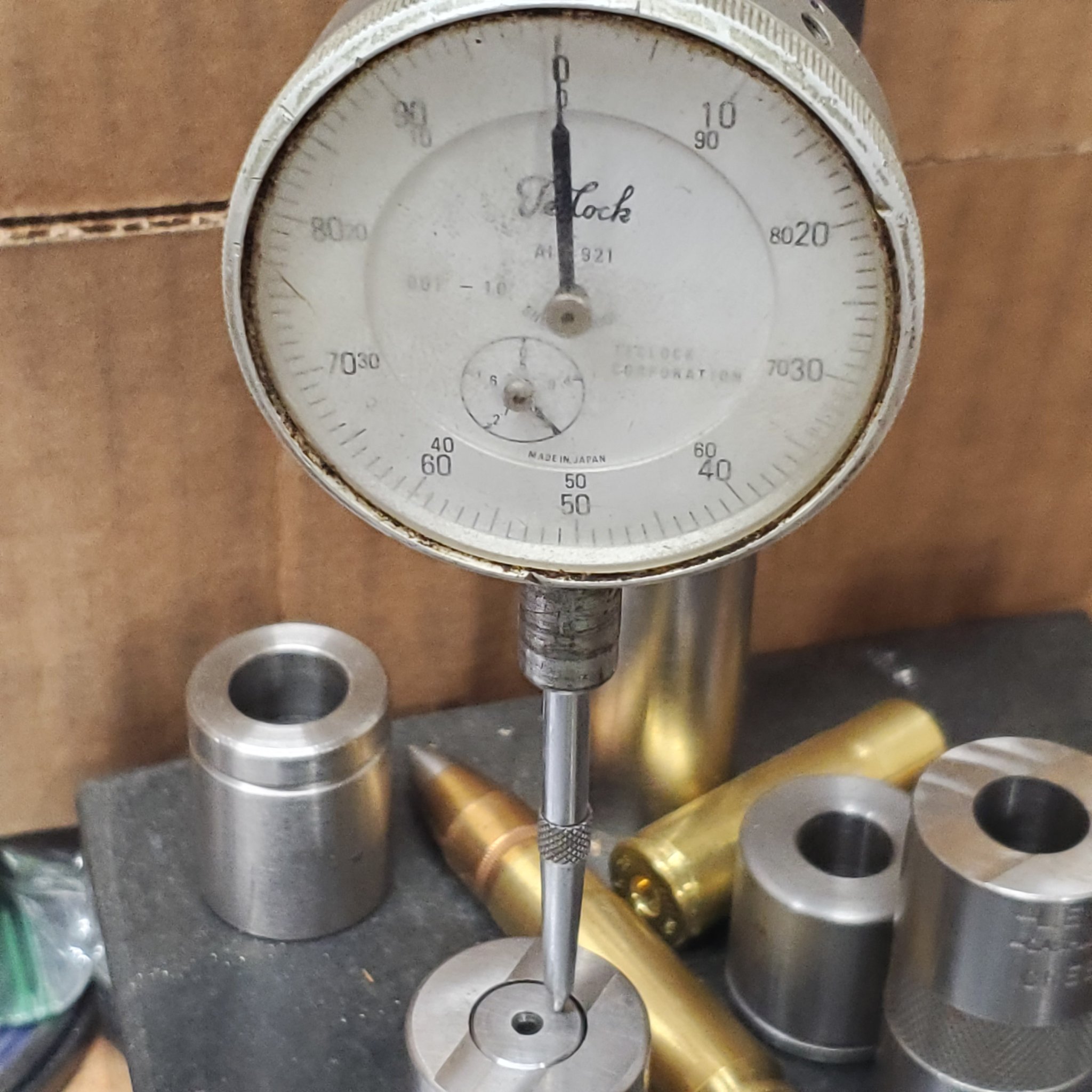

On new 6dshr alpha brass does anyone recall what the headspace measurement is using a comparator? Im trying to get a reference # to compare to my fired, and didn’t write it down.
I used the Alpha 6 Dasher brass as a go_gauge when I chambered the rifle checked against the real go-gauge as a resistance feel.
The new Alpha brass reads a couple ten thousandths difference, than when the go-gauge is installed in the Wilson gauge...or about the same.
So there is a little drag when the bolt closes...so now one can run this brass up to high pressures right out of the gate, on the first firing, if ya want, like 110 SMK at 3085 fps.

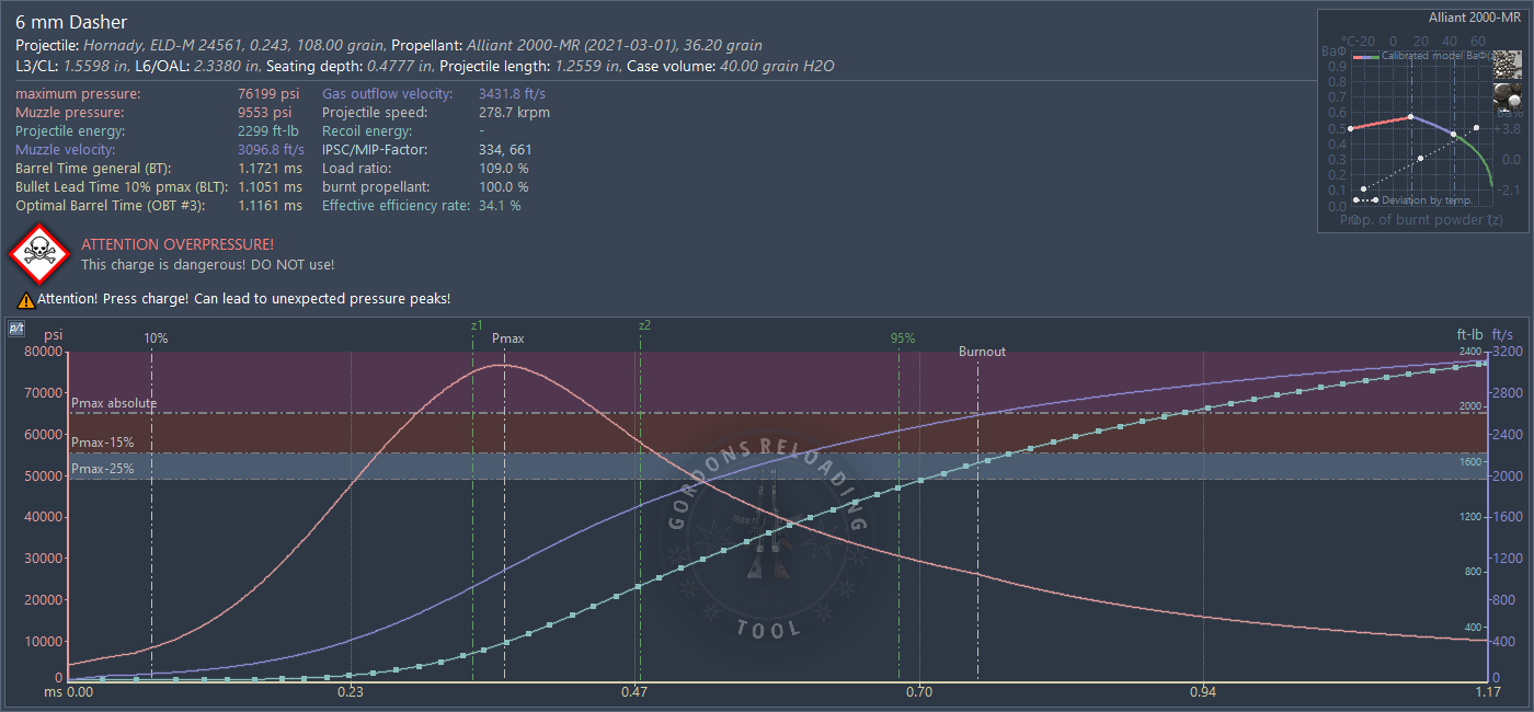

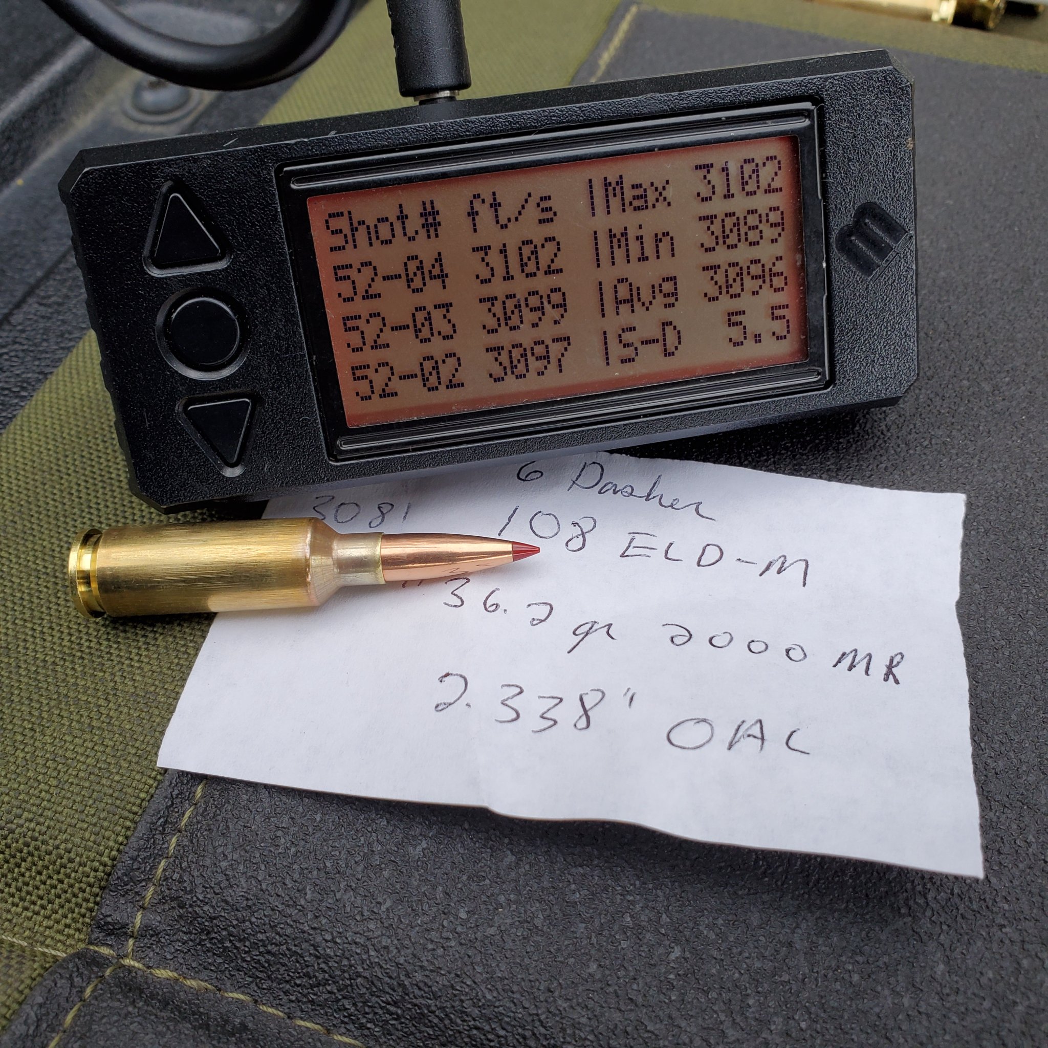

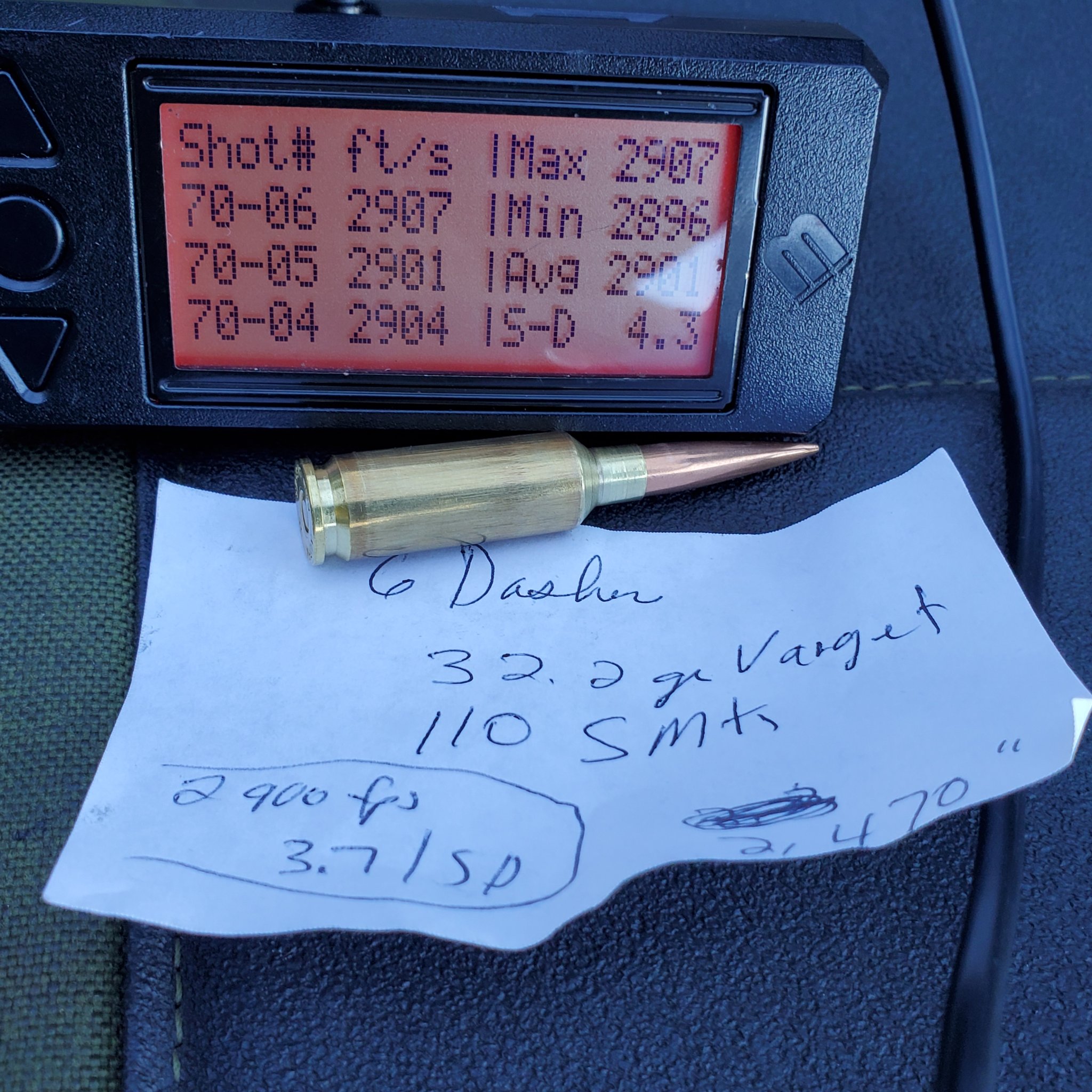

What do you think the chamber pressure is in a Dasher pushing a 110 SMK at 3085 fps? 75k? 80k?
Reactions: LR1845
Depends on the powder choice.
According to QL 61,866psi to 69 919 psi
Alpha will take 70,000 psi loads if one cares to go there, according to the manufacturer.
BAT actions and alpha have been shooting way above that for quite some time.
Go to Ultimate Reloader and watch a couple of videos on "Don't Do This At Home." They were runing tests over a predicted 100,000 psi in 308 Win on the first, and tested these high pressure loads at 12 or 1400 yds on video.
Then got actual pressure measuring equipment and ran the 6 CM to over 86,000 psi.
That's more pressure than I run in hybrid cases, which I can make into 6 Dasher if I want from the 277 hybrid case which is rated at 80,000 psi.
This is On video, new developments and experimentation and so it goes.
But don't do this at home.
6.5 CM to 6 Dasher...now ya have a LR primer...

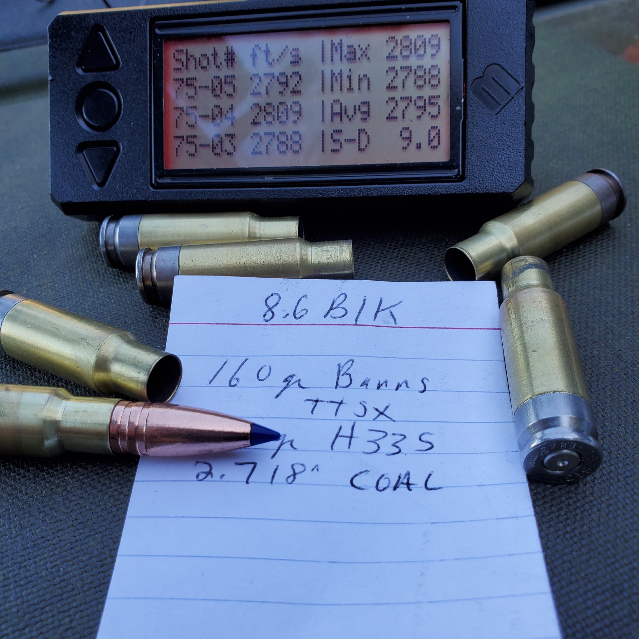

I run hybrid cases in the 8.6 Blackout hit 2800 fps with 160 gr Barnes and 2600 fps with 200 gr Speer in the 6.5 twist.
The 3 twist has been abandoned its really a low velocity sub only and slow even with copper bullets. Change to 6.5 twist get high velocity and good accuracy on subs, & supers, with no velocity limitations on lead bullets or copper subs. Win, win, it's now a dual purpose cartridge.

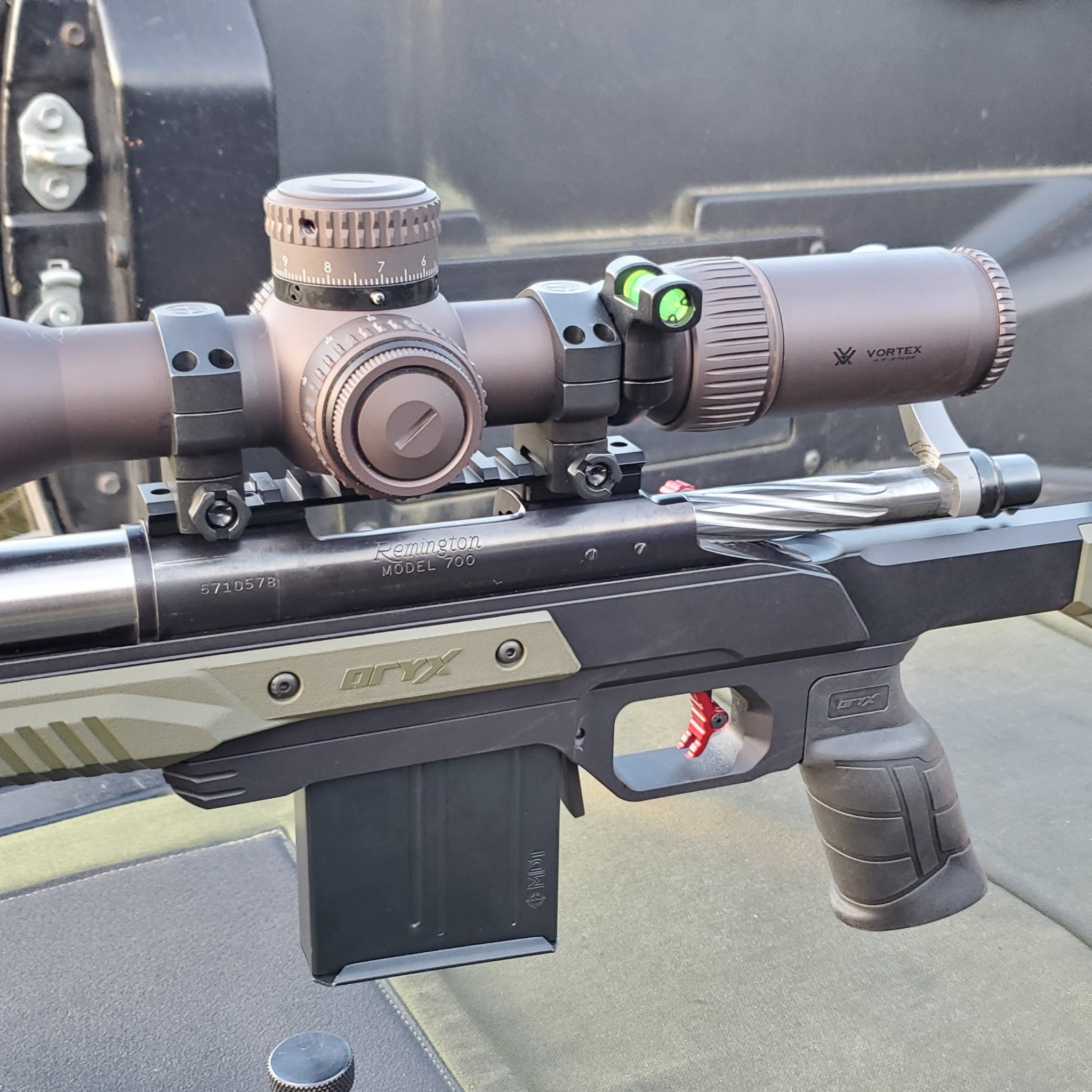

Hi all, I just dove into the deep end of the 6 Dasher pool. I have a Proof drop in Ai-AT barrel, 200 pieces of Alpha brass and dies on the way. I've got good stocks of Berger 105 Hybrid and 109 LR hybrid as well as 107 SMKs. For powder, I have lots of Varget, 4166, H4350 and 4451. Primary mission statement is LR steel out to 1500 yds. Not so much PRS.... yet. Although I'd like to get back into it. BUt my AI-AT is not the right rifle for it.
My question is which powder, bullet, charge combo would you gusy recommend to start with. From reading here, Varget sounds like the GO TO powder. What charge weights and bullet would you start with?? Finally, bullet length recommendations? Do Dashers like to be jumped or just in contact with the lands?
Thanks in advance!
Thanks in advance!

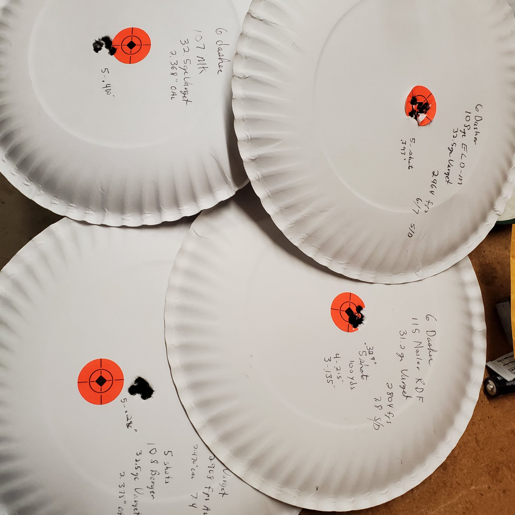

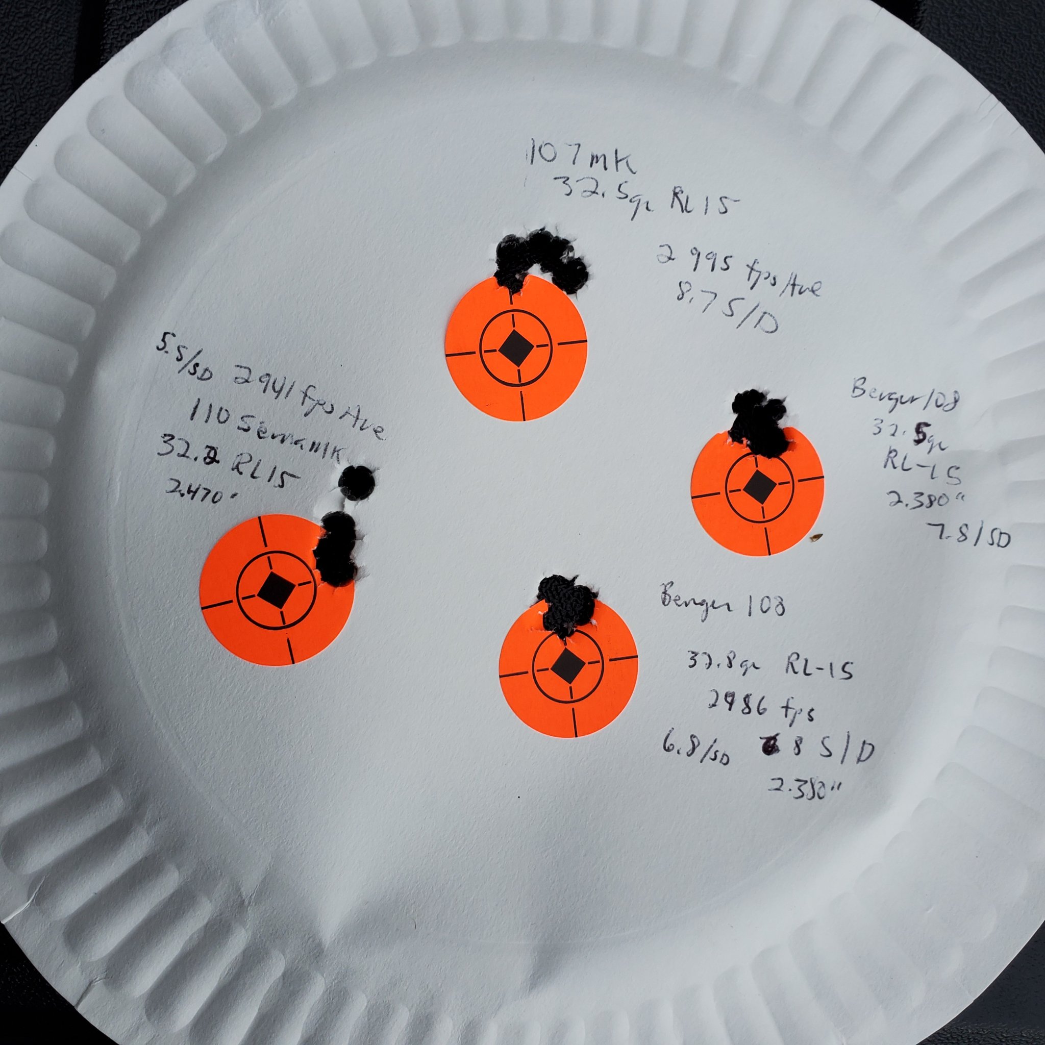

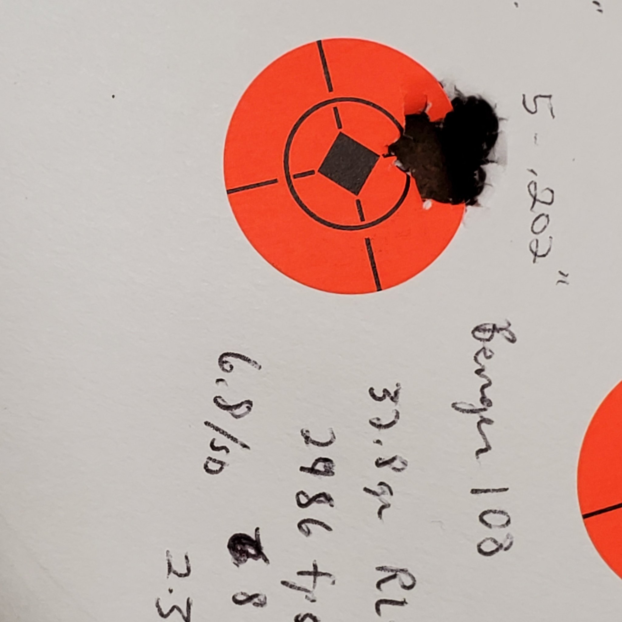

It's a 6 Dasher, you'll be hard pressed to shoot something as large as 1/2".
Sometimes I can't shoot good enough to to tell which powder is best.
13 different loads on one outing averaged .313" for all 5 shot groups.
The 108 Berger shoots in the low .2s or less with RL 15, I can't shoot much better than that. If one is a bit off it's likely the old man behind the gun.
I do not jam any bullets these days, just set them a bit back from the lands, and the COAL depends on your free bore.
I have my own finish reamer it's a .104" free bore with .272 neck set up for Alpha Munitions brass, and 7 1/2 Rem primers. With 28" Bartlein 5 R 7.5 twist M24 profile.
1500 yds is no problem...except the tiny 6mm bullets don't have much of an impact signature. And light thin steel so you can hear it ring.
I run the 110 SMK at 3085 fps for the LR steel.
Out west I use a rock cliff to see impacts, then go to the target...or just paint a white 10" circle on tbe rock cliff...then put up soda cans or one liter jugs to shoot.
When you post things like "I run 110 SKS up to 3085fps" as part of reloading advice for someone who's admitting they are just starting out with the Dasher, you really should include something along the lines of "but that load is probably pushing 70k psi" so use at your own risk.
Sometimes I wonder if you just post shit like this because you're hoping someone will take your advice and ruin their rifle and maybe their face along with it.
I didn't realize Alpha was actually recommending that folks load their brass to 70k psi pressures - are you sure they've publicly recommended that?
The same for BAT machine. If I call them and say I'm going to be feeding their action a steady diet of 70,000+ psi handloads, what would they say?

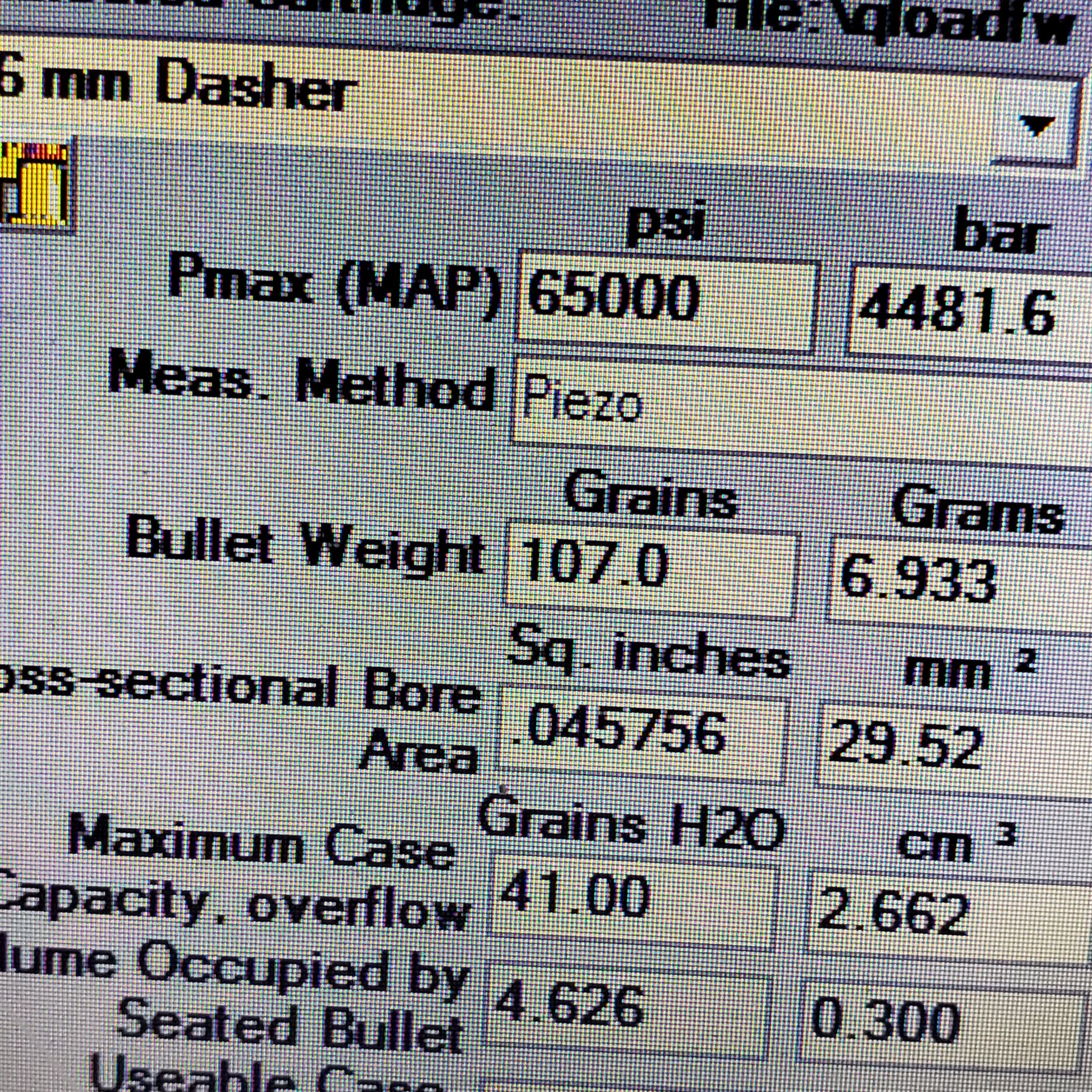

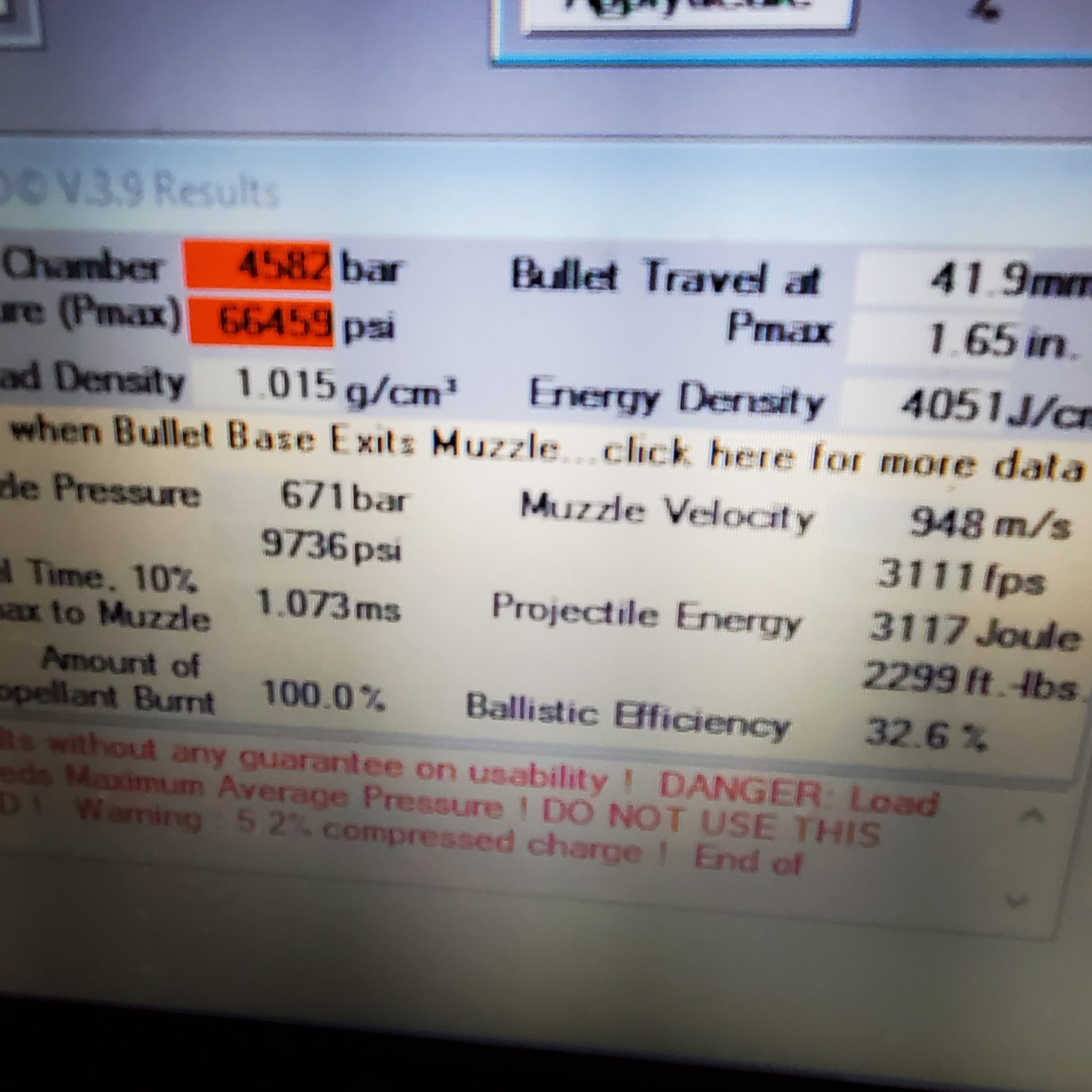

Depends on the powder ...
Here is a 6 Dasher 65,000 psi max working pressure.
Here is a 107 gr SMK over 3111 fps with only an extra 1700 psi above the max pressure 66,7459 psi for the Dasher.
One has to work up and verify, but the opportunity is there to run these just as well as your 2800 fps loads, if they meet your accuracy criteria.
You do not have to do so obviously, & no one cares if ya do or not.
But I choose to run many of these loads in several of my rifles with mostly hybrid cases rated to run 80,000 psi. I do not run them at 80,000 psi but leave a cushion, with a nice increase in velocity in many cases.
US military runs the 80,000 psi loads by the thousands, in full auto, that's where the cases come from, the extra speed to penetrate Russisn body armor in a 13" barrel, where cost is no option.
You can buy the civilian version, but semi auto only, complete with suppressor, for alot of cash, and do mag dumps with 80,000 psi anmo at your local range.
All this is on video, dumping mag after mag of 80,000 psi ammo in close quarters high speed drills, like it was a 300 blackout.
Times are changing, new developments are here, and more will be presented.
Were not much different than the 1898 Mauser and smokless powder.

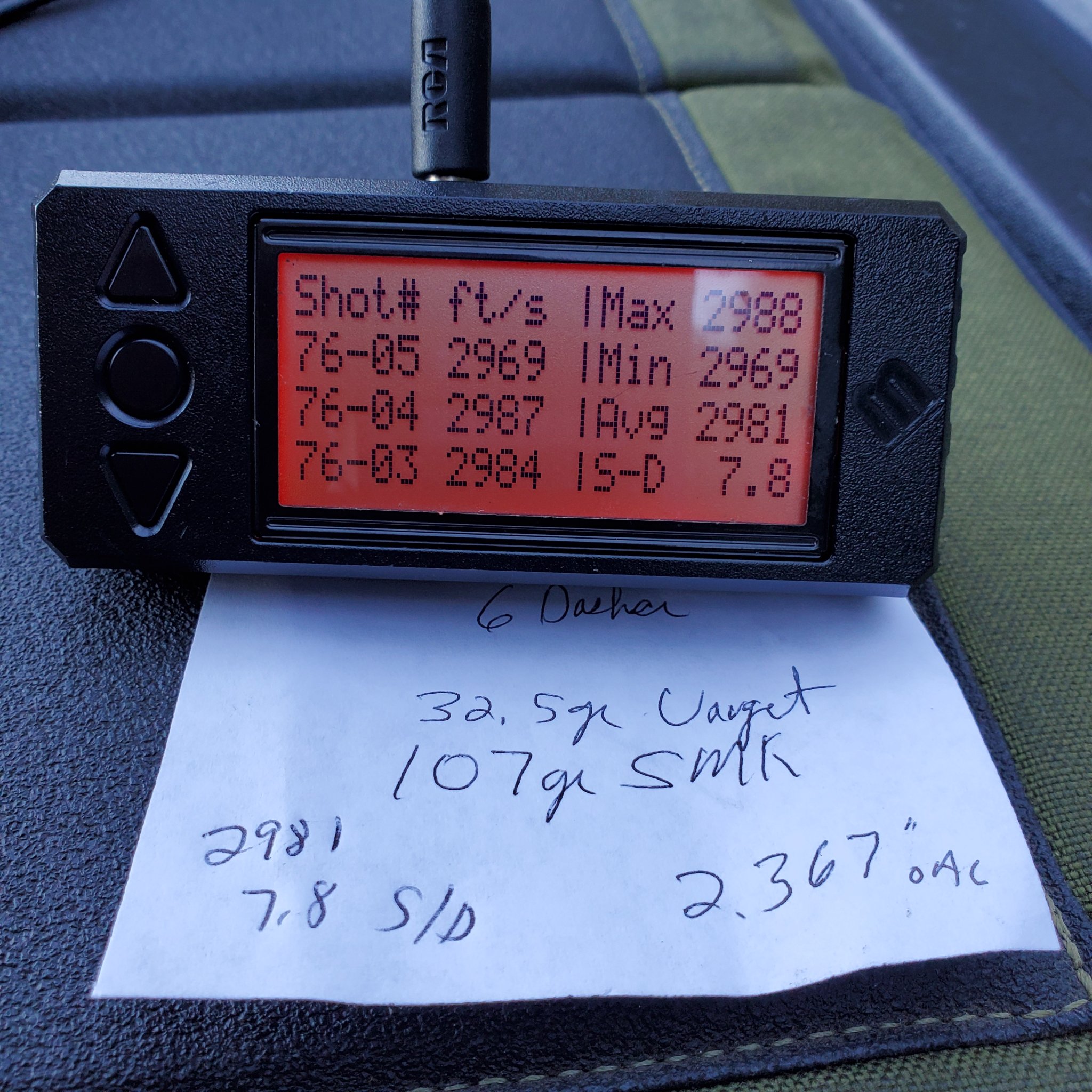

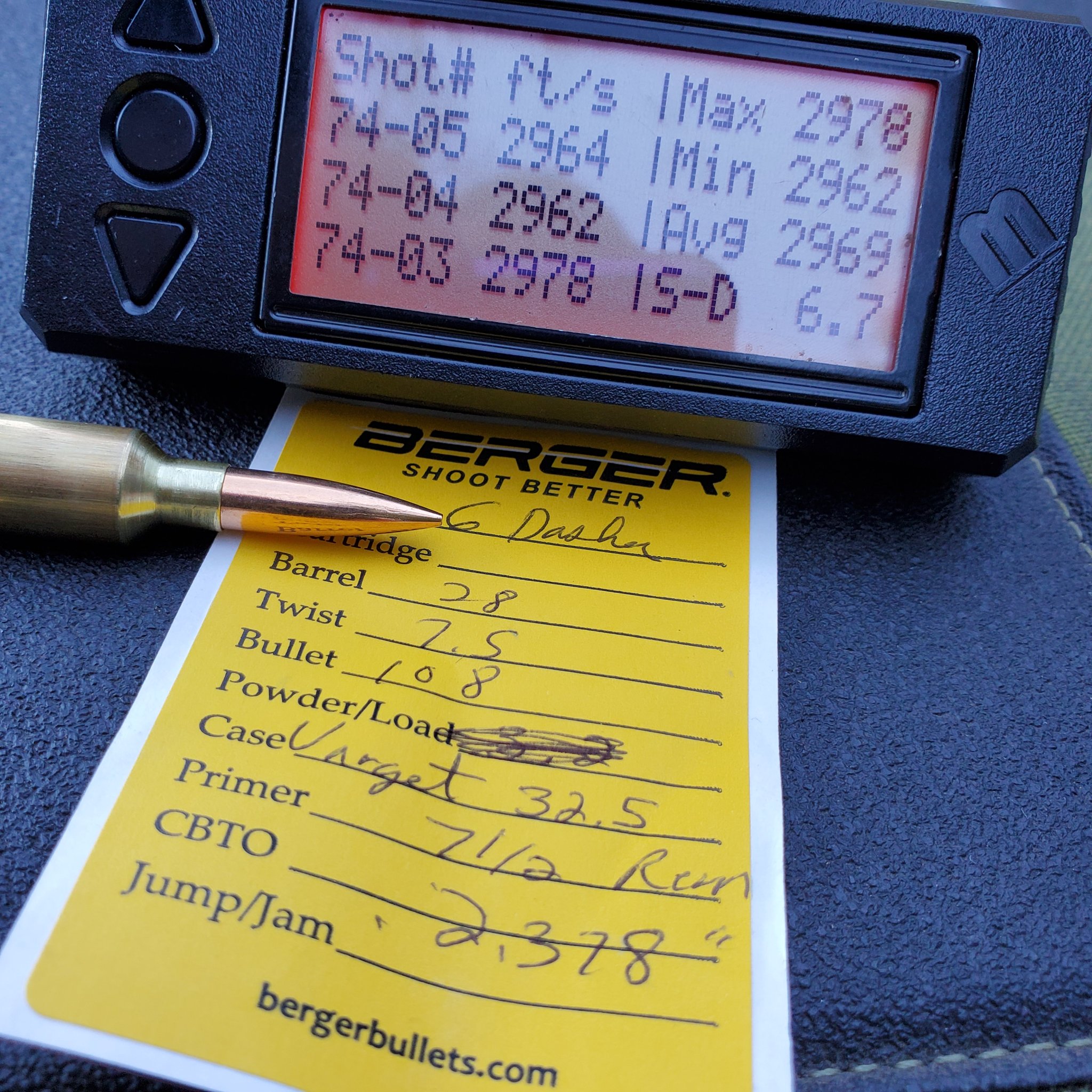

The load details are right on the targets above for My standard target loads.
So there they Are!
No 3085 fps loads were their so they can not be copied.
My Varget loads are listed as I was trying a bunch of bullets and several powders that day... my gun was liking RL 15 and 108 Bergers around 3020 fps.
But back to Varget everyone's favorite.
Notice my 108 load posted above is 32.5 grs of Varget, the speed was around 2980 as its 2988 fps with 108 eldm.
But you naysayers say it too fast can not be done, with a 26" barrel and I'm cheating with my long barrel that 28" barrel, I should take 2" off and fall in line at 2800 fps.
So pay very close attention...
Here is what the pros use for real.
Go look it up.
The professionals use 6mm Dasher
Most all use Varget
Most common is 26" barrel.
Most all use 105 gr Berger Hybrids
Varget is the powder and they use a very narrow window 32.3 gr to 32.5 gr of Varget.
Winning Varget velocities are 2925 fps to 2975 fps for the 26" barrels of the pros.
They run thousands if rounds a yearly at these velocities.
I heard on the shorter ranges they like 2800 to see the trace, to spot. But at longer ranges you have a lot of time and the extra velocity will be a plus in the wind.
Just the facts.
A new reloader or new rifle should always work up to these "pro" loads, but doesn't everyone who reloads know that.
And ya don't have to use their loads either, funny how my target loads and theirs are the same charge weight of Varget....maybe I know something after all.

Most are identical to what I'm shooting for my standard loads above.
The cartridge was designed for 105s to 108s at 2950 to 3000 fps .
In 25 yrs no one was endangered on the bench competing with a 6 Dasher at these speeds. A few changed powders an competed at 3050, but decided it wasn't consistent enough for competition.
Do you even have a 6 Dasher?
Let's see your targets?
Your rifle in 6 Dasher?
Have ya ever shot it past 800 yds?
Have you shot most bullets available from 55 gr to 115 gr?
Have you tried a variety of powders?

And here is what I call acceptable load data.
Most Dasher shooters have been shooting very similar loads for a very long time.

And so here is one of those experimental loads that's "totally unacceptable.:
"Do not do this at home."
108 gr 3100 fps...it might "blow your head off...really."
Checking the 70,000 psi claim, no loose primer pockets, with alpha brass...is what I found out. Long before the videos online, they just took it to the extreme.
Although seemingly pretty consistent, one guy shot the powder in several matches and abandoned the powder, as did I, for a more gentler powder for the 110 high velocity load that I like ....that no one else should use...ever.
For entertainment purposes only.
I tested the Alpha brsss so you don't have to...
And why I know my go to target loads are safe in my rifle, as they are in thousands of rifles over 25 yrs of target shooting and setting records at 600 yds and 1000yds, with 105 gr to 108 gr match bullets 2970 to 3000 fps....before the introduction of the 109 Berger. Just the facts.
I have lots of experience with the Dasher experimented with it in most every way possible, I chamber my own barrels so I'm not a round counter these days.

I know you probably felt like a badass when you typed this, but it's not the burn you think it is.
Hopefully it'll make it clear to less experienced folks looking for load data that your intent isn't to help or to educate, you're just here to brag and stroke your own ego.
And so your Dasher identifies as a 6mm Creedmoor...good for you, I guess. If I want to throw a 108 at 3100 fps I just shoot my Creedmoor instead of the Dasher. 🤷‍♂️
Anyways, I plugged your 3100 fps 108 ELD load (same powder, charge wt, OAL, 26" barrel, with estimates from my components for the data points you didn't provide like case length, case capacity, or projectile length) into GRT. And after truing it to the chrono data in your picture it came back with this:
That's an estimated 76,199 psi.
17% over the 65,000 psi max you keep quoting for the Dasher (already above the 58,000 - 62,000 psi that many books use), and a little more than 6000 psi (or 9%) more than the 70k that you keep insisting Alpha brass is "rated for." I sent Alpha an email asking if they actually recommend doing what you say they do. I'm interested to see what they say.
Granted it's just an estimate made by software and not actual measured chamber pressure (and you may have a slightly different case capacity, case length or bullet length) but it's not like you're measuring chamber pressure either. At best you're doing the same - using QL or GRT to make an estimate - and then hoping the actual pressure is within the safe limits of your system.
Maybe you don't shoot in bad weather, maybe you do, but have you water tested this load? If not, what do you suppose would happen if you got a little bit of water on your ammo?
If we're talking about PRS we shoot in the rain, and our gear can sometimes get wet no matter how hard we work to keep things dry. A slight film of moisture on a case can quickly turn what may be only a warm load when dry into one that's popping primers. I've seen it happen more than once to inexperienced guys chasing the upper end of velocity. They can end up with locked up actions and gas cutting on the bolt face of their rifle.
Franky, it's almost like you're just stuffing as much powder in the case as will fit (see the 109% load ratio on that 2000-MR load), crunching a bullet down on top of it, and trusting your Alpha brass to hold together while you get some wicked hot chrono numbers to post on the hide.
Which is fine I guess...you do you, boo.
But that doesn't make it a wise choice for a shooter wanting to load the Dasher in the context of shooting PRS matches.
So ya don't own a Dasher either?
Even old load data from the 2020 Anual Manual has 107 SMK at 2978 fps at a mere 62,000 psi in the manual ....I actually shot it.
Did You?
The velocity was 3020 fps in my barrel.
Only 80 fps to go to 3100 fps.
