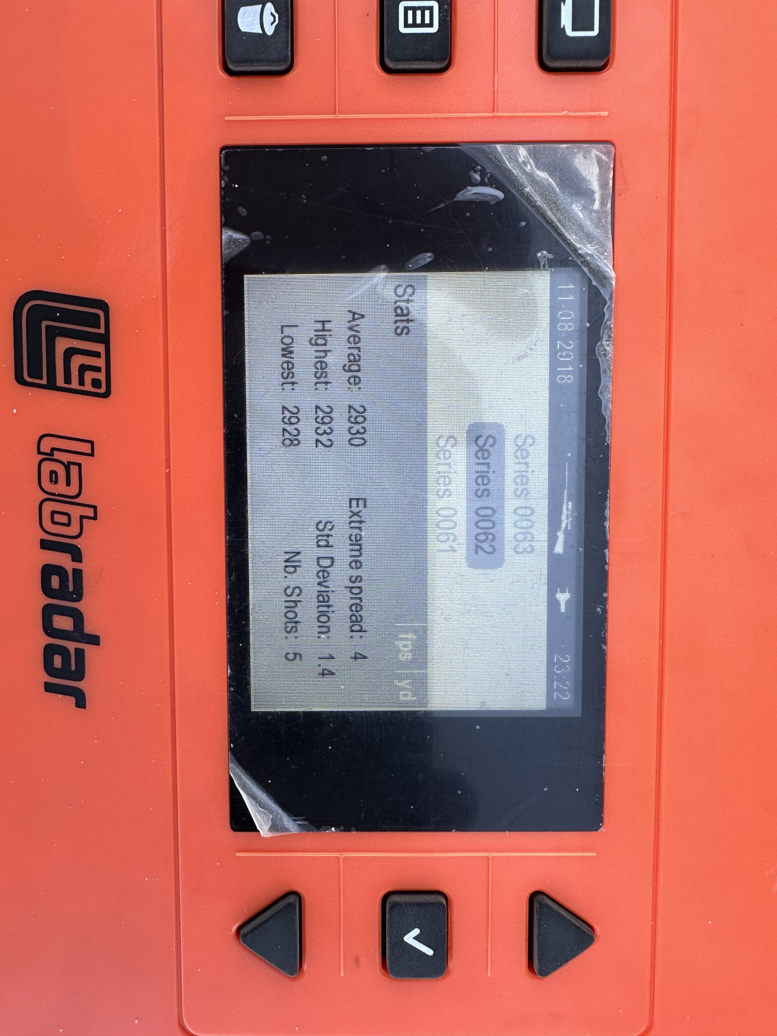

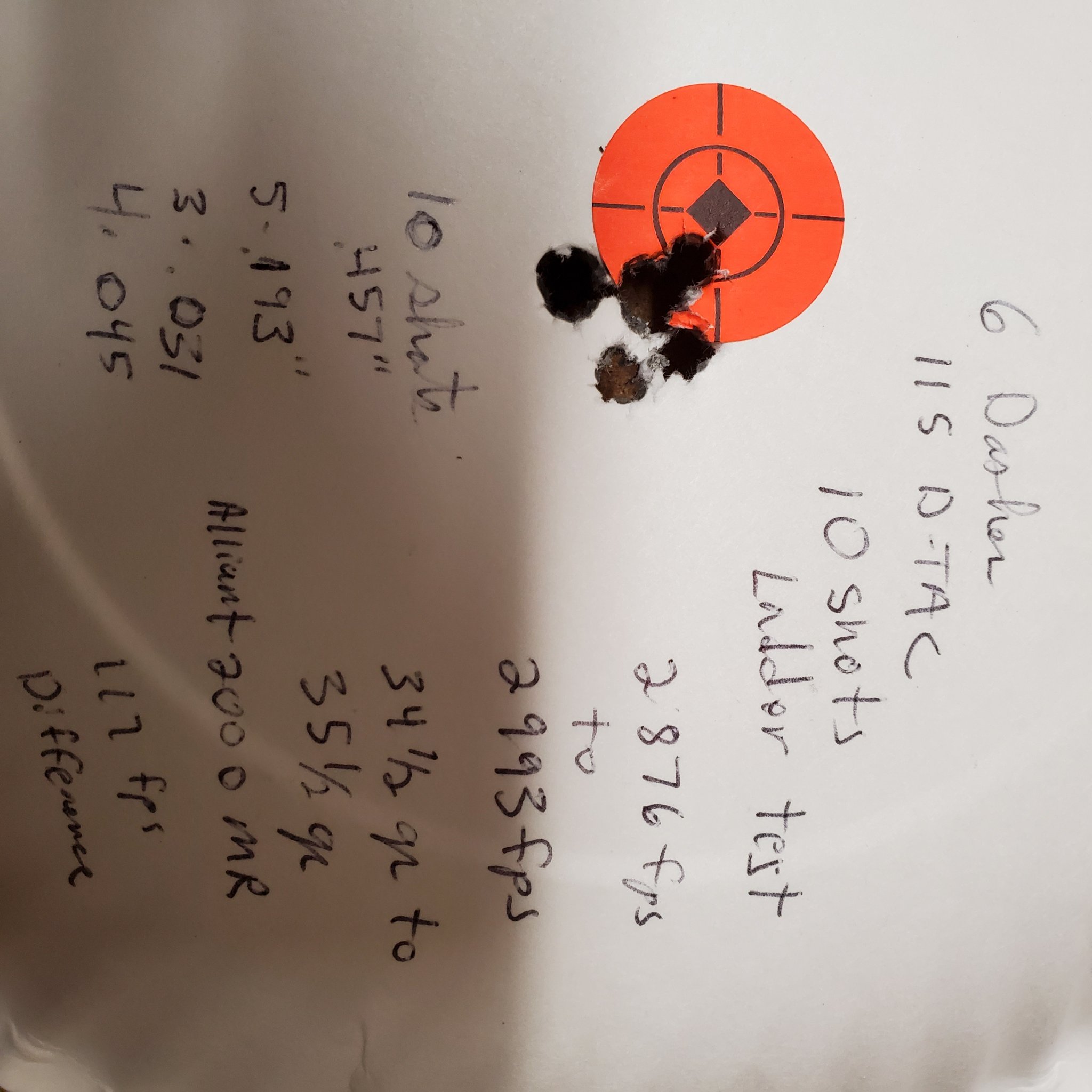

Load notes show 115 DTAC in 6mm Dasher 31.5 gr H4895 = 2894 fps
35.6 gr 2000 MR =2997 fps
35.8 gr 2000 MR = 3022 fps larger S/D
Nosler 115 gr 31.2 gr Varget = 2804 fps
Nosler 115 gr RL-15 31.5 gr = 2848 fps
The 115 gr DTAC with 2000MR load in a ladder test at 100 yds showed good possibilities at several higher velocity points in this 10 shot group, going to the top velocities S/D were higher.
H4895 was a small group shooter at 2800 fps.
6.5 Staball is fastest, and fairly accurate, at 3020 fps.
