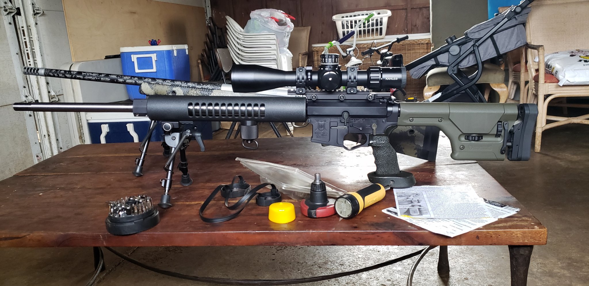

Just received this from 6mmar.com
6mm turbo 40°
I havent shoot it coz im still debating if im going to keep it :)
26" bartlein gain twist 8.5-7.75
