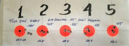

Well I guess you could say the barrel from True Sports is a helluva deal. I took out Fri to the range to try and find out what loads it likes and I think I'm on the right track. Started light and worked up 26 grains is 6PPC max. This was at 100 yds. A freaking 35 dollar barrel damn.
These do seem to shoot easy with most loads.
max 6PPC loads are basically starting loads for the 243 LBC (although most 6PPC data is for lighter bullets). Not much need to go any lower than that. You're 3+ grains below max for the 243 LBC there, based on my experience with the 95gr VLD.

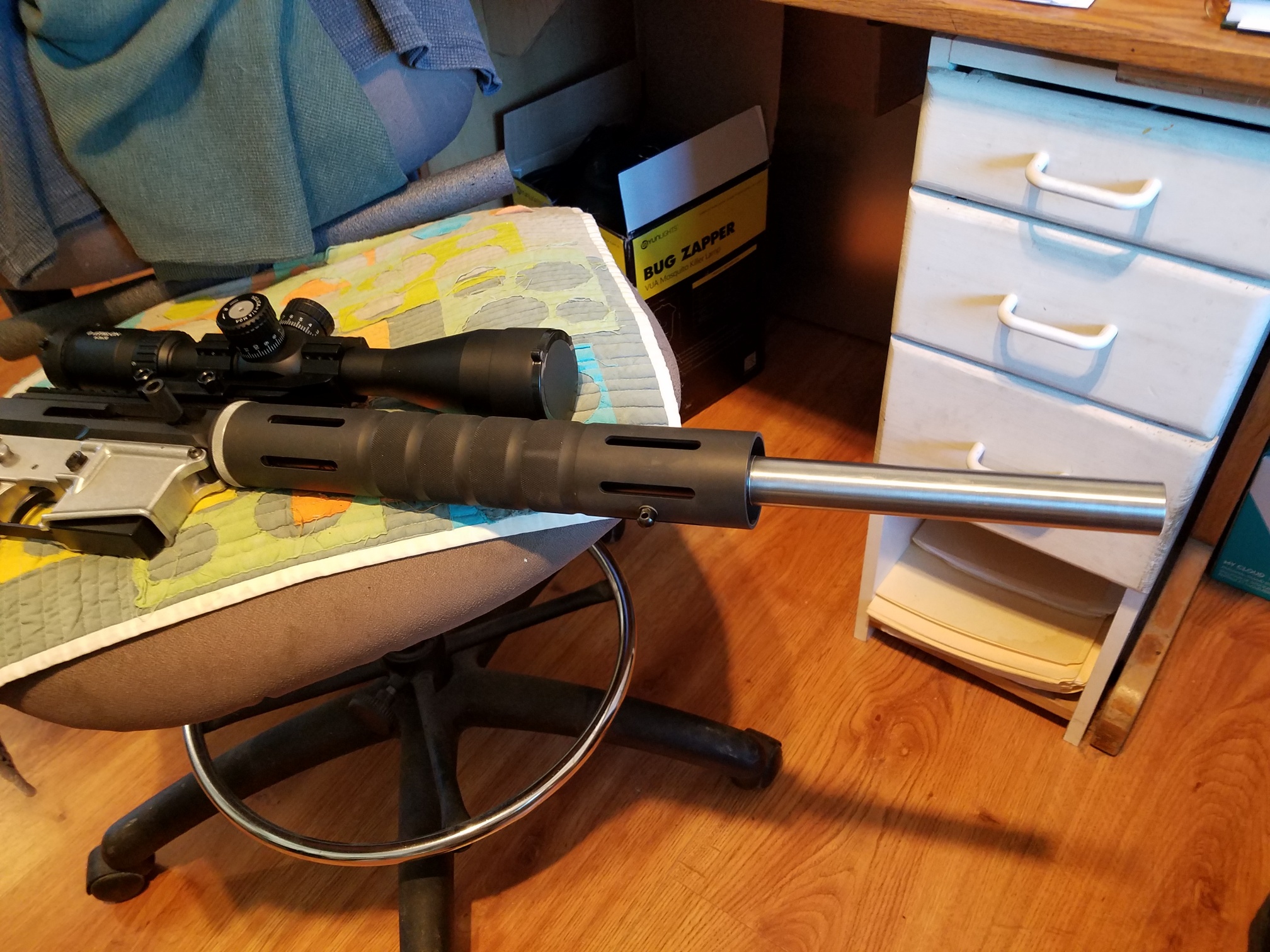

The barrel extension came from Brownells it was 21.99 the bolt was a standard 7.62/39 that I had. Checked the headspace and it was good. I then put an 11 degree crown and turned the barrel down till the machine marks went away to just inside a 15 " handguard and took it to the range. I can't believe how accurate this rifle is.@LtDan47 what barrel extension and bolt did you use? Did you have to touch the chamber?
SlickThe barrel extension came from Brownells it was 21.99 the bolt was a standard 7.62/39 that I had. Checked the headspace and it was good. I then put an 11 degree crown and turned the barrel down till the machine marks went away to just inside a 15 " handguard and took it to the range. I can't believe how accurate this rifle is.View attachment 7243897

I love that traditional octagonal barrel look! Its not necessarily a new concept but in an AR never seen it b4. Looks awesome bro!!I still need to bead blast mine, but it shoots well, especially for a cheaper build (not counting my own labor of course).
