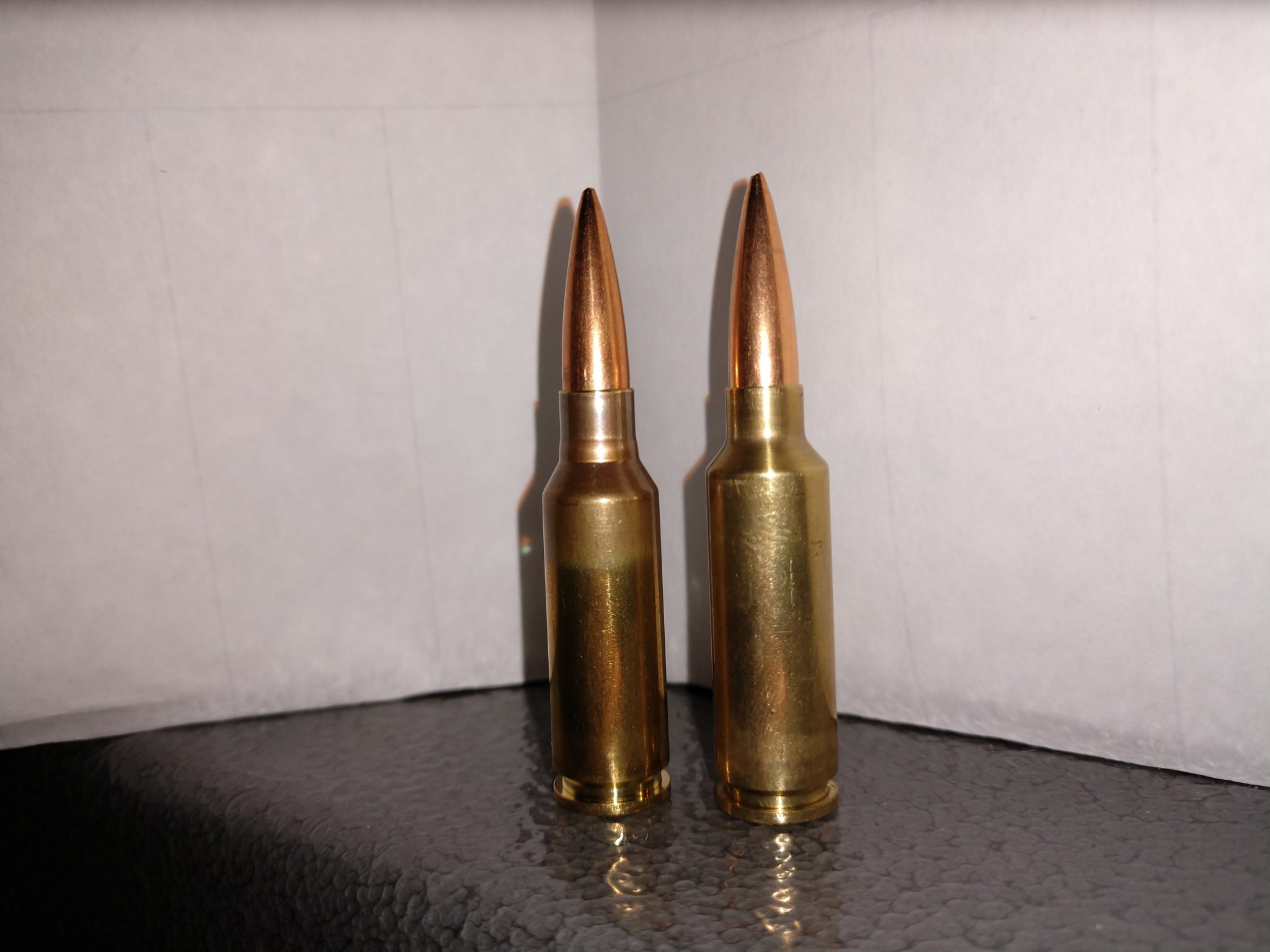

Not sure about the OP, but I'd be interested

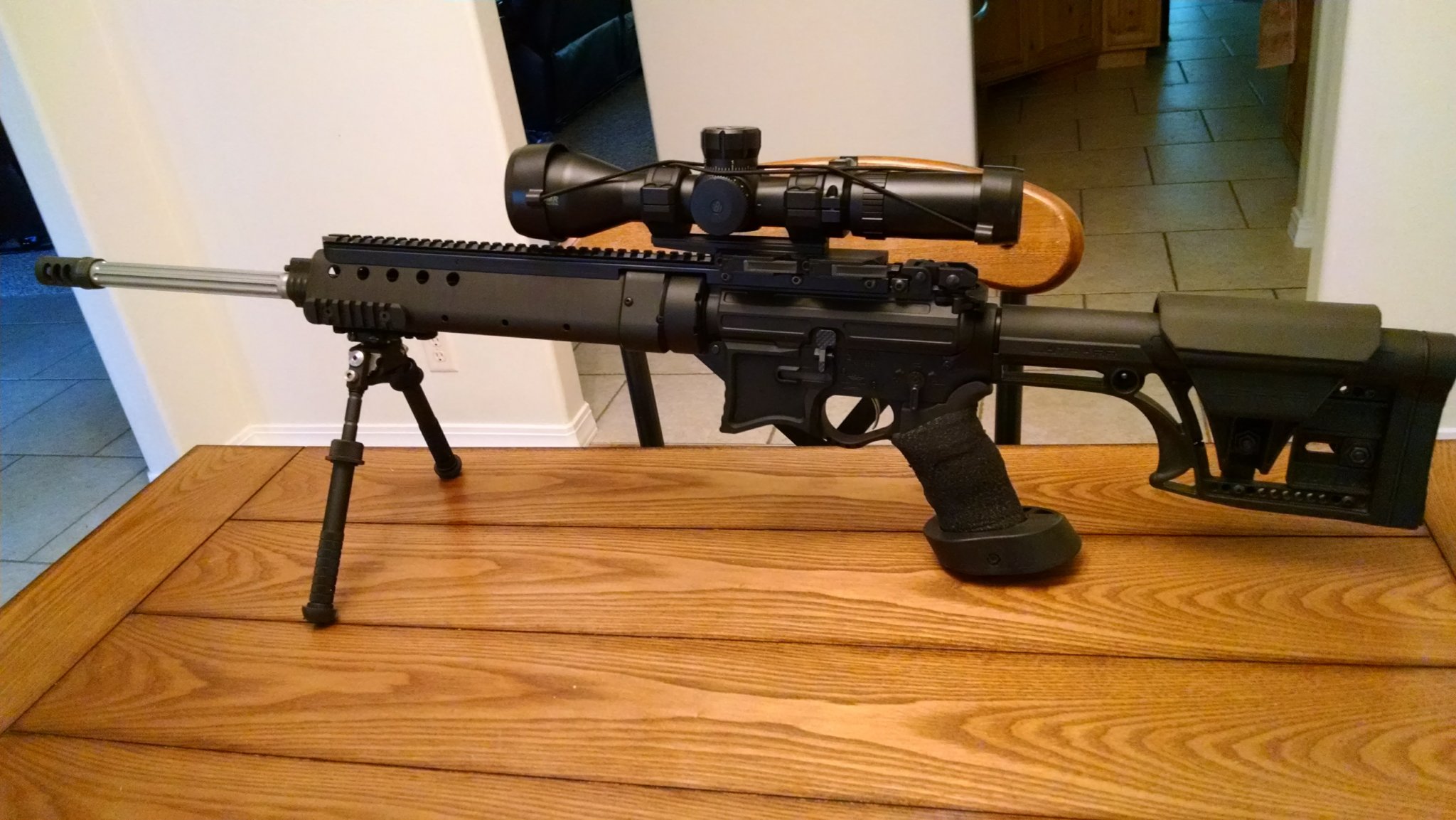

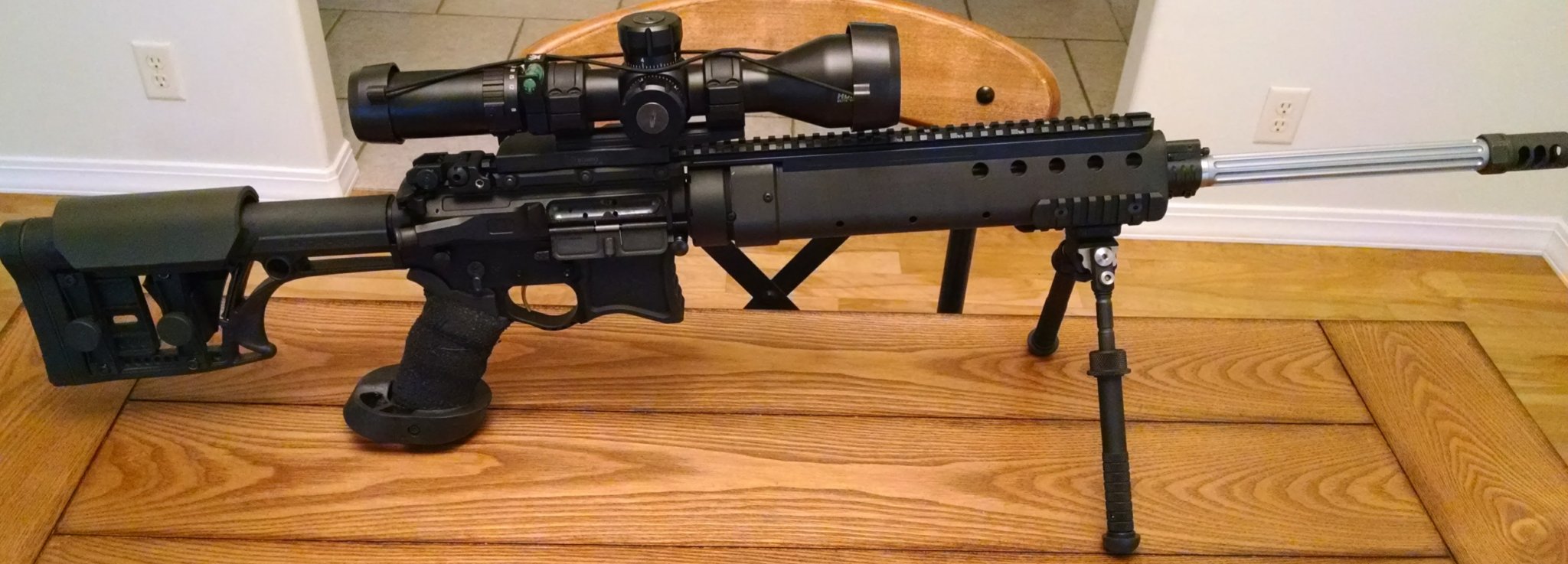

The build you see before you was done by Lee Wells he is the inventor of the 6mm Fat Rat. MK12'ish style build 22" Bartlein 5R 1-8 twist chambered in the Fat Rat Varmint (designed to be magazine-fed)Essentially it's a necked down 6.5 Grendel using the Whidden dies that you get from Lee Wells. Simple to reload, downsize the neck of a 6.5 Grendel and you're done, what's really interesting is the fire forming load is one of the most accurate loads for the rifle, consistently shooting 1/4 - 1/2 MOA. After the load is fire formed it blows the shoulder out .080 giving higher case volume over the standard 6.5G case. With the 107 SMK BC .527 I get over 2800FPS with the 22" tube. The 95gr TMKs are also good little shooters, I'd have to look at my reloading books to get you more specifics.
Only negatives that I've found, no store-bought ammo and the Lapua brass is a little spendy. you can use Hornady brass but I found you only get about three reloads out of them before you have to Shitcan them, between 8-10 with Lapua.
It's a hot little round, from 100-600 yards its absolute laser beam, just cuts the wind with ease. More energy down range compared to the valkyrie, you basically have a .243 in AR-15 platform.

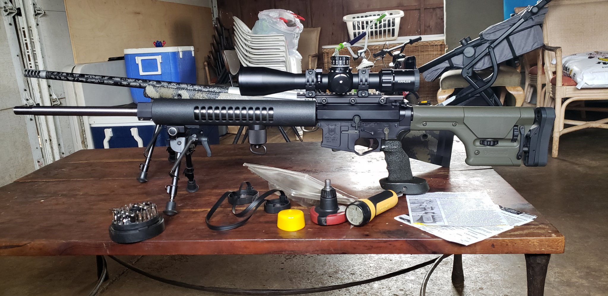

Well I succumbed to the black friday hysteria and ordered a 243 LBC barrel from X-caliber.
Specs pasted from my invoice:
Configure Your Custom AR-15 Barrel
Barrel Steel: 416R Stainless Steel
AR Barrel Length: 22" [+$20.00]
Caliber & Twist Rate: (6mm) .237/.243 1:7.7" Twist 3R Groove
AR 15 Chambers: 6mm AR/.243 LBC (Adjustable Gas Block Required)
AR Gas System: Rifle + 2"
AR 15 Contours: AR15 Heavy .980, .875GB, 850
AR 15 Muzzle / Crown: 5/8"x24 Threads (.243-.358), 11° Crown
Finish: Matte [+$15.00]
I'm already regretting it a little. I love the simplicity of loading 223 but I've been thinking about a 22 or 6mm Grendel for years. The 22G wasn't an option, and the extra sizing steps make it less attractive. I went and necked down 200 cases to 6mm and it made me think this wildcatting thing won't be that bad.

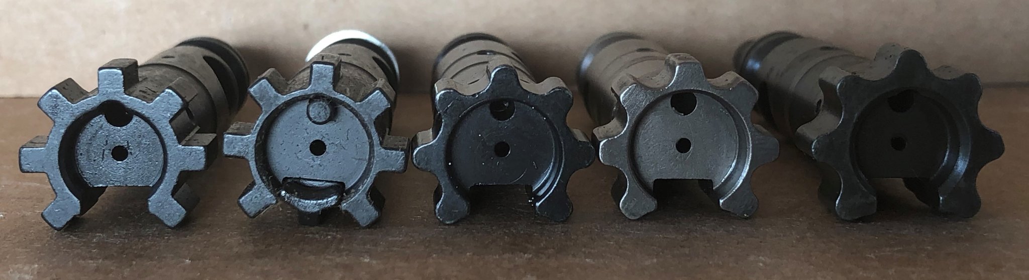

What bolt are you running? I bought a type 2 but I'm not sure if it's the right one.
