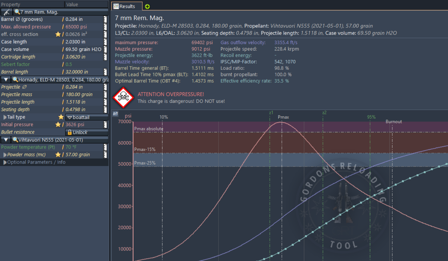

Anyone shooting the PRCW uses GRT Tools for calculations?
If so - what cartridge case did you take for base numbers and what H2O number did you use for necked up 6.5PRC Lapua case?
I ran some numbers compared to Frank Green and Hornady official testing number and compared PSI. I get almost always 3-5k PSI more then official real testing numbers.
I took 7mm RemMag as base cartridge and modified length to 2.030 and H20 volume to 69.5.
Got 5k more PSI and ca 55FPS more than pressure testing rig. What are you supposed to use for base calculations?
GRT needs a base cartridge with the same caliber. I can´t use 6.5PRC case. However if I change case length and volume to the proper number then the calculations should be correct. That is why I am asking what others have been using if they shoot PRCW and use GRT.
