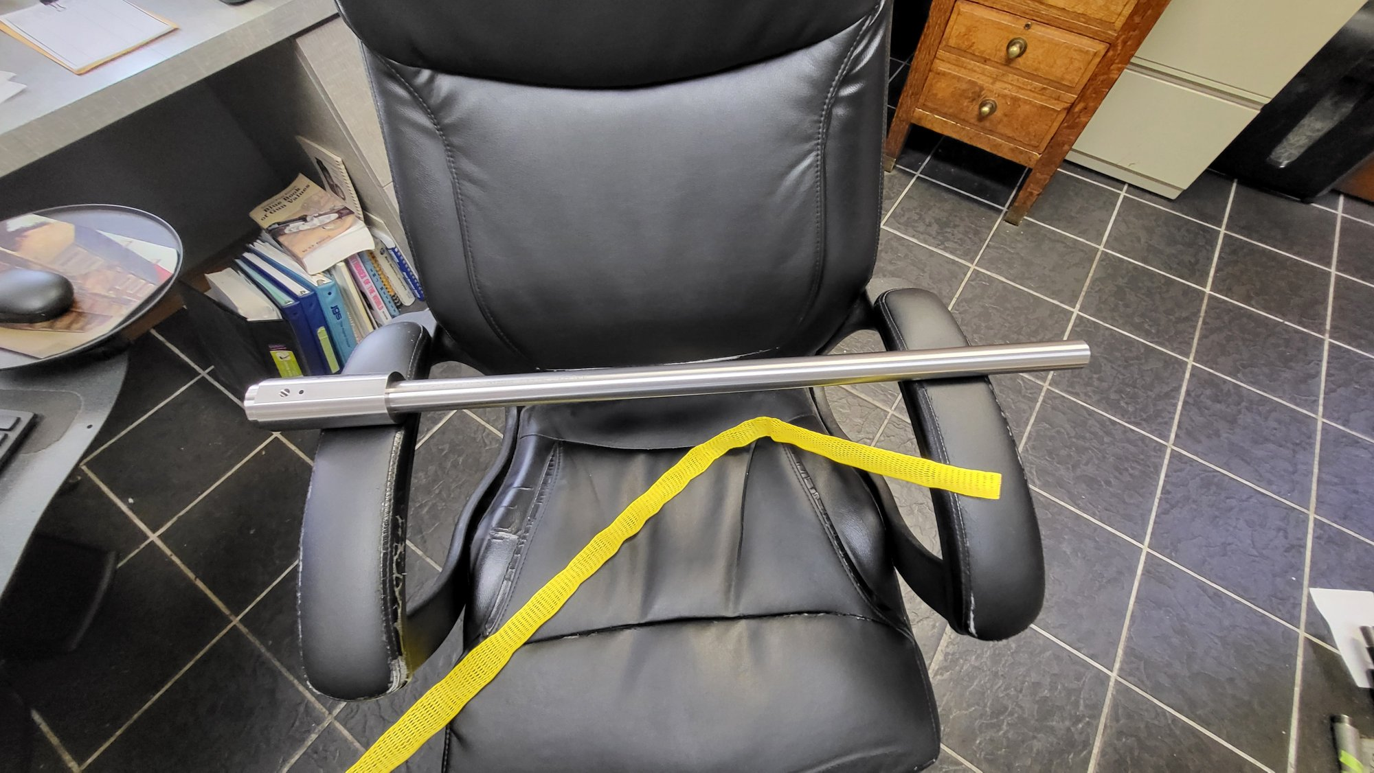

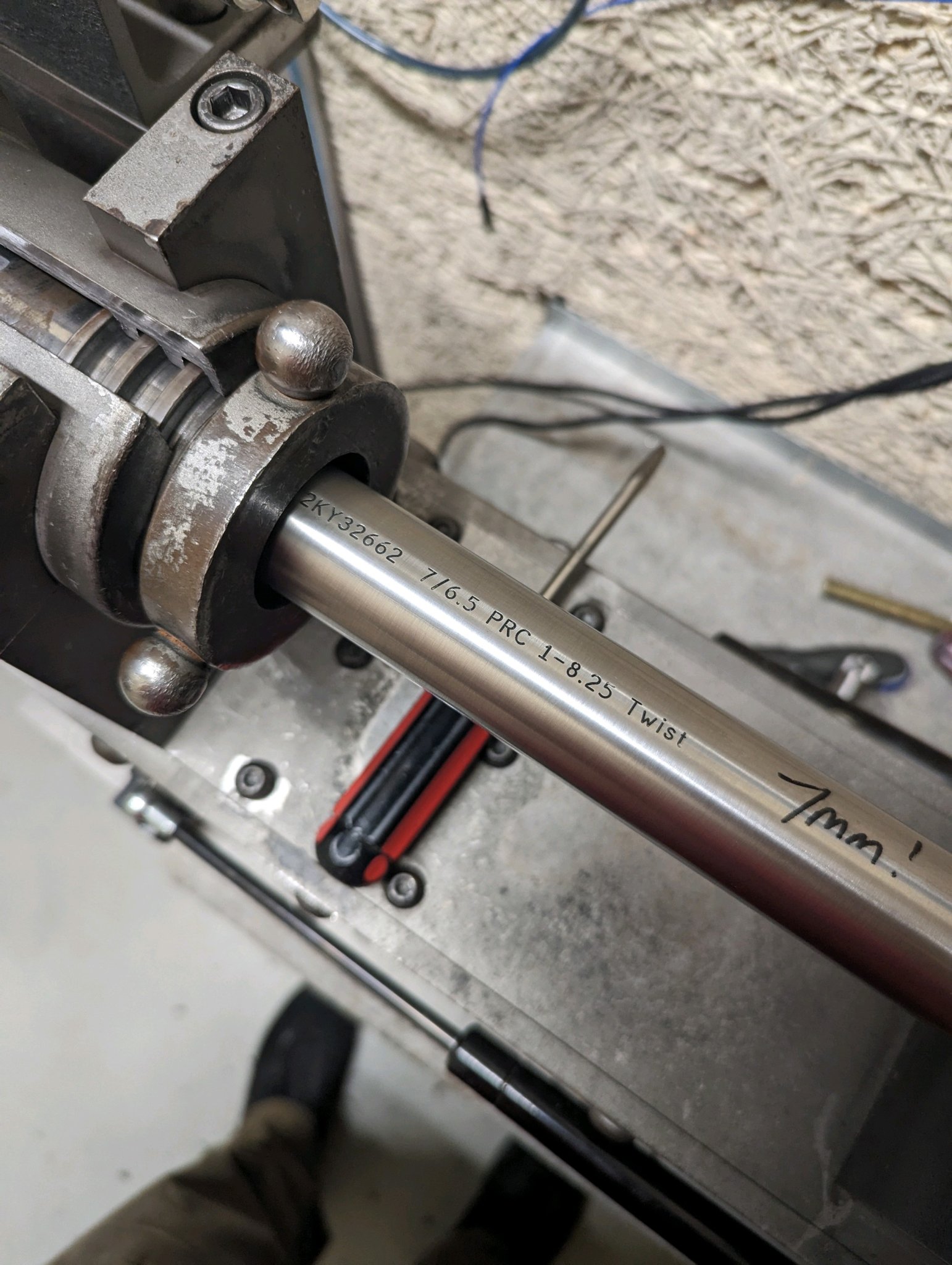

But... that's why the ammunition test barrel we made and the testing that is going to get done.... nobody knows what the actual pressure this stuff is running at.

Right now it’s just the 32” finish length. When the initial round of testing is done. The barrel will remain at Hornady. They can do with it what they will. My hope is that sometime… they will do more load development and put that data out there.
It would also be up to them if they like… they could cut the barrel down finish length wise to say 24” and run more tests etc…right now though again… 32” is where it starts.

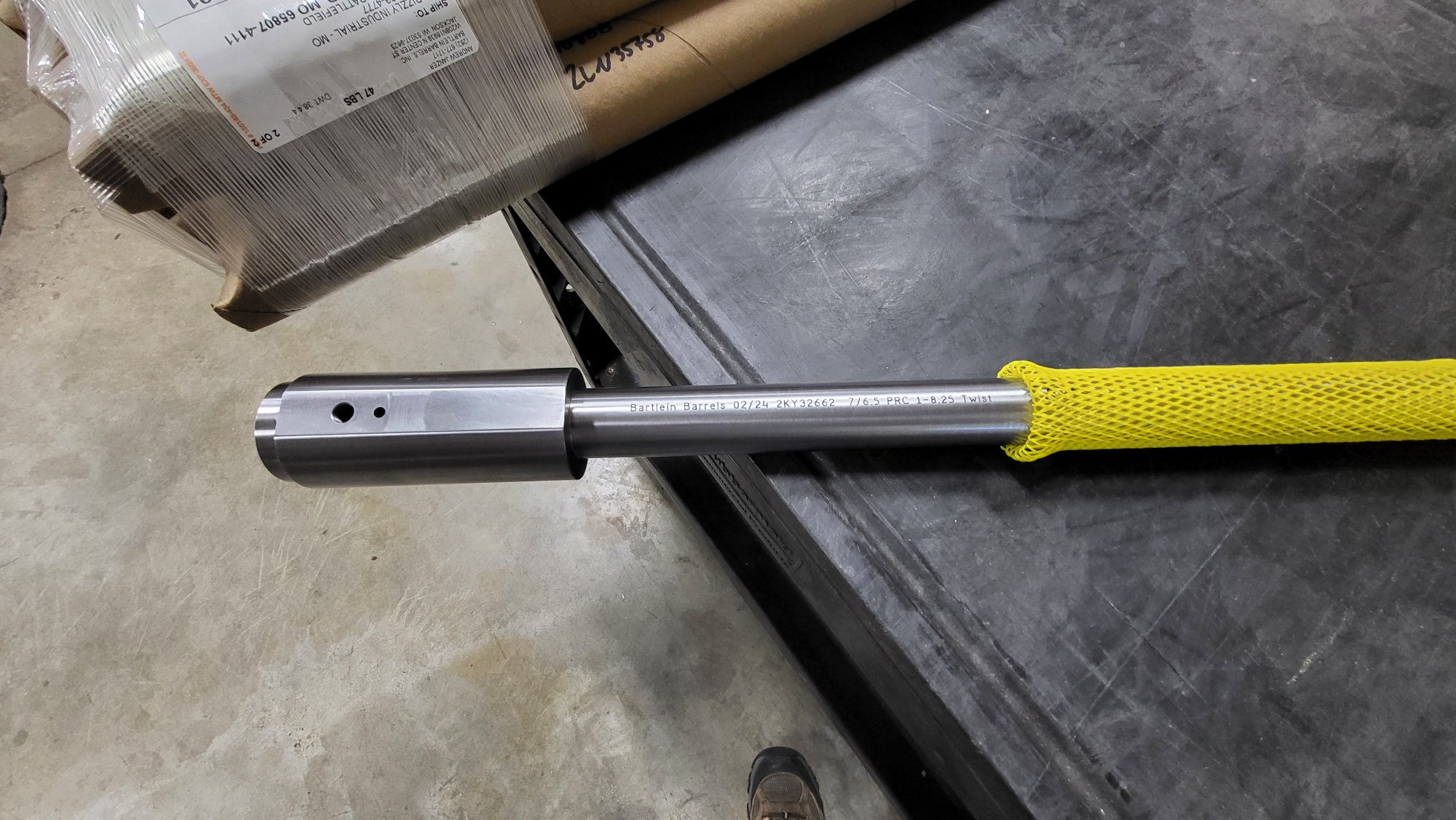

So to bring you all up to date. Testing is underway at Hornady on the P&V test barrel we made and the ammo we supplied.
All of the ammo loaded with N555 powder was shot this past Friday. They should be done with all the testing by the end of the week.
Again I have to give a shout out to Hornady for running the test! Thanks guys!
Attached is a pic of the test barrel in the fixture.
Later, Frank

So it should go without saying but I will say it anyways. Lot of powder variances, bullet lot variances from lot to lot and not to mention bullet diameters, primers, brass lot etc... all can change the pressure and velocities. Be careful with what you do! Don't forget.... temperature, humidity, pressure, altitude etc... can have an affect as well. This test was run in a lab in controlled conditions.
Not to mention that differences in chamber reamer spec's of what we used for the test/in our guns here and the pressure test barrel vs what you might have in your gun and as well as what your barrel measures for bore and groove dimensions vs what our test barrel was made to can make a difference as well.
Again I have to give a big thanks to Hornady and Joe and Jayden there for supplying the brass, bullets (166 and 190 ATIPS) and running the test! Thanks to Tommy at Sierra for supplying the 183SMK and 197SMK bullets for the test. Thanks to Ken at Capstone for supplying the Berger 180 Hybrids and the N555 powder used in the testing. The guys here at Bartlein for making the barrel and for Scotty here doing the chamber work and pressure port work etc.. in finishing the test barrel.
Max working pressure for the round is 65,000psi.
Twist does not effect pressure.
All pressure and velocity data is for 10 rounds fired for each load.
The p&v barrel measured 32" finish length.
Twist = 1-8.25
5R rifling
Bore size = .2773"
Groove size = .2843"
Headspace = go +.0002"
All of the ammo listed below has N555 powder. All ammo loaded with CCI#200 Primers. All brass was Hornady brass. All primer flash holes where checked for and or deburred.
All bullets where seated .020" off the lands of a brand new chamber. This was not a bullet test for accuracy. So no bullets/ammo had the bullets seated closer to the lands or further off the lands. No load tuning was done in anyway shape or form. In making this statement no bullet clearly out performed one over the other. All bullets shot very good. Noticed I listed the o.a.l. of my loaded rounds and not the base to ogive dimension. Some of my o.a.l. data I left at home. Let me update that information later today.

Again at this time no plans for doing testing in a shorter barrel length. F class is pretty much running 30" and 32" barrels. That's why we did 32".
Unless for some reason more testing by a ammo/bullet maker wants to be done and in a Saami spec. type finish length of 24" (the most common) or if and this is a big if.... if the round would be submitted to Saami would be the only reasons.
or possibly as the barrel will stay at Hornady if they want after this testing is done... they can cut it down to 24" and use it at will until it's junk. That's cool with me.
One of the reasons Hornady agreed to do the testing was to help the shooting community like we are doing and also I would think for similar cartridges it adds more data.
We've asked them for favors/help at times and vice versa. It is cool having other manufacturers willing to help. Again, it was nice having all the places involved supply and do things and did it at n/c so that's why I have to Thank Hornady, Sierra, Capstone in helping getting this pulled off.
