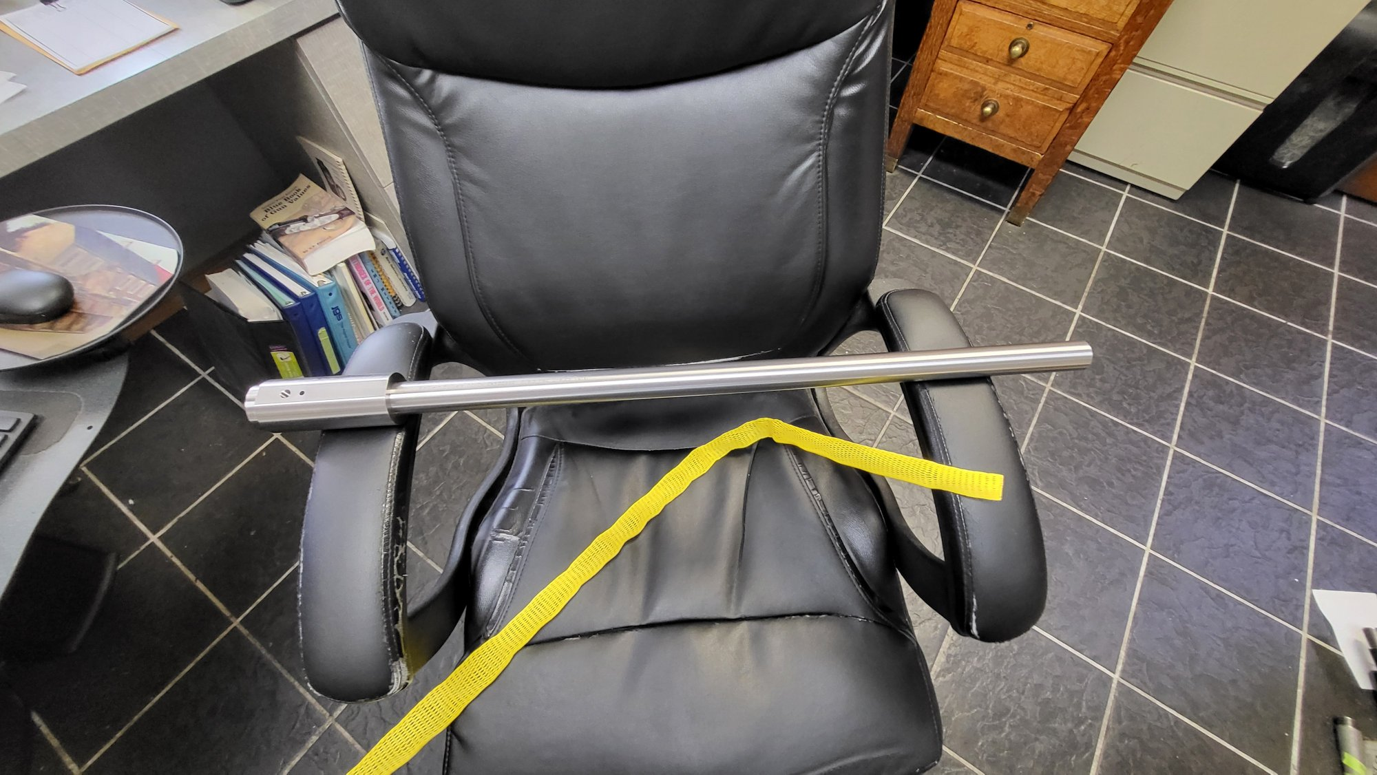

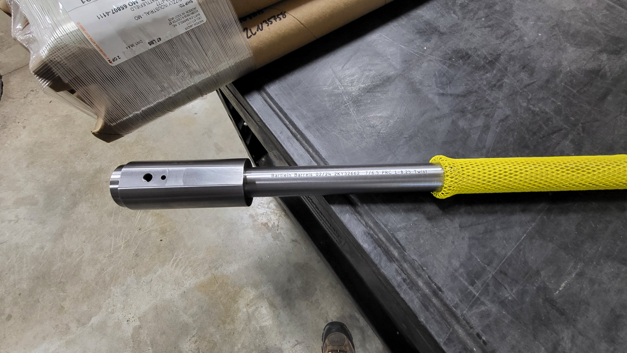

We've got 3 new barrels we are putting on our own rifles.... All BB material. Yes it should help.

Another reason for the ammunition test barrel.
Frank, is this test barrel thing for someone like Hornady to come out with a 7/6.5 PRC like cartridge?
As of right now the test barrel is for those involved to get real world pressure and velocity data.

Shipped the pressure test barrel down to Hornady last week. Should be shipping loaded ammo to them next week sometime.

I had thought hornady had already tested the 7mm in the 6.5 PRC case? What's the purpose of this latest test?
To my knowledge no it has not.
Hornady intentionally (I'm thinking outside the box here) made the 7PRC round/case different so you cannot by accident chamber a 7mm round into a 6.5PRC chamber for safety reasons. So a 7/6.5PRC again to my knowledge was never tested. You hear it over and over again where a guy got a 300BO round chambered into a 5.56 gun and other similar rounds and bad things happen.
What prompted this? The 7/6.5PRC is like the hottest round in F class. There is no hard/good baseline load data out there. You read different forums/threads and shooters loads are all over the place. I've seen guys using the same powder and bullet and you see one guy running 52gr as a max load another guy saying I'm running that at 57gr etc... It's all over the place. Now add in last Nov at a big F class match a shooter blew up a gun. My opinion is they had a round loaded with pistol powder or something like that.
So I contacted Hornady and asked as they've helped us with stuff and we've helped them with stuff similar to this. That if we made a p&v barrel and I supplied all the loads with all the lot numbers etc... would they do the testing? They said yes sure. So we made the barrel at n/c along with the ammo being loaded.
Even Sierra said this was a good thing for the community. So they donated bullets. I reached out to Berger as well and donataed some powder and bullets as well and Hornady donated brass, and bullets on top of they are doing all the testing at n/c.
Thought about it some more... if they did we never made them a test barrel.
Second... when I asked the ballistic lab guys about running the test... if they had done it they would've told me and shared the data with me.
So no it has not been done.

But... that's why the ammunition test barrel we made and the testing that is going to get done.... nobody knows what the actual pressure this stuff is running at.
