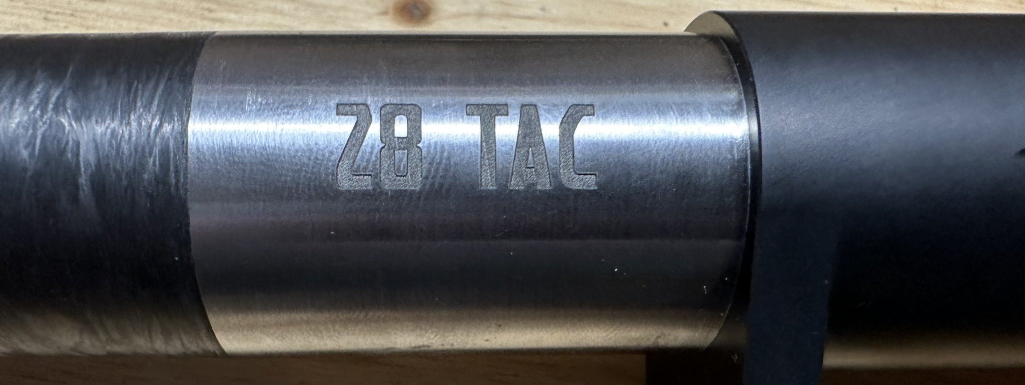

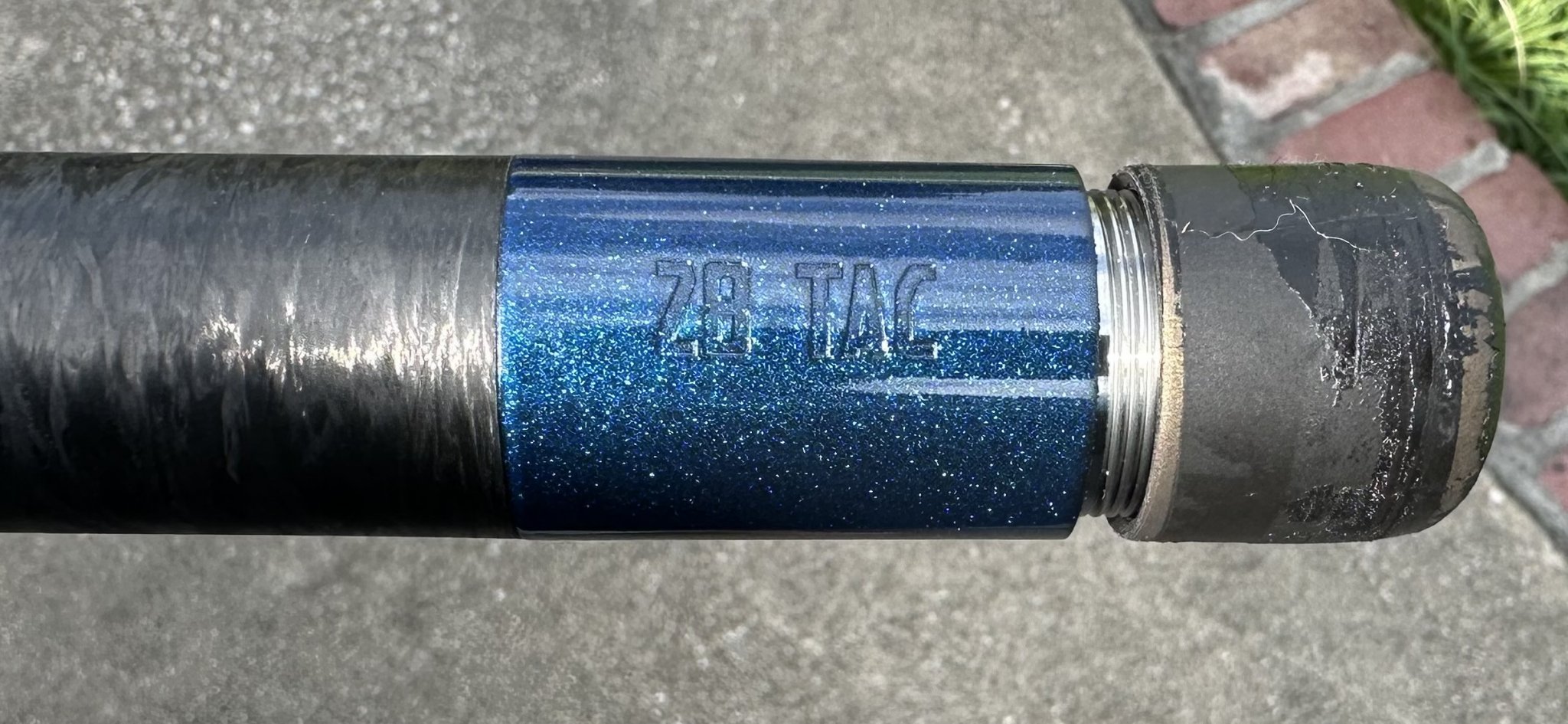

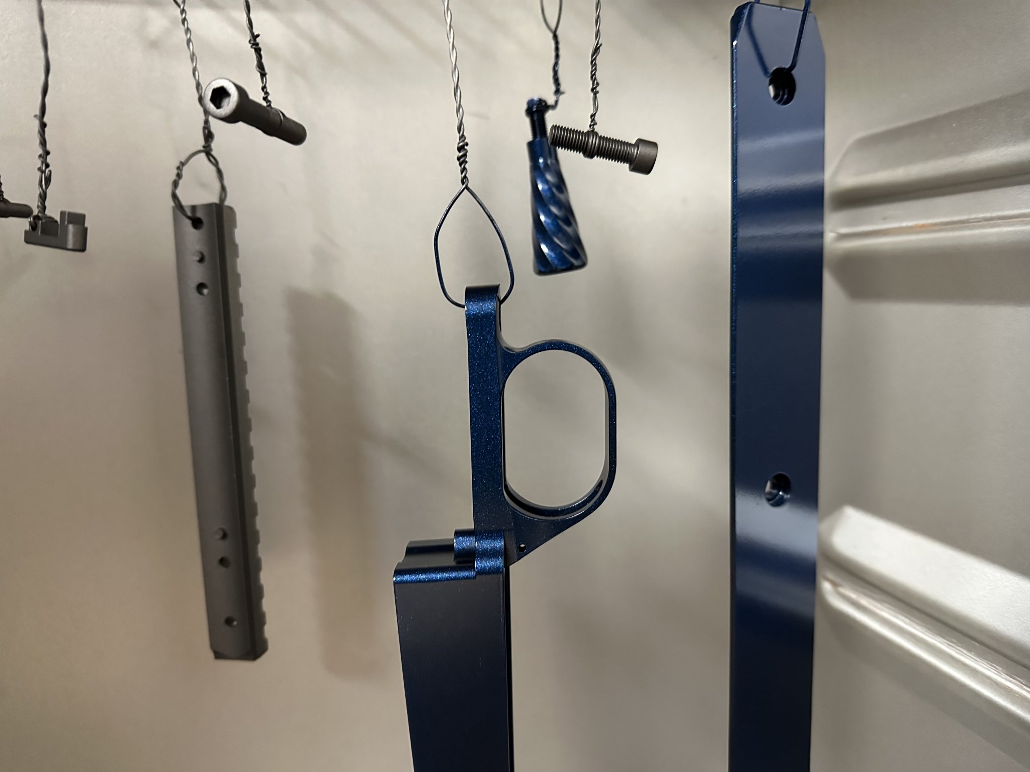

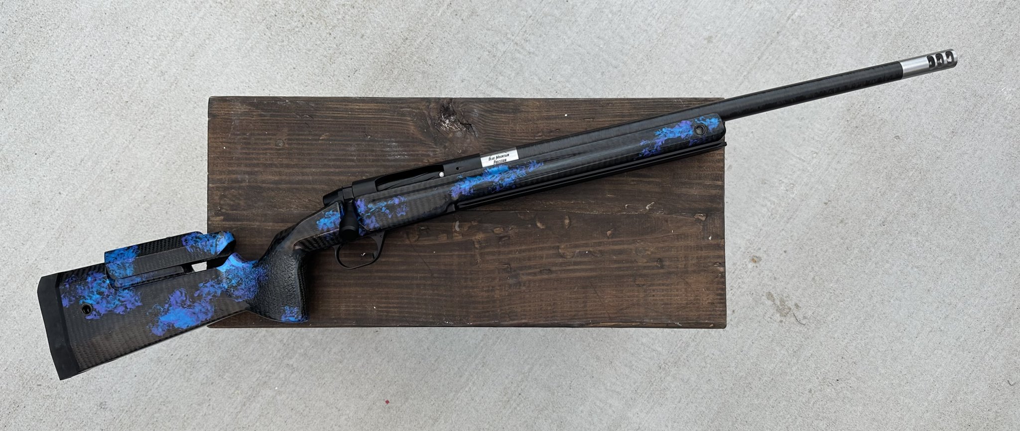

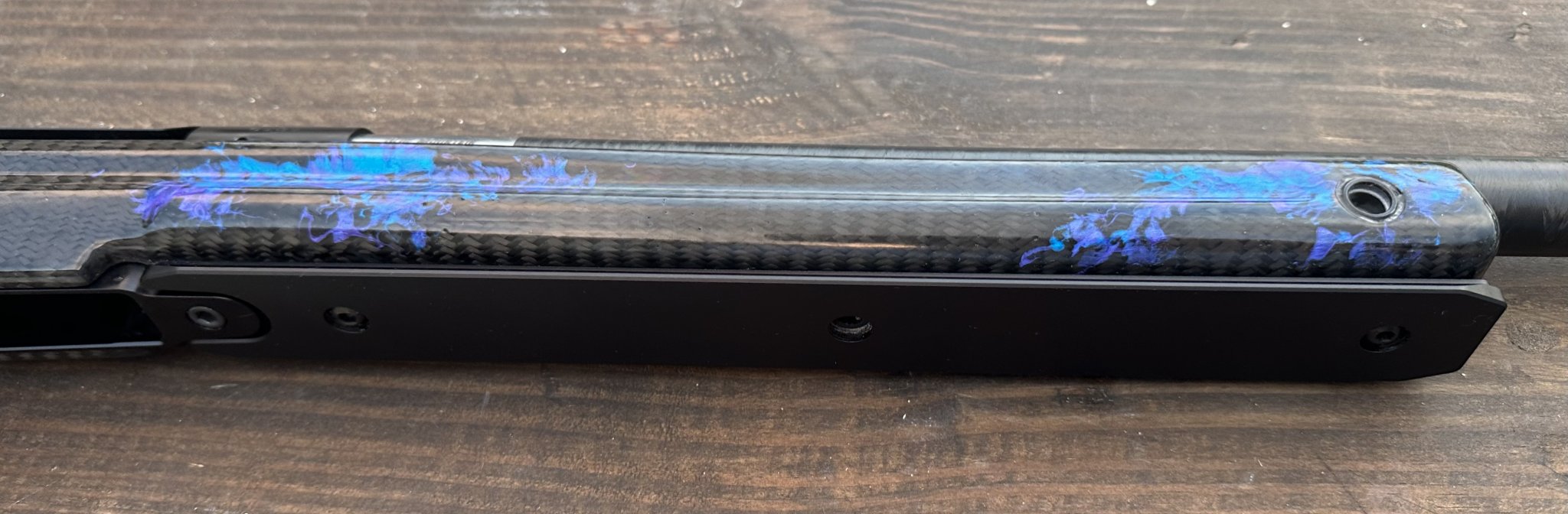

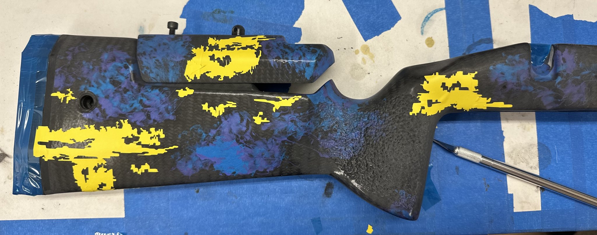

28 TAC (7-6.5 PRC Medium Action) is coming to life! Lots of Cerakote to come.

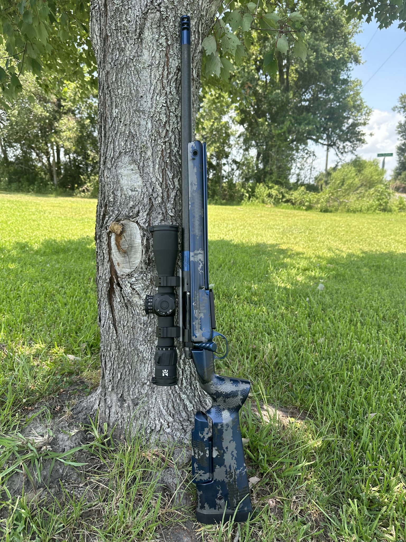

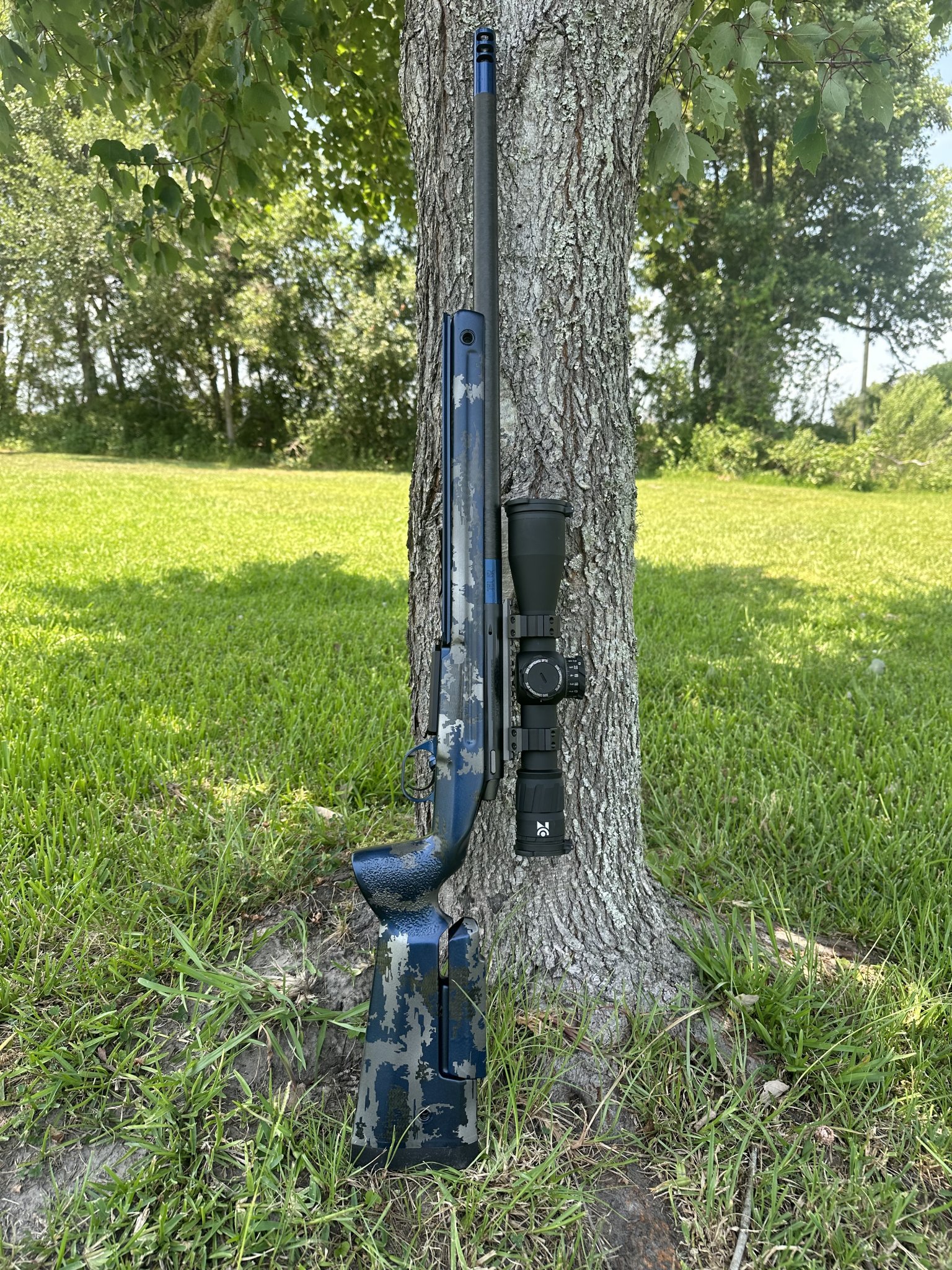

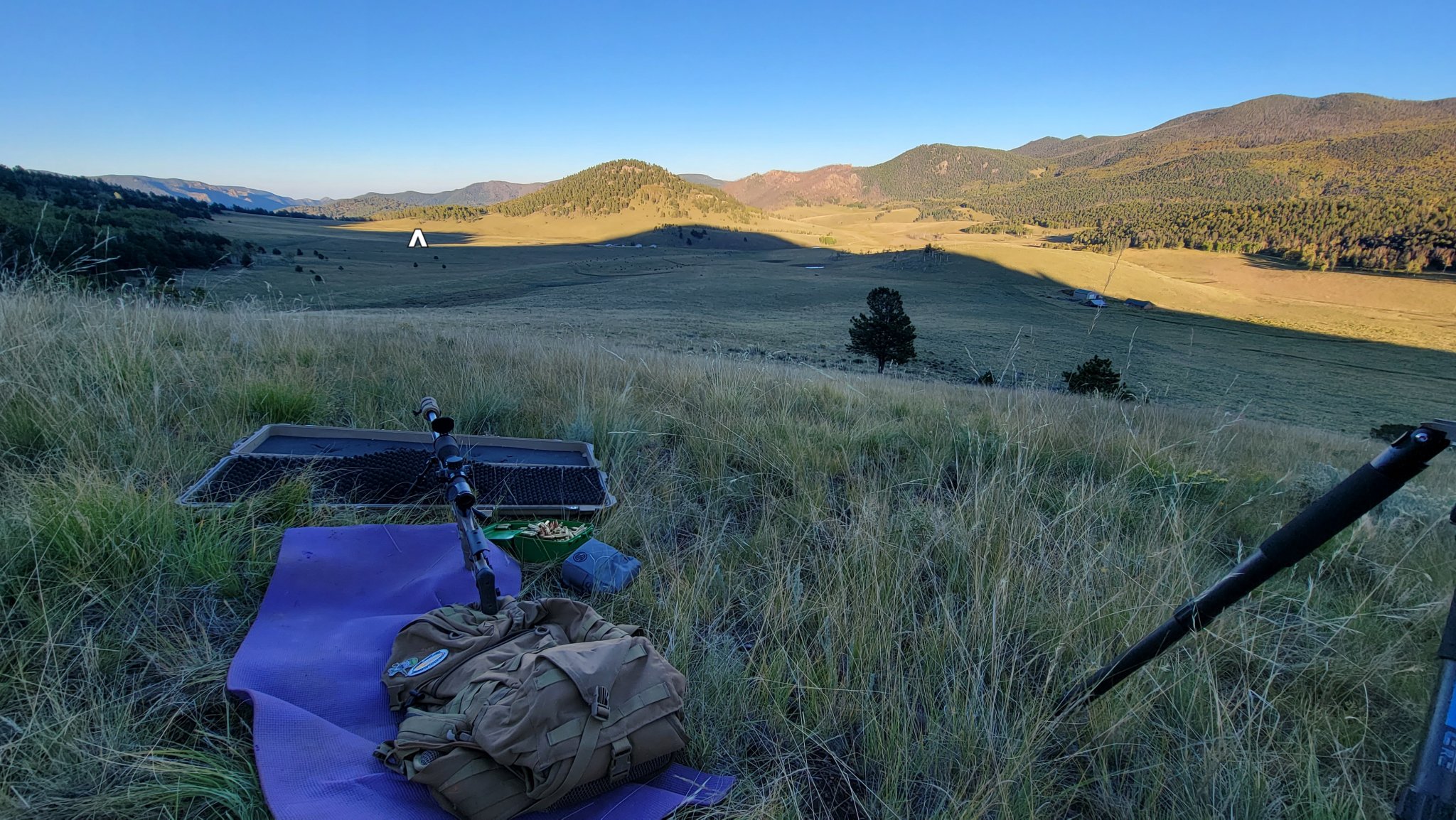

Took the 7-6.5 PRC out to 1507 yards yesterday. It shot really well considering the compromised positions I was shooting from. I think if I get a chance to shoot on good ground it'll really shine. Sadly I haven't done as much load development as I had hoped so I just ran the 162 eldm at 2950~ using imr4350.
Cold bore hit at 1379 and first round impact at 1507. It was a little scattered from there but I was on a bad slope laying on some weird rocks.
I'll be shooting some kind of ELR match this month with the same load. I'll update with how it preformed.

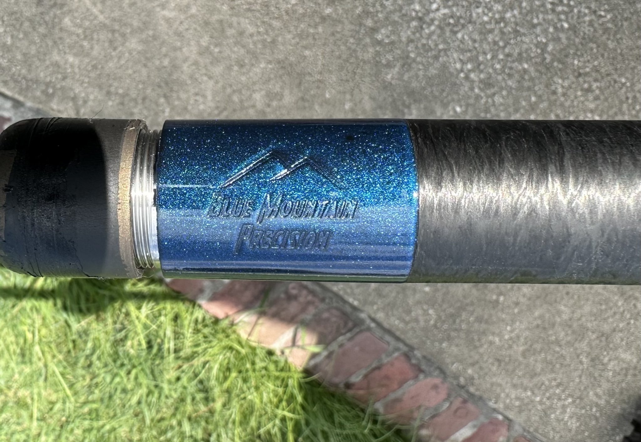

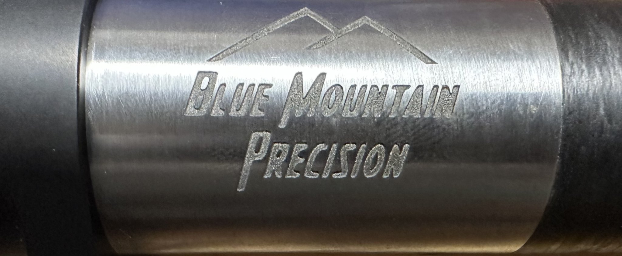

Hoping to hear more on these builds. Curious about the PVA 7/6.5 barrel vs the Blue Mountain. I'm considering getting a Zermatt medium action and I don't know if PVA's would spec well with a MA or if it'll only do well on a SA. I love the idea of being able to use MDT MA 6.5 PRC mags for 10 rounds of 7/6.5 PRC where as 7 PRC would only have 5 in a CIP mag. I know that AI makes a 10 round magnum CIP mag so I could just go 7 PRC for 10 rounds, but that magazine looks insanely long (haven't been able to find a spec on the length yet). The MDT MA mag looks much more manageable. Additionally, I'm thinking the MDT MA 30.06 mags can likely run 308 and 6.5 CM without issues.

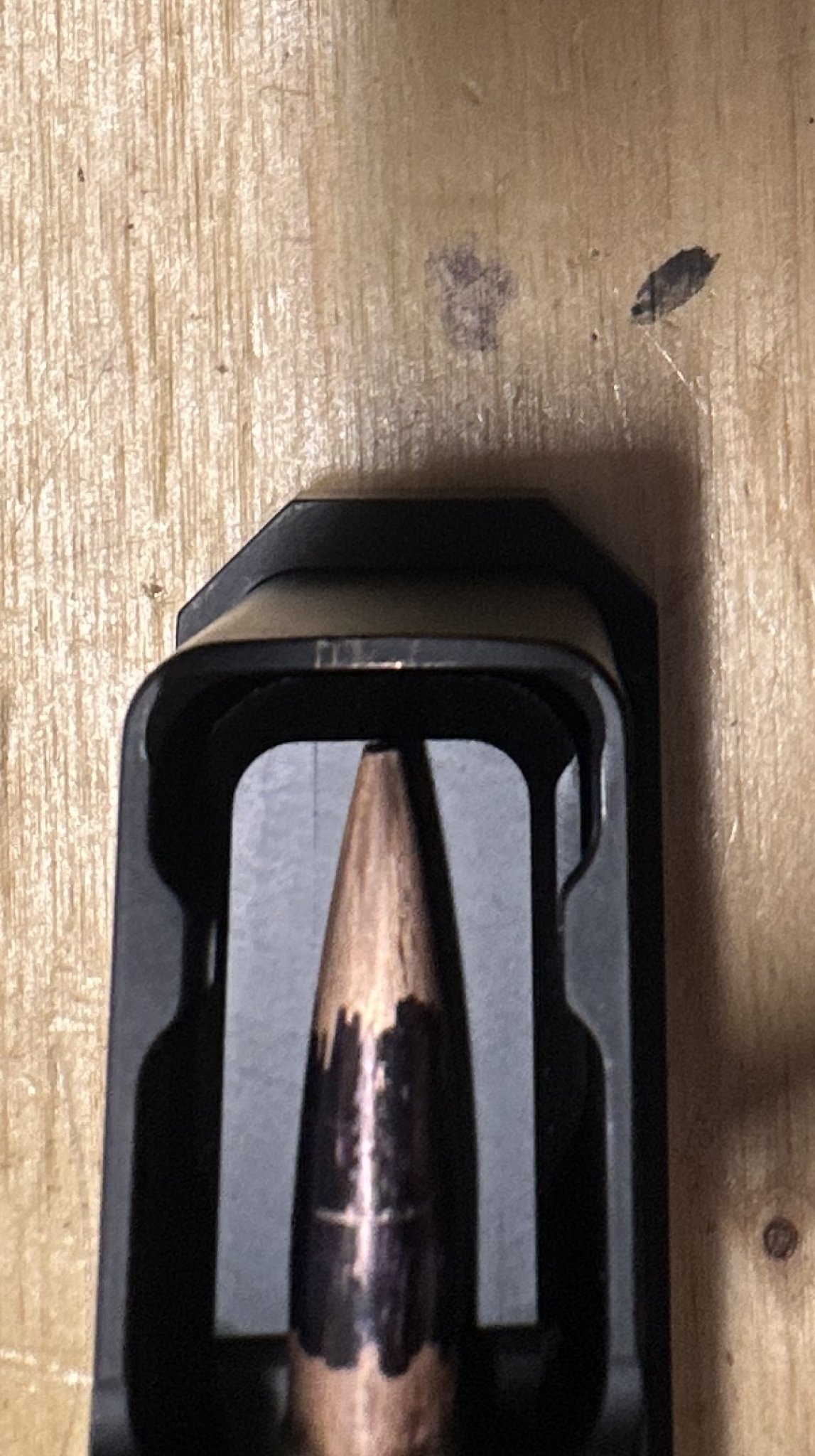

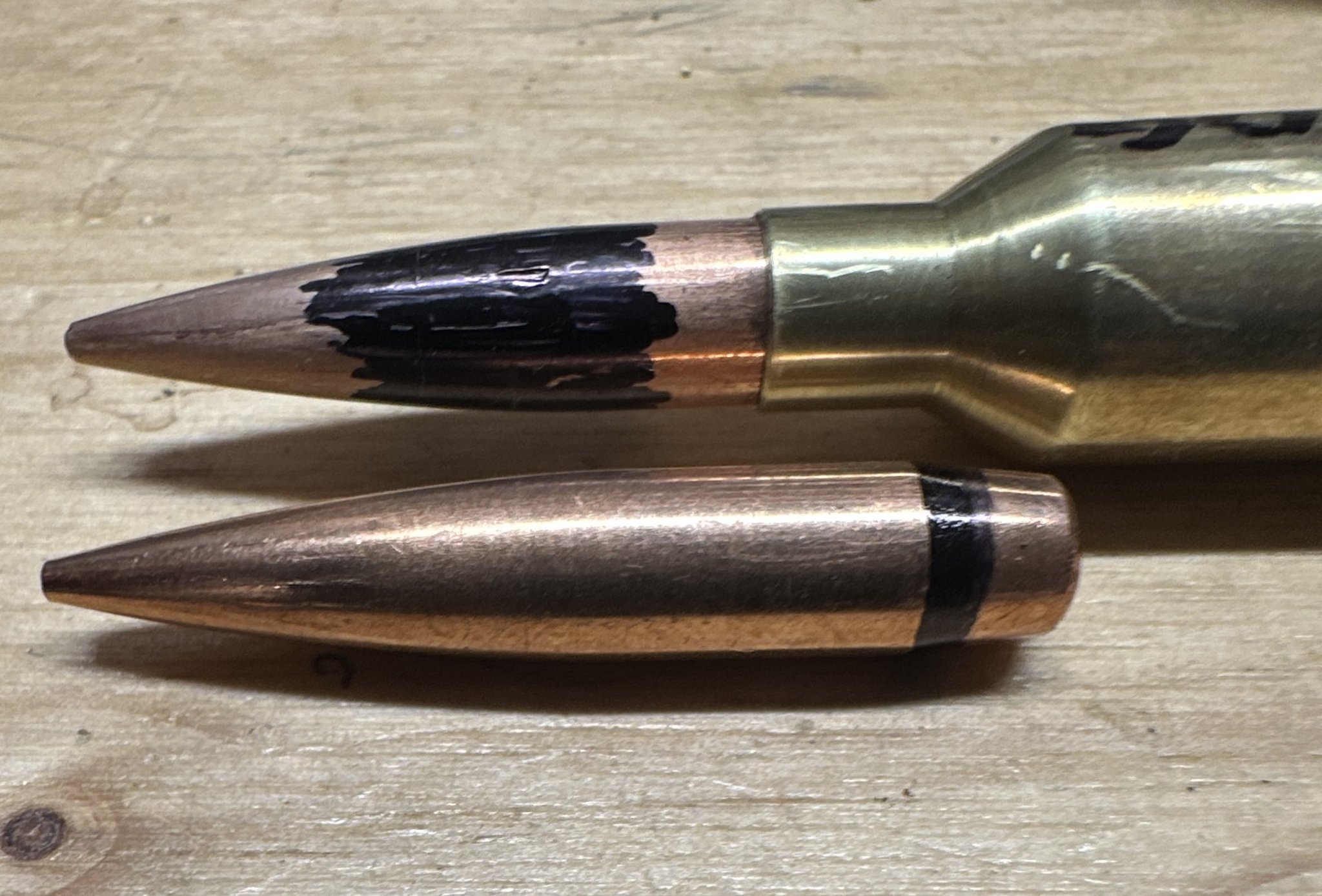

Sorry it's taken a little bit, made a point to find the lands.
COAL @ the lands with 180 ELDM was 3.100"
As best I can measure, the freebore is .265" +/- (from fired case mouth to ogive)
I'm not too worried about running .100"+ jump but the 180s seem to not like it as much as the 162's. Berger 180 hybrids seem to not like it either.

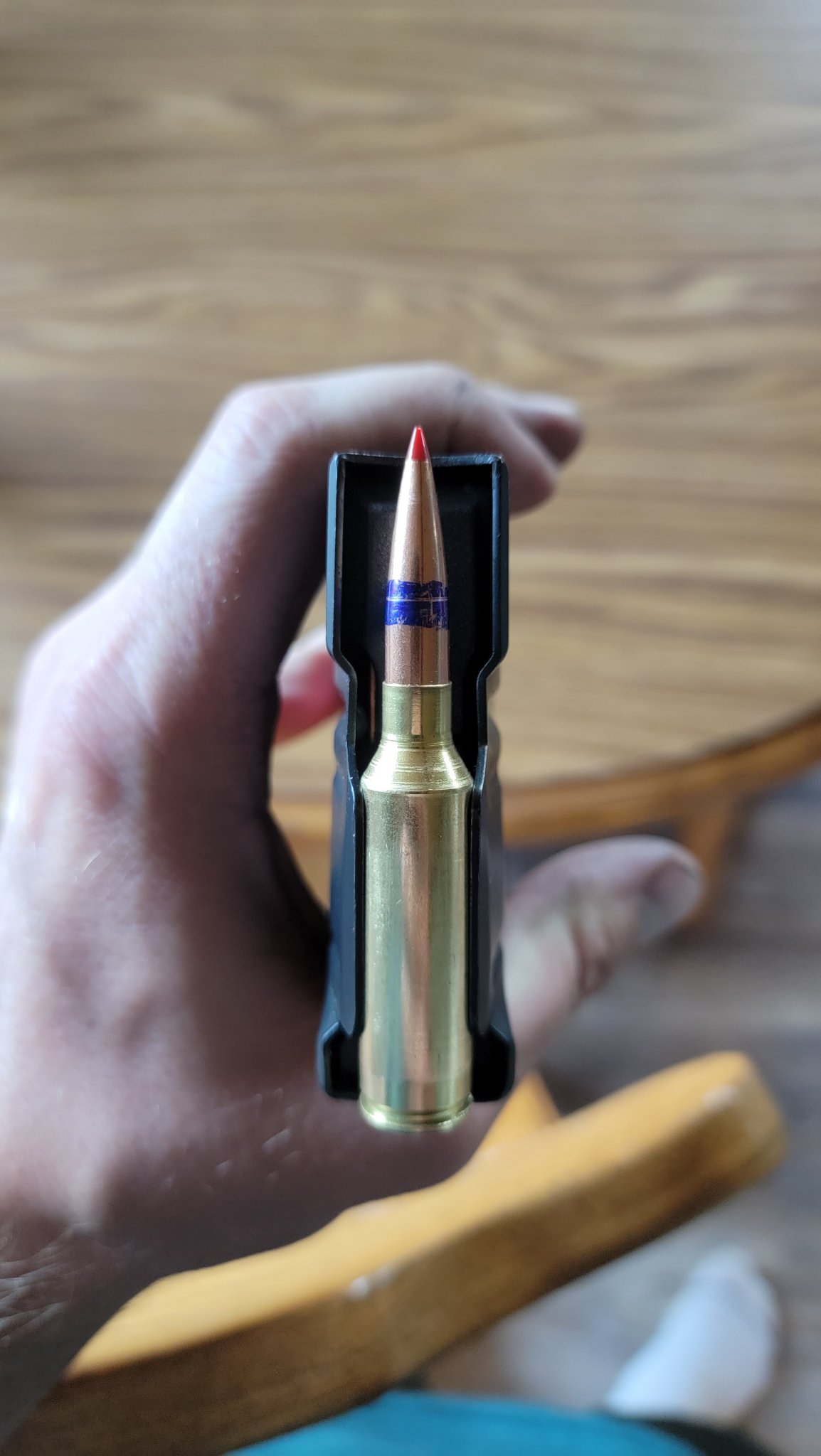

About how far out do you have to seat bullets to avoid the neck/shoulder junction?

At this point, I've just now "found the lands" with the 180 eldm. So not sure on the hybrids.
Im well into the neck shoulder junction even at 3.100" (maybe .075-.100 past) the base of the bullet is pretty close to the shoulder body junction.

If you want to avoid seating past doughnuts then you can't use a short action or just neck turn. (It sucks)
I'm not sure what or if wheeler did anything to the shoulders but I know he was pretty focused on clickers and having the web area large enough to get squeezed by the die. But Eric Cortina just released mandrel dies that will squeeze at the base too.
The FCP has the shoulder set forward to give some more capacity. Probably an angle change too. Someone here can probably give specifics if you can't find them elsewhere.
