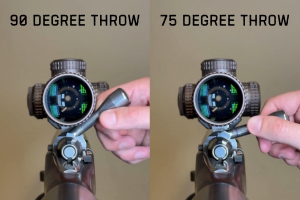

    I noticed both Defiance and Impact have new bolts, maybe they didn't like when I said nobody needs a 2 lug 90 degree action for more than $1500 in 2024 moving forwared
    I like you can get a bolt vs a new action though, smart.
    It's crazy that it took these guys this long to go better than 90...
    It looks like someone still shoots in MOA, though.
    IMO Defiance lost a lot of customers when they priced themselves out of the market when they got bought out. Time will tell!
    You missed the big Defiance sale last month. They were literally blowing out their whole Inventory at insane prices. Actions mostly under $1000. I think we may see a new model from them. Could be wrong, but…🤷🏻‍♂️
    I have all traditional 90 degree actions but I just got a Vudoo 360 and when compared to my V22 90 degree I like the 360 more.
    I also like the throw on the CDG but I’d have to play with a 75 degree impact before I went all in buying bolts for all my actions.
    Reactions: jimsair
    I do not think it is quite worth it. I’d rather pick up another action. In my opinion.
    That's where I'm at. I can equally appreciate a lighter bolt lift vs 75 degree, plus this "upgrade" is going to cost about 1/2 an action. If I have to ship the action too? It's just adding to something that's already too expensive.
    Reactions: lash
    I suspect they're interchangeable on the Defiance too, they just want to confirm things, just like how they won't publish a tenon print.
    I can mix and match my 3 bolts and the headspace doesn't change.
    Reactions: oldrifleman
    I find it to be smoother for my natural action, my daughter needs a throw lever on her ZCO and the 90 deg causes an interference between the bolt knob and the throw lever.
    Reactions: lash
    Need to clear up a few misconceptions.
    Regarding Defiance pricing, you need to take a fresh look at our webstore at https://defiancemachine.com/product-category/actions/
    You'll see that our prices have been modified over time and are more consistent with our competitors than some believe. I've admitted publicly on Frank's podcast that I made a mistake on pricing when we took over.
    We've learned much more about the operation and have made several efficiency gains. We have adjusted our prices accordingly. Defiance being way overpriced with $500? increase is fake news today. The action that was increased is discontinued and the replacement is available for roughly $50 more than the original Tenacity was before we took over.
    Regarding the performance of the 90 degree vs. 75 degree, there is roughly 25% more force needed to open a 75 degree bolt as compared to a 90 degree bolt. We know we are not the first action brand to this party, but customers were asking, and we are actively listening so here we are.
    We don't regard it as a superior alternative but rather an option for those who want it. Low scope rings for weight savings, transition from a 3 lug to 2 lug (more similar than a 90 degree), bolt run style allowing room for gloves or bigger fingers, things like that. With Defiance you get the highest quality options. This is one more.
    Regarding sending in the action to get a bolt, you do not need to send in your action. The 75 degree bolts will drop right in. Our customer service people offer that for optimal results, send us your action and we can guarantee with absolute certainty that everything will work perfectly.
    We have been making A LOT of actions for 15 years. There are many Defiance actions out in the world and we prefer to make sure that everything is perfect. If you buy a bolt for your Defiance and drop it right in, you won't be disappointed. We are extending the offer as a part of our strong customer support. You can choose either.
    -Eric

    I called today to inquire about buying a bolt.
    It is $495 for the bolt without nitride. And around $570 with nitride for a short artion 308 bolt for a ruckus, and they recommend sending your action in.
    With you on this. For almost 600 I can spend a couple hundred more and just get another action from someone else.
    Reactions: R_A_W
    Defiance is not the least expensive action. If cost is the important factor, then there are many less expensive options. The difference is something you feel and experience. You can't buy an action for $800 retail that works like a Defiance.
    I watched an action that cost nearly the same as Defiance break a firing pin at the end of the PRS Finale. I heard someone tell the shooter, "Did you put a new firing pin in before the match?" The shooter said no. The friend replied, "I do that for every big match." He shoots that same brand.
    It is not common practice to change out firing pins before a big match with Defiance. Buy once, cry once.
    The benefit to the slight difference in comparable prices is nothing compared to the experience of working a Defiance and not having any issues.
    -Eric

    My point wasn’t that the action is to expensive, but simply that i’d rather buy an entire action then spend the $600 for just a bolt for the action i already have.
    I have been running a defiance action in competitions for 3-4 years now with not a single bad thing to say. Mine has ran flawlessly, and when i went to buy another action i thought very hard about another defiance but the draw of impacts and their new 75degree bolt made me go that route. I’ll probably buy another defiance with the 75degree bolt at some point though.
    Same. I bought a Defiance Classic for $850.
    For the sake of clarification, I get the impression we are on the same page. The lowest "retail" price for a Defiance is $990 (Classic). There is an old logo Outcast (muzzleloader) on our webstore listed for $795 but it is 40% off. https://defiancemachine.com/product/outcast-x/
    All the old logo actions are being cleared for 40% off. We thought they were all gone but we found a few more.
    We did not make the 75 degree bolt with the expectation that many people wanted just the bolt. The vast majority who already had a Defiance are happy with the performance of their 90 degree. The 75 degree bolt just adds an option.
    -Eric

    I’m kinda curious about the 75° BAT Hammerhead. I had to call to get the lowdown on how it was different than their other actions. Then I lost my notes lol.
    Ok found the notes:
    TR
    HAMMERHEAD
    Throw90°75°
    Misctrigger hangerno hanger, slightly shorter lateral bolt throw
    Feel/cockCocCoc
    PrefitsYesYes
    Stops AICS bag bumpNoYes
    Also: TR barrels fit only the TR. Other BAT barrels fit all of the other BATs.
    Edit–also have some note that says: “Hammerhead has larger pin diameter.”
    Hmmm wtf was I referring to? Seems odd if it’s about a firing pin.
    Anyway, there you have it.

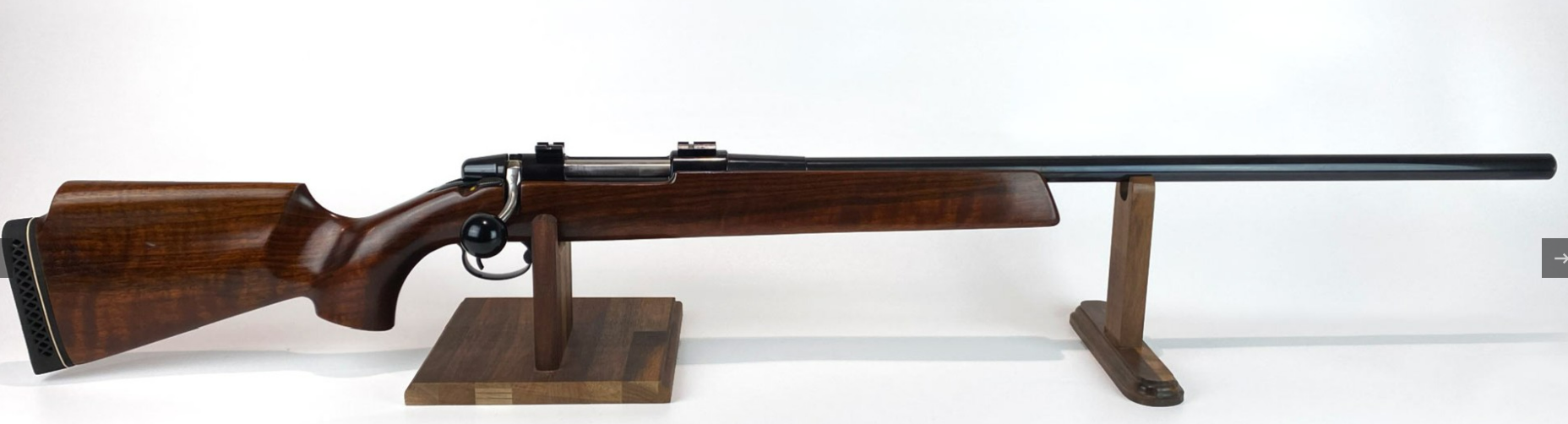

    This is a Husqvarna 1900 sporter moving target and field target competition rifle from 1968.
    It has a 70 deg twin lug bolt and reduced length fireing pin strike compared to the 90deg regular production 1900 hunting rifles.
    Bolt throw is adapted to cartridge length, and with short rounds in a long action, this thing is smoother than a Krag.

    Sweet! Where’s the chainsaw attachment? Lol
    But seriously, sweet rifle.
