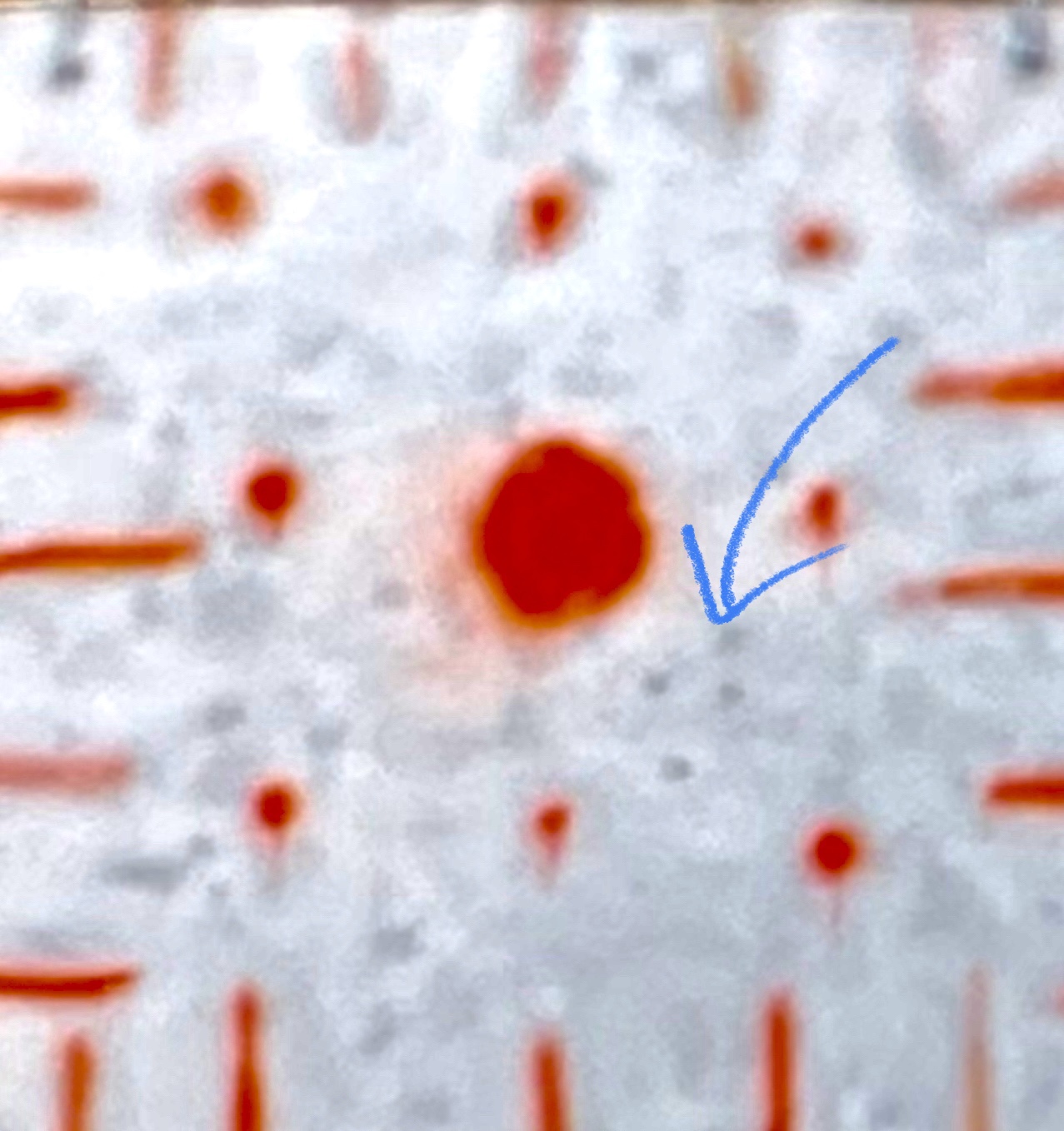

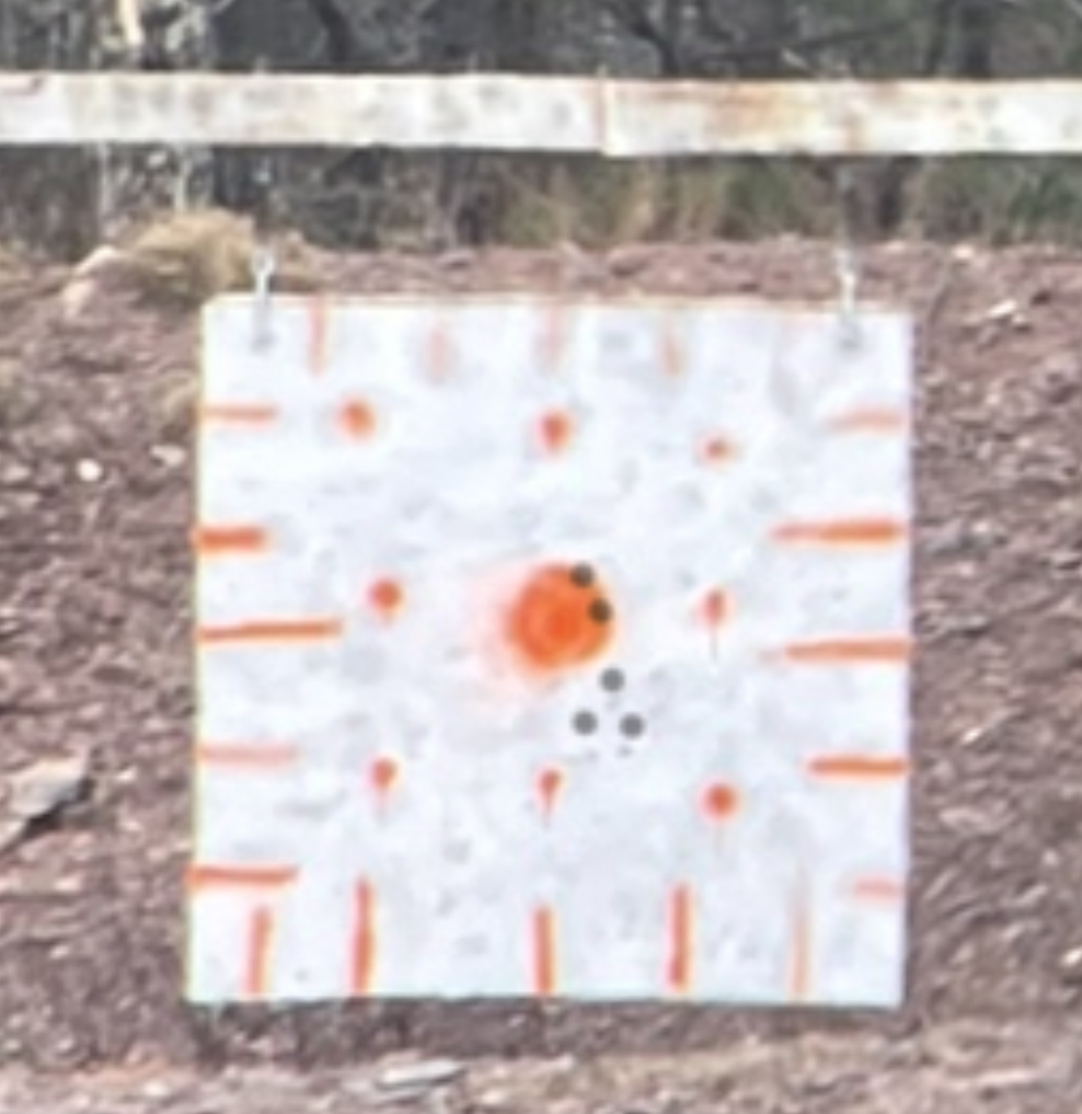

I’ve shot bug holes w the .223 77s but never the 75 ELDS. I’m well under 1 inch moa w ELDS but RDFS were magic in my HART BARREL. My Bartlein will shoot the ELDS and after testing jump, I landed at 45 off lands. Very consistent but I’m considering trying those RDFs in my Bart.. They were amazing in my HART and now I’m wondering if I can do same w the RDFs in my BARTLEIN. Stupidly I decided to chase BC and got off the RDFs. Wanting to try going back.
My best 1000 yard groups in a .223 TAC class rifle….( in my lifetime ) was w those 77 RDFs and
I stacked two 3-shot groups out there that blew my mind.
Pics show groups at 1000 yards, the second pic I highlighted POIs w phone ap. I want to try repeating this … guess that’s the purpose of a loading bench.
