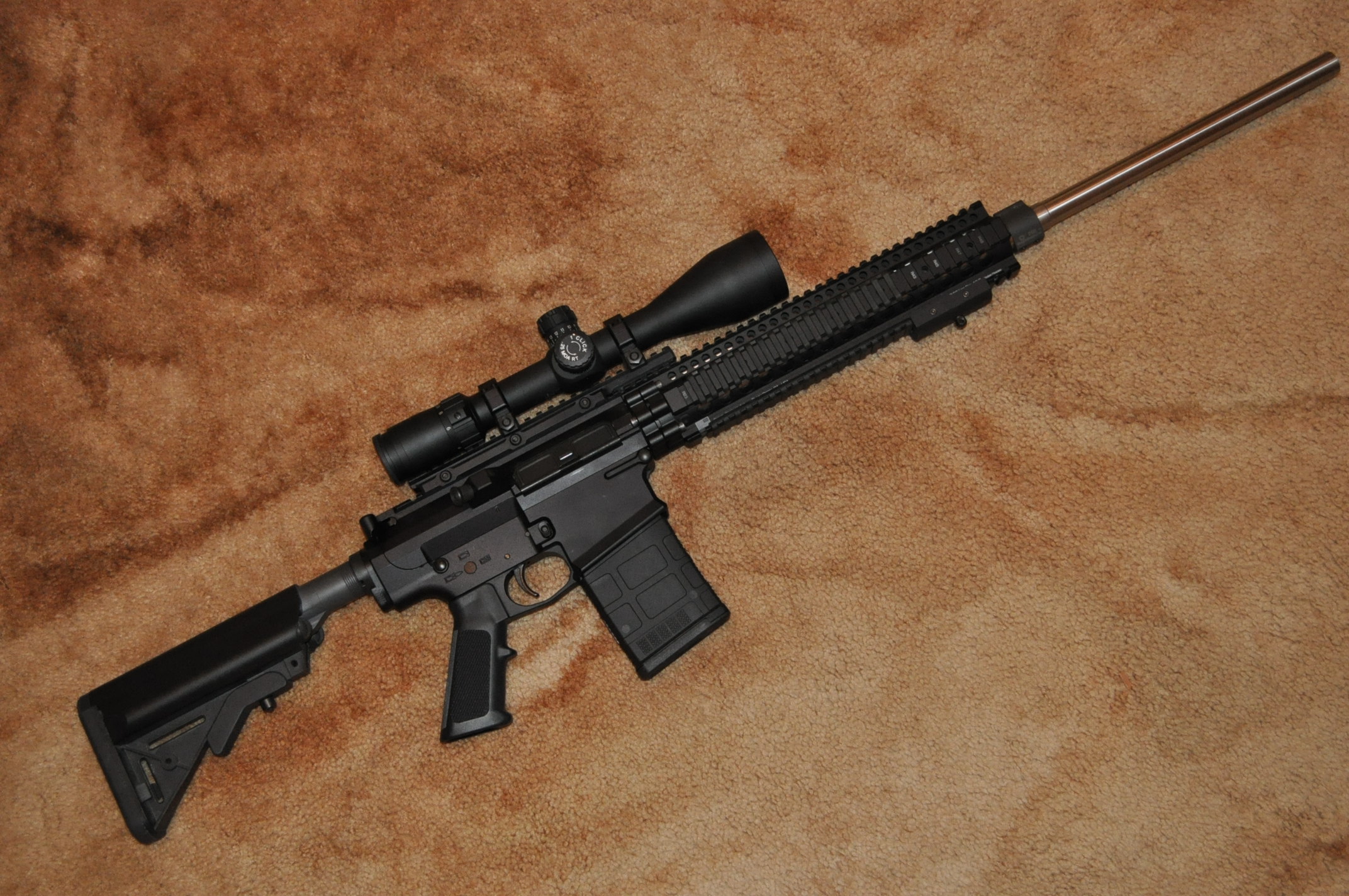

I built a 7mm-08 AR30* on a set of J-D Machine Snipers Hide receivers 3 years ago. Found a 1-10tw AR10 blank on Krieger's inventory list, which I finished at 25", after chambering with a slightly improved version of the 7-08. We went with .002" less case body taper, moved the shoulder .068" forward, and went with a 30* shoulder - the reamer name was Kiff's idea, not mine. I drilled the gas port with a #49 drill, and kept going one #drill size larger at a time as I test-fired, until I got the bolt to lock back on an empty mag. Wound up at #45, which is .082".
I used DD Lite 12 rail system, RRA 2-stage NM trigger, LMT SOPMOD buttstock, PRI gas buster charge handle, & PRI 20MOA sloped rail with a Weaver 3-15x50 tactical scope in TPS TSR low rings.
So far, the only really accurate load I've found in it used 2000MR/WLR/S130MK in old LC73 cases, running 2812 avg vel. Finally got a couple more 8lb jugs of 2000MR, and intend to try it with S168MKs in formed brass. None of the S168MK loads I'd chrono'd so far have gone over 2450fps, and accuracy more or less sucked with both the 168s & some 150MKs I tried. So until I got the new supply of 2000MR, I'd more-or-less lost interest in this rig, and have been thinking of pulling the 7mm bbl & replacing it with a Krieger in 308. Krieger's expected delivery date on the 308 AR10 blank is Dec. 31. I figure I owe it to myself (and the 7mm Krieger) to at least try some 2000MR with the 168s, or maybe even a few H162AMaxes, but if it doesn't perform when I do, I think I'll just pull it and set it aside. Could be that a 1-10tw bbl is too slow to do a good job with the 168s, but it should still handle the 150s OK.
Originally, after managing to wrangle a spare J-D upper with the SH logo, I thought it'd be cool to have uppers in both 6.5-08 AR30 & 7-08 AR30 - there's a 6.5mm AR10 blank out in the shop, waiting on me to make up my mind whether to chamber it for this rifle, or try to sell it to a customer. I have a good bolt rifle chambered with another version of the 6.5-08 Imp 30* with less body taper, and I love the way it shoots, so it'd be sweet to get similar results out of the gas gun version of it in this SH AR10. .

How much jump is there in your chamber? Are you past mag-length OAL so that the pills have too much jump?

The reamer print Dave sent shows .108" throat dimension; the SAAMI std chamber print shows .119". I'm not having to jump the S168MKs all that far when they're seated to mag length; same goes for the S150MK & S130MK. None of the other bullets I've tried so far have shot any better than the S130MK, but it'll hold well under 1 MOA at 600yds in decent conditions. Would sure like to get the same results out of the 168s. Haven't had time to experiment with the 168s & PP2000MR yet, but will post the results with that combination as soon as I'm able.
Been in the field for the past couple of weeks, and now have got to get some rifles finished & delivered so I'll have time to play with my own stuff. For example - there's been a new Kahles K624i AMR sitting on my DTA SRS for about a month, and I've only got about 25-30rds fired behind it so far....
