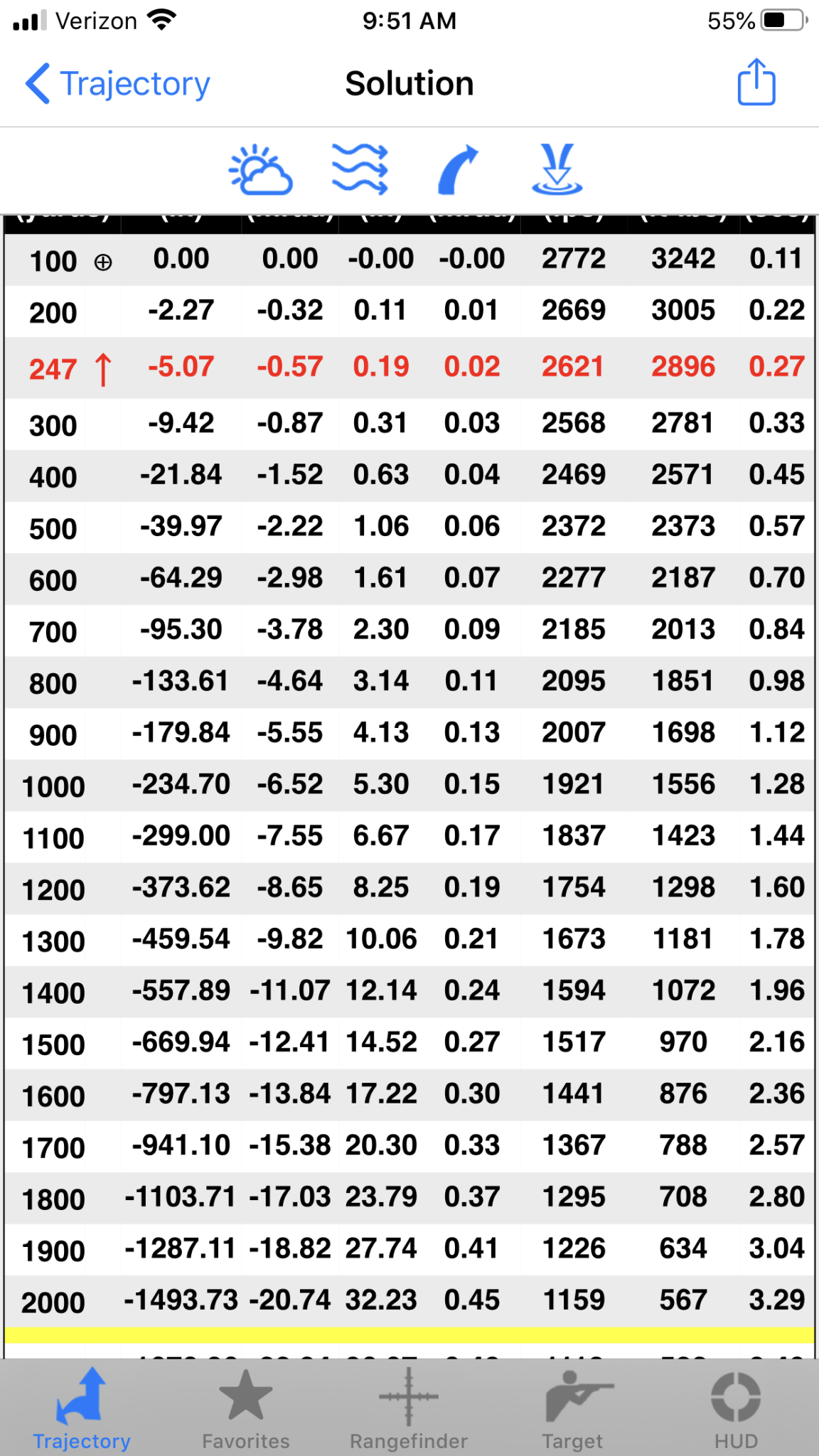

    My go to powder was going to be h1000 to start with. Looking for 180 eldm or 190 bergers but those 190 atips look dang good bc .422 lol came into this barrel 28 inch long 1-8 twist with muzzle brake so should get some great velocities

    I for got about that bullet. What is the g7 bc? Yeah i dont mind single shot at all just a long range target rifle for fun. But yeah that would be a good one too

    If that BC is close at my current 190 speed drops look like this.
    • Wow
