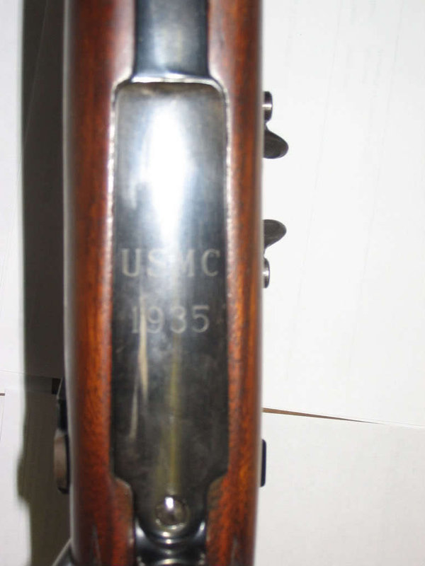

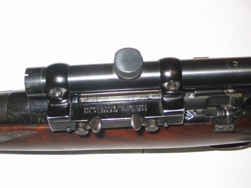

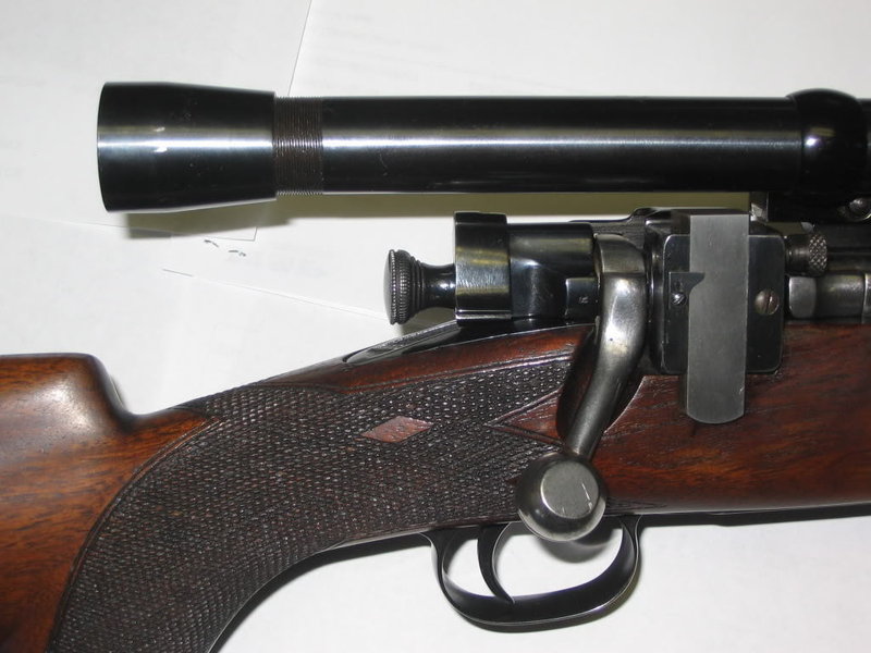

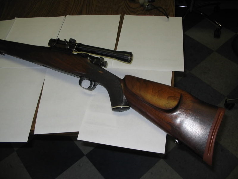

A friend has a close twin to this rifle, I'll have to dig out the photos.
Michael Petrov was the authority on these but he has passed sadly.
The serial number issues are disturbing, someone took a nice gun and hoped to get more for it by taking it out of the low number category.
The USMC never recalled the low number guns and used them in numerous battles from WWI to WWII.
Their history does not recall a lot of Marines being killed by exploding 03's. That said there is still a concern.
USMC ended up with a lot of Rock Island guns and it would be interesting to see if yours is in the SRS files.
The gun has been shot more than a handful of times as well as the receiver being tapped for scope mounts so to me it should survive, I'm not too concerned with it blowing up. I won't be putting any old surplus ammo through it anyway, probably just some soft point hunting ammo that's already loaded pretty mild.
You obviously have skills and dont mess around.
Only issue is that it might have been an original made gun by one of the many companies doing Sporters "back in the day" and if positively identified to any one building house may have been worth more "as was".
Sedgely and Griffin and Howe are among the better known but there were many that built these and the level of workmanship varied. The high end builders were well known and their guns are valuable.
Michael Petrov was the expert on these builds but has sadly passed. You can Google search him and see pictures/posts he has made on various places concerning these guns.
That said - Its hard to get one of these verified and the use of the 03A3 barrel tends to lead me to believe your rifle, though nice, is not one of the high end Griffin and Howe class builds.
I still owe you pictures of my friends gun similar to yours and Ill see if I can dig them up, photobucket no longer being convenient.

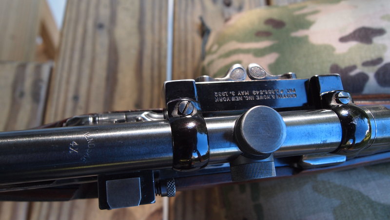

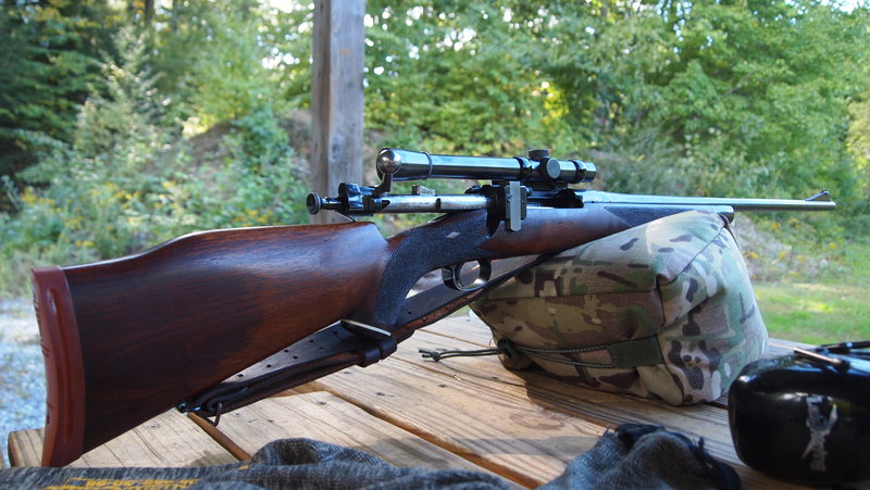

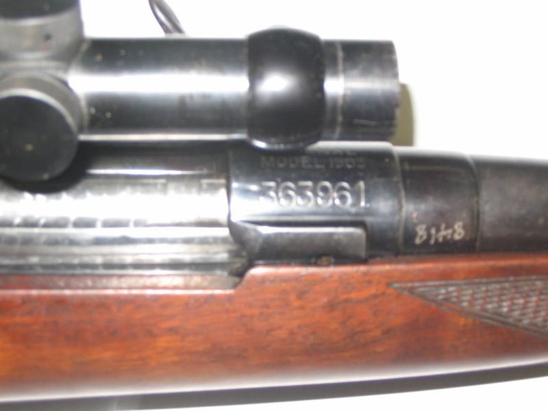

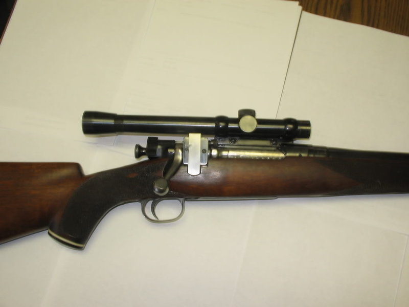

I knew I had a picture somewhere of my 1903 that is still out in Idaho. I bought it chambered in 30-338. The bolt has been opened up to take the magnum face [IMG2=JSON]{"data-align":"none","data-size":"full","src":"https:\/\/www.snipershide.com\/shooting\/core\/image\/gif;base64,R0lGODlhAQABAPABAP\/\/\/wAAACH5BAEKAAAALAAAAAABAAEAAAICRAEAOw=="}[/IMG2]​
Not a great pic but is indicative of how many of these were copied in the Segdely/Griffen and Howe style.
A similar Rock Island sporter...

It was an easy job because I was able to find a barreled action in the family. ;) The new Springfield barreled action headspaced perfect with the original bolt and dropped into the stock like it was made for it.
I wasn't concerned with the value of the rifle since it had an altered serial number and no markings to identify it by. If down the road I found out it was highly collectable, which I doubt, I could quickly change everything back to the way it was if I felt the need.
