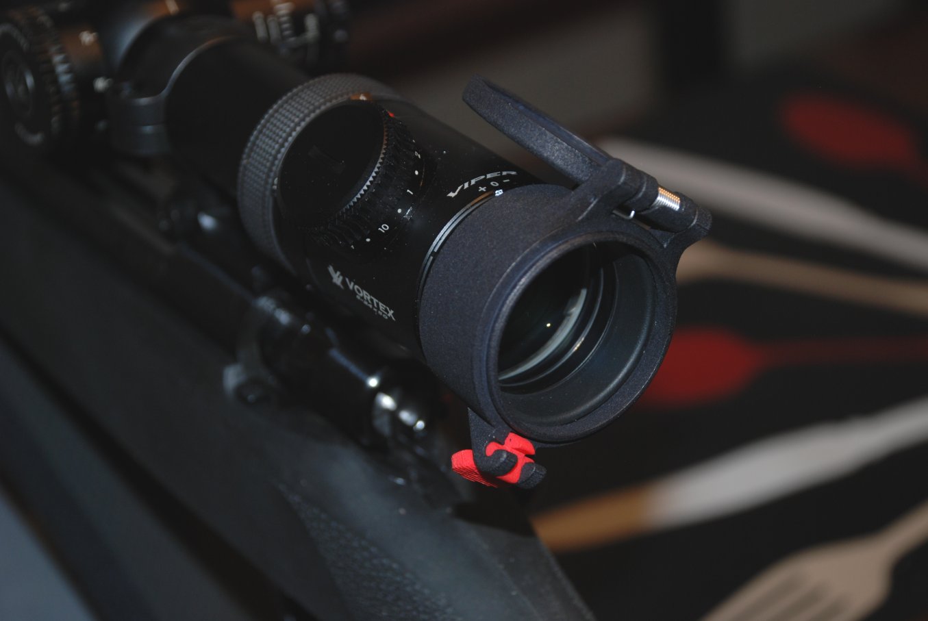

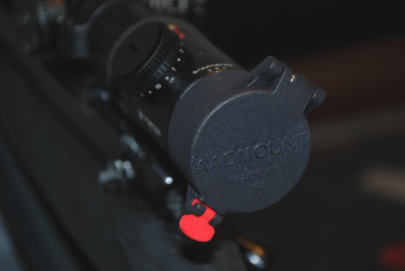

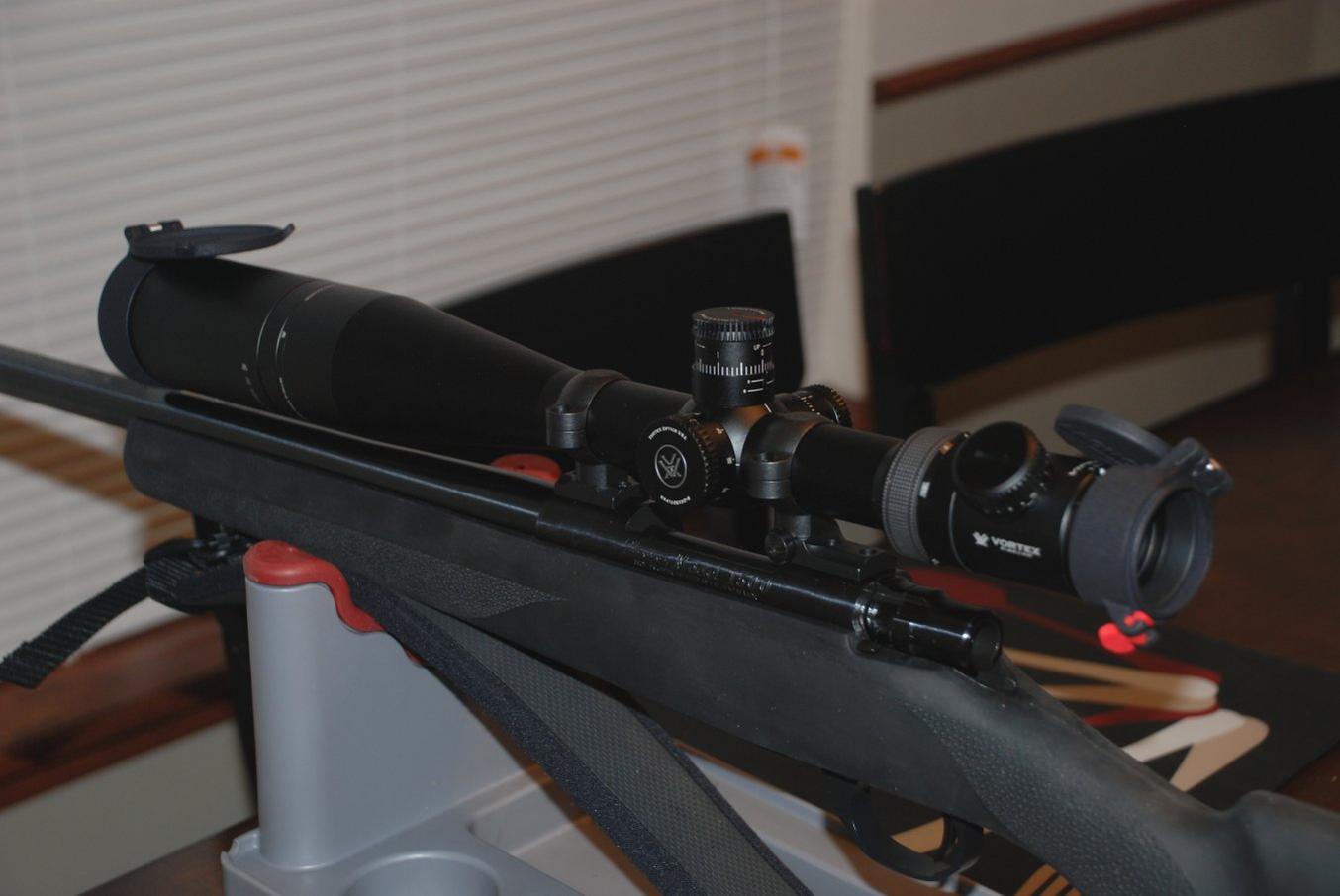

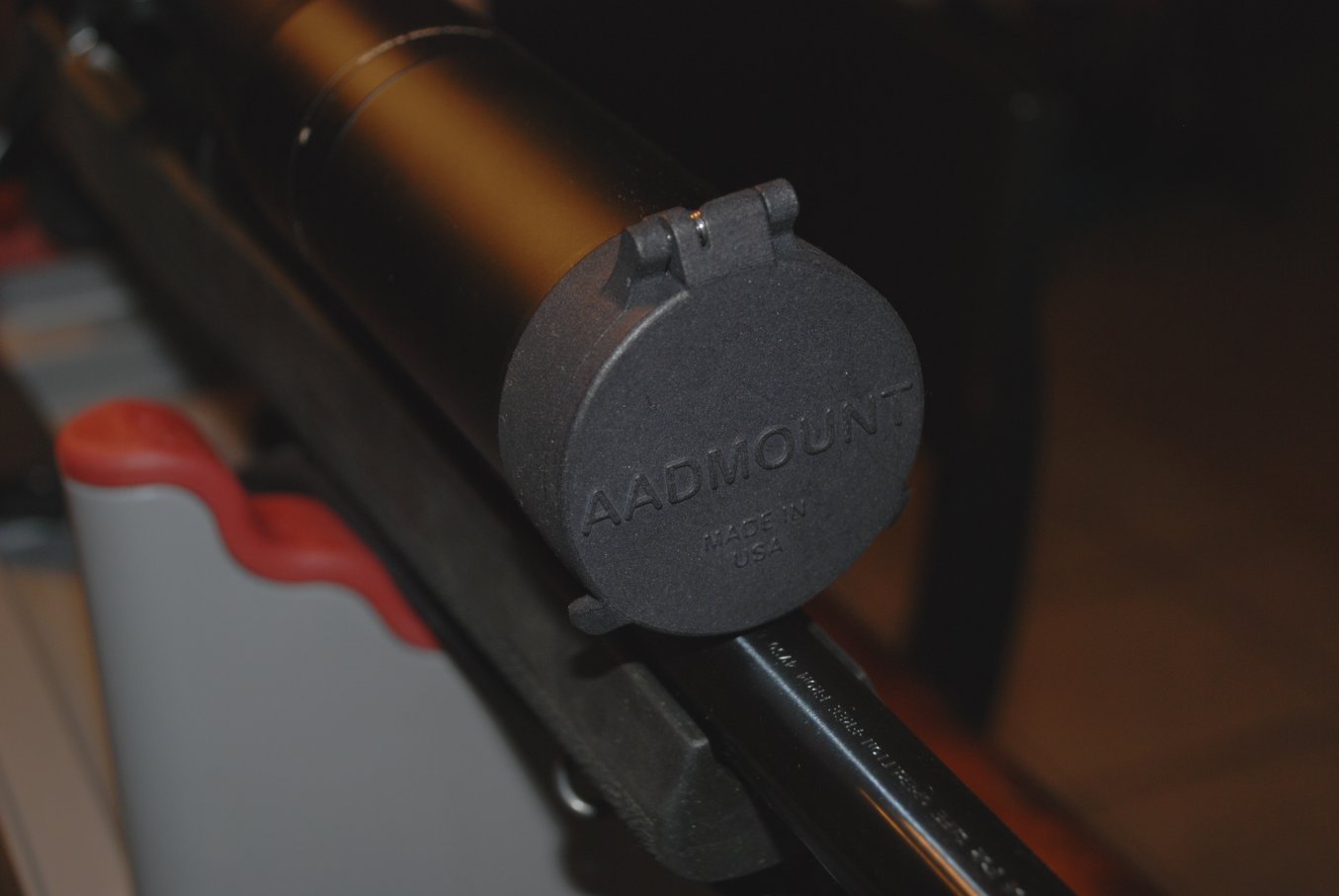

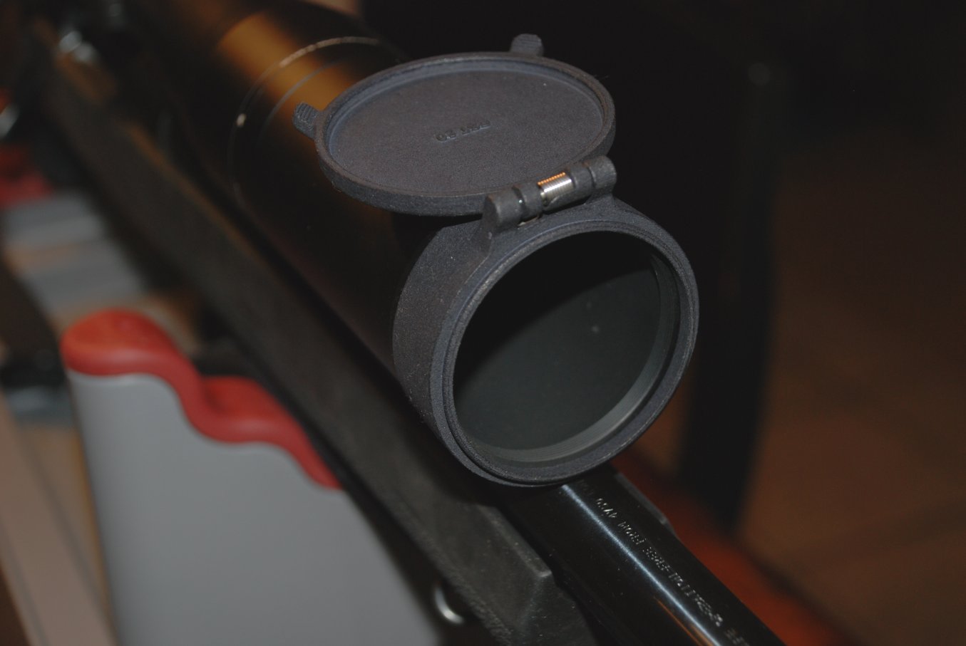

Just received my AADMOUNT Vortex Viper PST 50MM flip up scope caps today. They are very well made and designed. The plastic is actually thinner(measured at .053") than the Vortex (Bushwhacker) caps I purchased from Vortex (measured at.113"),thus giving plenty of gap between the cap and rifle barrel. They snap open and close with authority, in other words very tight. They fit the ocular and objective ends of the scope very tightly and require some effort to push on. The caps will not come off by accident. Removing them takes a lot of effort also, rocking top and bottom helps in both installation and removal. Included are small adhesive backed foam squares to help limit the noise of the cap tops opening. When installed just a finger push on one of the front cap tabs is required to open. The ocular cap is easy to open but hard enough not to open with a bump against something. These caps are well worth the price. The Vortex caps were ok, but the ocular cap was a loose fit and had to be opened and closed with both hands.0283small.jpg0284small.jpg0285small.jpg0286small.jpg0287small.jpg

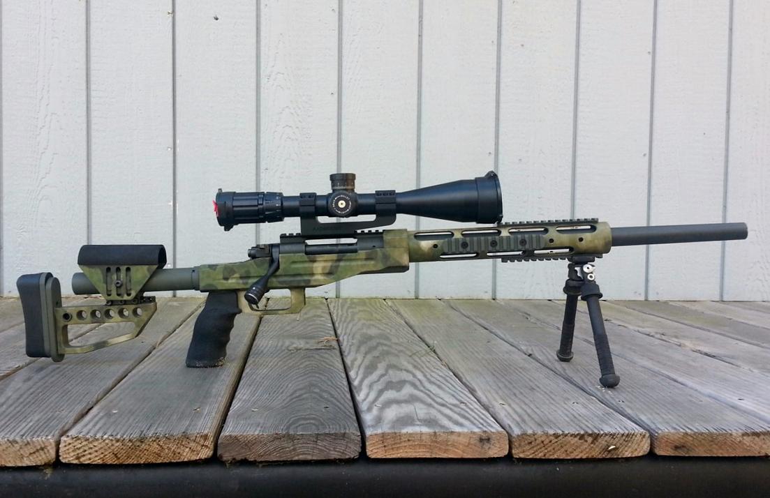

My personal set on my March made it through hunting season with flying colors:
The rifle was banged around into and out of vehicles, crawling through thick brush, into and out of a saddle scabbard, etc, as is usual (and usually enough to break BC's in short order).
