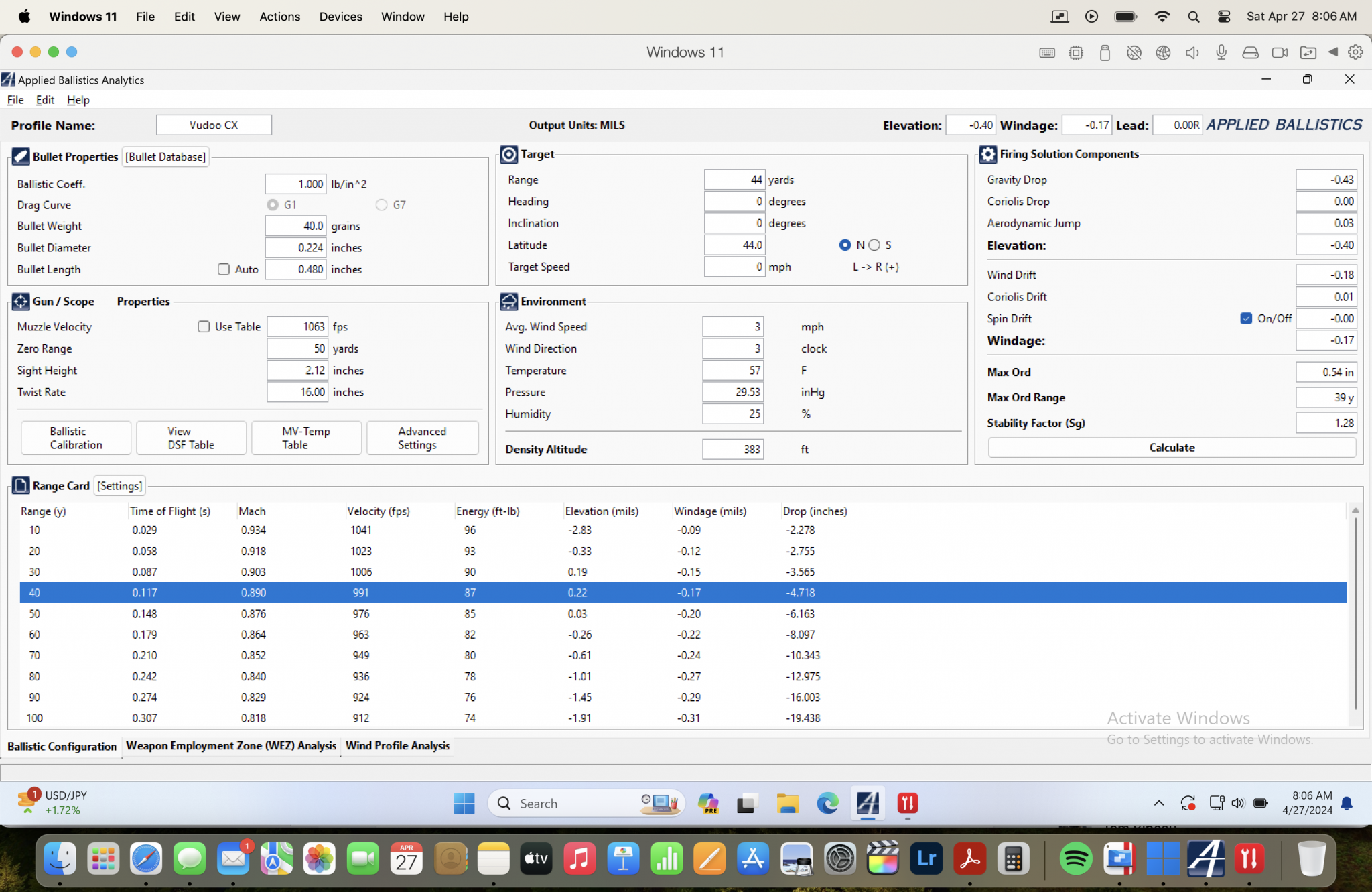

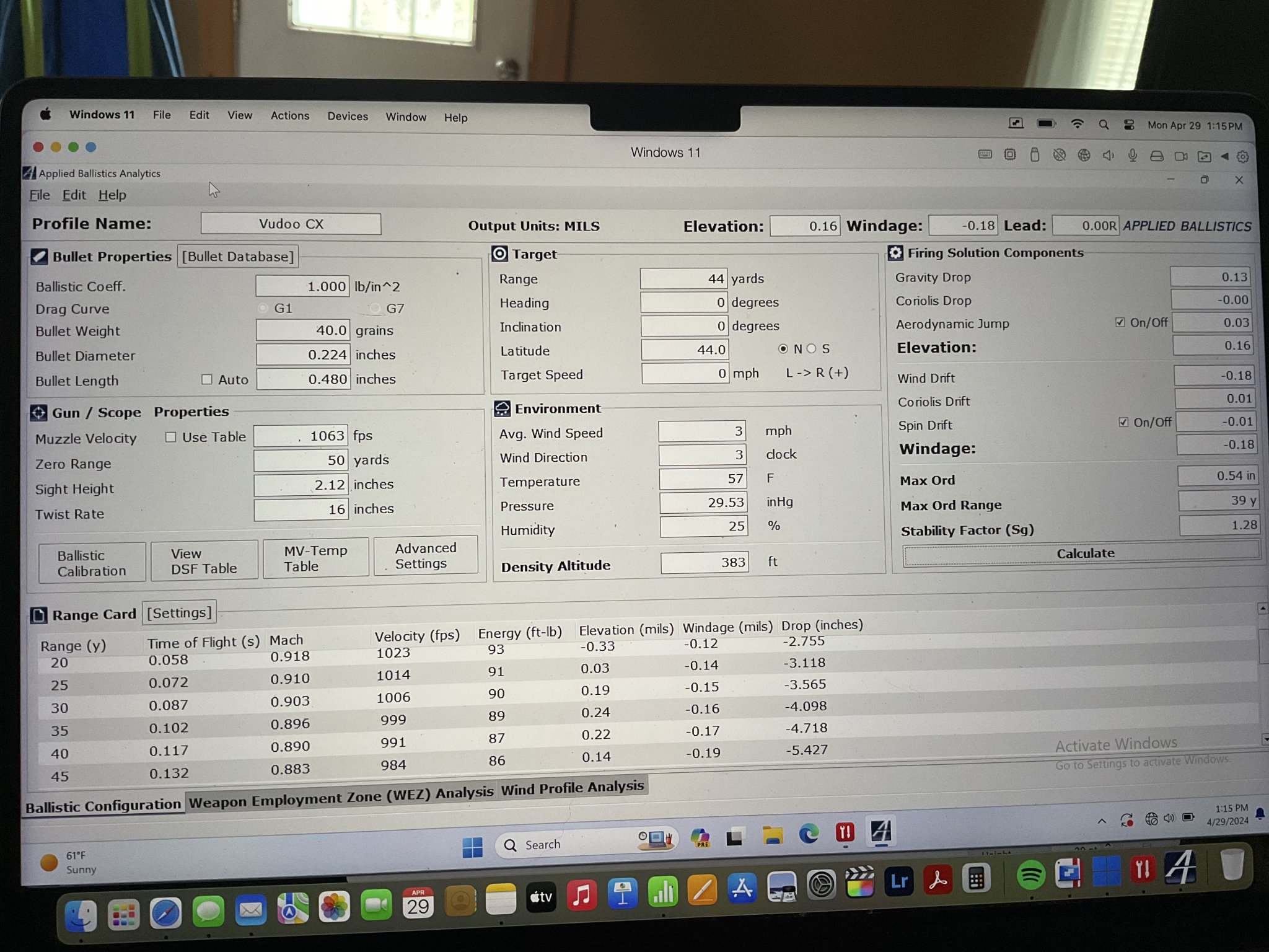

I spend a fair amount of time playing with the numbers for planning NRL22 Stages. This has got me scratching my head. . .
Rifle / Ammo Information visible in the screen shot.
The Calculated Elevation shows -0.40 for 44 yards. . . Kestrel say's .13 Down
Range Card run off the same information @ 40 yards says .22

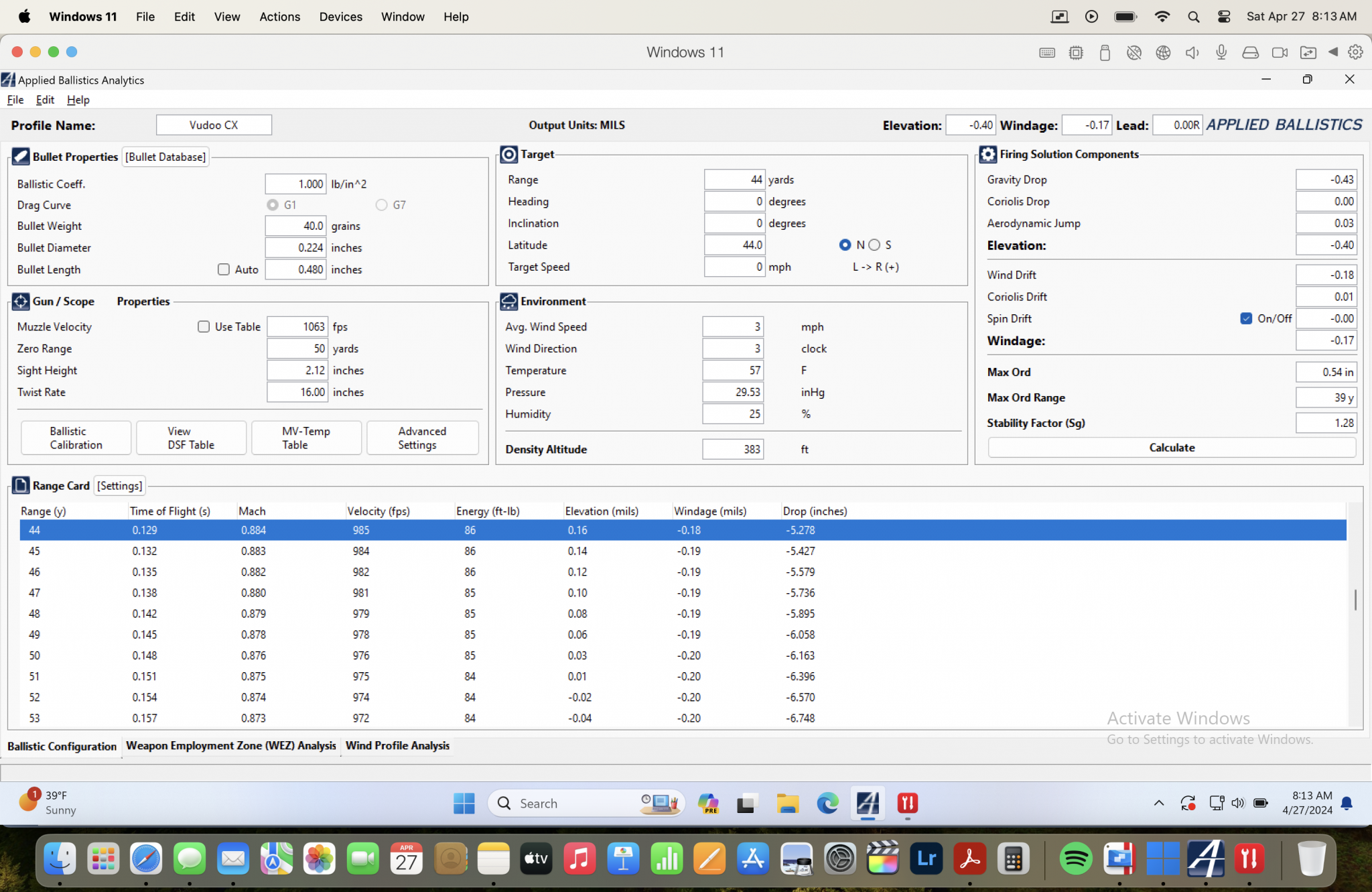

Range Card shows .16 when I update increments to 1 yard... so the Range Card looks like its calculating "correctly".
WTF is up with the -0.40?

Did you press the calculate button on the right after changing the variables? I don’t have access to mine to play with anything but this is the only thing I can see to try in the meantime.

I made sure to click the calculate multiple times as well as close out the program. Reopen. Reload gun profile. Reload information to calculate firing solution.
It's pretty much in line with the kestrel on anything OVER the distance in which it was zeroed (50 yards)
It’s probably something really obvious we are missing.
