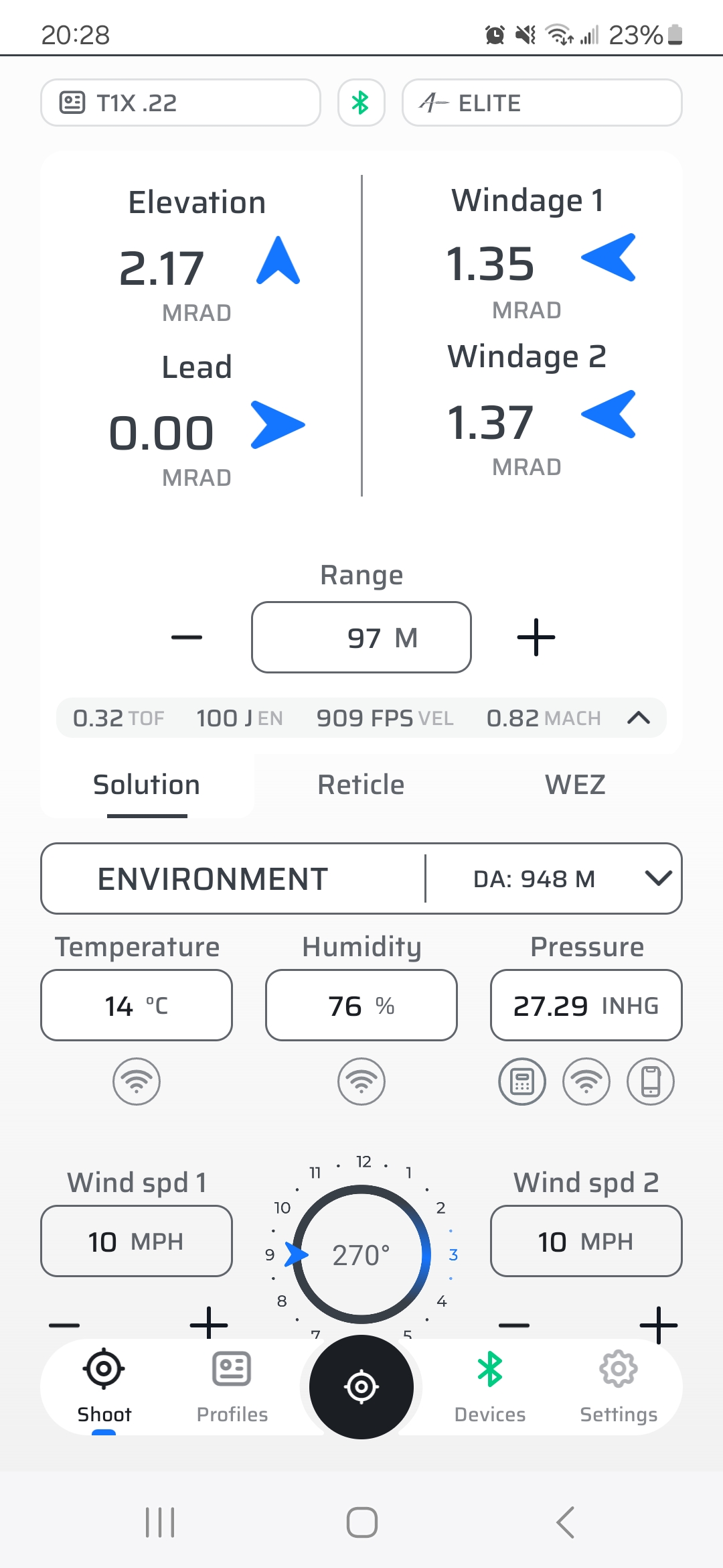

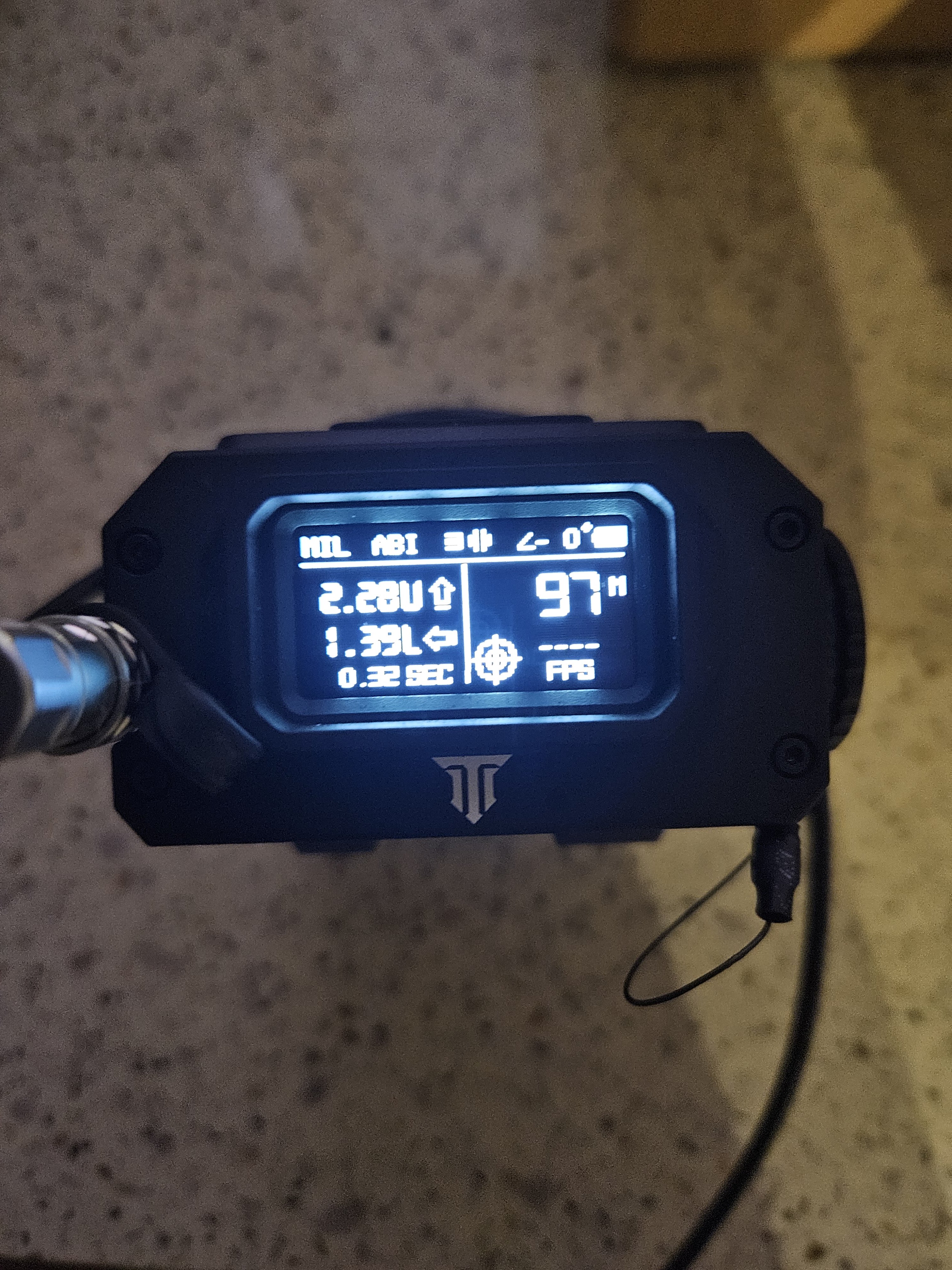

I got everything synced but when I turn off aerodynamic jump on the app the Fire 4000 still gives a solution with it.
How do I sync the aerodynamic jump settings? I'm getting a different solution on the app versus the Fire 4000.
View attachment 8661611View attachment 8661610
Settings for the App do not translate into settings for the Devices. You would have to turn that off on the device.

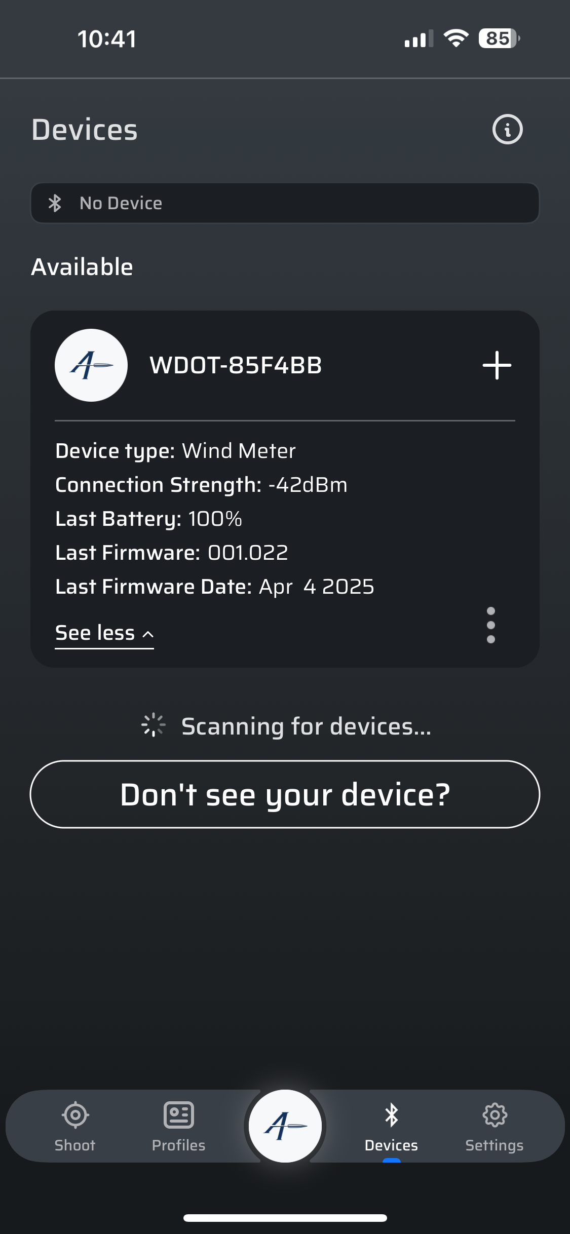

I just picked up a mini AB because of this update, but I’m getting wild readings from the meter. Lots of 30-40mph wind readings (almost always perfectly from 9 o clock) even when there’s no wind at all.
Calypso’s trouble shooting basically just says to charge it if this happens, but it’s 100% 🤔
Try to see if it needs to be updated. Mine wasn't picking up at all. I put it on anemotracker conf./update. Did it's deal started picking up. Just a guess.
Both the AB Mini and Quantum were updated to the latest version before I noticed this issue, so got that ruled out so far. Also tried placing the unit in a whole bunch of various environments and some perfect elevated and unobstructed positions, same issue everywhere 😭
  • Sad
Reactions: ShootnFool8
Did you touch the transducers, even by accident?
Nope, literally opened box on desk and went straight to charger got it to full charge and firmware update and noticed the issue as soon as it was synced. Carried it from the exterior body only and moved to a few other positions indoors and outdoors. Same problem everywhere.
I'd contact them for repair or replacement while it is still under warranty then. If it was a plain jane model doing a factory reset would be worth a shot, but no idea if the AB model is the same in that regard.
Reactions: DocUSMCRetired
I would check if this unit needs replaced. If the firmware is confirmed at 1.022
