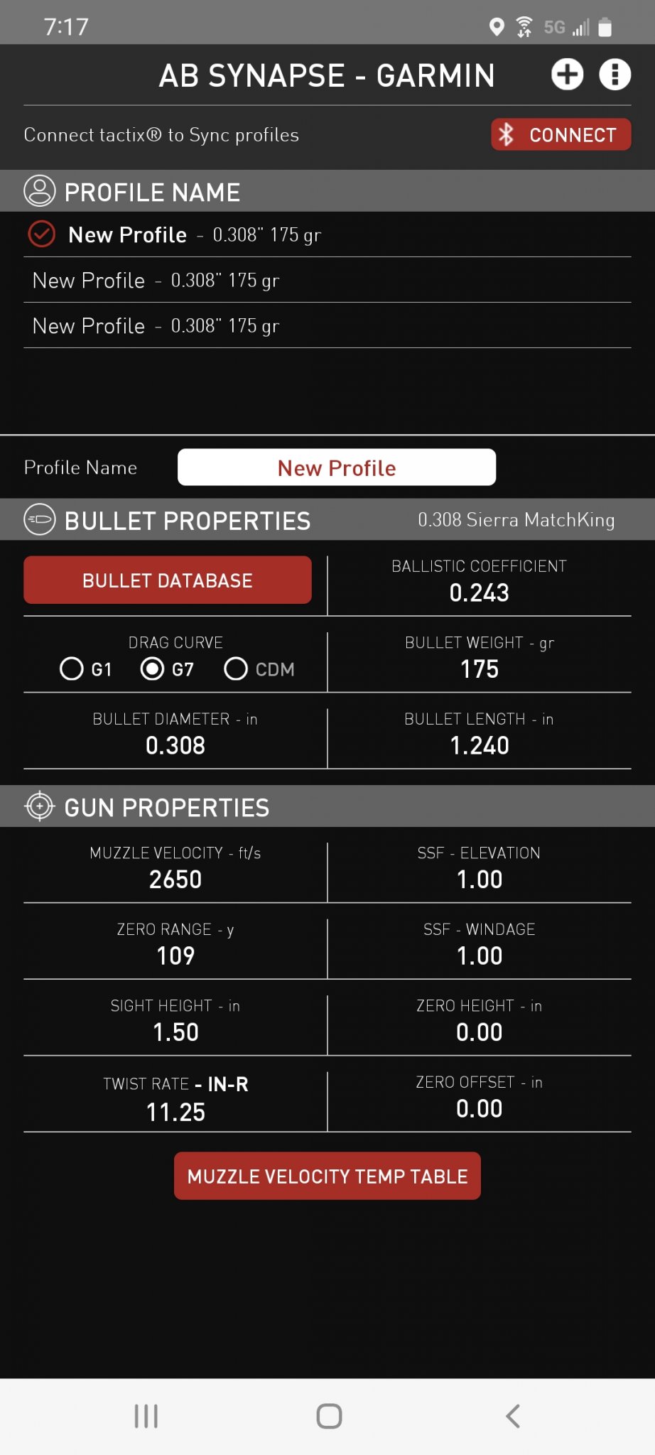

So I just picked up a Tactix 7 Pro Ballistic watch last week. Its unclear to me how to get the AB Synapse "App" which is installed on my Android phone to "See" my watch. When I open the App I see the red Bluetooth icon at the top to Connect to the Tactix but upon opening it shows an empty screen for Select Device.
Do I need to disconnect the Garmin Connect App which is also installed on the phone before this AB Synapse App will connect?

Hello, Thanks for your reply.
Yes I have the connect app already configured on the phone and it can talk to the watch no problem and vise versa.
Its just the Synapse App that isn't seeing the watch. I have all the latest updates/versions installed on both the App and Watch.
But...maybe I'll just try and re-pair them because the Synapse App wasn't yet installed on my phone the first time I did the pairing process.

Below is what my App currently shows. Clicking the "Connect" button shows an empty list. Software Build on my phone reports version: 024, Phone: Samsung Galaxy S20+ 5G
Unfortunately it appears that mine looks a bit different currently. I'll mess with trying to rejoin the BT on the watch to the phone now that I have the Synapse App installed. Maybe it will see both programs this time.
