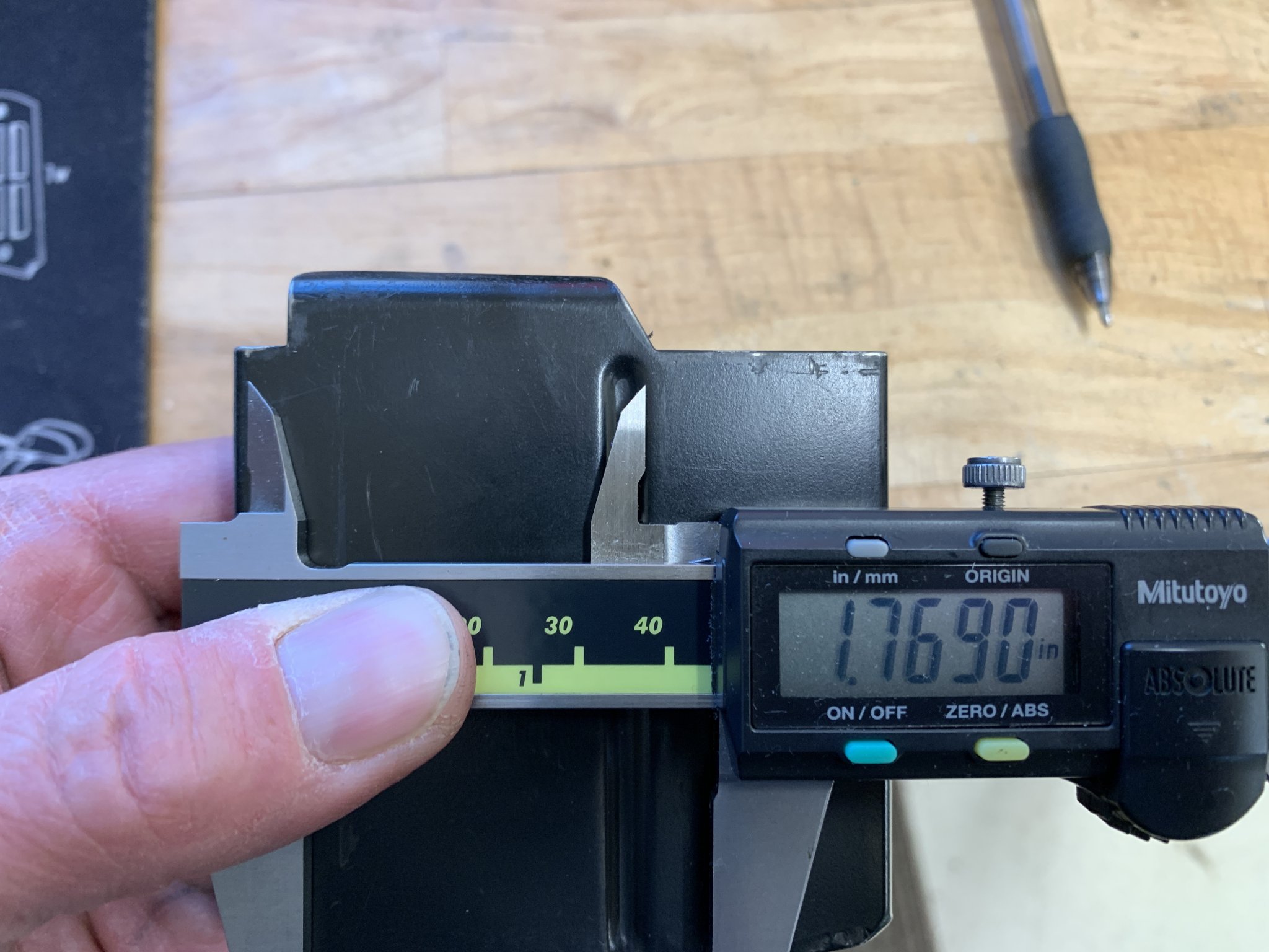

The shoulder of the 6.5-284 is at 1.770.
I wonder if he was forgetting about the rib.
