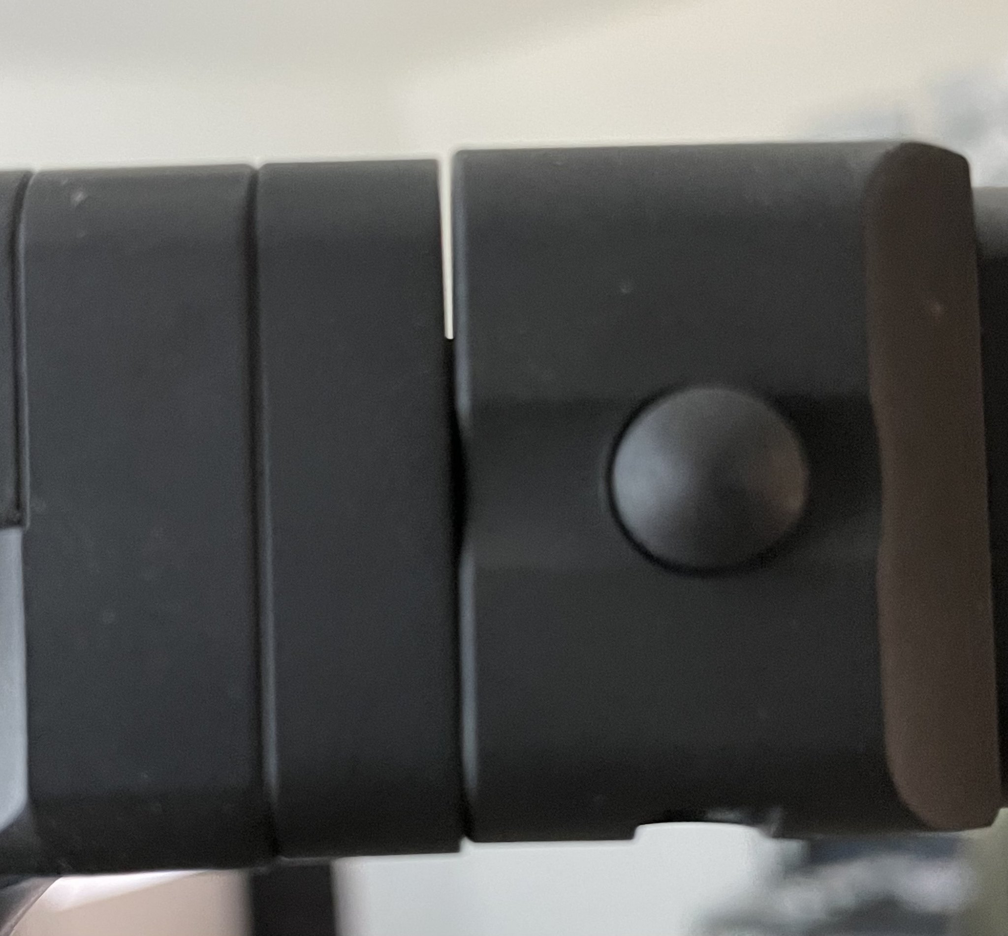

Anyone know how to adjust the ATX hinge? Mine does not fully lock. I can push the buttstock sideways and the hinge unlocks itself.
Found the issue. The only way to make the hinge fully lock is by forcing the buttstock upwards to make the hinge flush.

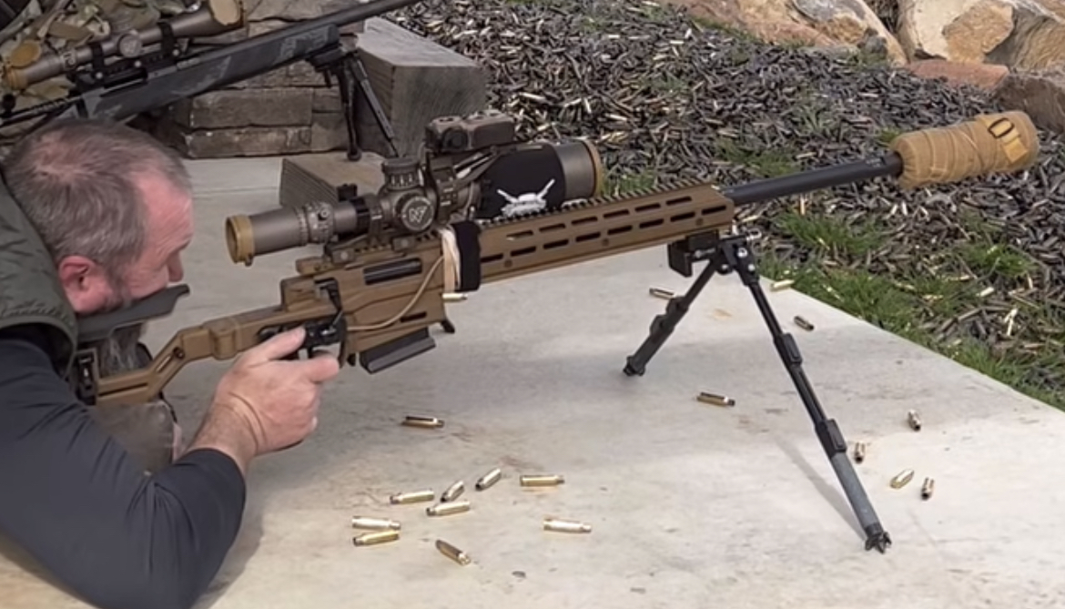

Here’s hoping the new AT-XC has the MLOK option for civvysView attachment 8418809
That's coming with the Gen 2 AT-XC, due to be released in 2025. MSRP increase of only $1,500 too. No retrofitting and have to buy the new one, but you do get a limited edition decal.

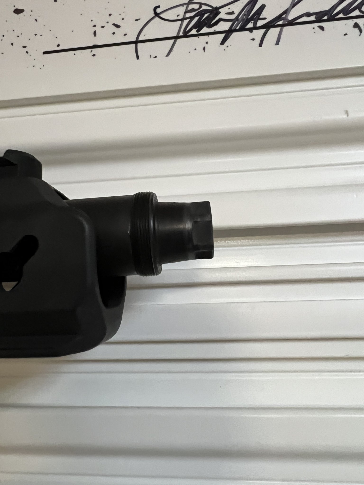

I would send it in. Contact Mile high shooting they are a distributor they may be able to help you out with that issue and expedite a return to the factory. I wouldn’t go messing with it as you may make it worse.

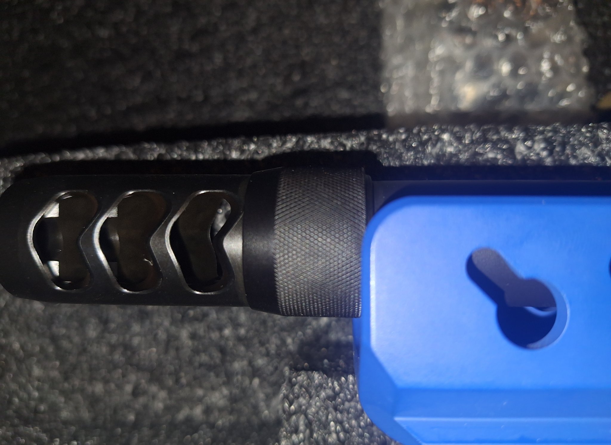

I hate to say but the erected keyslot made the ATX almost incompatible with aftermarket keymod accessories. And I ended up with a bunch out dated keymod accessories collecting dusts.
It wasn’t keymod to begin with. I don’t understand the infatuation of wanting to be able to bolt all kinds of “accessories” on.
I don’t understand that ether. Other than a vertical grip on my AR’s I’ve never attached anything to my mlok/keymod or keyslot rails other than pic rails/Arca rails or weight. Which are available in all the platforms
Mlok by design takes up space inside the forend. So either you run a larger forend or smaller barrel diameter to accommodate the screws inside.
Keyslot is flush with the inside of the forend. So it allows you to keep it slimmer with a larger barrel accommodation. It’s also without a doubt the toughest of the three.
I actually wish others chassis makers would adapt the keyslot. Then cheaper accessories like rails and what not would be an option to people as companies like Magpul would start making them
