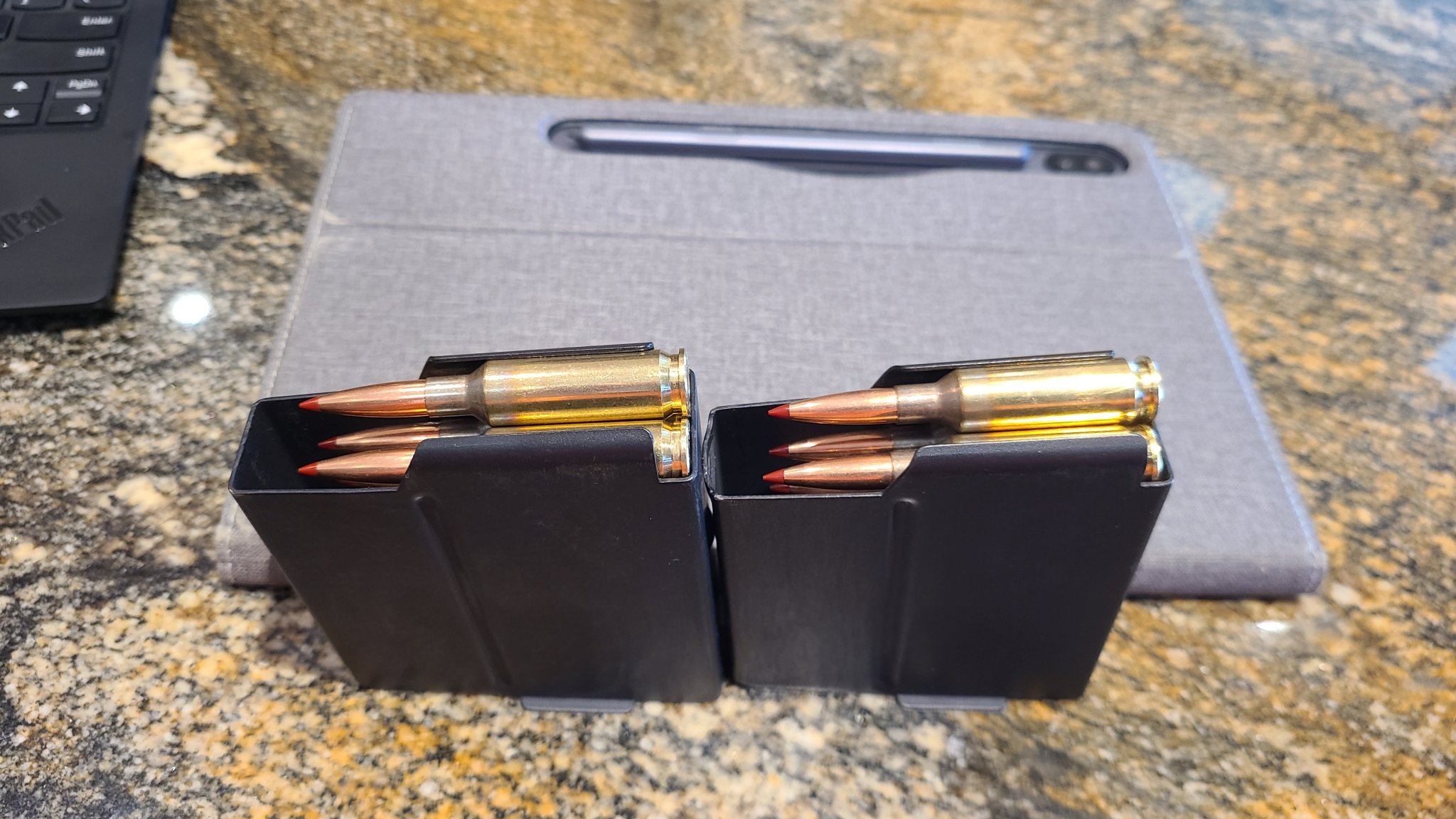

For anyone interested, my two new AX mags feed 6gt perfectly with the rounds seated all the way to the rear.
In other actions that I’ve used AW (not AX) mags, I’ve always had to have the rounds pushed forward similar to dasher rounds with a spacer.
DT, can you give us some pics of what the loaded mag looks like? Are the lips making full contact with the round towards the rear? Thanks
Reactions: Darkside-Six
AW on the left, AX on the right. Gotten into the habit of packing them back like a pack of Marlboro lights back in high school!
I’ll get some pics. But basically, yes.
The mag that didn’t feed was similar to Scott’s pic above. It wasn’t as pronounced, but you could definitely move the top rounds around as they weren’t pressed firmly up into the lips.

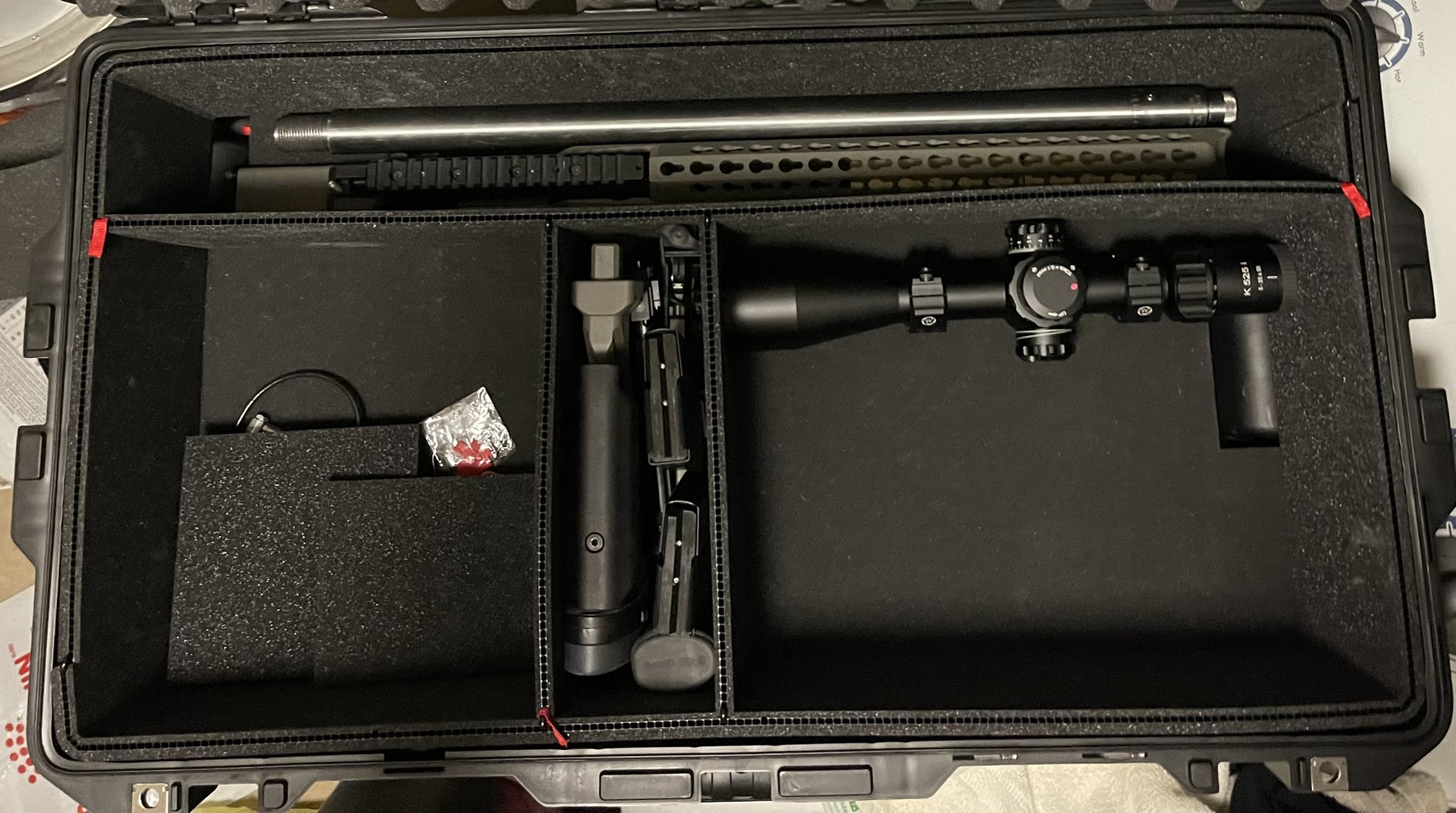

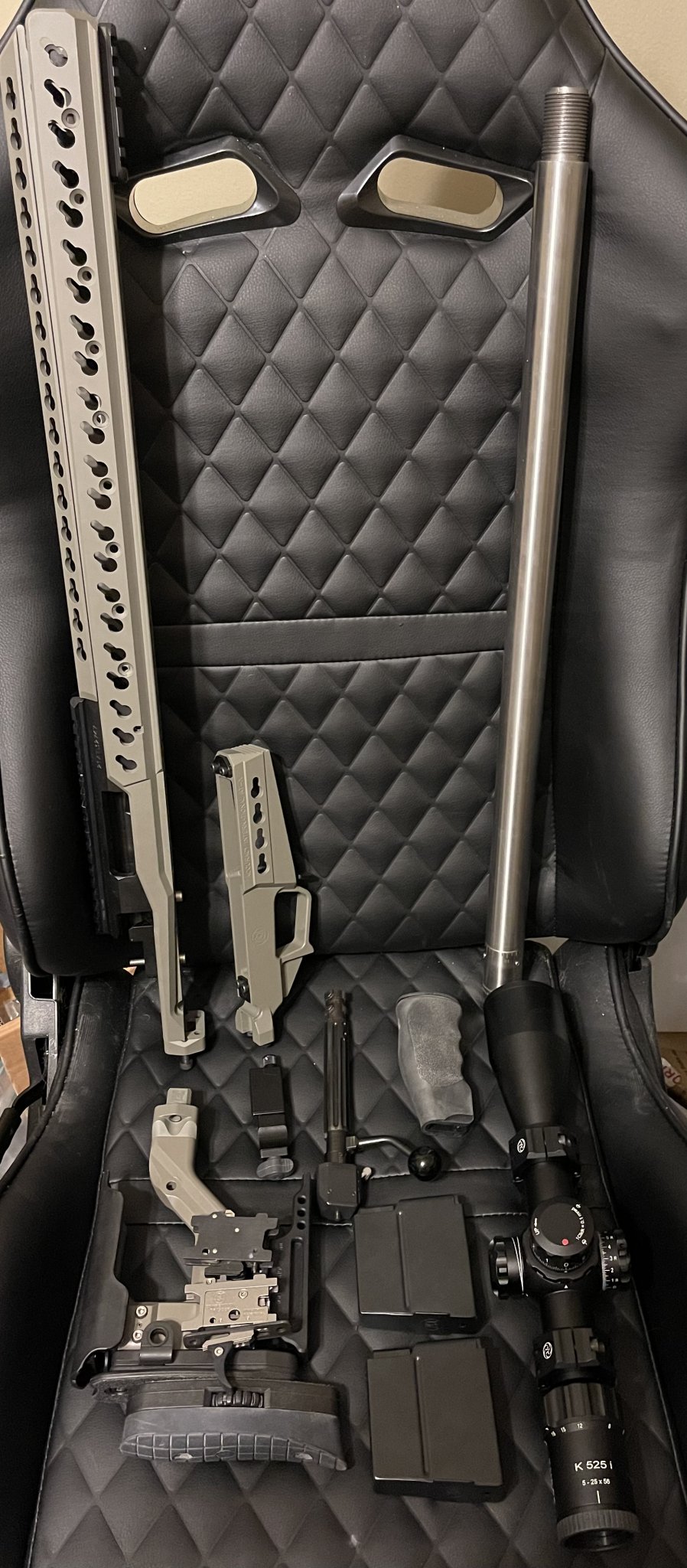

If anyone else is like me and absolutely hates dragging the long rifle case through the airport and such……
You can break it down where all but the barrel and main chassis only take up about a shoe box worth of space.
I have a Pelican Air 1615 with the dividers that I used for travel. I’ll be configuring it to hold the rifle disassembled. One less large item to drag around.

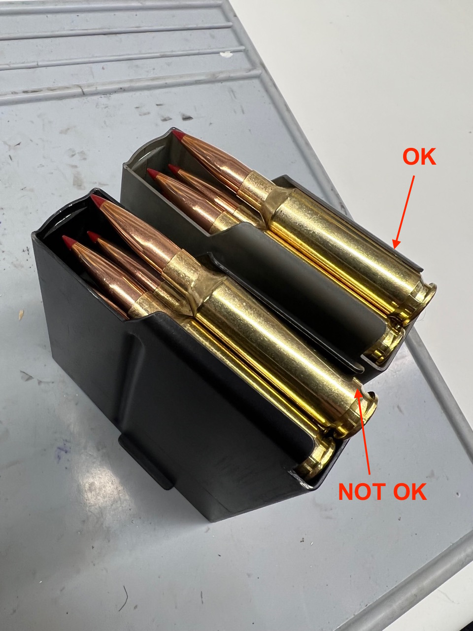

No. I am not providing a MIN/MAX dimension because of the difficulty of taking a reliable measurement.
This is real simple.
At the risk of sounding like a bit of a mouth breather, I'll inquire about this further. I promise that my reading comprehension is at least considered adequate in most places and I can recognize what's happening in those pictures.
Hypothetically, if my loaded mags look like the ones labelled "OK" and I'm still experiencing feeding issues in the neighborhood of ~50%, what can be done then? I can't send mags to AINA for tuning/repair (ITAR and all that BS) and I would really prefer to not order a stack of mags in hopes that two or three will work as they should.

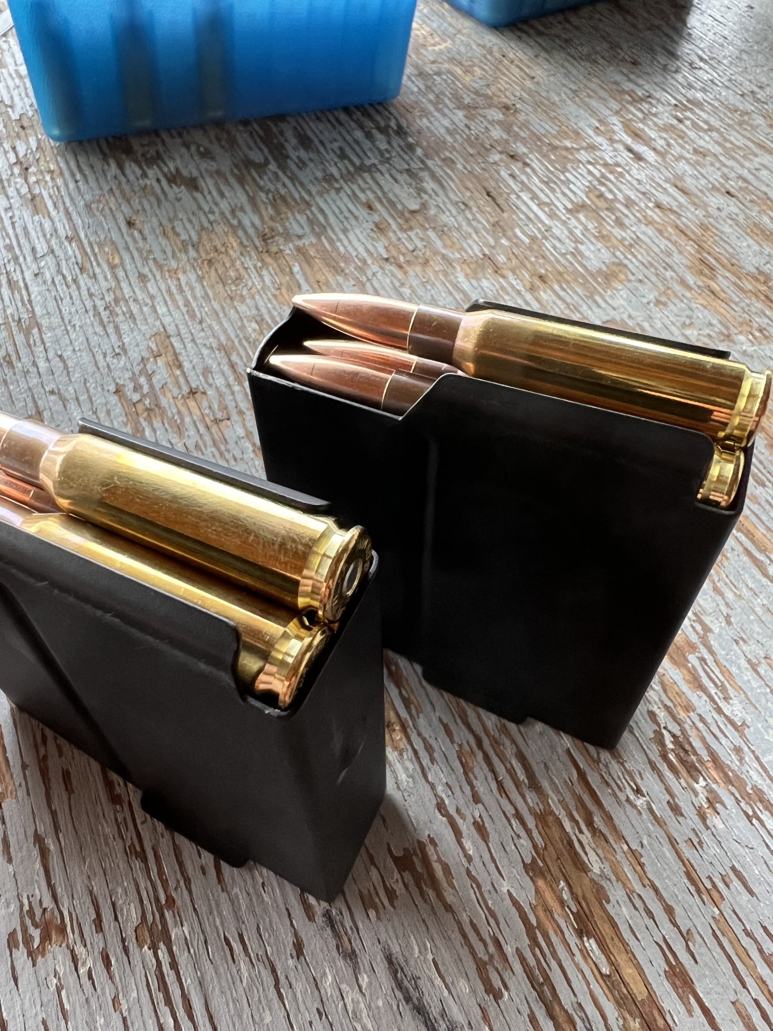

Is the fix to try and open up the mag a bit at the retention ribs and hope for the best? To be clear, I have no problem trying that out, but if there's a preferred method to this before I go in and hamfist the mag apart, I'm all ears.
Please don't consider this as another post knocking the rifle, it isn't meant to be. Love this thing, just need it to feed correctly.
EDIT: This is not a AINA rifle, it's a UK built rifle, if that makes any difference.
Update:
So I received my second mag from MHS. Yep, it's a mag issue. This one doesn't have as big a gap at the rear of the feed lips, but you can bump the rear of the case, and it pivots on the front of the feedlip, showing the rear lip isn't making contact with the body of the case. And it won't feed either. Looks like this one is getting sent back to MHS or AINA (not sure what the best action is TBH). I'll probably just reach out to AINA tomorrow, like I did for the one that came with the rifle.
All this being said; Yep, it confirms this is definitely a mag issue. But, one that AINA has taken action to address for future batches of mags. I suppose it'll just take a little while for this current batch's wonky ones to get filtered back to the mothership. The distributors (EO and MHS) IMHO may want to check their mags with 6.5CM ammo before sending more out, or check and send any suspect ones back to AINA for inspection/repair; it would certainly save a lot of people a lot of grief.

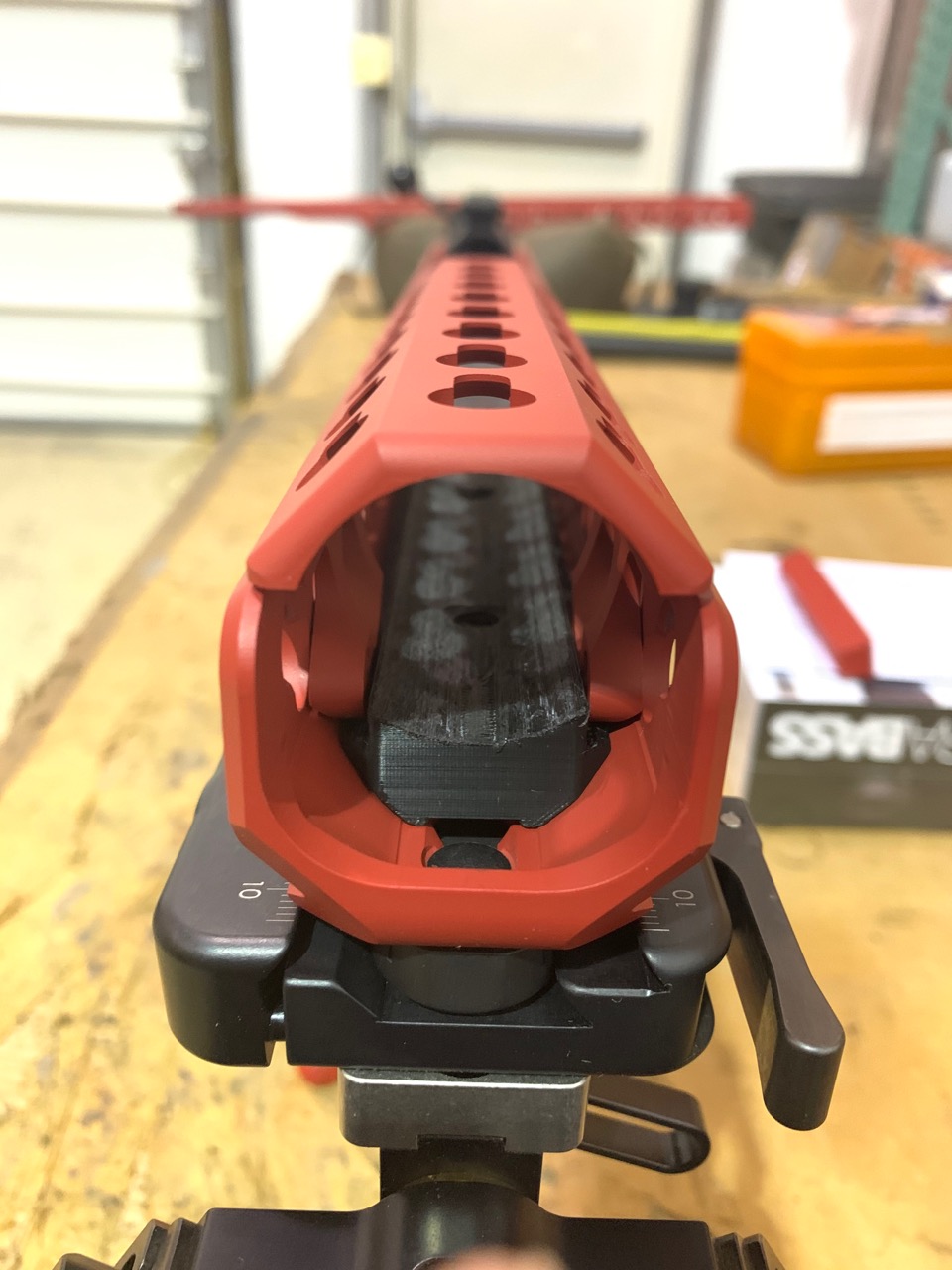

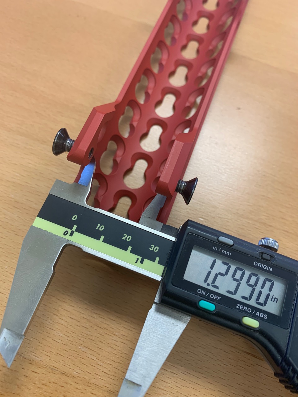

The AT-X will ship with a 4 groove cut rifle barrel in 6.5 Creedmoor manufactured by AI in Portsmouth, UK.
Barrels supplied in the US are finished at WIN Tactical from contoured blanks supplied by Bartlein. We have been using Bartlein blanks for about 10 years in the U.S. and will continue to do so.
The interior diameter of the forend bridges is 1.300". The bridge will clear a 1.250" diameter barrel. As Jorge has noted, running a no taper 1.250" barrel may not be the best approach and we did not intend to design the rifle to such extremes. The channel weights, when installed, will also clear a 1.250" barrel. The AI barrel is 1.220" at the breach end and .950 at the muzzle. The weight of the finished 6.5 CM barrel at 24" is 5.8 lbs. So, it's very close to the "M24/M40" profile in finished weight.
View attachment 7577452View attachment 7577444
@Frank Green
Frank, how much clearance would you recommend?
I have a BB 1.25” blank. Gonna toss it in the lathe and just turn it to a smaller straight.
1.20, 1.15 or something smaller?
@Frank Green
I think 1.250" might be too big and not allow enough clearance for barrel whip/vibration if the fore end is 1.3" wide. I think it would be o.k. but might be on the tight side.
1.200" you will be golden for sure. Plenty of clearance then.
So you could run a 1.250" breech diameter and either have a step down to 1.200" or some sort of a straight tapered barrel to get you down where you need to be.
Later, Frank
