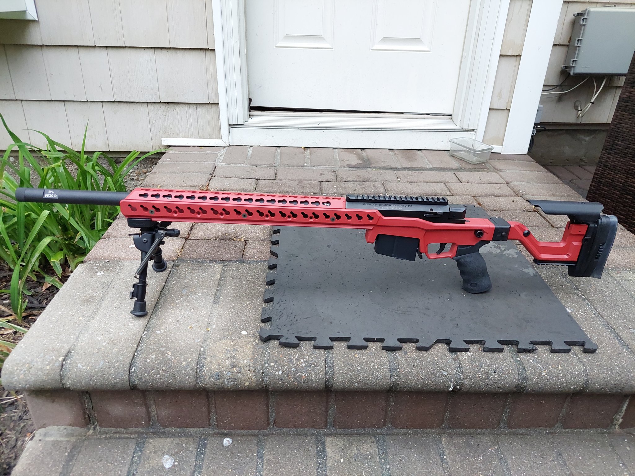

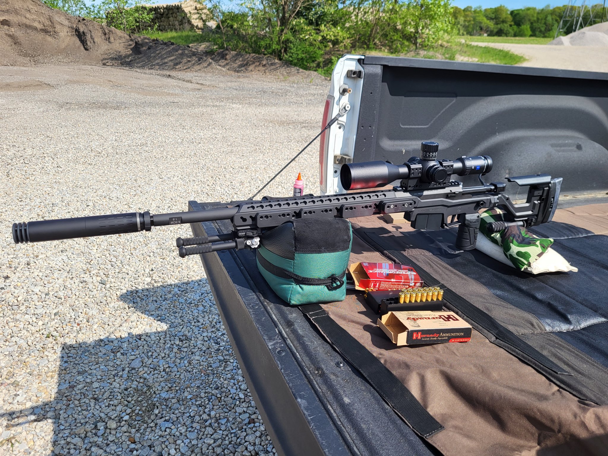

Well here she is. Everything looks like it should. Ran some snapcaps through and it fed fine. I can pull the bolt out without removing the cheekrest which is a plus even though I ordered a hinge. Going to shoot it in a few. Overall I'm pleased. Will update if any "issues" arise.
Wow, love it, looks sick! Enjoy!

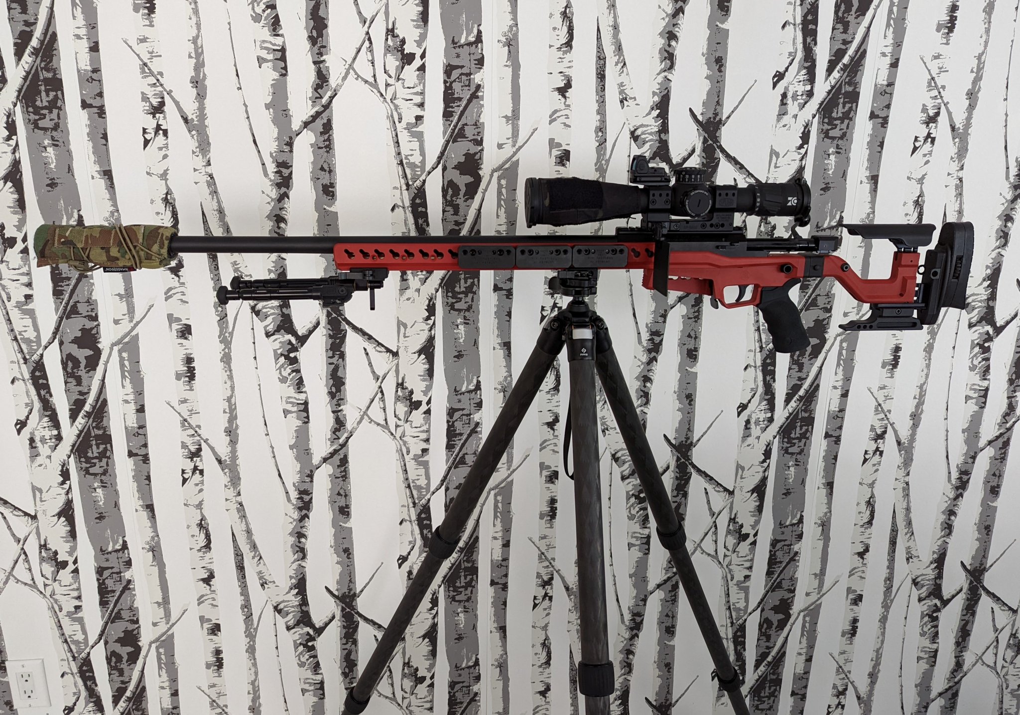

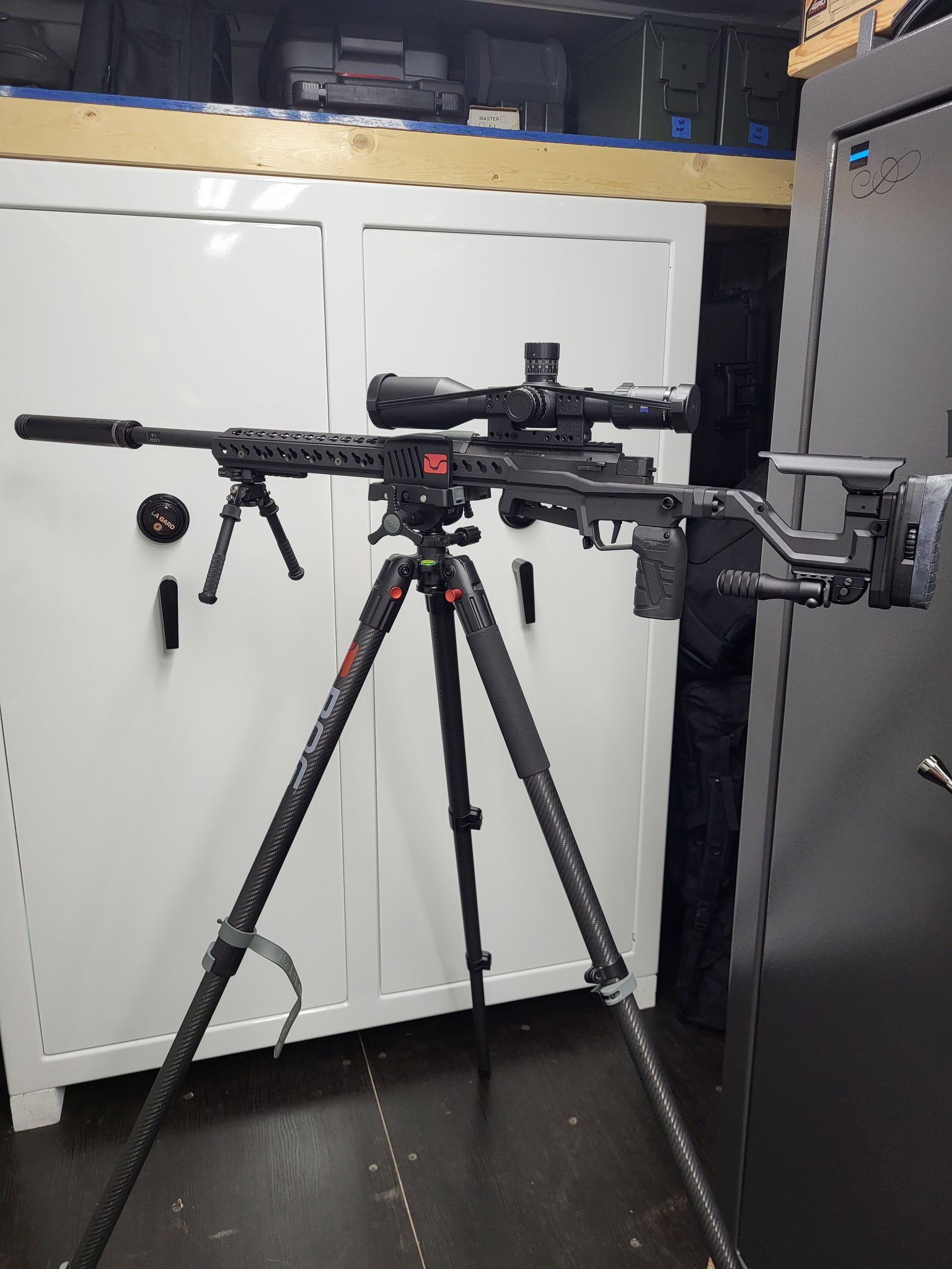

My brother in Christ, that gun has approximately one mile of ARCA dovetail on it for bipods, tripods, and probably some kind of -pods I don’t even know about yet. Are those adapters next on the shopping list?
Looks excellent, by the way. Glad you enjoy it.

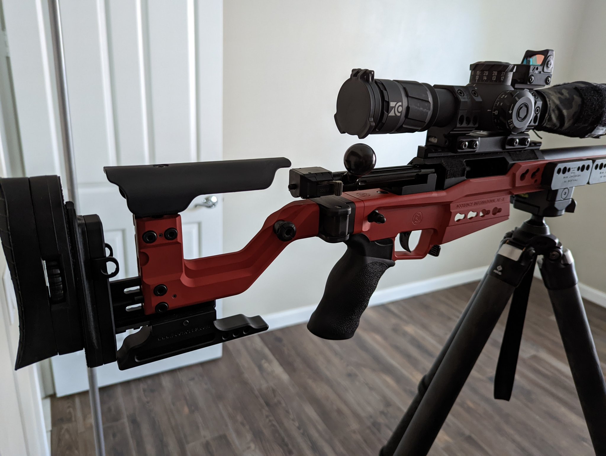

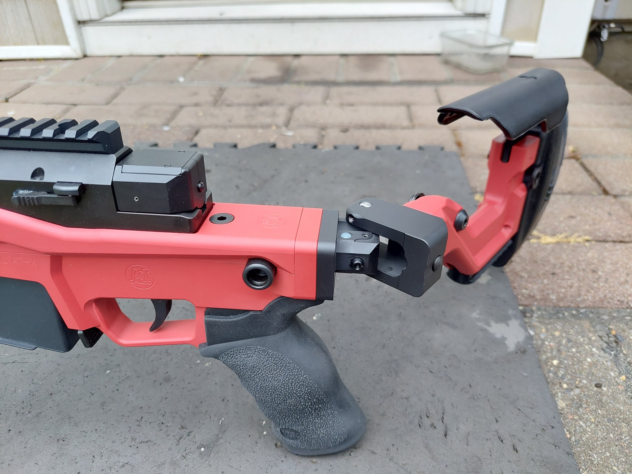

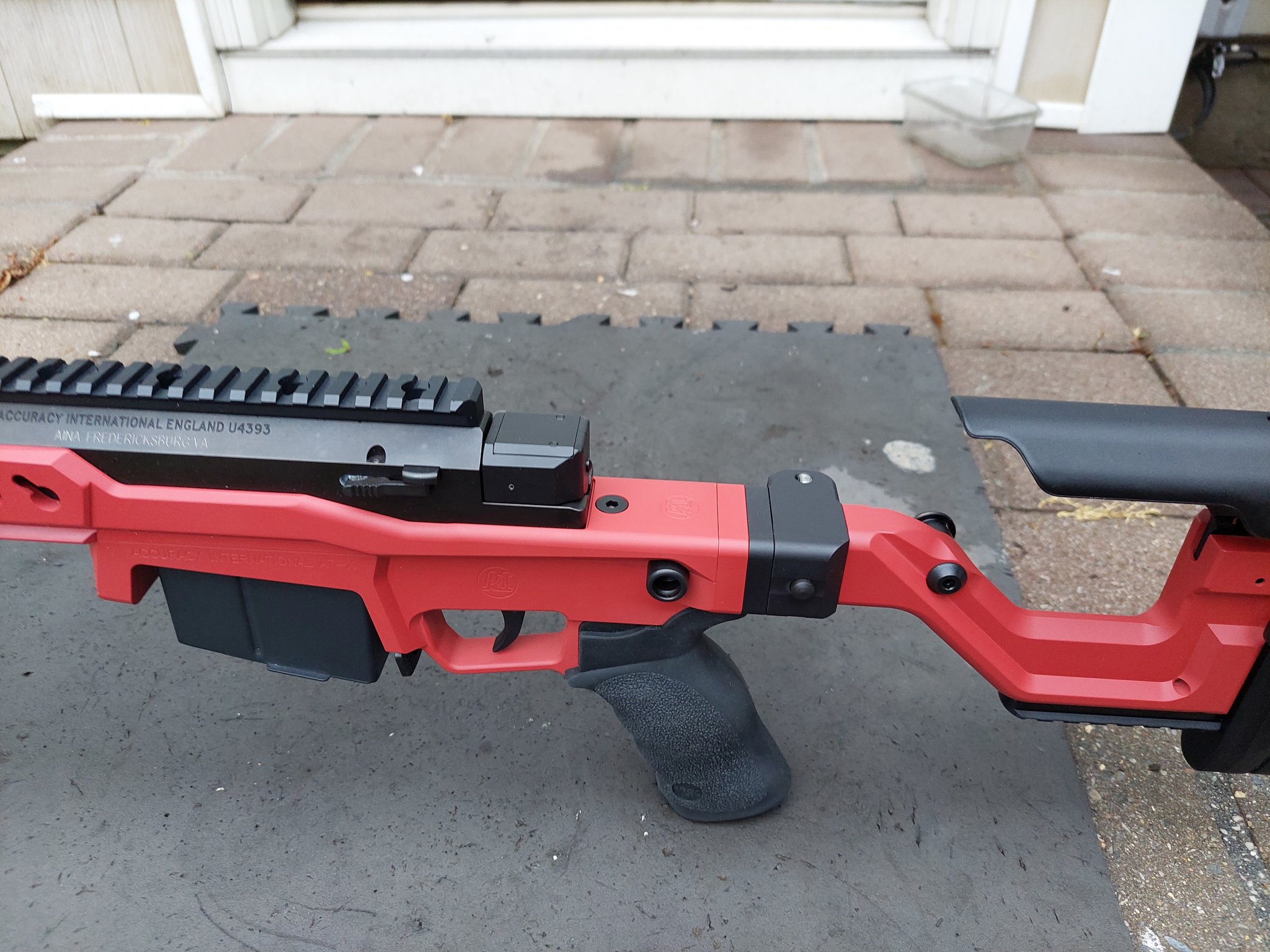

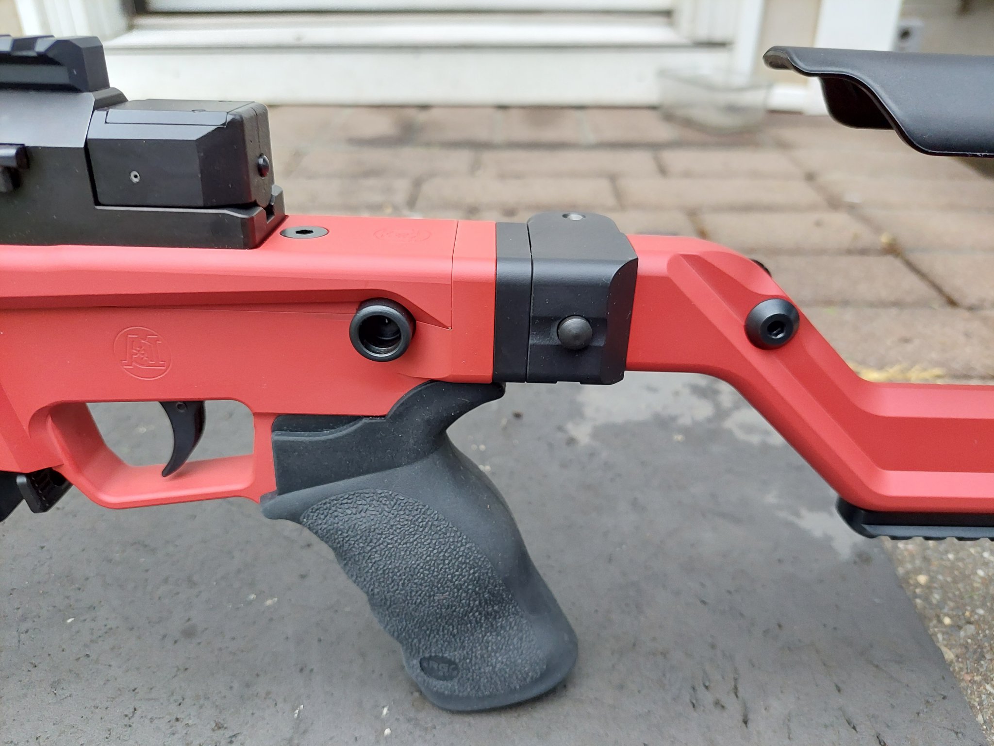

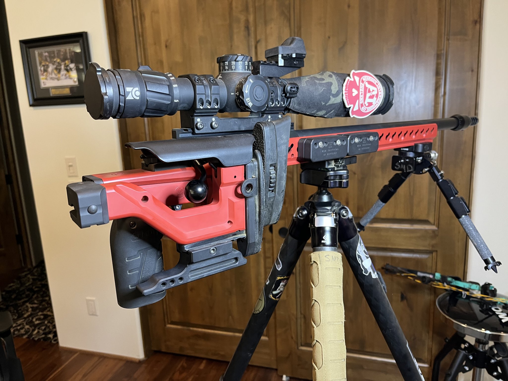

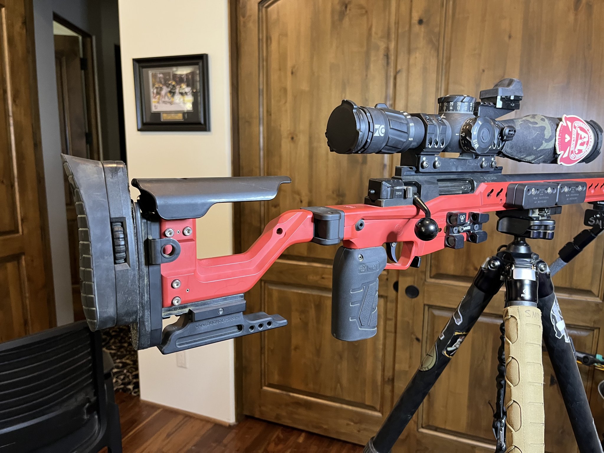

Hey while its not overly difficult, its also not really obvious how to replace your fixed stock with the Hinge Assembly. I included some quick short instructions on my website where I list the AT-X Hinge Assembly for sale:
Here they are as well (since I just replaced mine):
Below the manual calls for 44.3 inch pound torque settings for #4 (bolts to main chassis), and #5 which is the bolt to the rear chassis. These are basically the same bolt sets you will use for replacing the fixed chassis with the hinge assembly. The AT-X Hinge Assembly comes with (4) M6 hex screws and (1) M5 hex screw. You will need to remove the part below that is between the screws #4 and #5.
AT-X Hinge Assembly Torque Settings
Additionally, you will need to remove the below part as well (between #1 and #2). You will then replace these with the Hinge Assembly.
AT-X Hinge Assembly Torque_Settings_Rear_Chassis-2
edit - of course there are the other parts like the part that keeps the stock in the folded position - those are pretty obvious so I didn't include them...
opening the hinge was the toughest part for me. The hinge is extremely tight and without the stock attached to get more leverage opening the thing took some prying which I don't recommend, maybe someone has better tips. If I was doing it again I'd probably try clamping the end in a vise with soft jaws and slowly tapping open the hinge with a mallet.
Reactions: Timo Turl
Ha, I did the same thing, but I think if I put the stock on to get it open, and just inserted both ends loosely into the slots, I could have done it without prying with a flat head screwdriver and marring the nice anodizing job....
Kind of difficult to describe I guess...
Reactions: TylerN
I just plugged it in to the unbolted stock parts. That worked perfectly.
This is what I was trying to say I should have done :) @BuLLet just said it so much more eloquent
Another annoyance, but pretty trivial annoyance is now the stock closes right where I had my spare 2 round carrier... Gotta find another location for that now and there is not a lot of available space on the chassis :)
Same, thinking I'll try the elastic 2 round carrier instead of the Hoptic quiver to solve that one. I believe SAP makes an elastic carrier.
This is what I was trying to say I should have done :) @BuLLet just said it so much more eloquently.
Great feedback and instructions especially on opening the hing!

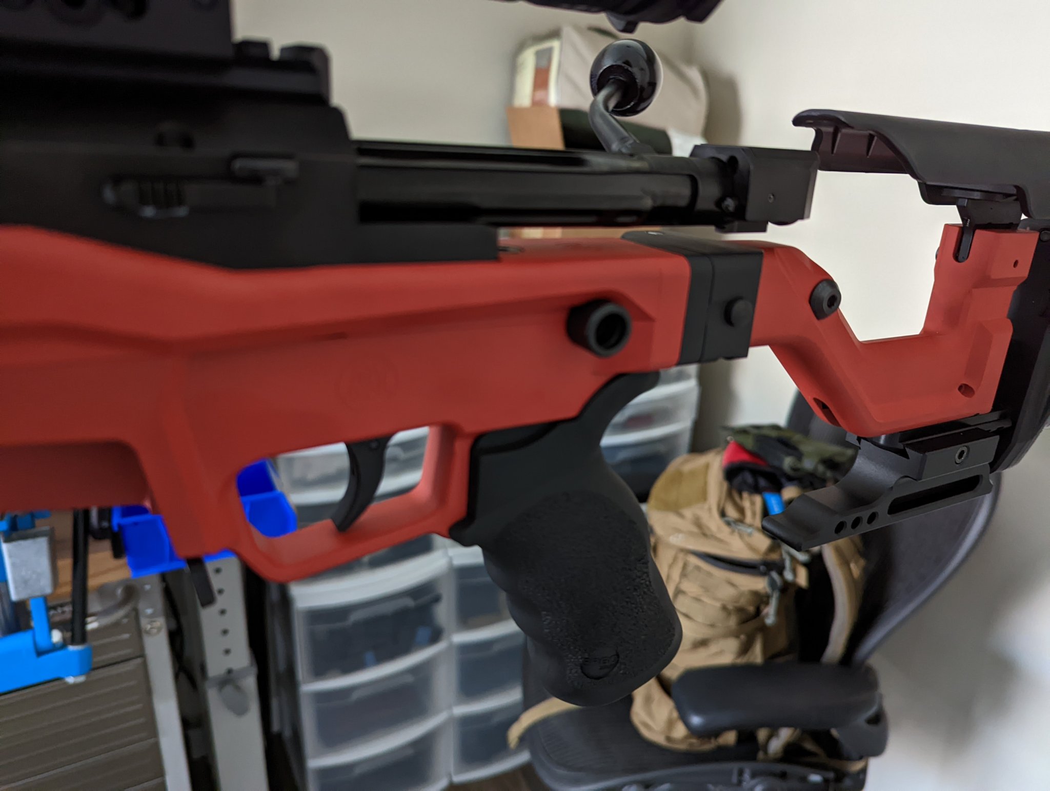

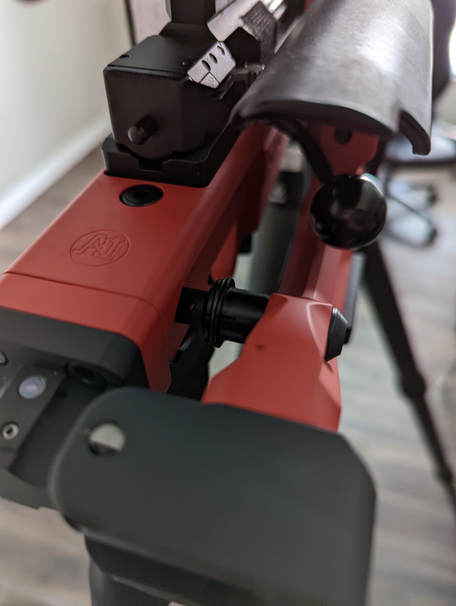

What is the flushcup assembly for if I already have one on mine?
Reactions: blbennett1288
You're missing the lock that secures the stock open. Remove the flush cup from the stock (above the grip) and re-use the flush cup and small screw to screw in the post with the nipple on it. Then screw in the cup that clamps over the nipple on the stock like this. Then when the stock is opened all the way this catches and holds the stock in position.
Since I haven't decided if I'm gonna remove the quiver might leave as is.
Did the male part slide through the chassis easily mine will not push in?
