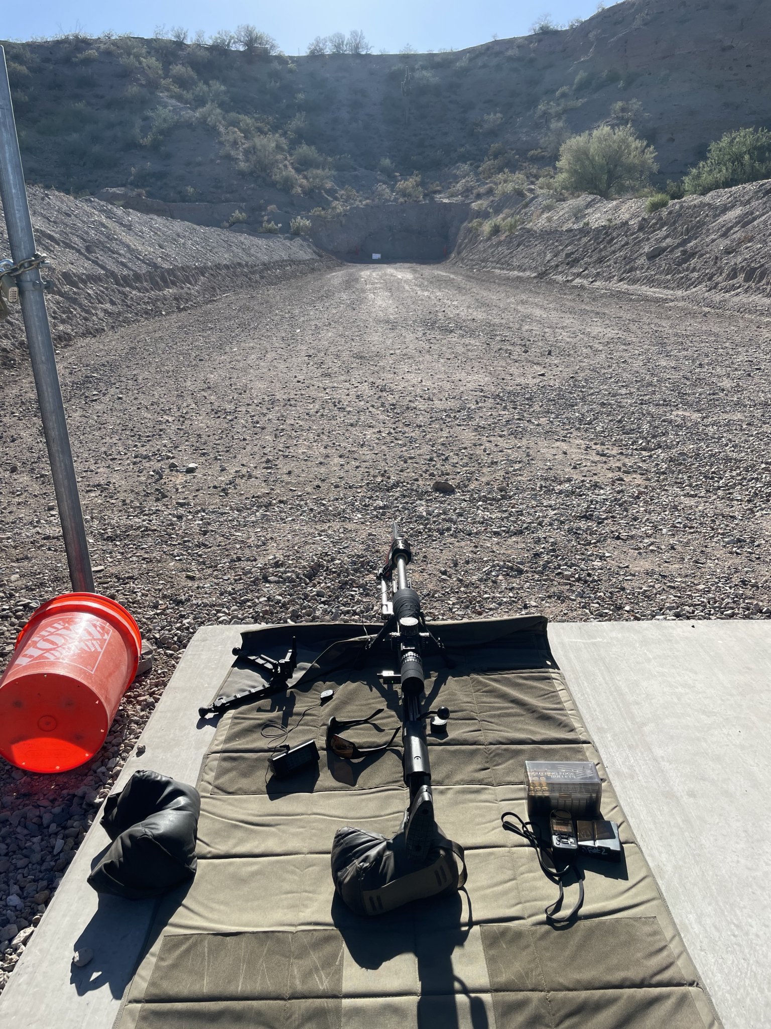

I went back out a re-zeroed after switching one S&B in a lower mount for another in a 1.5" mount. This rifle, caliber and suppressor combo continues to impress me and I hope I can do as well when I get off my belly and on to some positional shooting. Shown with the '21 Toyota TRD Pro gun carriage in the magnetic grey master race. ;)

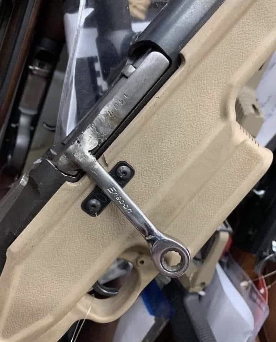

Yep. Playdough with 5lbs of locktite. I stripped one also.
I felt it strip and immediately said it’s not worth it. I knew where that road was going to lead.

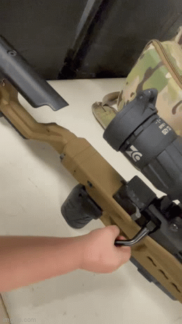

Idk about anyone else but my bolt lift is ridiculous. A few people on the hide said it was comparable to a Zeus and that’s not even remotely true. I’m 220lbs and can do 15+ pull-ups and deadlift basically a Toyota pickup. The bolt lift is stupid heavy.
Don't you hate it when your expectations get crushed by the reality of a thing after hearing all the hype from people online....
Severely. My AXSR has a marginally better bolt feel overall. I figured with the exaggerations and what I experienced with the AXSR that it would be in the same realm. But this ain’t it with the ATX.

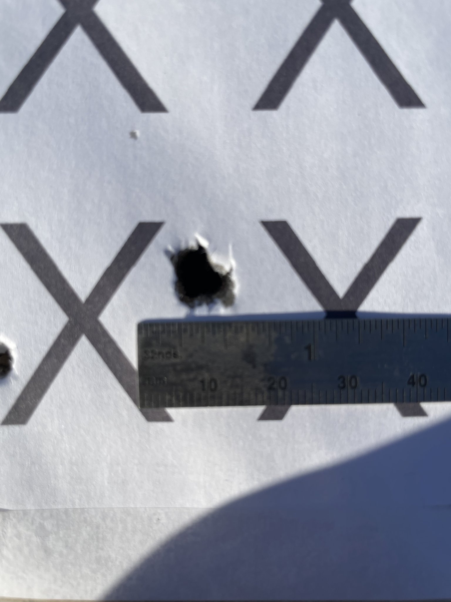

Does alright with the 6CM barrel and a random load of 38gn RL16 with 108 ELDM. 6 shots on the first pic and 5 on the second.

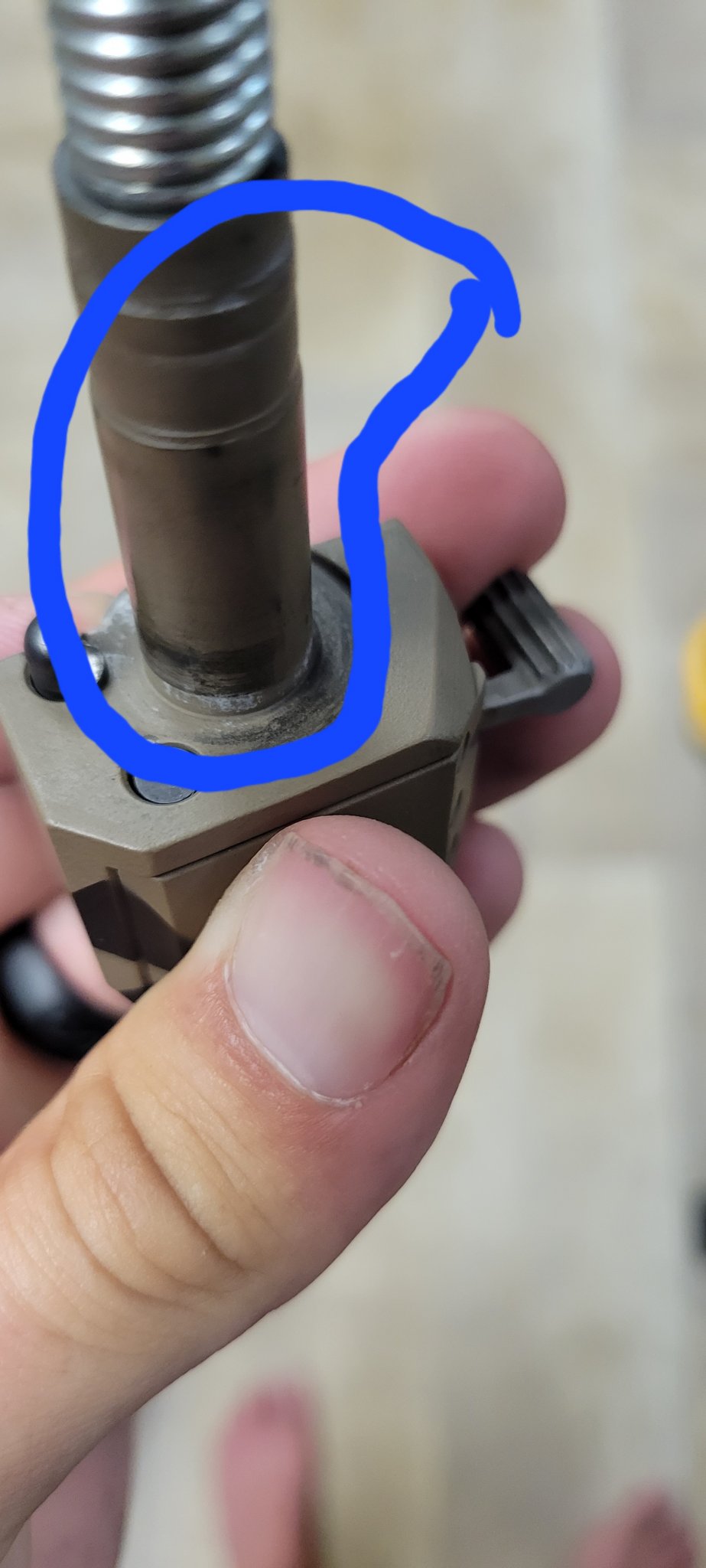

Something I learned last week. Ever since owning my AI, I have never thought about lubing the back of the firing pin assembly. I did so because my bolt was significantly heavier on open and especially closed ever since getting it cerakoted. Little did I realize it was because the factory grease had been taken off by degreasing, sand blasting, and cerakoting. I greased it up and it feels better than it ever has. Everywhere that is circled in blue. A little goes a long way if you use the right grease.
Also grease the rear face of the bolt body where it meets the front side of the bolt shroud.

What grease do you recommend?

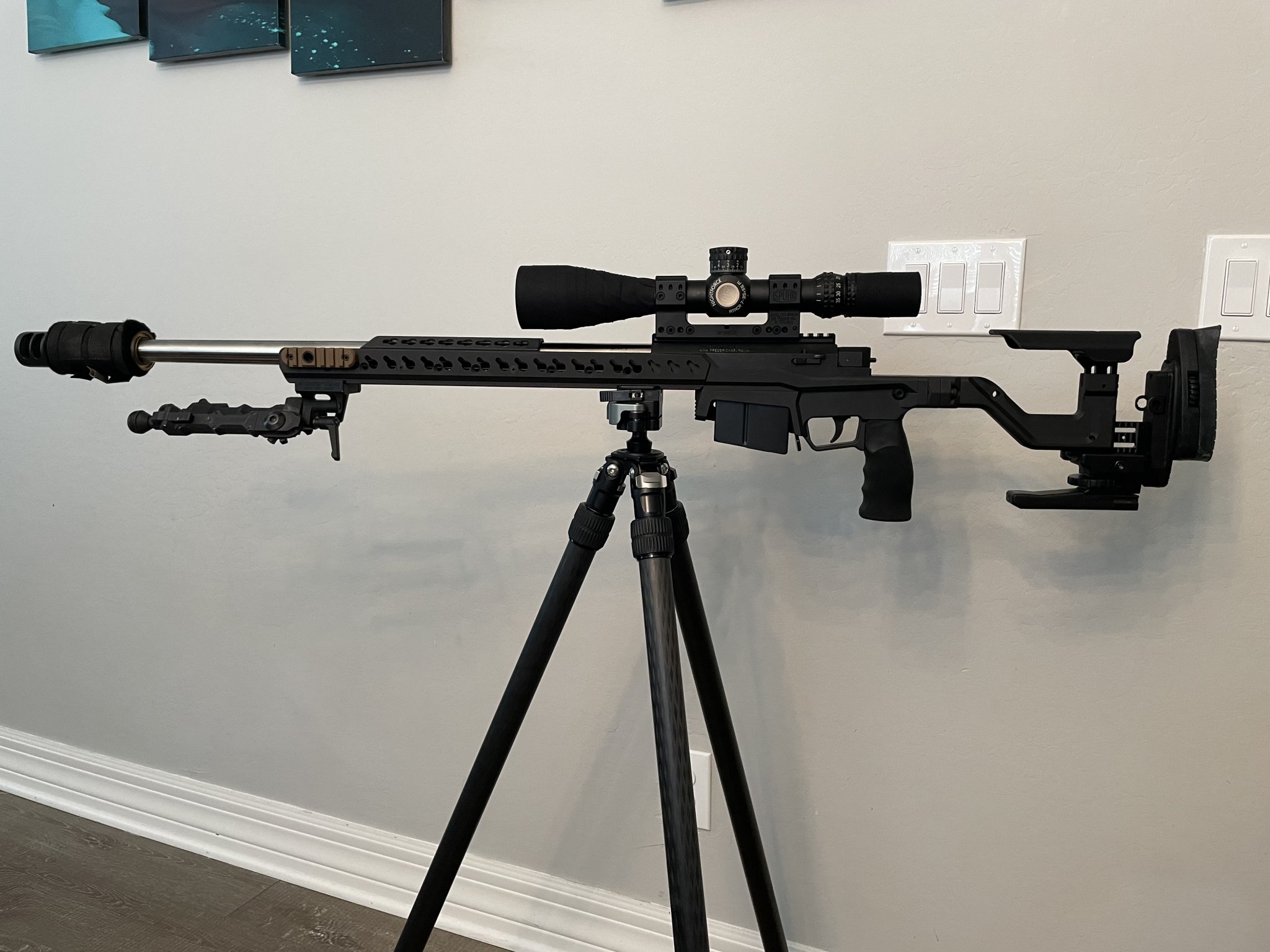

Hey while its not overly difficult, its also not really obvious how to replace your fixed stock with the Hinge Assembly. I included some quick short instructions on my website where I list the AT-X Hinge Assembly for sale:
Here they are as well (since I just replaced mine):
Below the manual calls for 44.3 inch pound torque settings for #4 (bolts to main chassis), and #5 which is the bolt to the rear chassis. These are basically the same bolt sets you will use for replacing the fixed chassis with the hinge assembly. The AT-X Hinge Assembly comes with (4) M6 hex screws and (1) M5 hex screw. You will need to remove the part below that is between the screws #4 and #5.
AT-X Hinge Assembly Torque Settings
Additionally, you will need to remove the below part as well (between #1 and #2). You will then replace these with the Hinge Assembly.
AT-X Hinge Assembly Torque_Settings_Rear_Chassis-2
edit - of course there are the other parts like the part that keeps the stock in the folded position - those are pretty obvious so I didn't include them...
