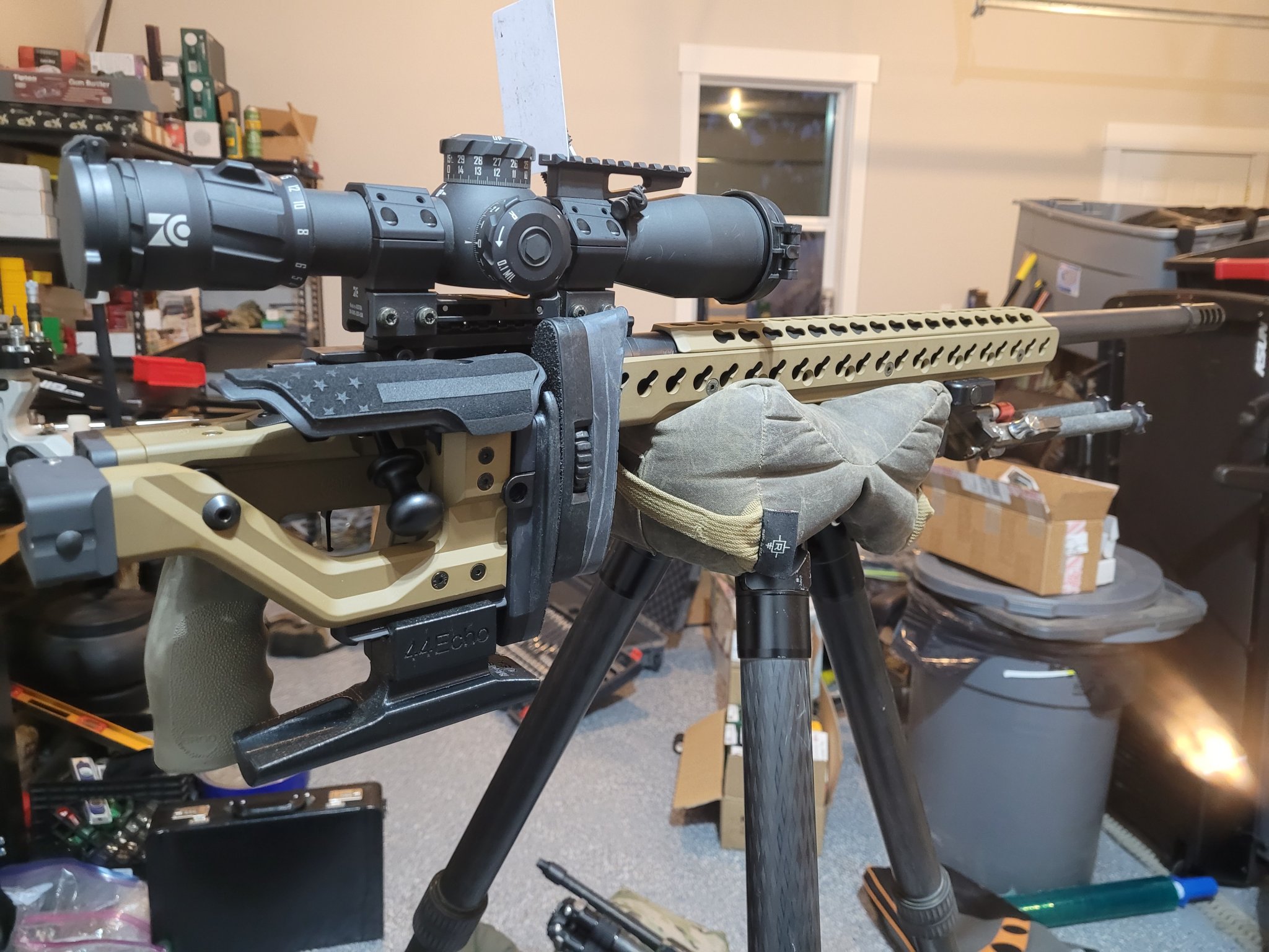

Rifle at 24 lbs.
(too poor to have a Raptar and need a Raptar mount so MRDS is at 12 O'c.)
