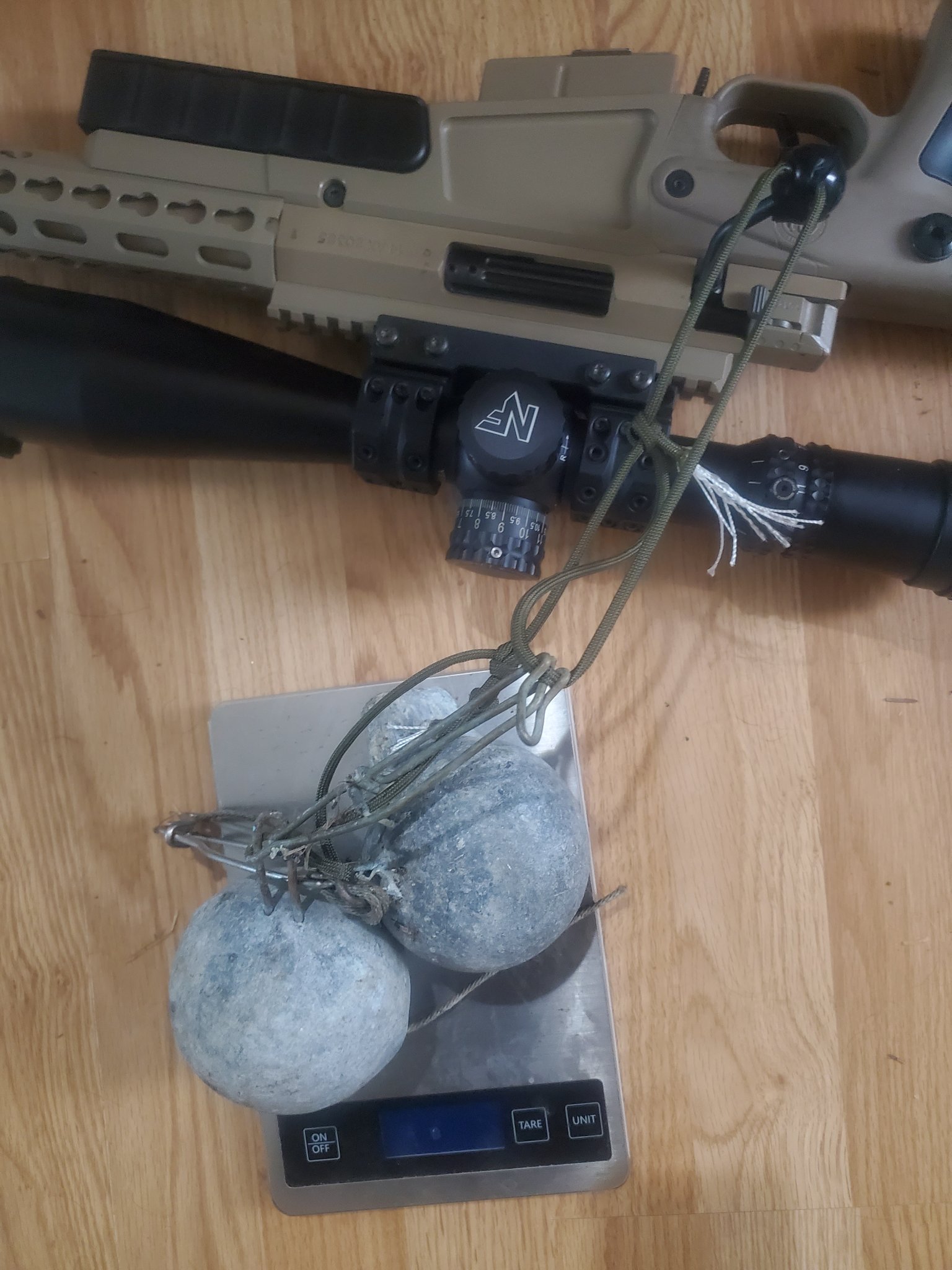

Not that it is scientific. But putting 20lbs of lead on the scale and taping paracord to the most outward point on the bolt, greatest leverage.
2014 AX308 was 7.5lbs to cock the bolt.
2022 AT-X took 12.7lbs
2020 AXSR 8.5lbs
Trg22 6.4lbs
Mousingfield 6.0

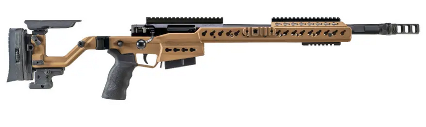

I could be wrong but these pics look like the AT-XC will have the AXSR grip angle (which I for one prefer). Maybe is AT-XC Gen 2? It was previously done on the CBP rifles. My apologies if this has already been discussed at nauseam...
AT-XC (eurooptic), all of their AT-XC pics are like this. Their unboxing video shows the "normal" at-x grip.
AXSR (eurooptic)
AT-X (milehigh)
CBP Rifle
Reactions: 96C
I asked about this when the CBP rifle came out and was told it's the nature of the photoshoping they did for the press release photo since that rifle in that configuration did not exist at the time. If you look at the CBP rifle you posted it's a lot easier to see the interface between the grip and chassis doesn't look smooth and natural.
Reactions: gamewarden
it's insane that the AT-X Mil and the Border Patrol guns aren't available for sale to civilians. I'd take either... or both.... but this is a company that nuked their patterns for the AW, both the action/chassis and the skins.... AI just doesn't make sense to me.
The grip angle thing is interesting... I much prefer the grip angle on my AXSR over the AT-X with the same Ergo grip.
Pictures are different on each website. (AI, MHSA, Euro).
The Euro video has a normal AT-X grip angle:
This guy has a new AT-XC that also has the standard grip angle.
Seems like some photoshop shenanigans.
