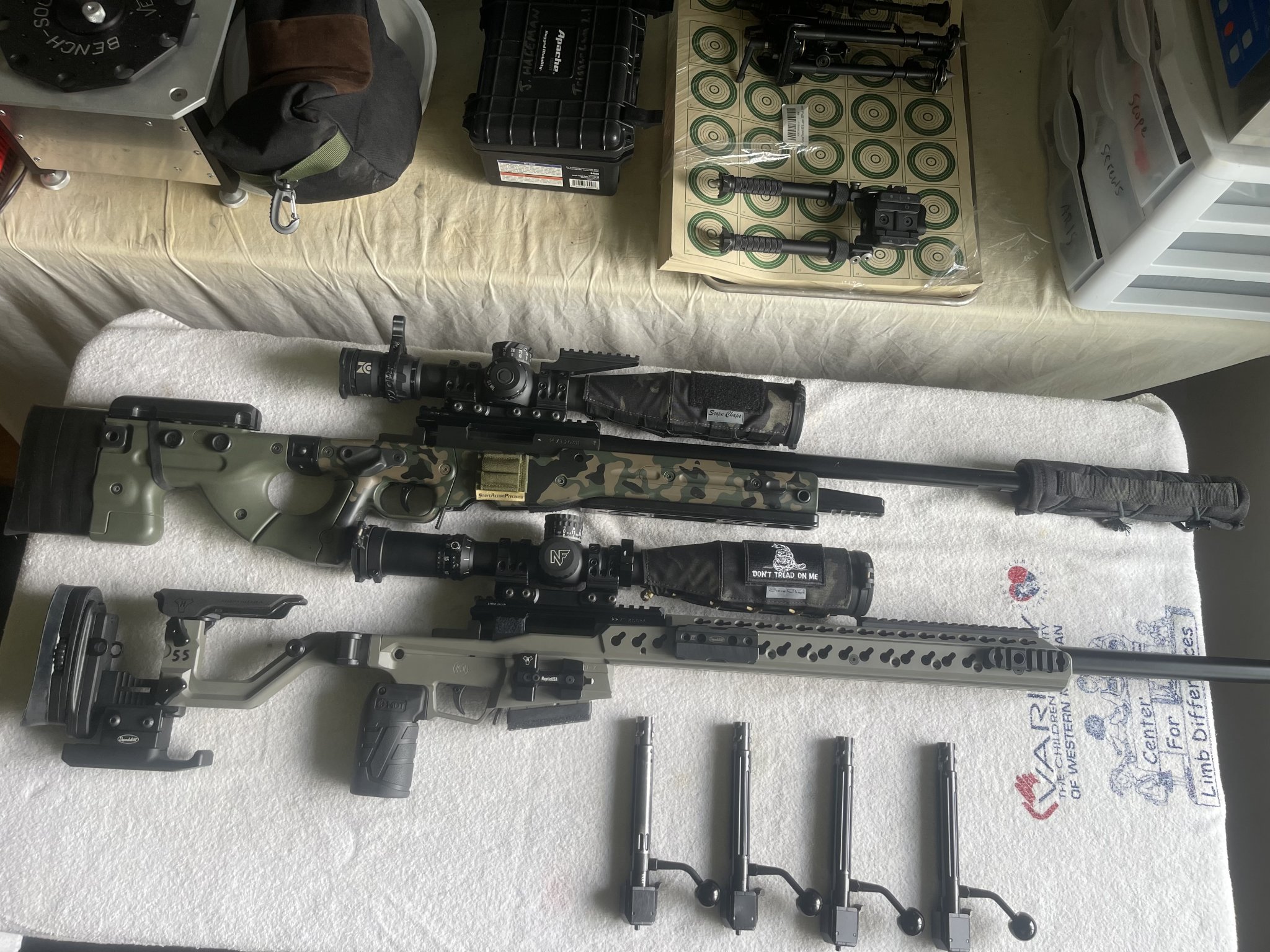

AI appears to change bolt fluting at times. My 2014 bolt isn't fluted when chambered, however, my 2015 bolt is.
