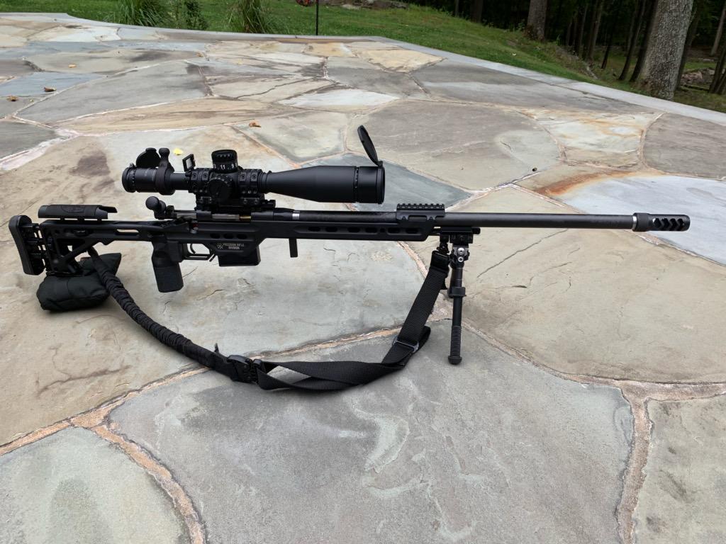

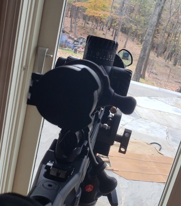

Hi everyone.
I've had a bug to add a reflex sight to my spuhr mount so that I can use it to acquire targets without zooming out my main glass.
I'm shooting a 6.5CM and main glass is tangent theta 5 to 25
Problem; There are so many to choose from. Any ideas would be greatly appreciated . Heres a picture of the rifle.

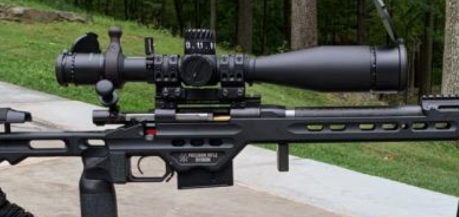

Your scope looks really high on your rifle in that picture. That may have something to do with not finding targets right away.
Got it, maybe I'll revisit my scope mount. How low profile cannI go...alsongotta checknmy clipon for height. Ty for pointing out that height thing.
How low can I get this scope? Any recommendation?
What Spuhr model is that? Also, is your receiver rail removable and replaceable with something lower? It looks really high...
Do not buy into the bs about a lower scope mount. That is not at all your issue.

I'll be the dissenting opinion here. I run red dots on both my match guns and find it to be a big help. It's not that I can't index on targets without them (in fact the more I've used red dots, the faster I've gotten at picking up targets with rifles that don't have them), it's just faster, especially in weird, awkward positions or when panning in big arcs. Put the dot on the target and drop behind your scope and the target is there. I have a red dot on my spotter as well and when I do my stage prep, I landmark where to put the dot to be on target and that translates straight to indexing the rifle on target.
That's why I have a bug to try it.
Which red dot are you using?
I'm using Leupold Deltapoint Pros but honestly you can use pretty much anything. I'd get a smaller sized dot though, something 3 moa or smaller (vs the 6moa dots on some RDS).

I only read the first post and looked at the picture.
I immediately had to post, so that I could ask if you were in fact, a giraffe?
After seeing what extreme long range rifles look like, my 2.5inch scope height is a nonissue. Topic here is more about acquiring targets and squaring off properly as some readers pointed out. Thanks for the laugh though.

I get it. Last match, I shot the whole match except one stage on 12x, including longer targets at 1000 yards. At 12x acquiring targets should be easier. Also, as mentioned above, if you have both eyes open, you can see the field.

Got myself a handy dandy vortex
Was half the price of a trijicon SRO, RMR or Leopold delta point and the life time warranty made it easy for me to decide...I love this for what I needed.
